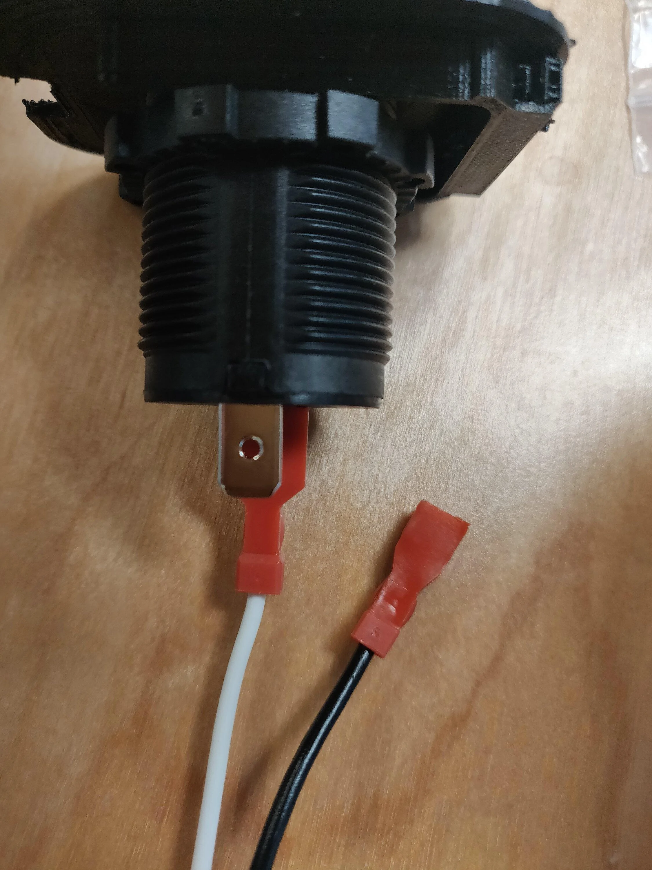

Question regarding this pigtail connector. White wire (positive) has larger terminal (fit perfectly on the positive connector of the 12 V outlet). Black one has much smaller terminal. How to connect it to the large negative contact on the outlet? Cut and replace with the larger terminal?
Also my Ginsco 12V outlet has a fuse and a wire. As I understand it would be nice to use a fuse in this potentially wet place. How to connect it between the pigtail and the outlet?
Thanks in advance
If using after market pigtails be careful using the wire color for polarity. Many of these pigtails were manufactured for speaker hook up not 12v power. It is best to plug it in and check the polarity to be sure. Also note the other recent posts about the wire size of the after market pigtails.

Please be careful with the Amazon & eBay pigtails.
I ordered one that was advertised as specifically for the Maverick Flex-Bed
The connector fits but the wires are for speakers, very thin gauge.
This is fine if you want to use them for some LED lights but not if you want to max out the 15 Amp spec for a compressor/inflator.
That's a good point. So far everything works. Would be nice to replace with OEM.
