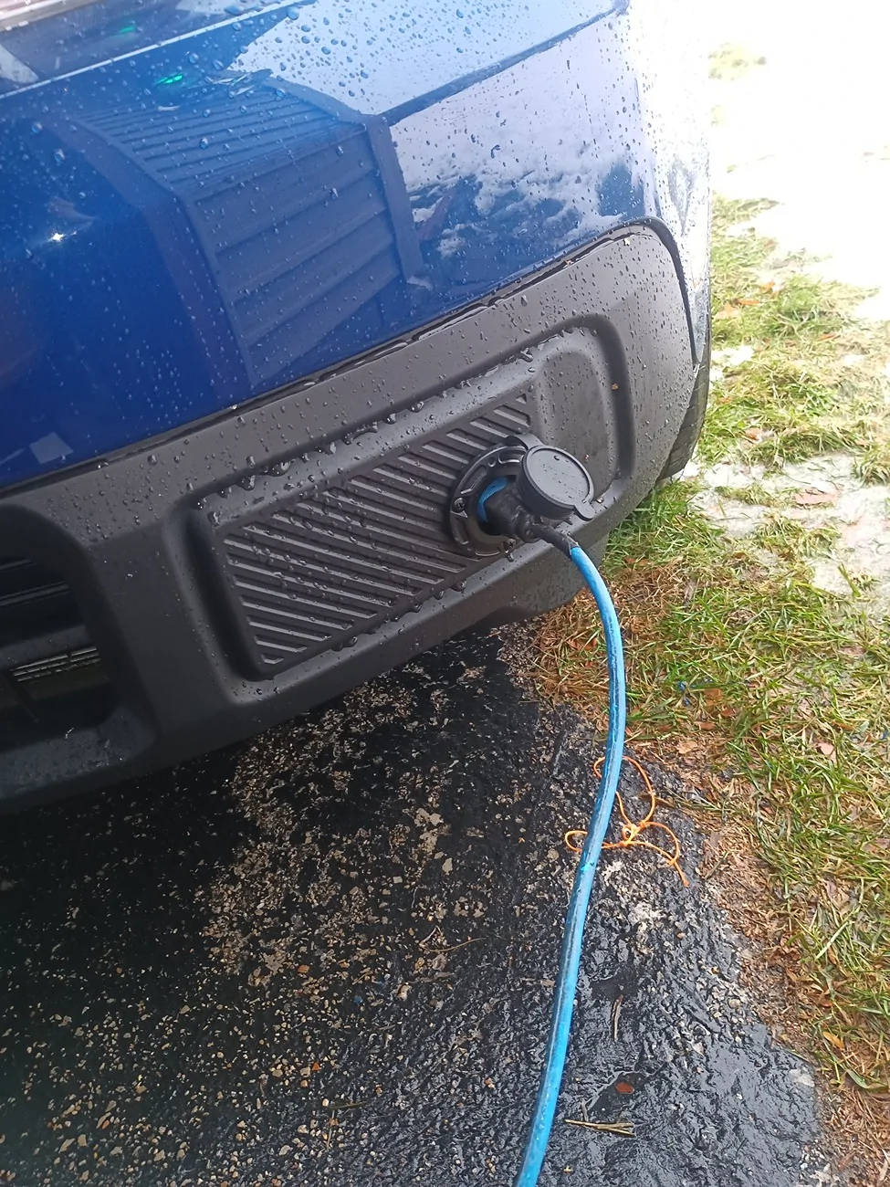

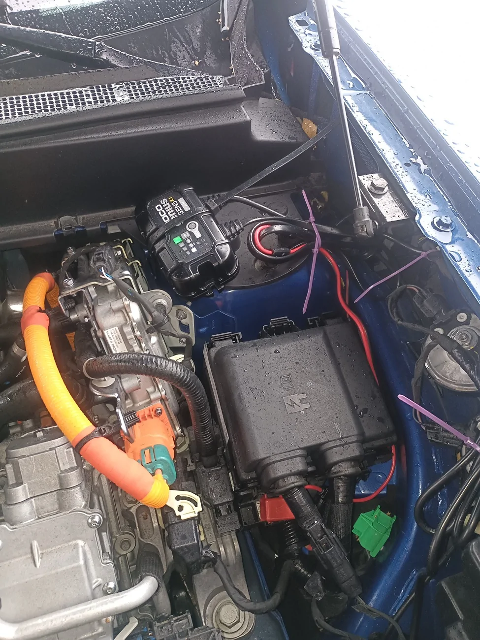

Mine has done it twice now that it's cold outside. Yesterday I temporarily installed a NOCO GEN5x1 under the hood and a plug in in the bumper. We'll see what happens. I don't drive it as often now that the salt slop is around. If it keeps it from deep sleep mode I will permanently mount the charger .

LMAO, a PHEV. Plug in Electric Hybrid Vehicle. That is no solution, it's a, Kick the can down the road fix. My problem was eventually solved on my third battery, I hope. Dealer programming and a larger CCA battery than it came with when I purchased.

Yes many of us have had this problem. Do a search and read all the threads. There are real fixes for some that work. Personally, I wouldn't keep the battery going by charging it, unless you want to continue until you sell and or the warranty runs out.
