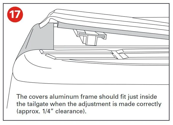

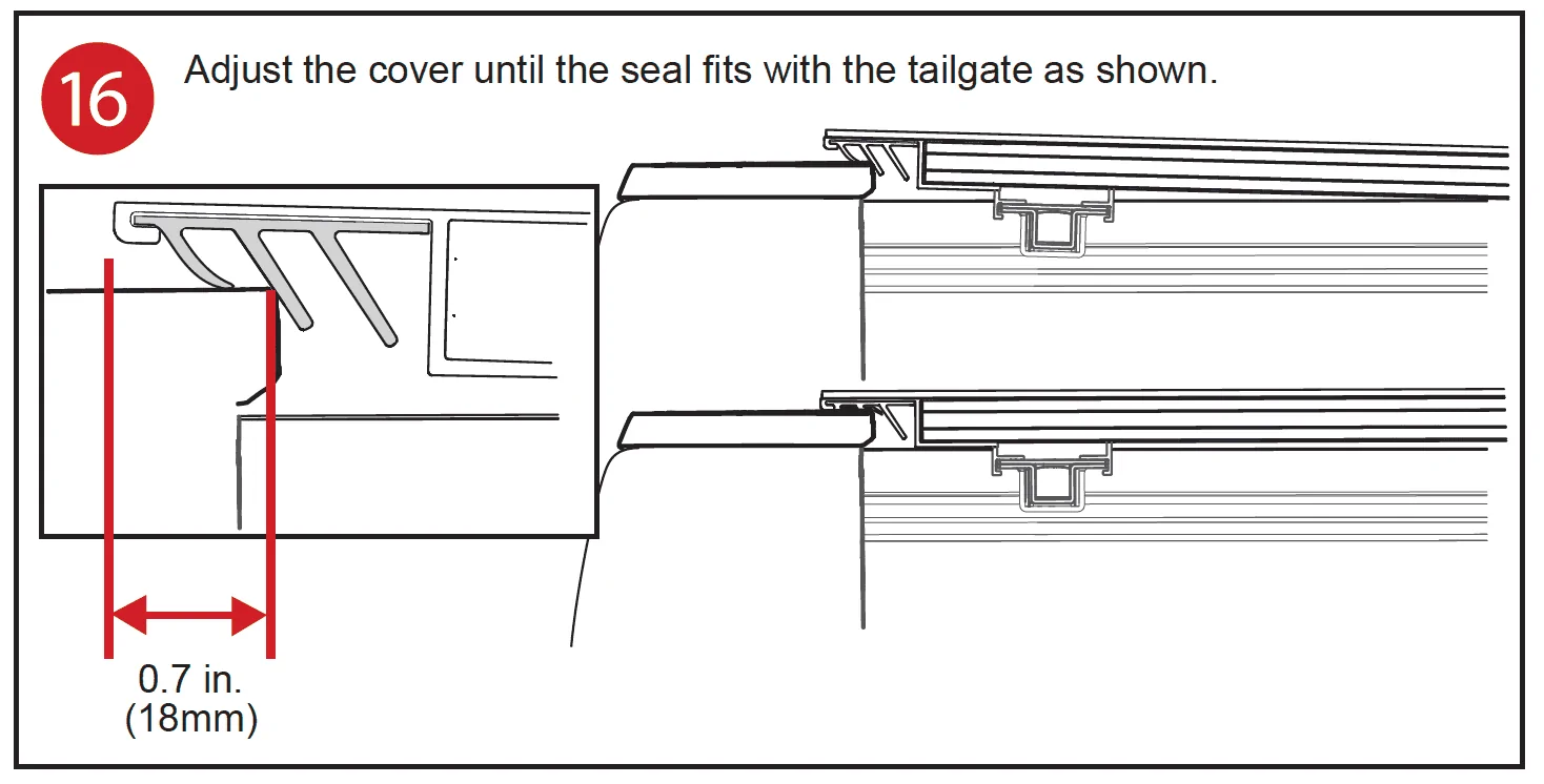

I just installed the Bakflip MX4 on my new Maverick.
The instructions suggest the cover's rubber seal should rest 1/4 inch on the tailgate. Mine is at most 1/8 inch.
ie. there are 3 rubber fins, the first and second should rest on the tailgate. Right now only the first fin does.
I'm concerned that it't not overhanging enough.
But I'm also concerned that nudging the cover up another 1/4 inch will shortchange how the cover sits on the seal by the cab at the other end.
Has anyone figured out the right protocol here to get the cover to have proper coverage at both ends?
Or how to shimmy the whole cover down a 1/4 inch?
Any experienced advice would be appreciated.
