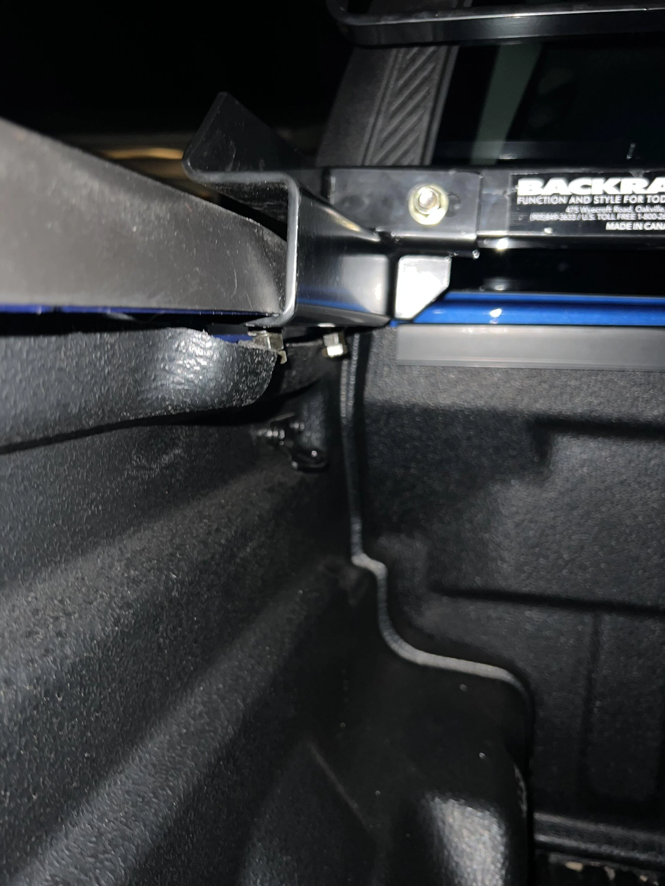

Backrack installed..terrible!

Better maybe. . Sorry to say it but it loooks really ......
Thanks..my others were a lot smoother looking!
Looks like it's made so someone could carry a ladder at an angle.
I use it to carry my arcade games standing upright. That way I can carry 2-3 and strap them to the backrack instead of just one at a time.

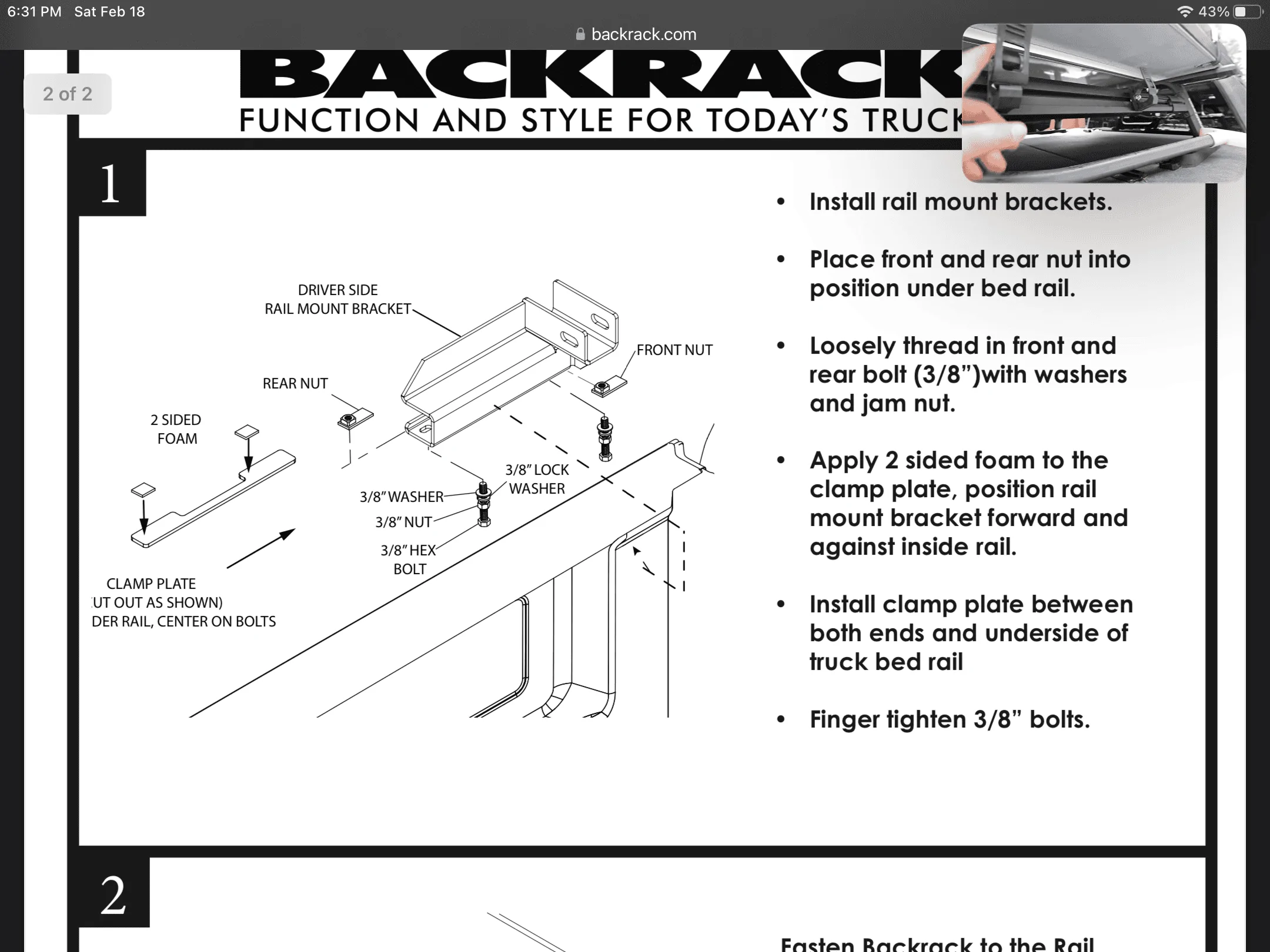

All rail fasteners should be under the rail…per instructions. no drilling. Reposition the bolts as shown in the diagram and it’ll probably look awesome. See attached pic of hardware mounting.

Post new pics when you get it repositioned please. I’m interested in a Back Rack too.

Hold up, did you drill holes in your truck for that?

Yea, looks like Back Rack just phoned it in with the installation design and/or the instructions.

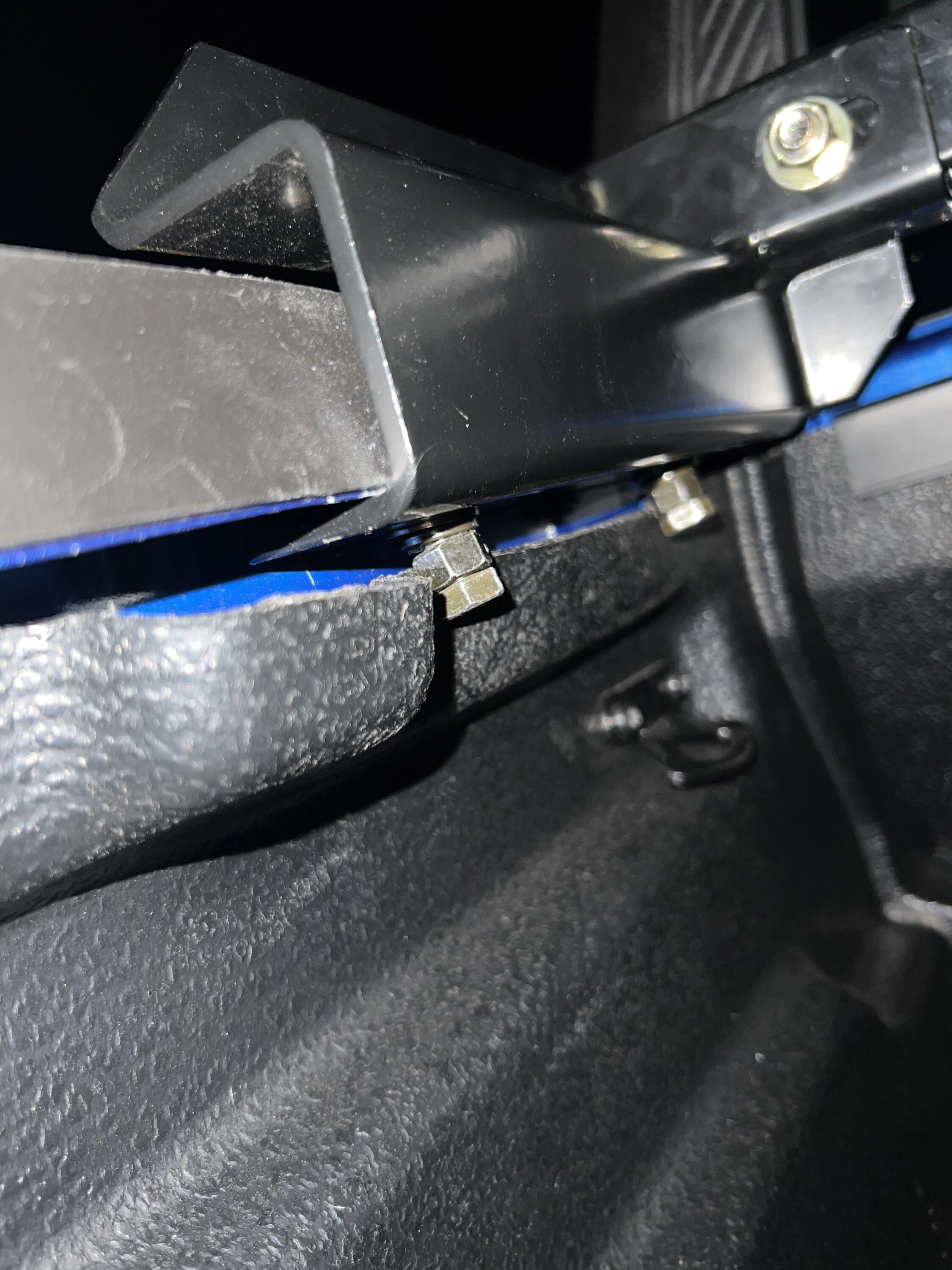

I saw this and tried every combination to try and make it work but in the end you’ll see this is the only way you could actually mount it.
Ford Maverick Backrack installed..terrible! 43676D55-F1ED-403C-A2F3-F6459DCF9E92
Ford Maverick Backrack installed..terrible! 78129B89-01EB-4DCB-9719-B7D48F2AADC1

Your DIBL is in the way which is why the bolts are canted over to the side, you’ll need to cut it like you did pictured on the other side. The jam nut does not go against the bolt head, it serves no purpose there.. it appears the bolts draw the black brackets down tight on top of the bed rails where you drilled the holes....
The clamp plates get double sided taped to the under side of the truck bed rail and the 2 bolts on each side contact those plates rather than the thin bed channel.
I would test fit, then fill those holes with a dab of silicon to prevent water penetration and rust, then tighten down again.
Good luck
ahhh dang it..but I think I get it. The front and rear nuts create a locking pressure point under the bed rail and fit in those holes…I will try that..not sure if it will work but it’s totally worth a shot!

The liner looks like it’s getting in the way. Send some pics to: email: [email protected] and see what they say. The instructions recommend removing the liner. Gotta be a more graceful way to mount the rack.

ahhh dang it..but I think I get it. The front and rear nuts create a locking pressure point under the bed rail and fit in those holes…I will try that..not sure if it a
I did remove the liner (mostly you will see in my video..I have an idea of how to do it…but directions are not great.

Probably best to notch the DIBL so that you can easily check and re-tighten the clamp bolts periodically.
The final installation will likely cover the drilled holes. Post up some final pics, we all make mistakes..
