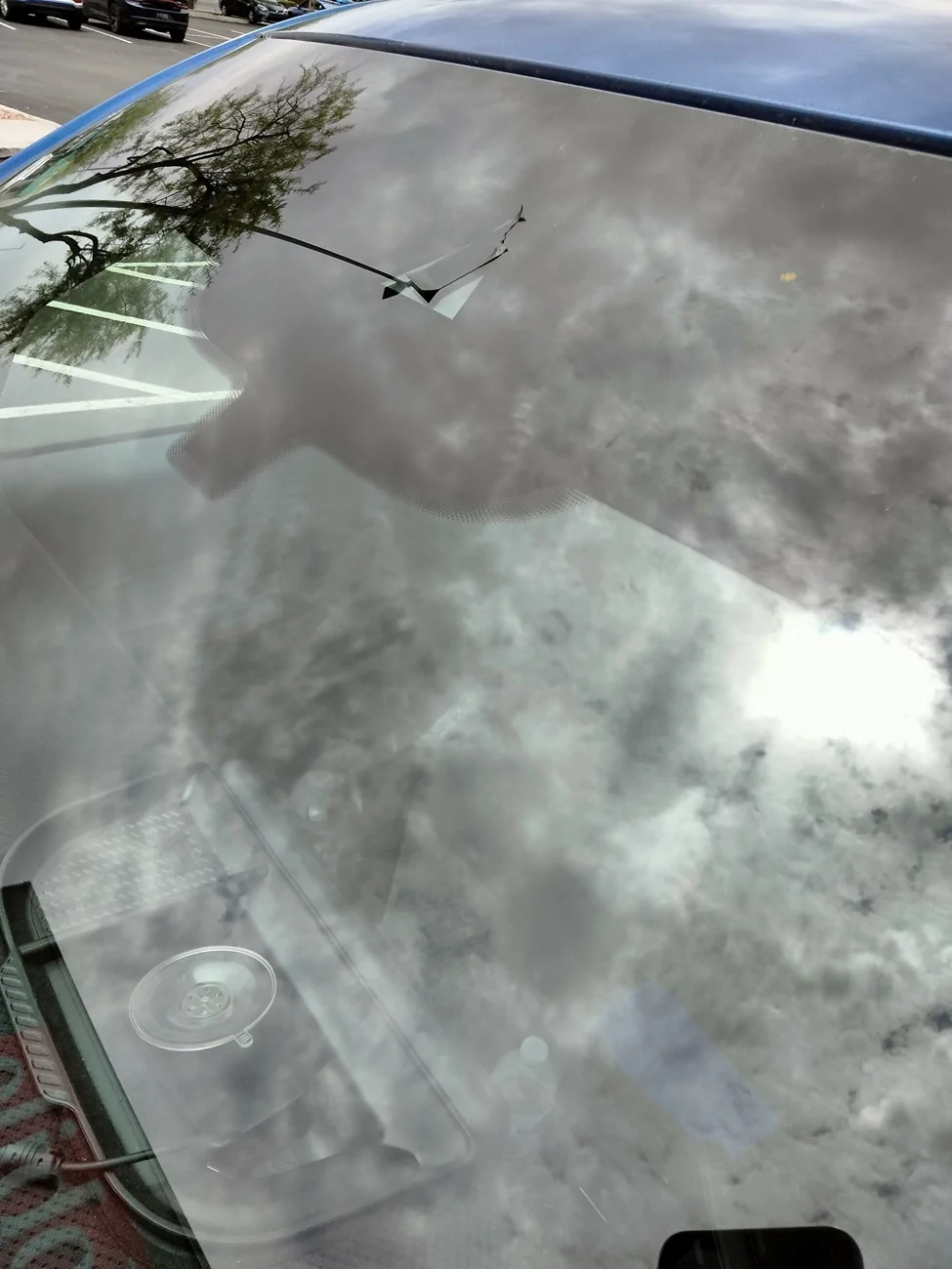

Where is the sensor? The truck is almost 3 years old, always parked in the garage and this was the first time we got that notice, and the next time we started the truck, after church, it was no longer there. So maybe a dirty sensor? Communication issue?
Just out of curiosity today when I went out.
I put a piece of black electrical tape over my camera in the middle of the windshield.
Ford Maverick Automatic Crash Notification System Off warning IMG20260713121736
I received no warnings whatsoever.
I tried using my Lane assist. It didn't give any warnings, but it also did not detect being in a lane. The little notification stayed White instead of turning Green or Red.

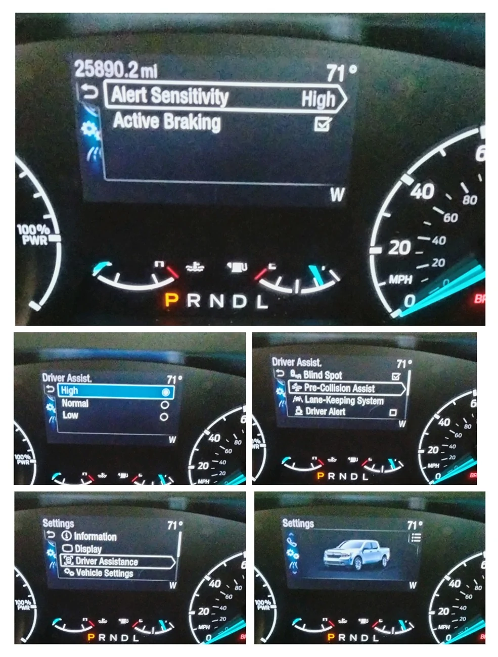

Mind you, on my pre-collision assist I have the alert sensitivity set to high
Ford Maverick Automatic Crash Notification System Off warning IMG_20260406_141838
In a couple of days I plan on using a larger piece of vinyl over the sensor and I'm going to put some aluminum speed tape over the sides of the bumper to see if I can elicit any warnings.
