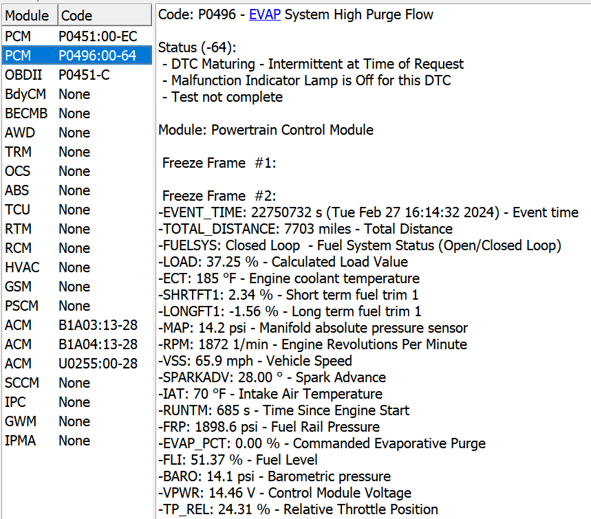

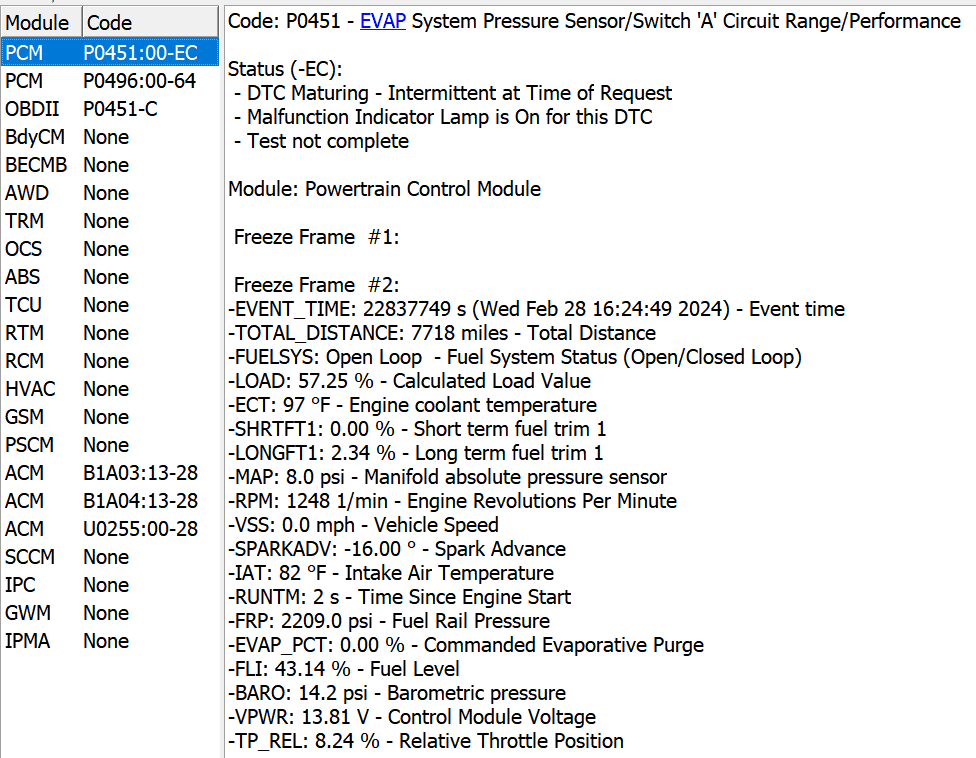

After what I thought was 7,718 trouble free miles - my EB has experienced the dreaded EVAP system service engine soon warning.
Interesting enough if you look at the Forscan log for code P0496 it states that the malfunction indicator lamp (check engine light) is off for that specific code, and that it actually started occurring after 7,703 miles - so the Maverick let me drive with a DTC for high EVAP purge flow and let me keep driving, no check engine light or FordPass warning.

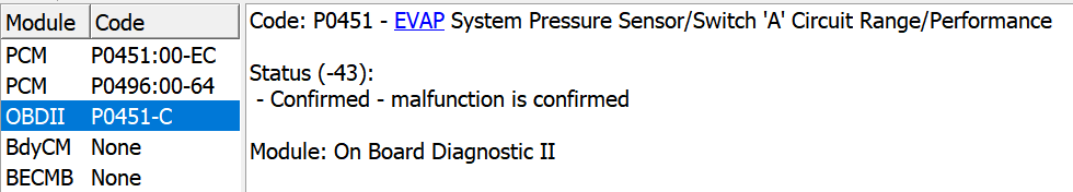

P0451 is what actually triggered the FordPass warning and service engine soon light.
This is a fairly known issue with Ford engines - a once reliable part (the EVAP purge valve and cannister) was made exponentially less reliable to save a few pennies.

Chapman Ford (Marysville, OH) quickly confirmed it is the EVAP Purge Valve, unfortunately they did not have the part in stock but they are getting it overnighted and I have an appointment scheduled on Monday at 2p to have it replaced, probably take about a half hour to swap out.
They are also honoring my request to not have the hyperflash turn signal recall performed as it will mess with my added TSR and lane keep assist.
So from the time the check engine light came on to when I'll have it replaced under warranty by Ford will happen in less than 5 full days, and the dealership has offered to pick up and drop off my Maverick for today and on Monday (however I declined).
I don't like that the purge valve went out at 7,800 miles but you really can't ask for a better response from a local dealer.
