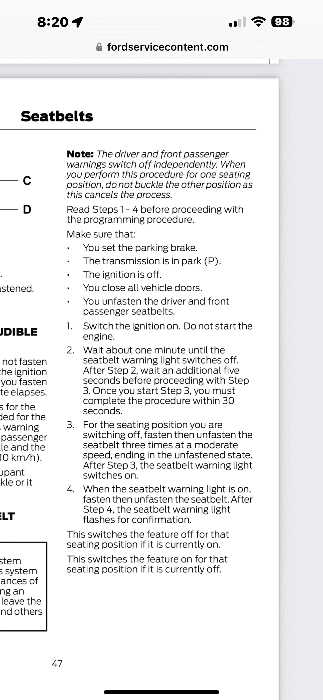

Just got mine to work, 2023 Hybrid. Followed the steps mentioned earlier:
Set E-brake
Turn on vehicle (not engine)
wait like 2-5 seconds.
Slowly connect and disconnect the seat belt watching that the seat belt light turns on and off.
Slowly continue this process until the seat belt light begins to flash.
Thats it, your done with that seat belt. Now do the passenger side.
You definitely need to watch the seatbelt picture and coordinate your buckling/unbuckling to that diagram.
Set E-brake
