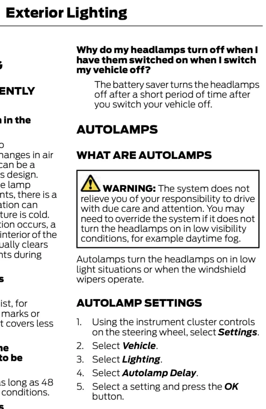

Anyone experienced any issues in adjust the auto headlights delay?
It doesn’t matter your setting, the delay it seems hold in 20 seconds.
This is what manual states:
I did a research in the modules settings and found a block called “Autolamp delay” in the BdyCM. I’ve change the default value (20 seconds) to 0. Nothing happened.
I will other settings later on. Keep you posted.

Simple, in the auto position, it takes 20 seconds to turn on the headlights when enters in a darkened area.
Back in the early days of auto headlamps, my 2003 Taurus would frequently turn the lights on and off when ambient light levels fluctuated, like passing under tree cover.
Over time, they've matured the logic to smooth things out so that generally when the lights turn on, they'll stay on for a while.
Unfortunately, that means that, for instance, they won't turn on for a bit after entering a tunnel. In cases like that, it's probably best to turn them on manually rather than wait.
The customizable delay in the settings is for headlights staying on after the vehicle is turned off. When you turn off the vehicle, the headlights will briefly stay on.

In case anyone finds this later and is confused - the ambient lighting is a setting in the infotainment center not the dashboard - and fits with the Lariat trim line as shown in the video.
In manual (your page for year will vary) under Interior Lighting - Ambient Lighting.
The delay for ext lights to turn off is another delay in the dashboard settings. No setting for interior they'll time when they time out.
Under Exterior Lighting - Headlamps.
SWITCHING HEADLAMP EXIT DELAY ON AND OFF
To switch headlamp exit delay on, pull the turn signal lever toward you when the headlamps are off and the ignition is off. A short tone sounds when the system is on.
To switch headlamp exit delay off, pull the turn signal lever toward you again or switch your vehicle on.
Note: The headlamps turn off after three minutes with any door open or 30 seconds after the last door closes.
The auto-lamp for turning on is another setting.
Which is shown above, but it appears misunderstood as to usage, though latter post covered it.
