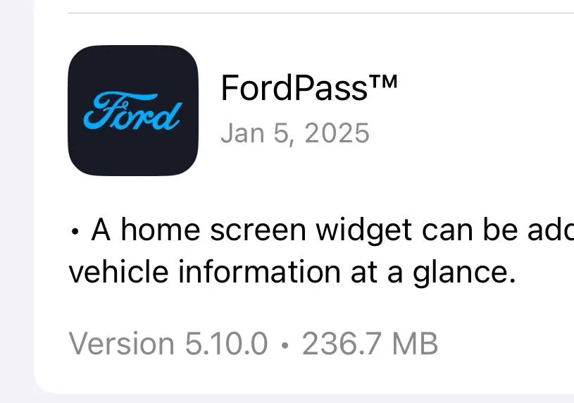

Maybe your app needs updated, mine is this version

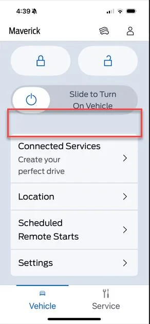

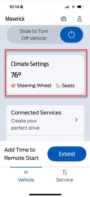

I figured out what the "problem" is. I was expecting to see Climate Settings between the "Slide to Turn On Your Vehicle" and "Connected Services", but it doesn't show up until after you turn your vehicle on. My bad.
Once I turn on the vehicle, I can change my heated steering wheel & heated seats settings.
___
Great! Thanks for the helpful info.
___
I didn't think to mention it doesn't show up until the truck starts, sorry.........

I have App version 5.10.1 and used the app to start my truck this morning. The option(s) didn't appear for me after it started?
I'll monitor. Perhaps it takes a bit for the app to implement those options, or it's related to a permission I've not allowed?

I'll chime in here. My 25 hybrid, which I've had for all of a week now, has the same issue. It was -14 here a few days ago, so I definitely noticed.
Initially, the seats and steering wheel would not turn on with remote start, and were not on after starting either, despite setting them to Auto in the truck settings. This was true with both the app the key fob. At this point, to turn them on, I had to push the buttons on the screen once the truck was on.
Eventually I found the climate settings in the app, and set the seat and steering wheel to be on with remote start. Now, after using remote start with either the app or the fob, the steering wheel is toasty warm when I get in the truck. The seat is not, but turns on at 2 bars once I start the truck. I typically run the seat at 1 bar, and when I turn it on with the button on the screen it's at 3 bars, so it turning on at 2 bars must have something to do with the remote start. So I think it's kinda working, but it's not coming on at quite the right time.
It's not the biggest deal, since it warms up fairly fast after the truck is on, but it would be great if the seat would be warm right when I get it. Like it's supposed to be. I'm sure it's a software issue, I just hope ford fixes it soon. No one at my dealer has any idea how to fix this issue.

I just deleted and reinstalled the FordPass app. Now on Verizon 5.10.1. I remote started my truck, but the climate option still does not show up. I have a '24 Lariat.
Any clues on why some people have that option or how to get it ?
