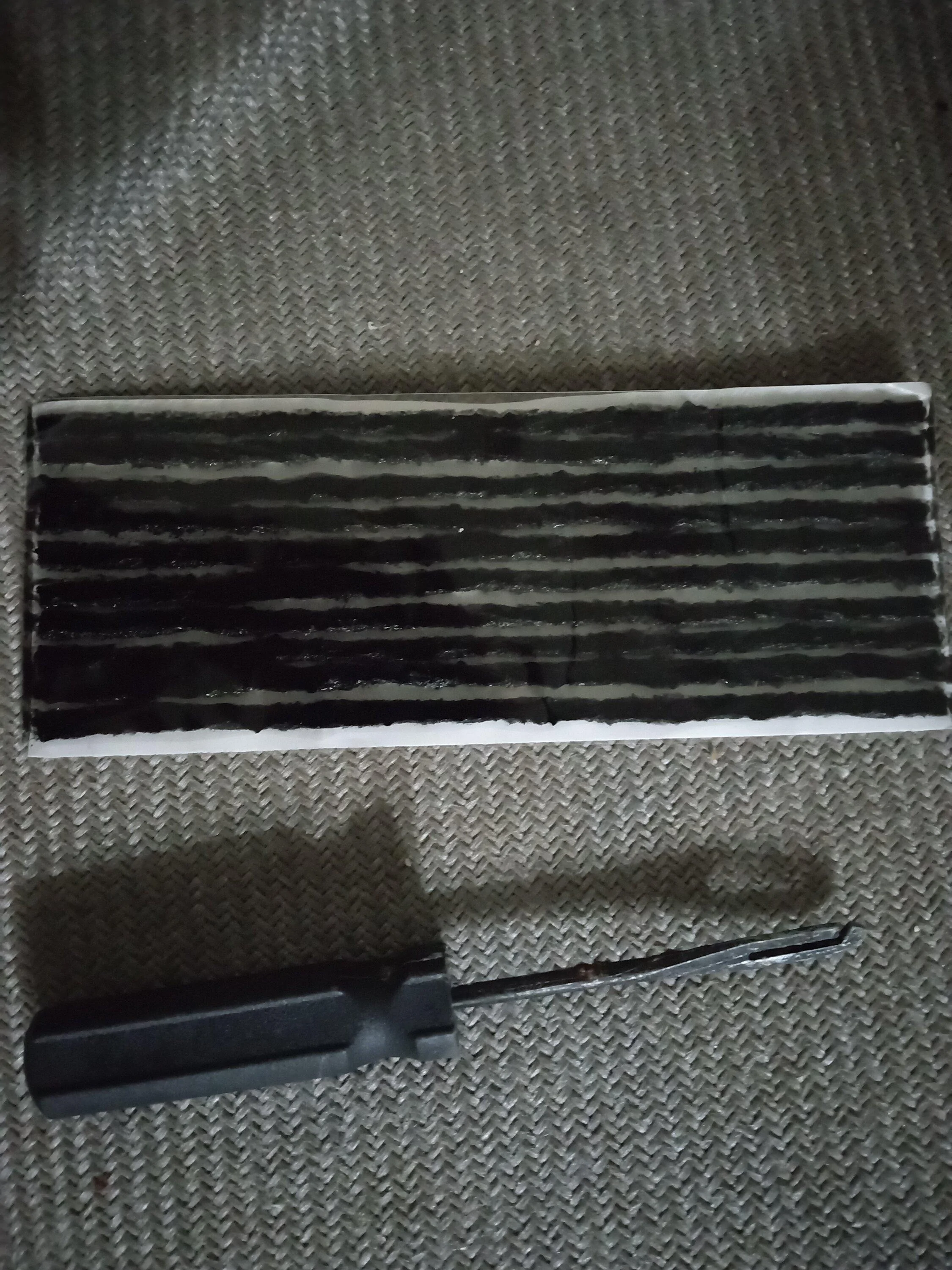

I too carry a compressor and worm kit. For a simple nail or screw in the tread the worm works well and lasts. If the puncture is more complicated a worm may get you to a safe place to change the tire. Plugging on the side of the road takes way less time than jacking and putting on the spare. Also, as said a few posts back it is your decision if the tire needs to be replaced.
