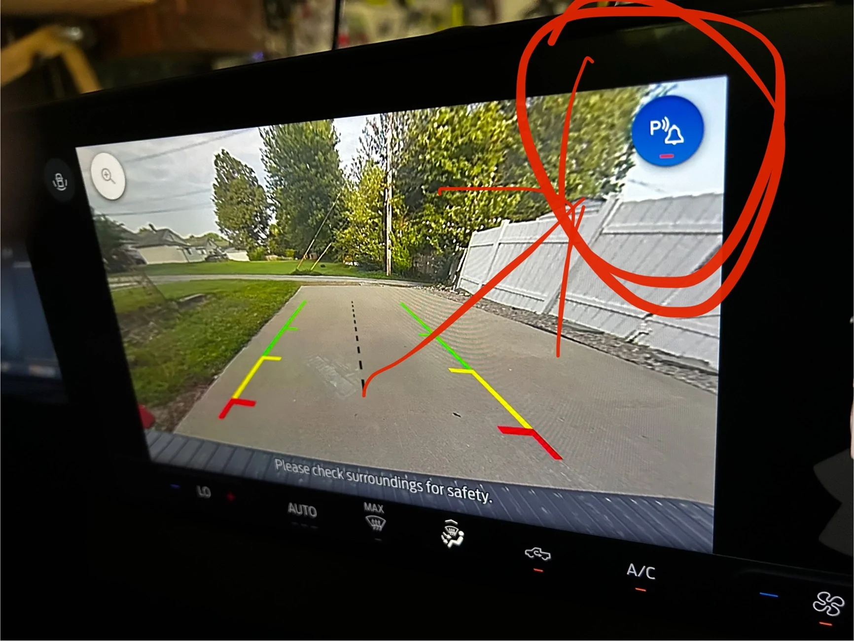

Depending on what year your Maverick is, there is a "silent tailgate alarm" button somewhere on your truck. On my 2025, it appears in the upper right corner of my infotainment display.
But I'm with you. I don't need an alarm screaming at me about the tailgate being down when I'm already trying to concentrate on backing up without the camera.

Ford Maverick Anyway to disable reverse beep with tailgate down? IMG_5151
This is what I have to tap to silence mine. Friend of mine has a ā€˜22 Ranger with the same button, but it’s a physical one on his console. It’d seem weird to me that ā€˜25 is the first year it was offered on a Maverick, but I also don’t feel it’d be a surprise either.

I believe OP's is pre-25. So it'd be in the instrument cluster Menu > Settings > Driver Assist > Rear Parking Aid On/Off.
