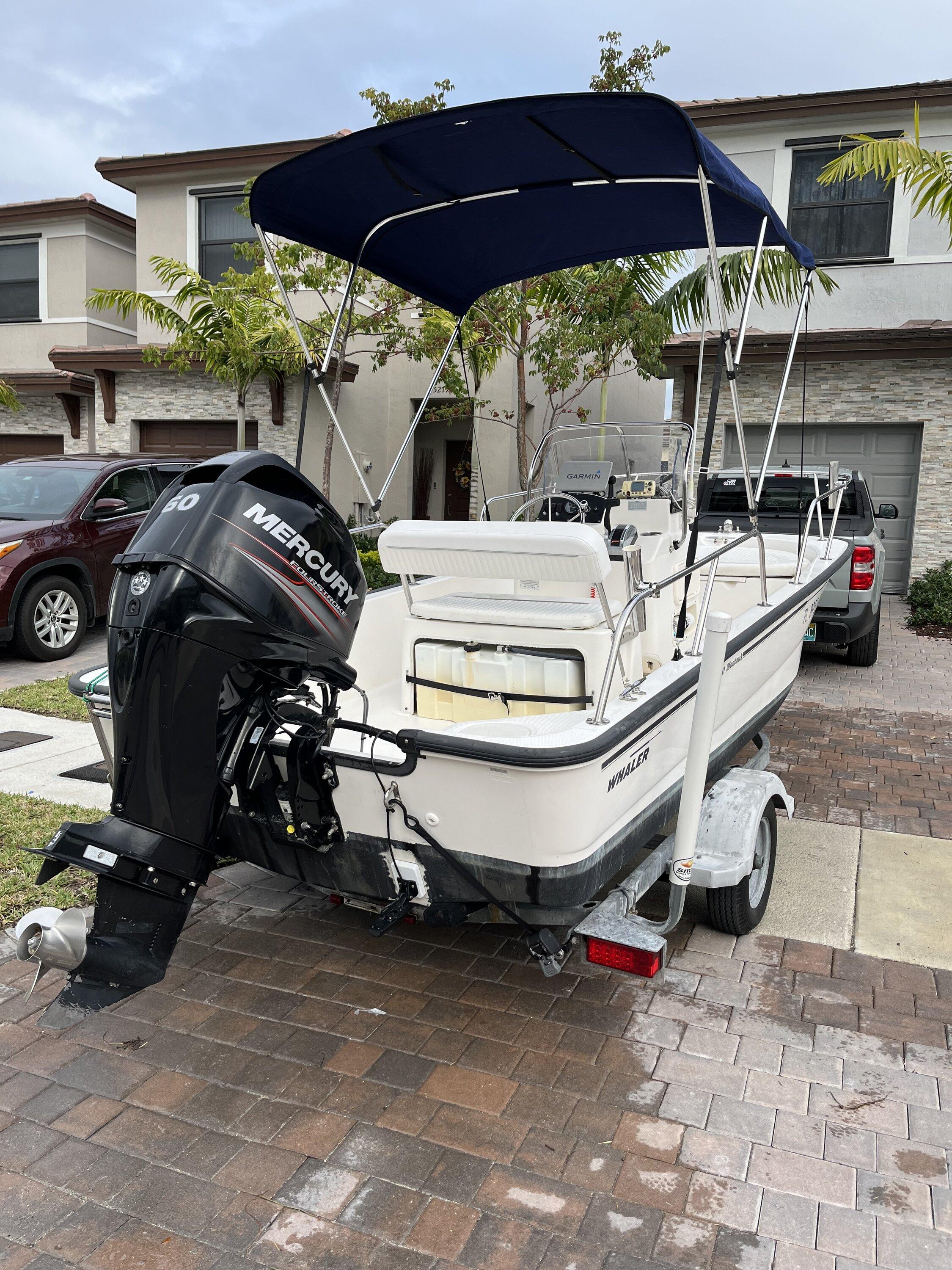

Here is my boat right at 2,000 lbs. Launched a few dozen times this year, hasn't been perfect scenarios and conditions every time, but never once did the tires make a peep. For the other 95% of my driving I get 45 MPG+.
I even pulled the boat to the everglades to fish in Florida Bay/Flamingo area in South Florida 180 mile roundtrip. Averaged right at 33 mpg on the flat roads going out there.
I will say that the UK Hybrid Ford Kuga (US Hybrid Ford Escape), is rated for 1,600 kg in the UK (2,000 lbs US). The vehicles use the same platform and drivetrain. US/UK use different calculations to come up with the towing numbers, but if you tow close to the limit or over that of your vehicle, slow down. IMO you shouldn't be going freeway speeds with a trailer whether it's a 1,200lb trailer or a 2,000lb trailer.
