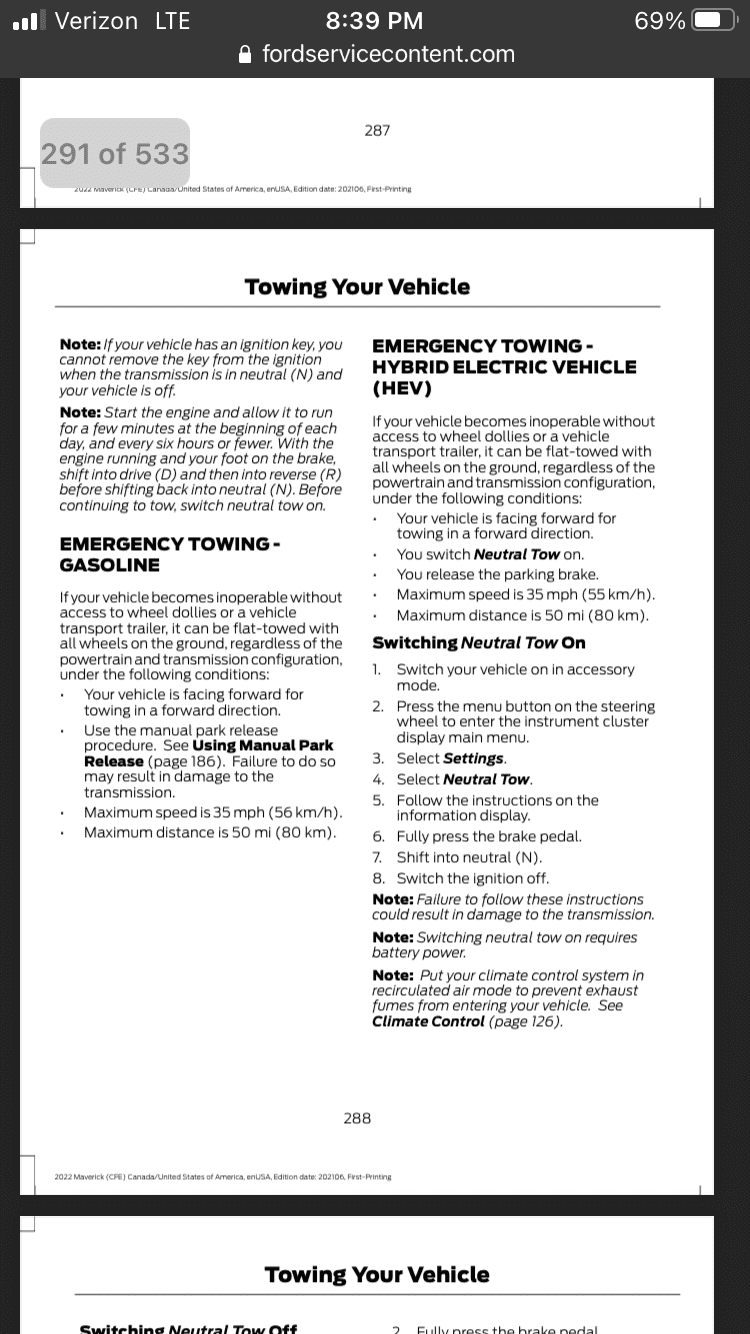

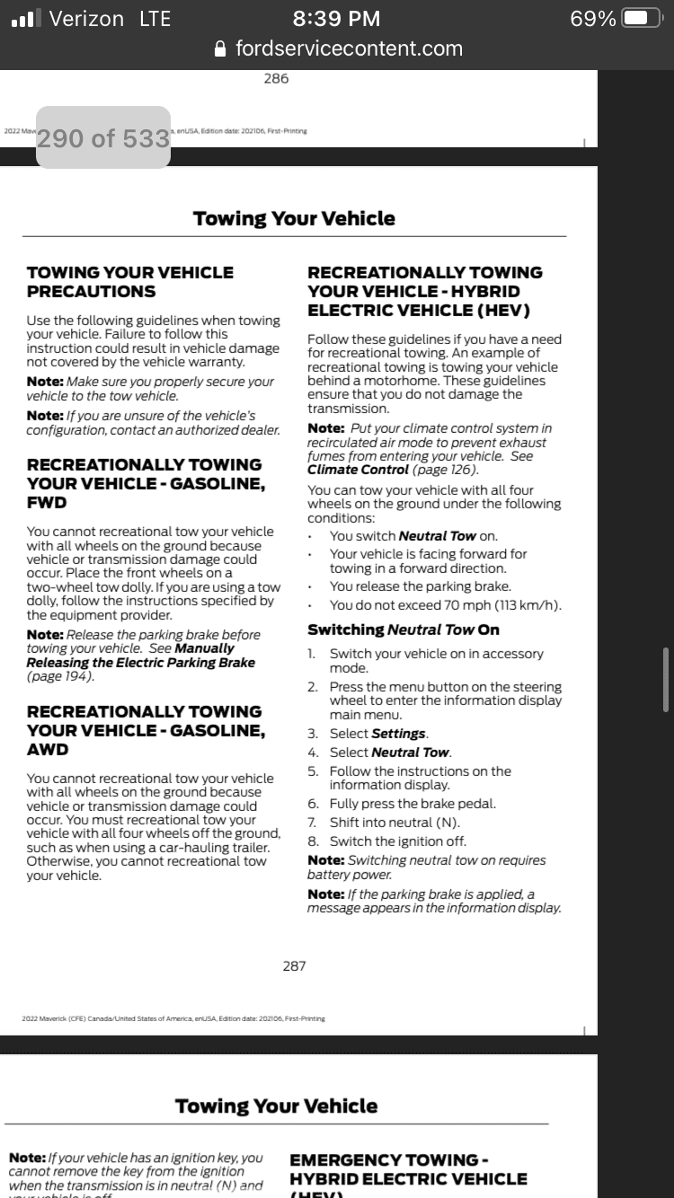

Xbbqpitmaster
Dec 21, 2021
399
407
Full Time Gypsy
2024 Ford Maverick XLT
Ford Maverick Anyone towing a Mav behind a motorhome?  Can it be done? 8EDD4C33-0B49-40A3-8CE3-87BBDD176EBB
Ford Maverick Anyone towing a Mav behind a motorhome?  Can it be done? C4C37A7D-60E7-452A-8294-D18518E70D07
