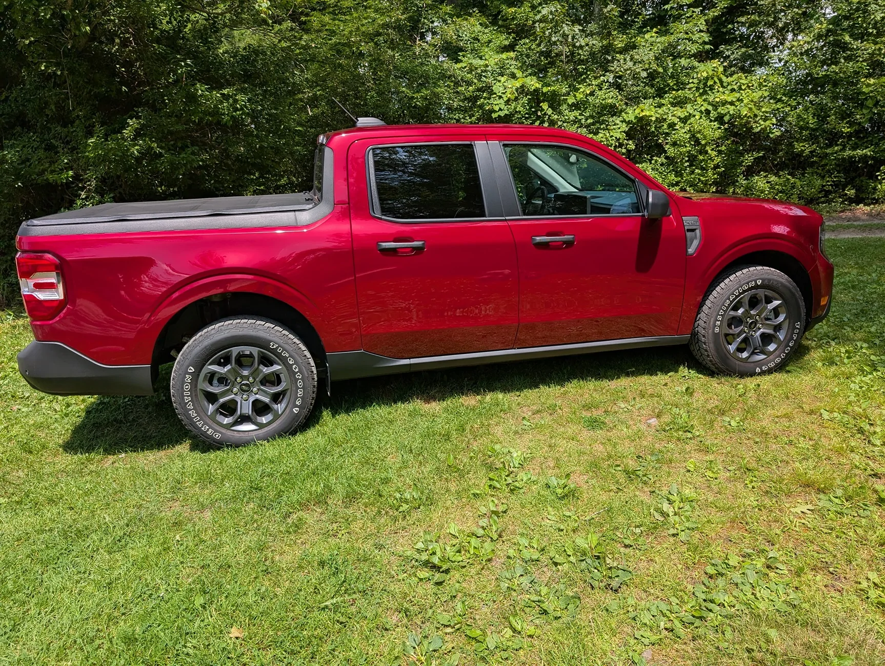

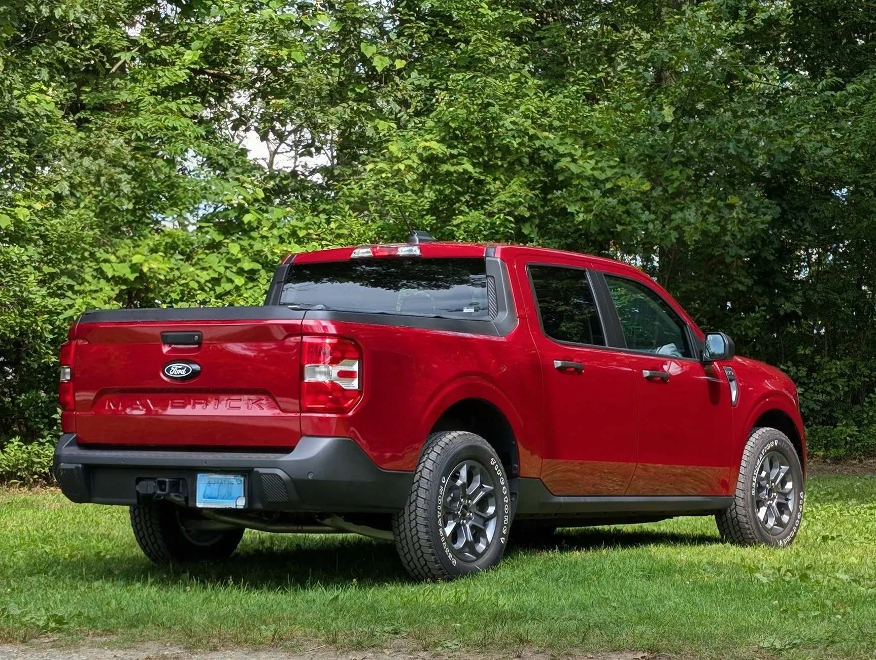

I went 235/70-17 in that exact tire and have been very happy with it.
Road noise is increased a little bit, but certainly far from unbearable. I was expecting to have a little more road noise. Impact on MPG has been small, ~2 MPG. Have driven in sand, mud, rain, and snow; these tires haven't missed a beat.
Looks good!
Added weight taxes mpg.
Type of tire can add more weight than another.
Even one A/T vs. Another.
