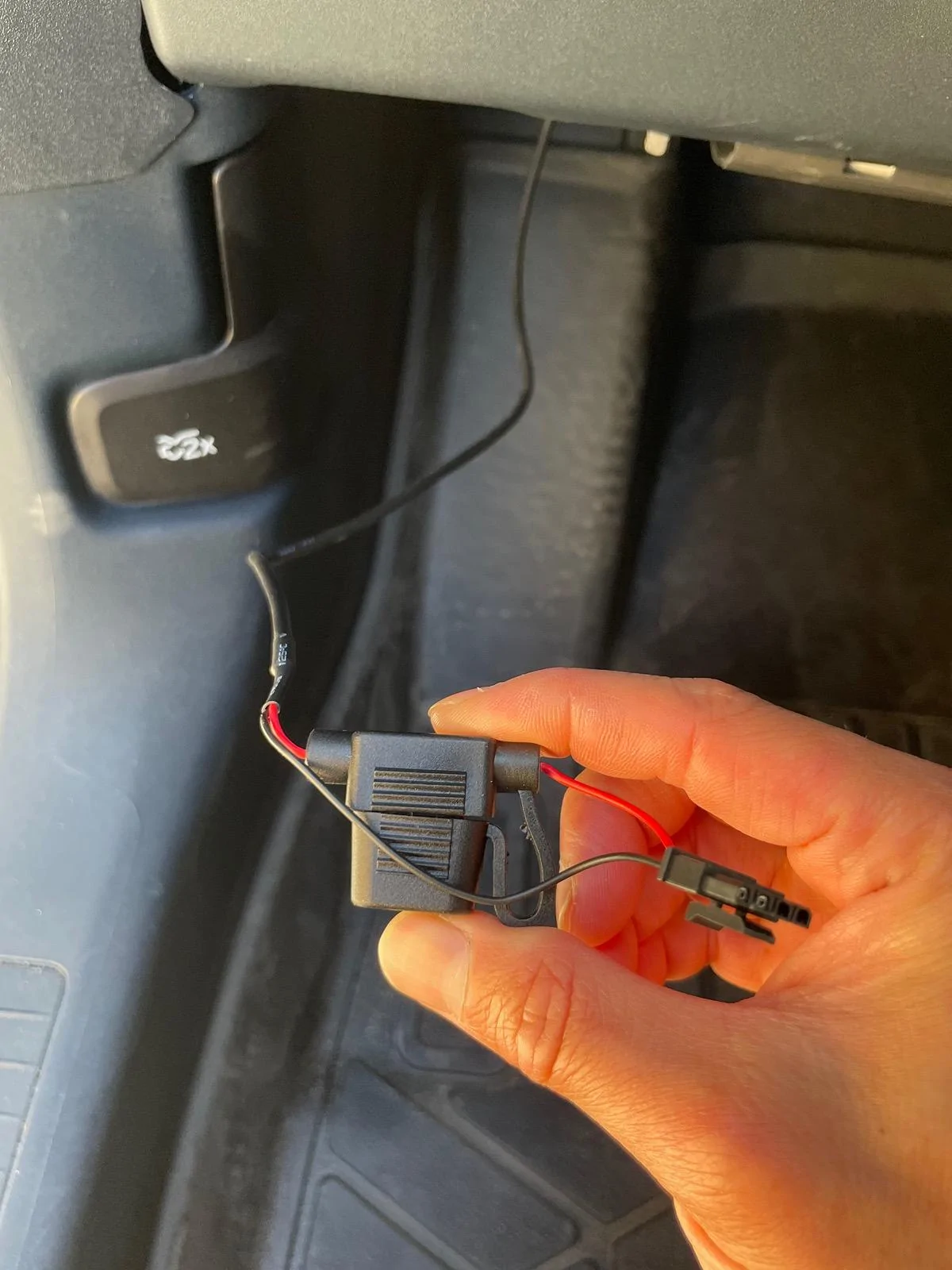

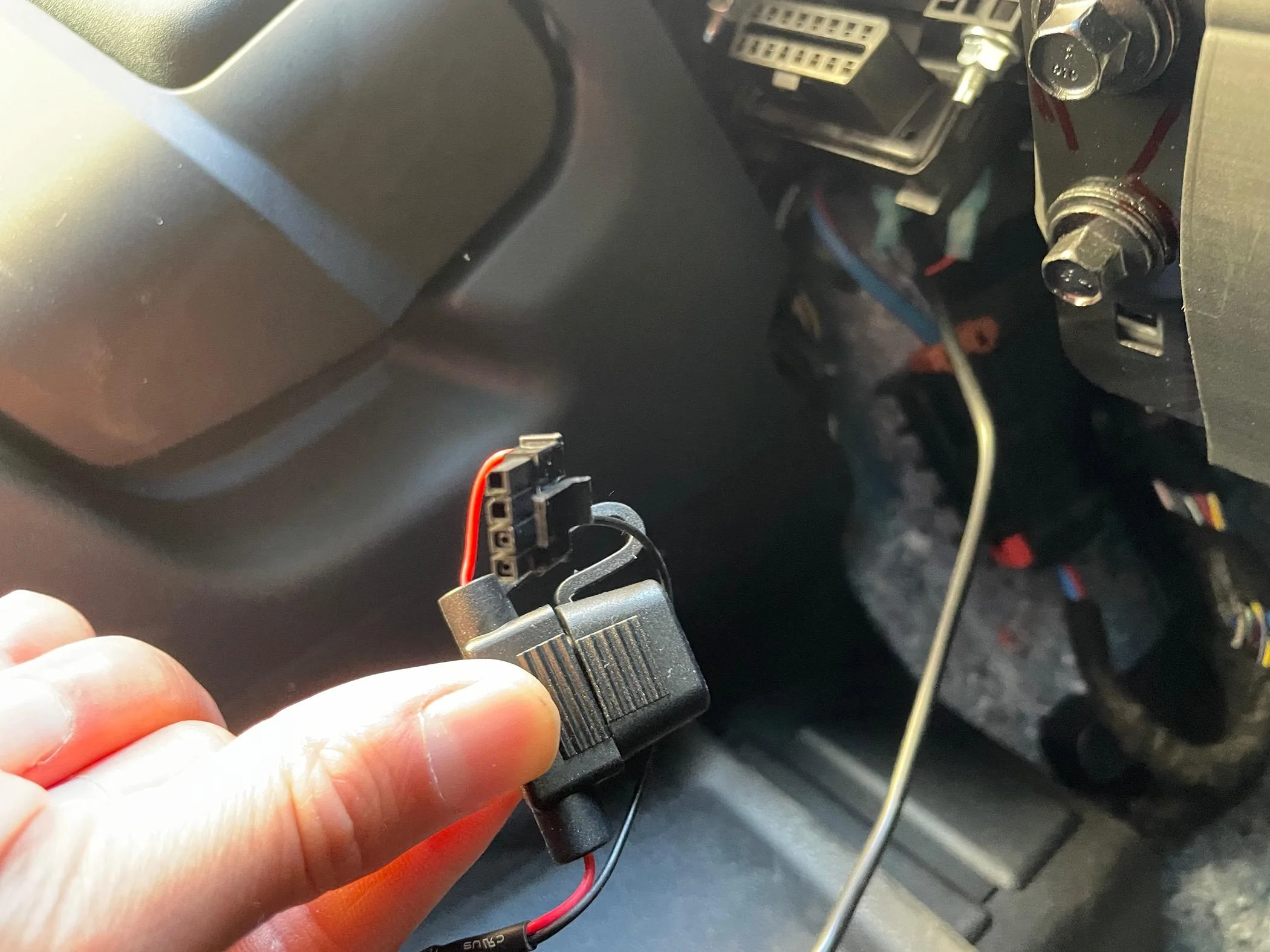

Anyone know what this wire is for/supposed to connect to?

You can always unplug it and see what, if anything stops working.
By the way, many dealers are adding extra tracking devices to all vehicles, they tell you it’s to recover it if stolen and the built in tracker is defeated. They charge you for it and they get a nice check from the company that makes the tracker. If you read the paperwork that comes with it the recovery service is a small part of it. They really want to track all your driving habits and locations and sell that data to whoever they want, which most likely includes insurance companies to assess your risk as a covered driver. On top of that the data they collect is not secure so anyone can hack it and get all your data as well.

I'm guessing a vehicle tracker was connected to it if you financed, easier to repo if you don't pay, possible removed during a service visit.

I have a suspicion that the 12V power at the OBD-II port may not be switched like the lighter power point below the HVAC controls. If you wanted to install something like a dash cam or LoJac that needed uninterrupted power, this might be the place. Has anyone tested this?

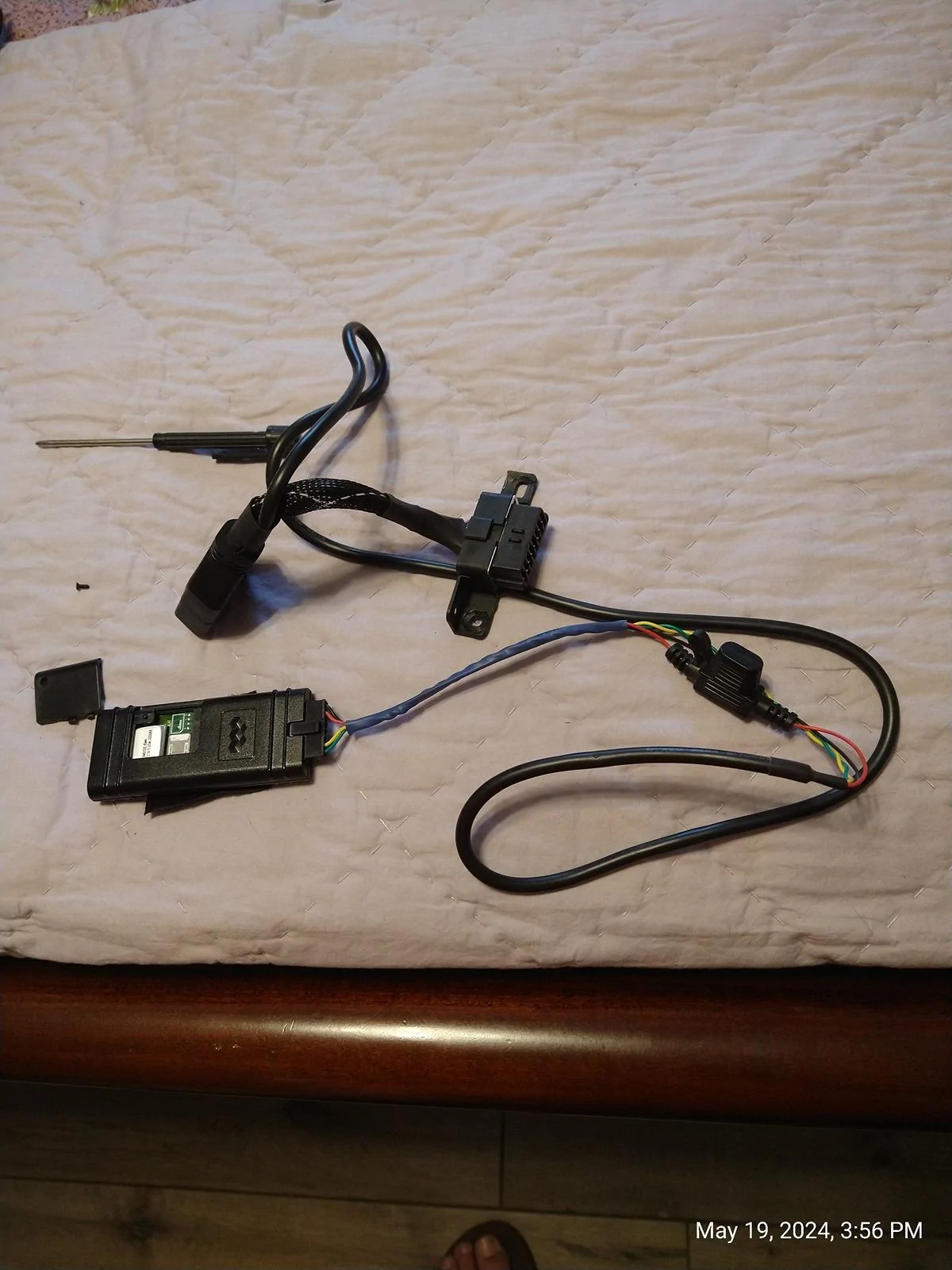

This fell down when i took my driver-side mat out to clean. The mat must have knocked this loose. Anyone know what it is and where it's supposed to plug into?
Hopefully its nothing to do with the driving 😅

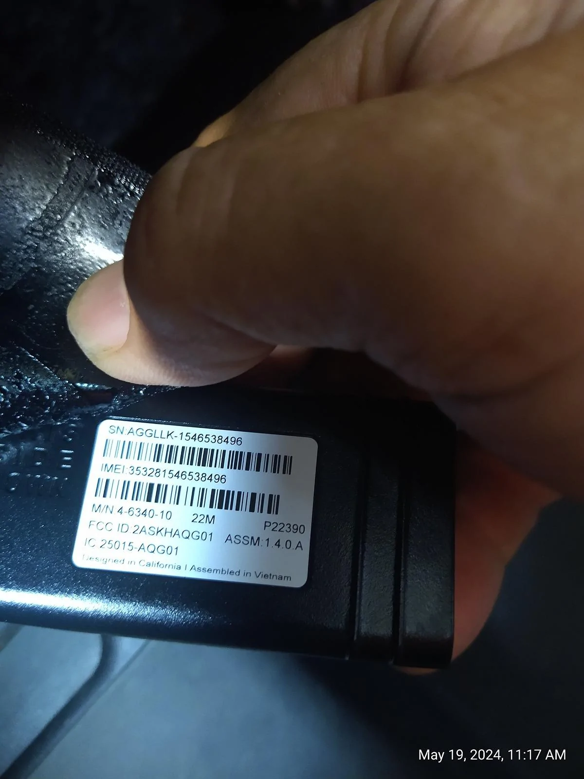

Hello All,
I found this on the other end of my cable that looked similar in my 23 Mav.

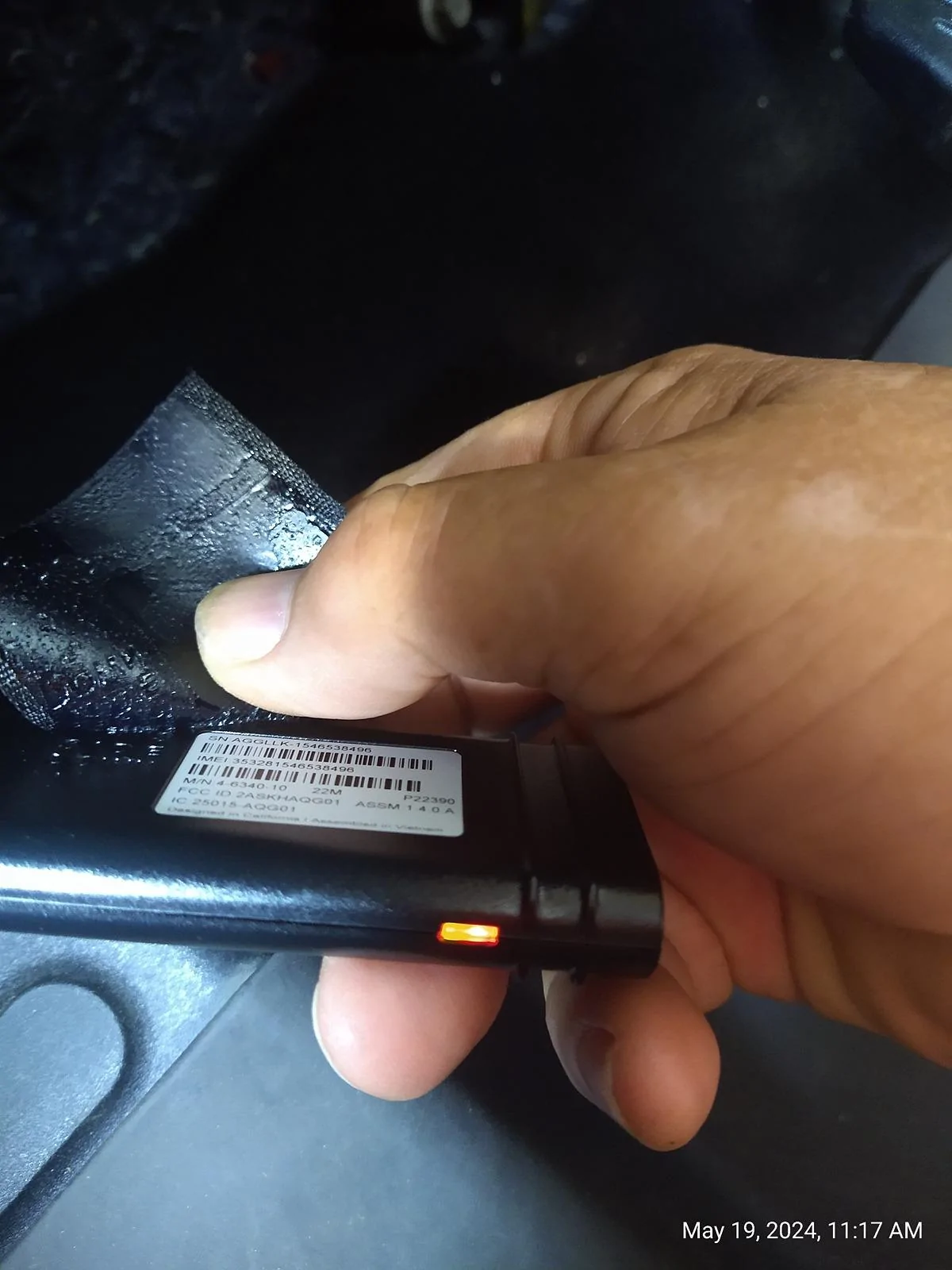

It was powered up continuously when I found it attached on the underside of the dash below my steering wheel with Velcro and the led lights were illuminated all the time until I unplugged it. The other photos show the complete OBD II port T-Dongle with a continuously powered Cellular Tracker complete with IMEI number and FCC ID.

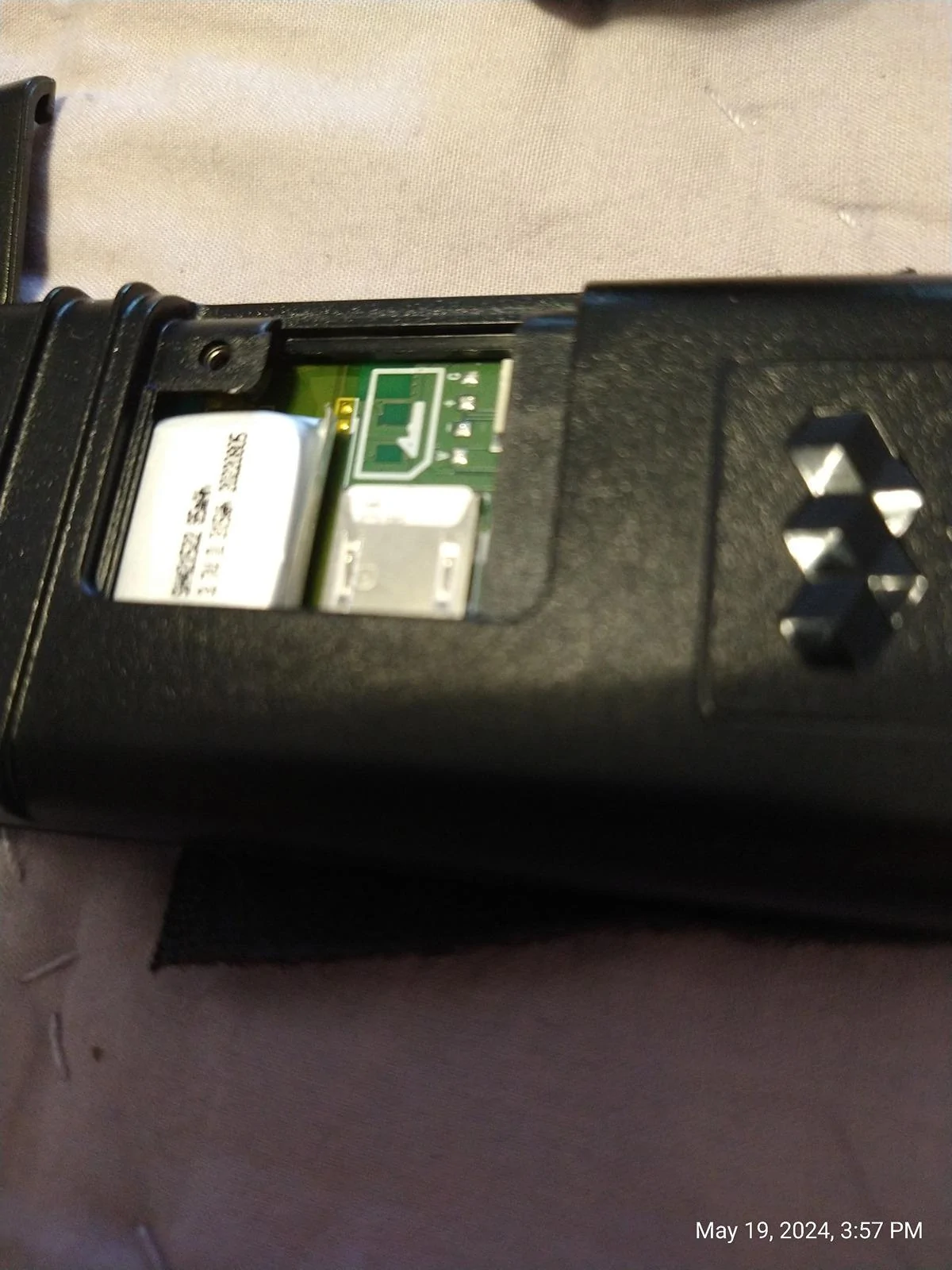

This device when I open the small cover has a SIM card inside as well.
The last file is a users manual for this device that is listed as a "Vehicle Tracking Device".
I did not finance this Truck so I am surprised this device was on my Truck and active or continuously powered up.
I proved this by unplugging from my FOMOCO Stock OBD port and the led light went dark. I then plugged it back into my FOMOCO Stock OBD port and the Led illuminated.
I cut the tie wraps loose and had a bitch of a time getting the dongle out of the stock location and unplugged this dongle from my FOMOCO Stock OBD port and and reinstalled the FOMOCO Stock OBD II port in place.
I have not had any problems with my truck since this.
The left nut on the mounting area is very difficult to remove, but you can do a search on here and there is a documented how to remove the hood release handle and the trim to get to it, or just find this little device and unplug it.
I feel like this is just one of the many parasitic 12 Volt battery draining things that affect many Ford and other vehicles that could be avoided.
Comments and Questions are welcome.

Hello All,

Holy crap. Thanks for posting this.
Now I need to go look and see if that is on the other end of my wires. If I find a cellular tracker it’s getting smashed with a hammer and sent to Skynet heaven.
Edit: Wowwwwwwww.
Ford Maverick Anyone know what this wire is for/supposed to connect to? processed-79A45E44-DB80-4A16-9E8B-77B62714CE35

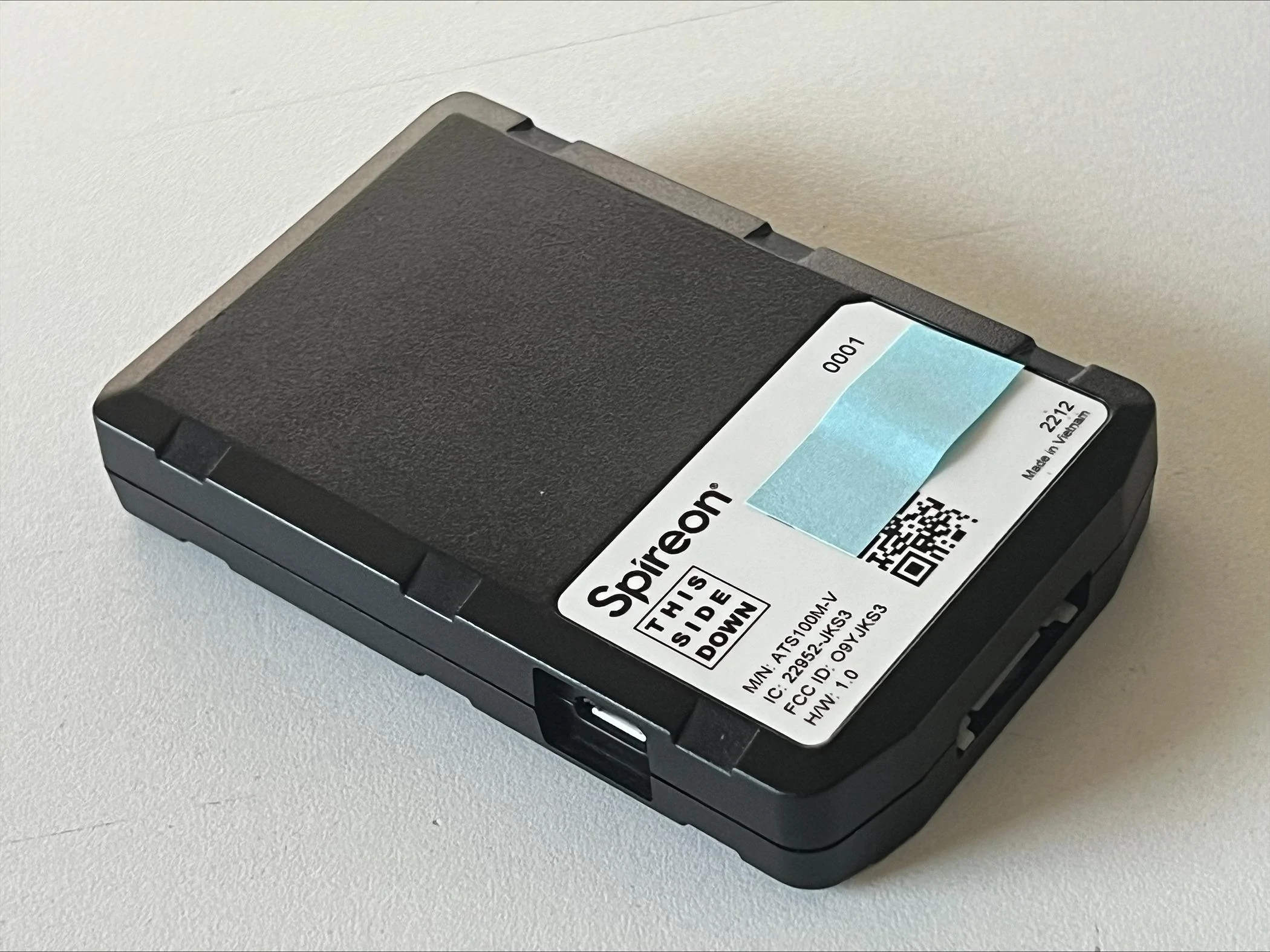

It's a damn Lojack. One that wasn't promoted, or requested. I'll give it a while before I smash it, but it's harmless for now. https://www.spireon.com/wp-content/uploads/LoJack_ATS100_InstallGuide_OBDII_0521-1.pdf

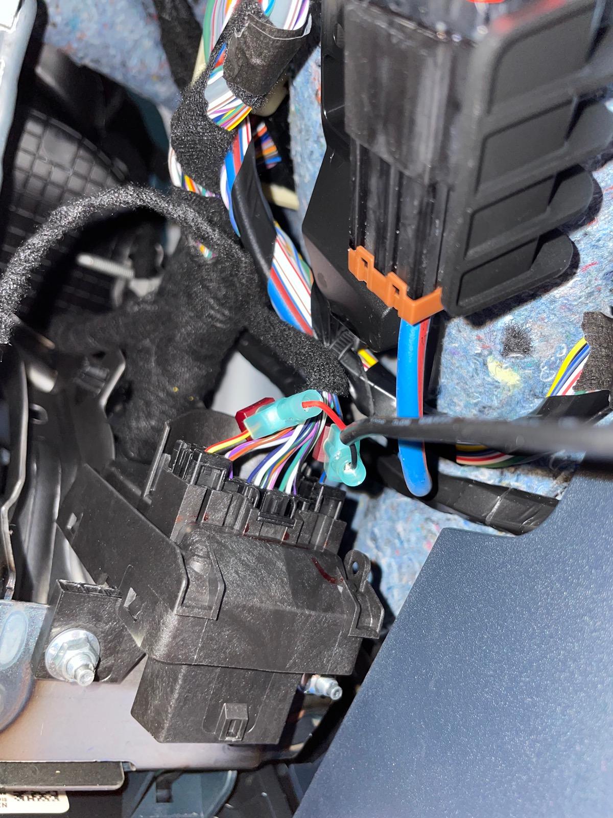

If you pull off the driver side trim at the end of the dash, that's how I got to mine. It was just velcro'd up in the dash cavity, with the slack wires coiled around a metal brace. Not at all an OEM way to do things.

Just a guess but maybe for a trailer break controller connection for the 4K package.
