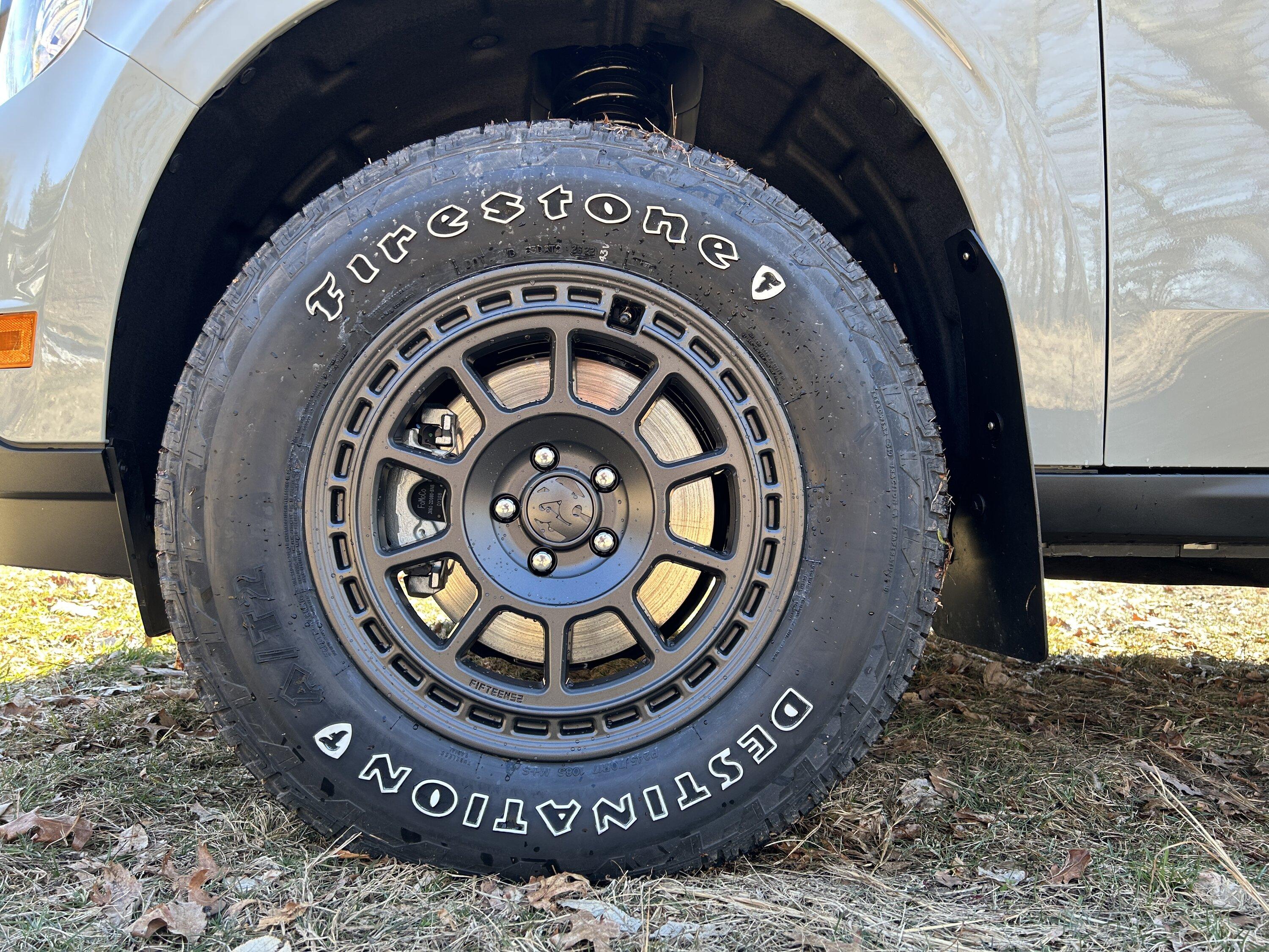

I’m running 245/70/17 tires on my lifted truck. Proper inflation for these tires on my Maverick is 27 psi. Problem is the truck gives me a constant low tire pressure warning.
I can clear that by adding more air but the ride is so much better at 27 psi than 35 psi I really don’t see that as a permanent fix.
I tried to make some changes to the TPMS settings in the BCM module but the system wouldn’t accept any of them when I tried to write the changes.
Anyone with more FORSCAN knowledge than me know if this can be done and how to do it?
