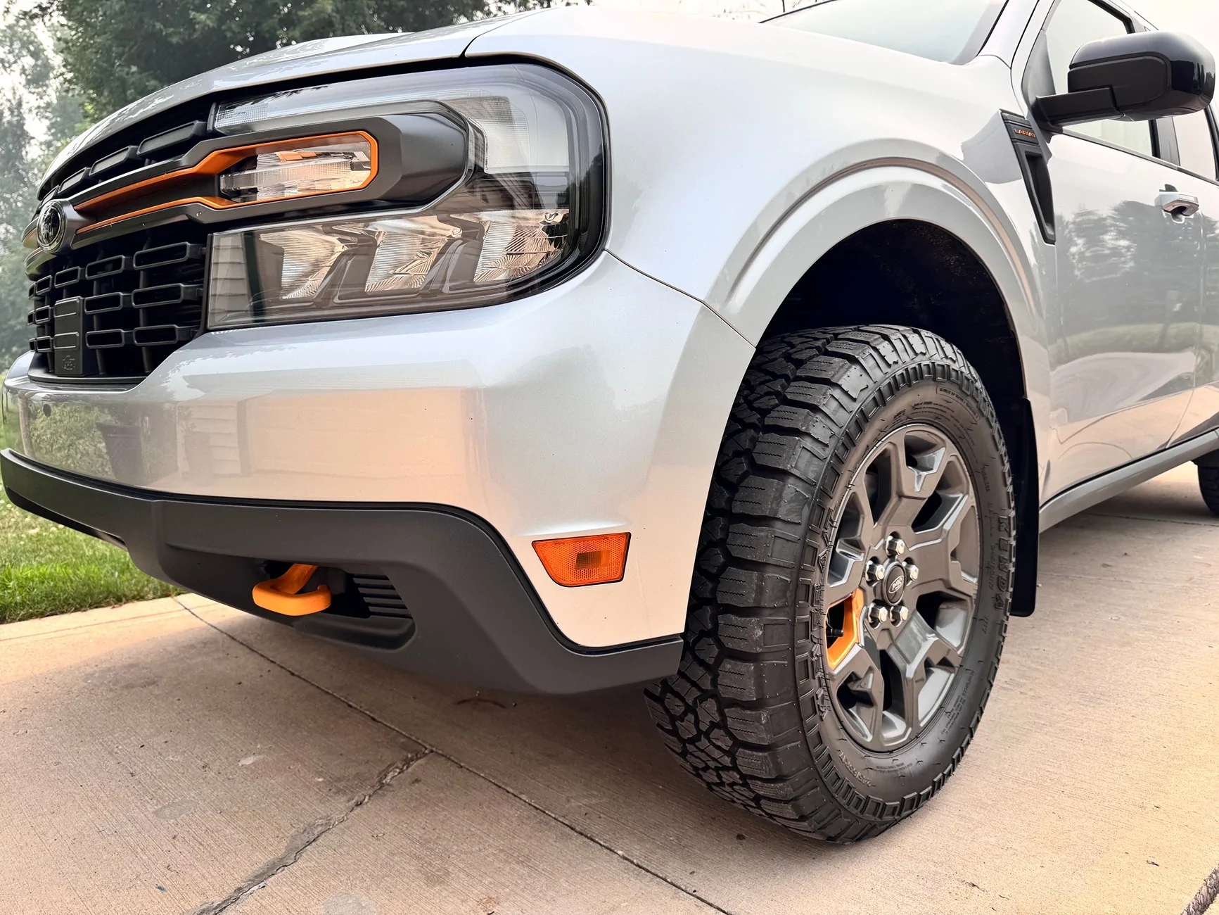

245/65R17 Kenda Klever AT2-- No rubbing at all lock to lock an light offroad. They fill in the Tremor stock lift very well. The 245/70's -75's will rub for sure or very close to it on the road snow an mud lock to lock turns large bumps etc.
That’s what I was afraid of. Thanks for the info. Don’t get me wrong. I’m ok with the Michelins. No snow in my locale and I still have several thousand miles on the tires. Just looking ahead while not under pressure.
