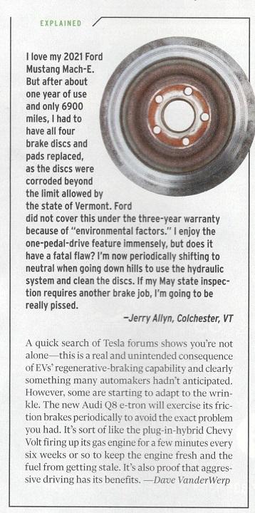

I have a similar problem on my Mach-e becasue I use 1 pedal drive. Even if I switch over to two pedal drive the regen is so aggressive that it usually isn't enough to knock the surface rust off the rotors.
Once a month I head out to a long stretch of back roads then get up to speed and put the vehicle in neutral and do some braking. I do it a couple of times then call it good. Sounds excessive but it is the best way I've found so far and it is the recommended way to keep the rotors from getting worse.
I subscribe to Car & Driver and they had this little blurb about it a couple of issues back.

The state of VT is insane with their asinine regulations concerning rust on the brake rotors. They push hard as hell as state policy for EV & hybrids and are forcing many people who drive such vehicles to actually have to have a brake job every inspection cycle (one year) due to rust on the rotors being more than 1/4" long. Not a typo, that is 1/4".
Not going political here, just suffice to say there is one segment of society here that wants their cake and eat it too and one thing I have learned in my almost 75 years is life don't work that way. :D
