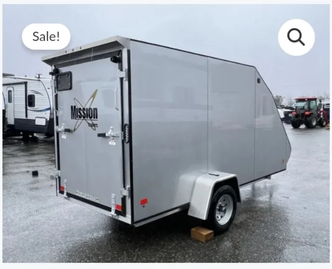

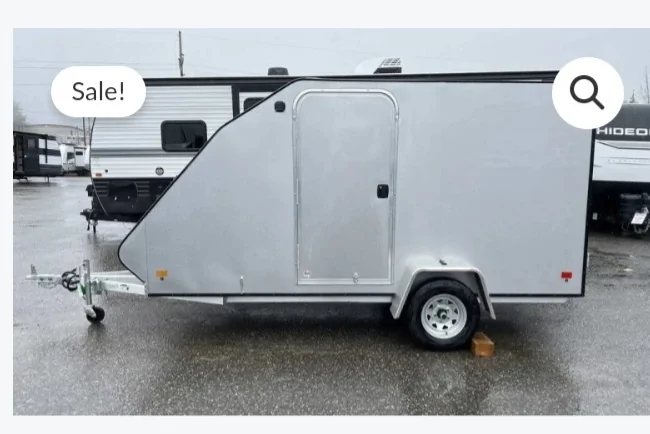

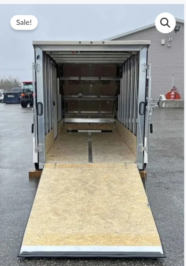

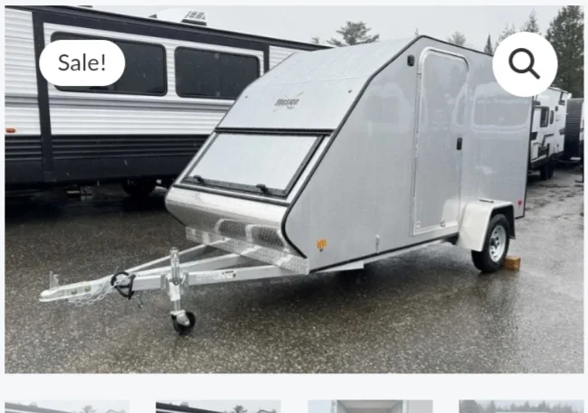

I’m toying with the idea of purchasing a 5 x 12 aluminum crossover trailer and converting it into a camper. It is a bit taller than my Maverick (WHICH I ORDERED YESTERDAY BECAUSE THE FOURTH WAS WITH ME!!! - ahem, I guess I needed to shout about it!). I know wind resistance oft plays a bigger role than weight in lost fuel economy when towing, but this little trailer seems like it may have minimal impact. What do you think?

Looks like a nice unit. I like it.
Please keep us updated, on your progress with it.

The things I tow with either my ram, or maverick will cut my mileage in half. Our boat is about 3000 lbs. I get lows 30,s hwy not towing, 15-16 towing. When towing with the ram i get about 20 not towing, about 10 mpg towing. This trailer looks way less that 3000 lbs ...unloaded.
.so depending on the overall weight your mileage will vary.

Good looking trailer, looking forward to seeing your conversion pics.

It looks like a nice aerodynamic lightweight trailer.
I didn't see that it had brakes, and depending on how much you load it (rated at 2200 GVWR) you could be over limit in some areas for trailer brake requirements.
IMHO trailer brakes are a very good to have as they can make a big difference, even if they are not legally required, when you are in a situation that requires a panic stop.
