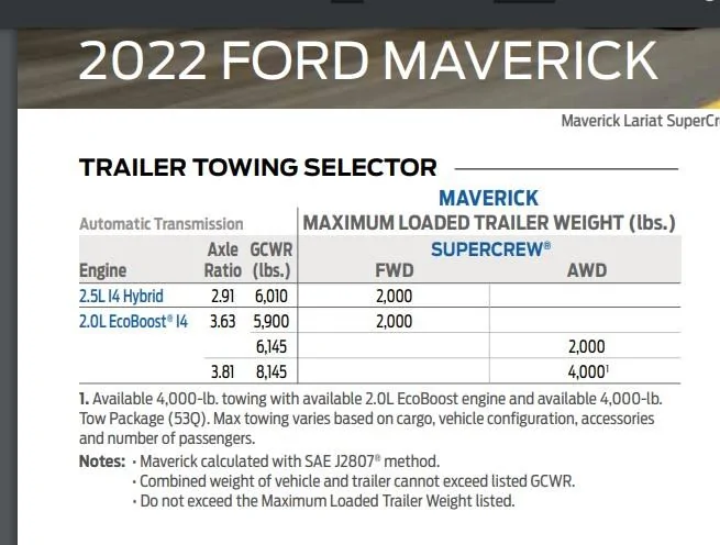

I am getting an AWD EB Lariat WITHOUT the 4k towing package. I know the bed can haul about 1500lbs, and it can tow 2000lbs. My question is, do you combine those two numbers if you're pulling a trailer AND carrying items in the bed? I know you need to subtract for the weight of the driver and passengers, but for arguments sake let's say I weigh 0lbs. That would mean I can pull a 2000lb trailer AND carry 1500lbs in the bed at the same time for a total of 3500lbs, correct?
