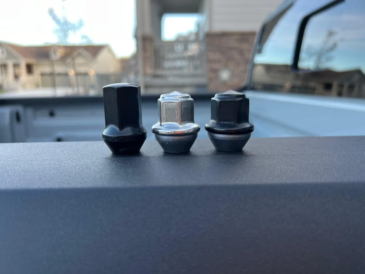

Hopefully, my mistake helps some folks. I recently bought a Tremor and wanted to replace the chrome lug nuts with black ones. Initially I bought the Gorilla nuts that people on the forum were using but they’re too long. I wasn’t going for that long spiked lug nut look that some of the semi truckers annd dullies do. :cautious: After that I found a company called Threadstrong that sells black stainless steel nuts and they’re US made(!). They’re a matte black and the quality seems good. No nicks or scratches when I received them and no marks from installing. I’ve mostly always used Gorilla lug nuts in the past but I kind of think these are nicer. Some pictures below for reference.
From left to right: Gorilla 61148FSBC, OEM, Threadstrong
Ford Maverick Another black lug nut thread (especially applicable for tremor wheels) IMG_1987

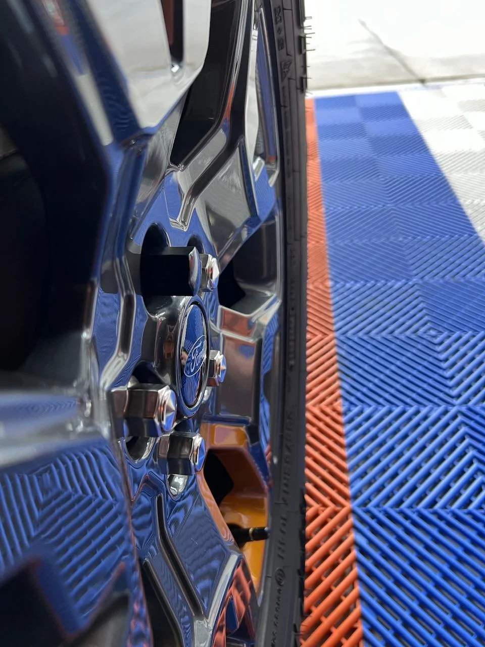

Gorilla 61148FSBC - look how far that sticks out!
Ford Maverick Another black lug nut thread (especially applicable for tremor wheels) IMG_1892

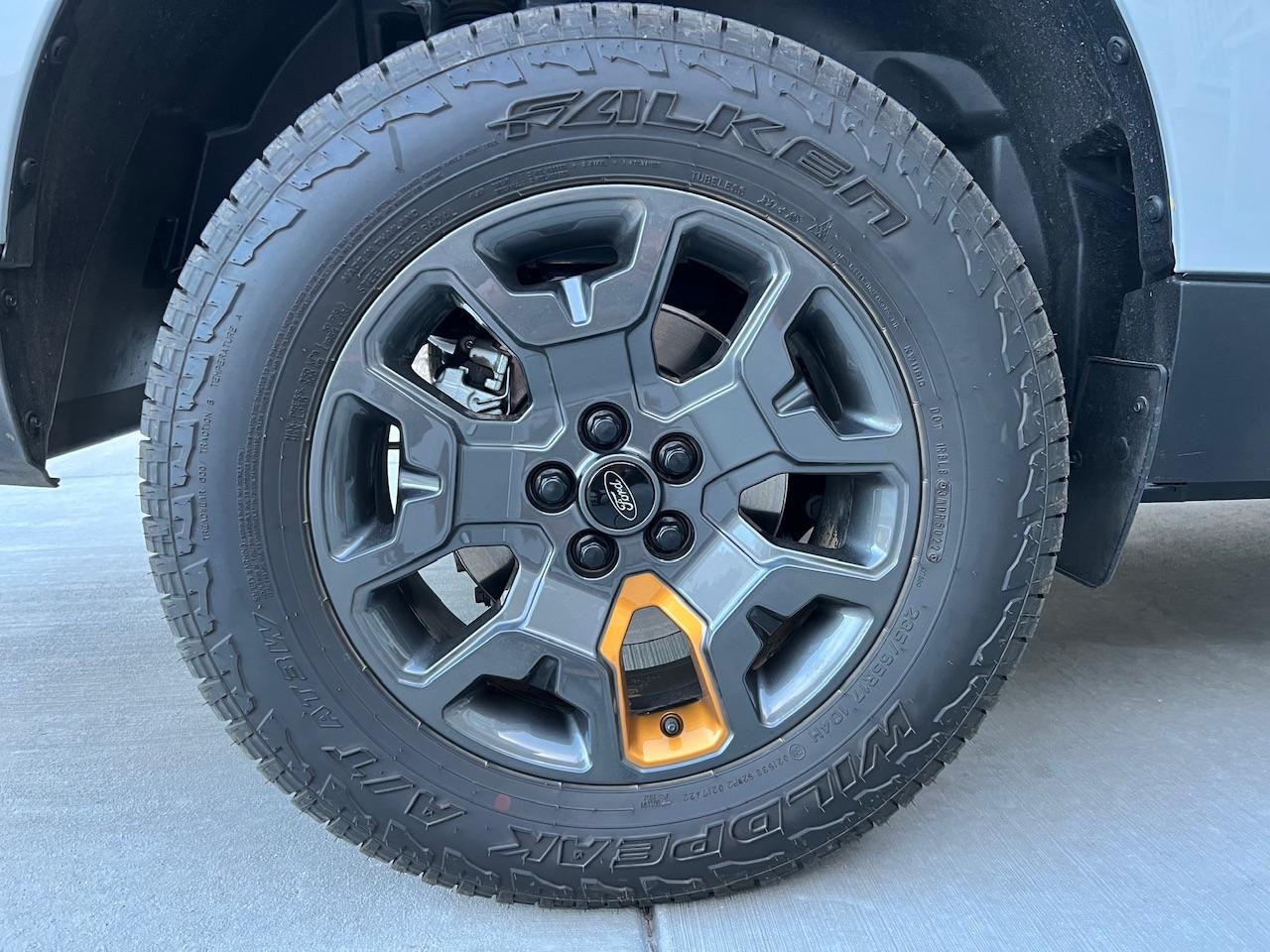

OEM lug nuts
Ford Maverick Another black lug nut thread (especially applicable for tremor wheels) IMG_1989

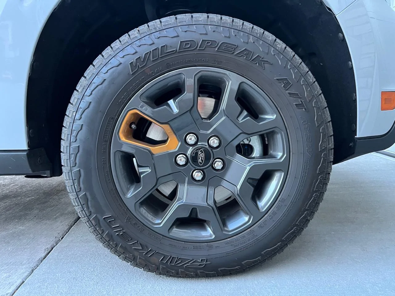

Threadstrong lug nuts
Ford Maverick Another black lug nut thread (especially applicable for tremor wheels) IMG_1988

They are still 2-piece 'clad' lug nuts as opposed to solid, correct?
thats what I was thinking of. if those are 2 piece nuts keep your impact wrench away and you'll be fine

Correct. I’ve not ever had an issue with swelling so I’m not too worried. If I do, I’ll figure it out at that time.
They claim they’re more durable, but of course they’re going to say that. Here’s some more info: https://threadstrong.us/blogs/tech-talk/black-chrome-lug-nuts-are-they-right-for-you
Edit: From what I’ve seen impacts wear all lug nuts over time and guys at tire shops typically aren’t careful which means they often nick the holes too. When I can, I prefer to mount/remove the wheels myself In order to minimize it. It’s not that much work to do with a ratchet.

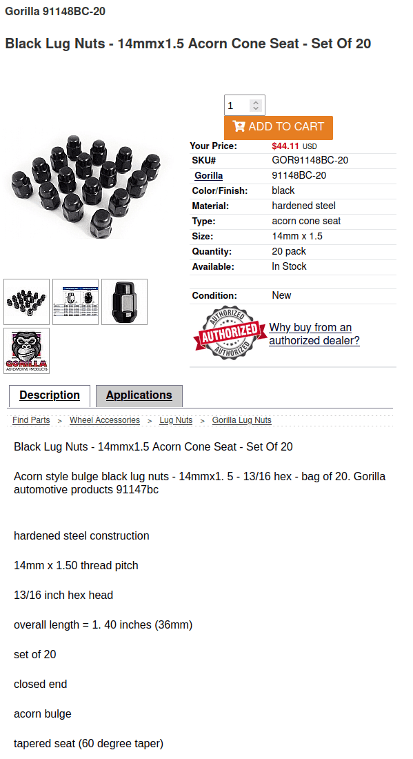

From Gorilla's catalog:
91148BC (optional 91147BCB) are the closest to OEM in size.
So, as not to advertise, just search and use the shopping option to find what I just looked at.
Note the price shown for set of 20
Ford Maverick Another black lug nut thread (especially applicable for tremor wheels) 1697605528170
EDIT: if screenshot not allowed, let me know and i'll post text only
Those are not correct, they do not have the factory style bulge, those are just standard acorn. The 61148 is closest to factory with the correct bulge.

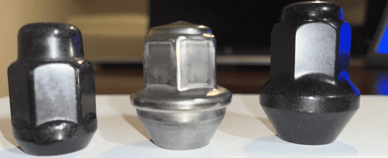

My apologies ... my info was wrong.
@kdiff and @A.Bursell were correct .. the 61148 series is the (Gorilla) match to OEM - just taller.
Left to right in the pic below:
1. The wrong lug I mentioned -91148 series. 36mm tall - probably ok for aftermarket wheels.
2. OEM from my own Maverick. 36mm tall
3. 61148 series - 42mm tall
Ford Maverick Another black lug nut thread (especially applicable for tremor wheels) 1698804948051
