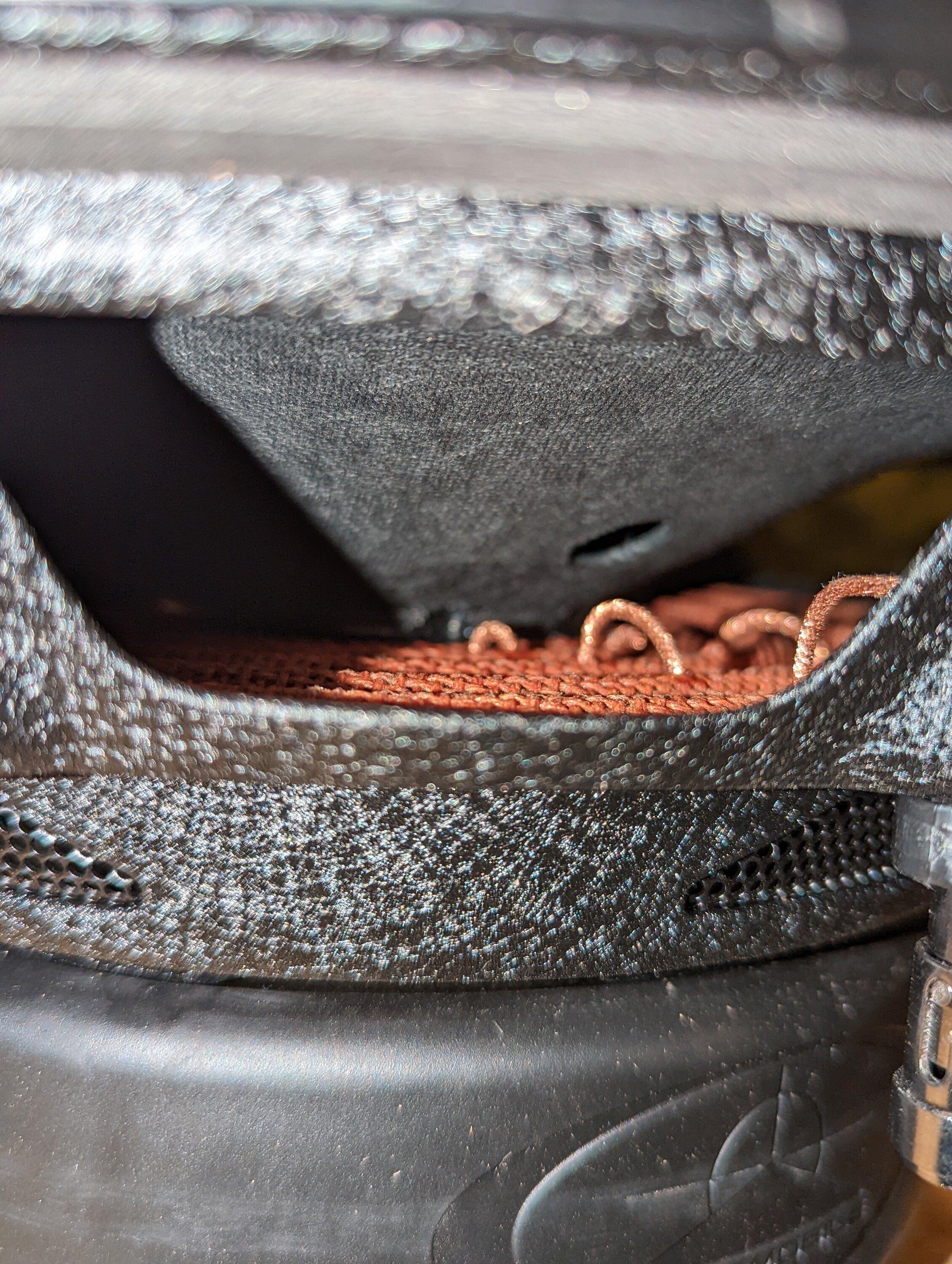

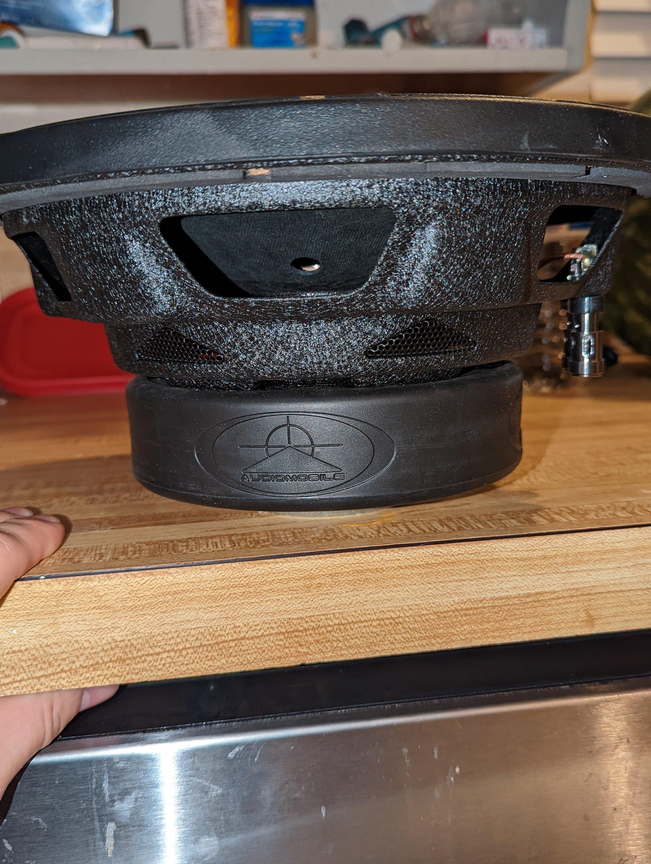

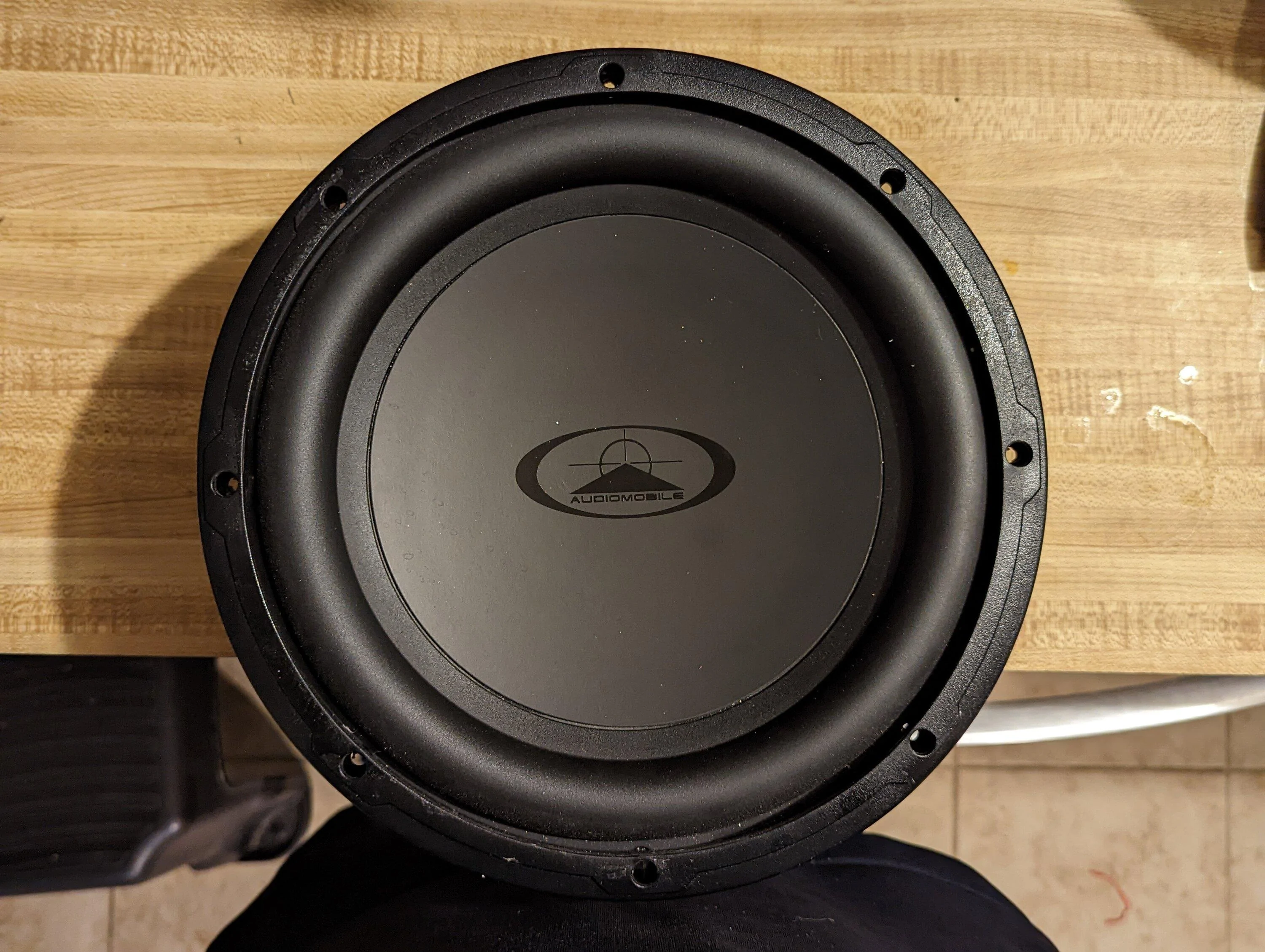

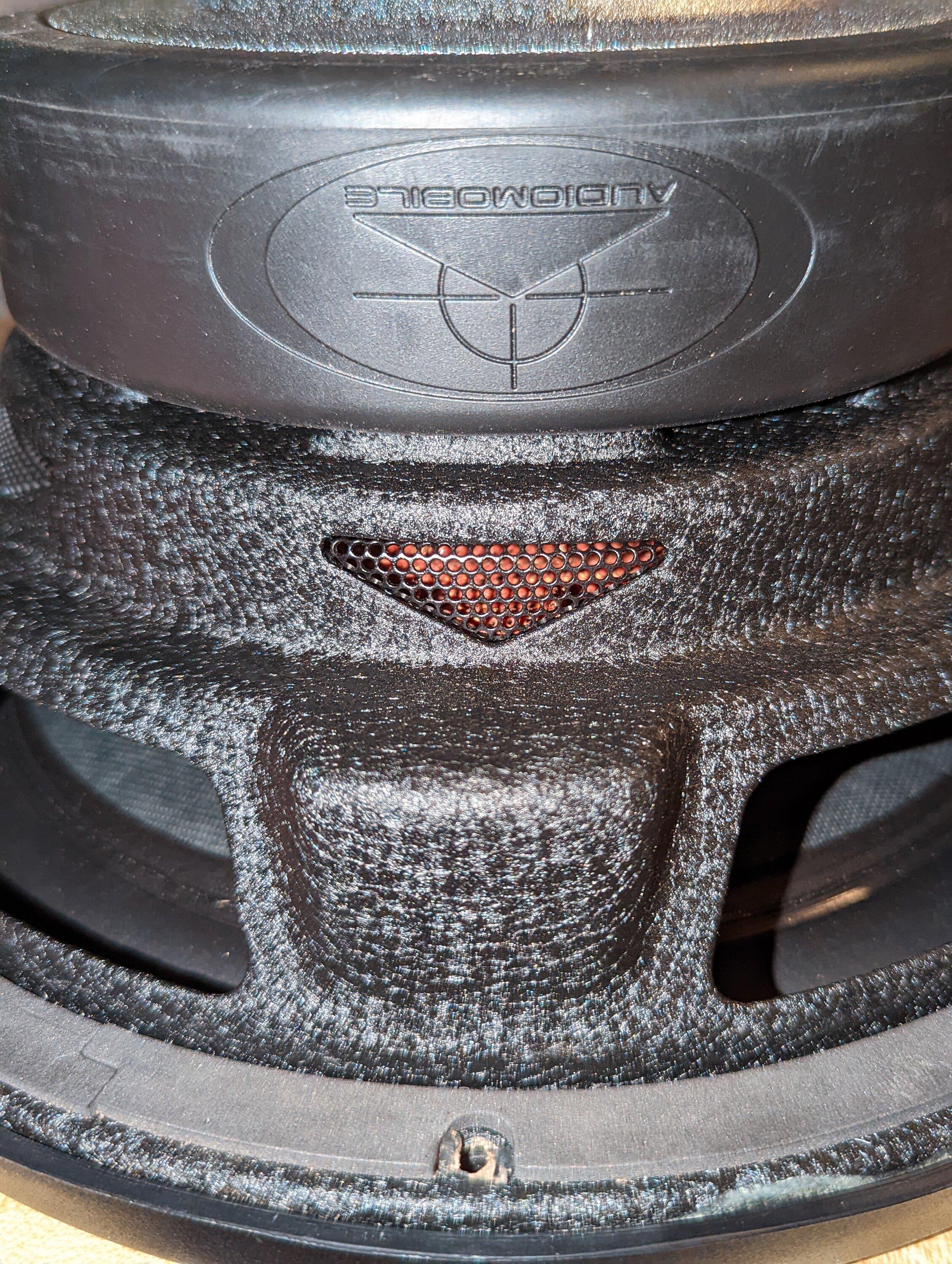

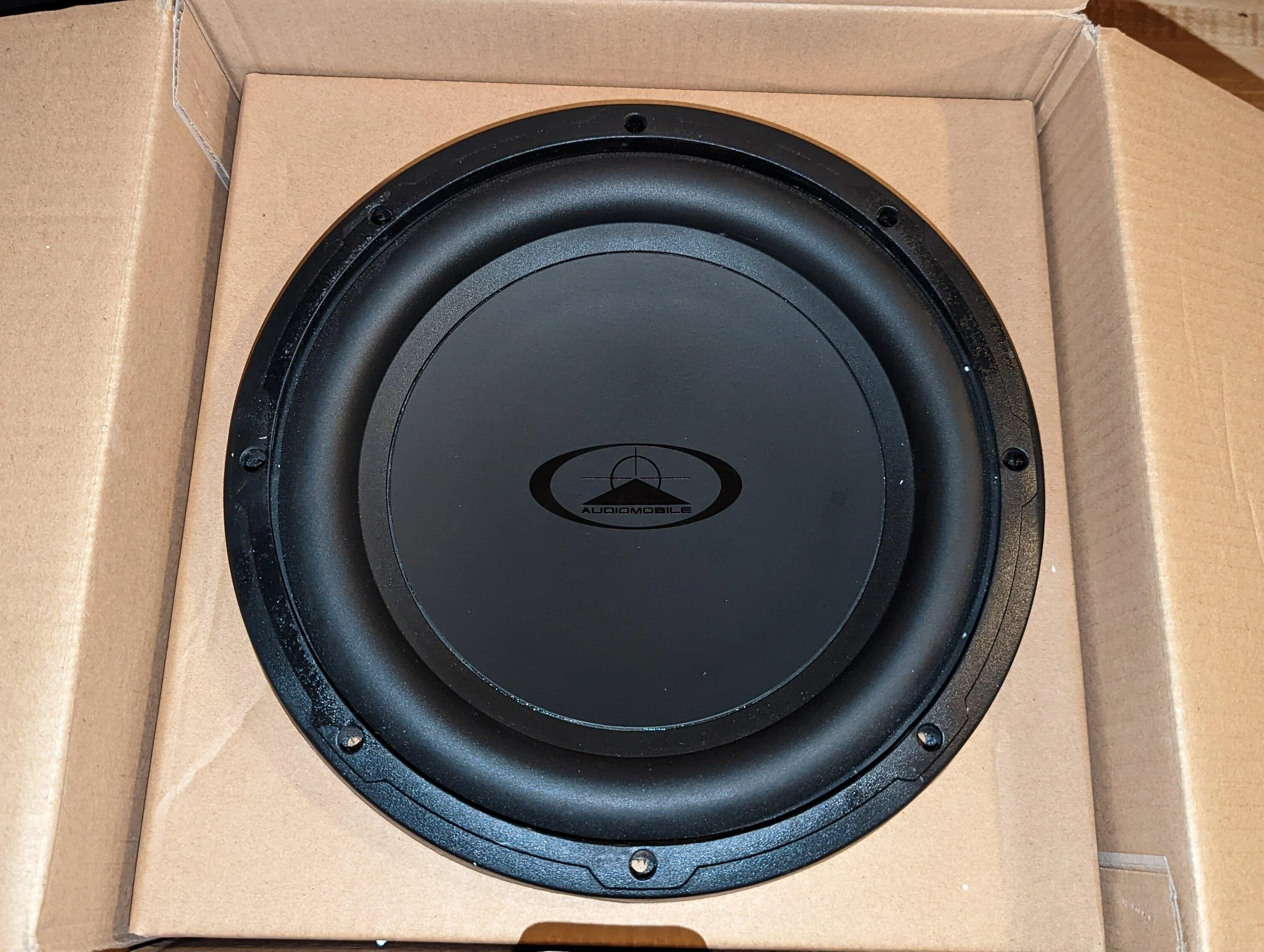

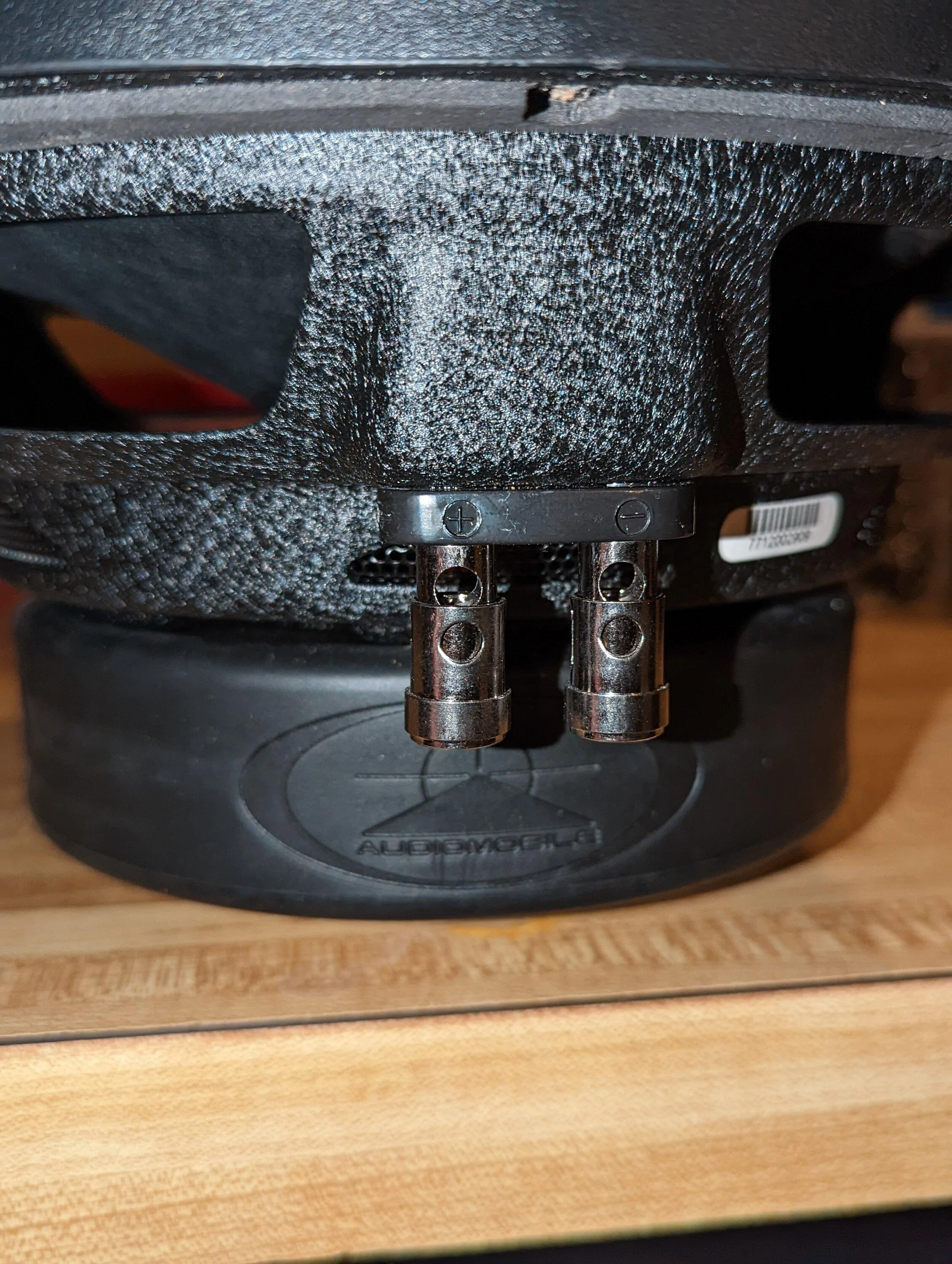

Here is the audiomobile subwoofer, I will be using two for the build. This is one of my all time favorite shallow mounts I've used most likely only behind the stereo integrity which they don't even make anymore
Nice looking sub! What’s the mounting depth on it and what size box do you need for it? I have a 10” sundown sd2 that I took out of my old truck but I’m not sure if it will work under one of the rear seats in the maverick. It’s 4 3/4 deep but also has about 1” of the rubber surround sticking it of the top and needs to be .5 ft for a sealed box. Y maverick is suppose to be getting built next week so I’ll take some good measurements once o get it.
The mounting depth on it is 4.5 so not far off from your sd2, and .5ft for sealed box as well. So you definitely should be good for getting it to fit under the back seat.
Ok. The only thing is that rubber surround on my sundown sticks out an additional 1” not sure how much room I would need between that and the bottom of the seat for movement. (Think sundown recommended over 1”) not sure how much that would affect anything if it was less then a inch. Looking forward to seeing how yours is done.

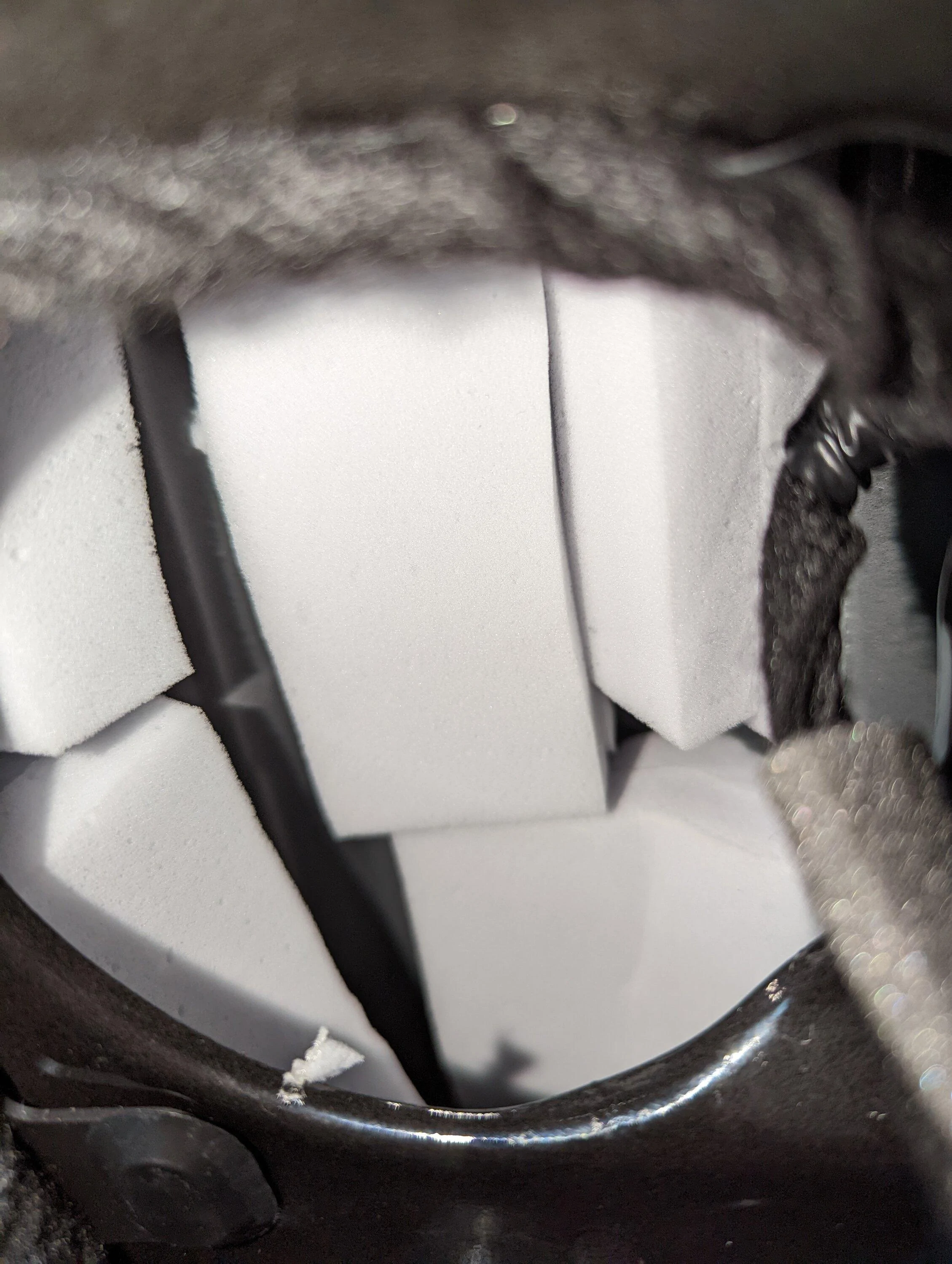

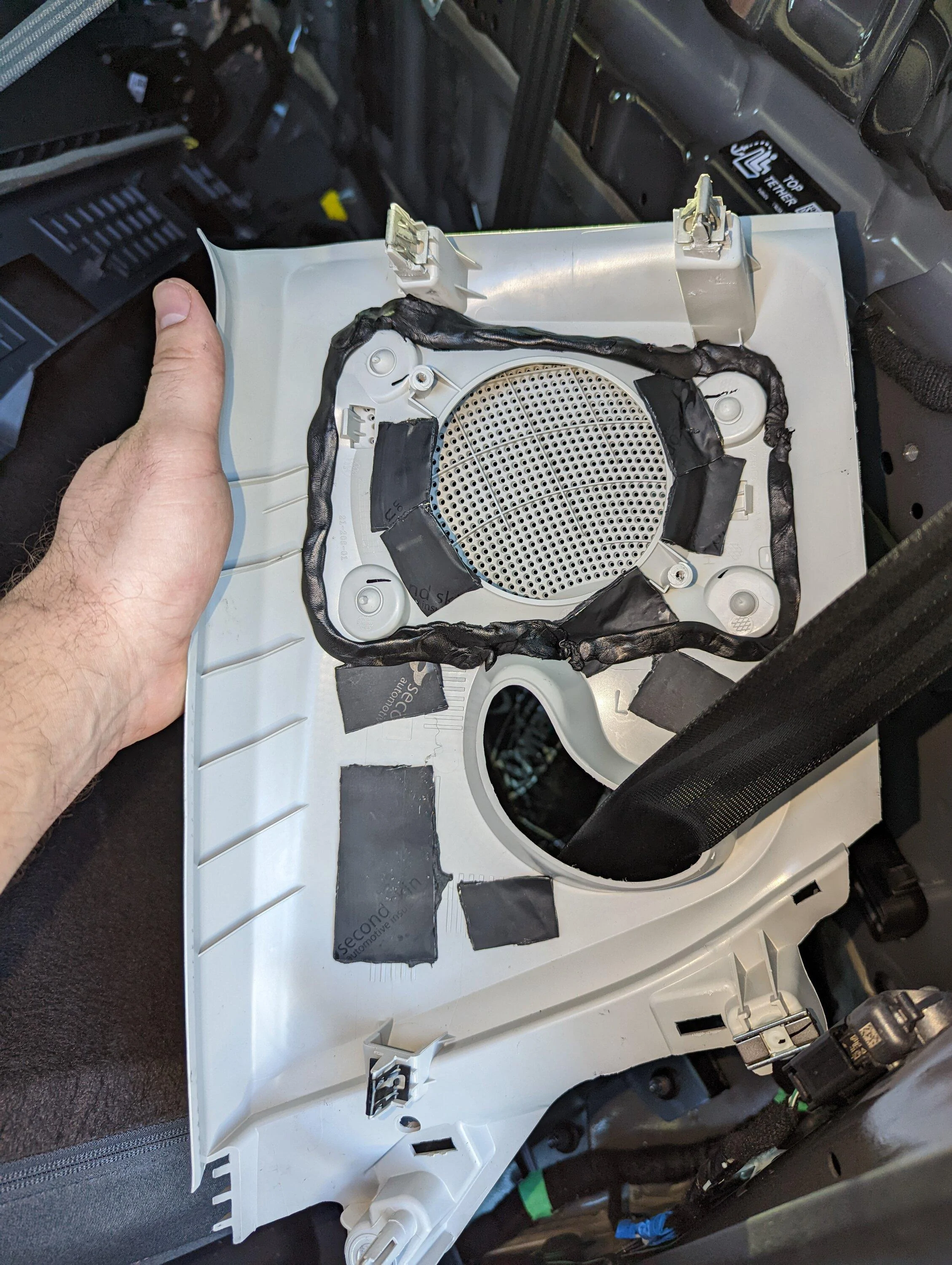

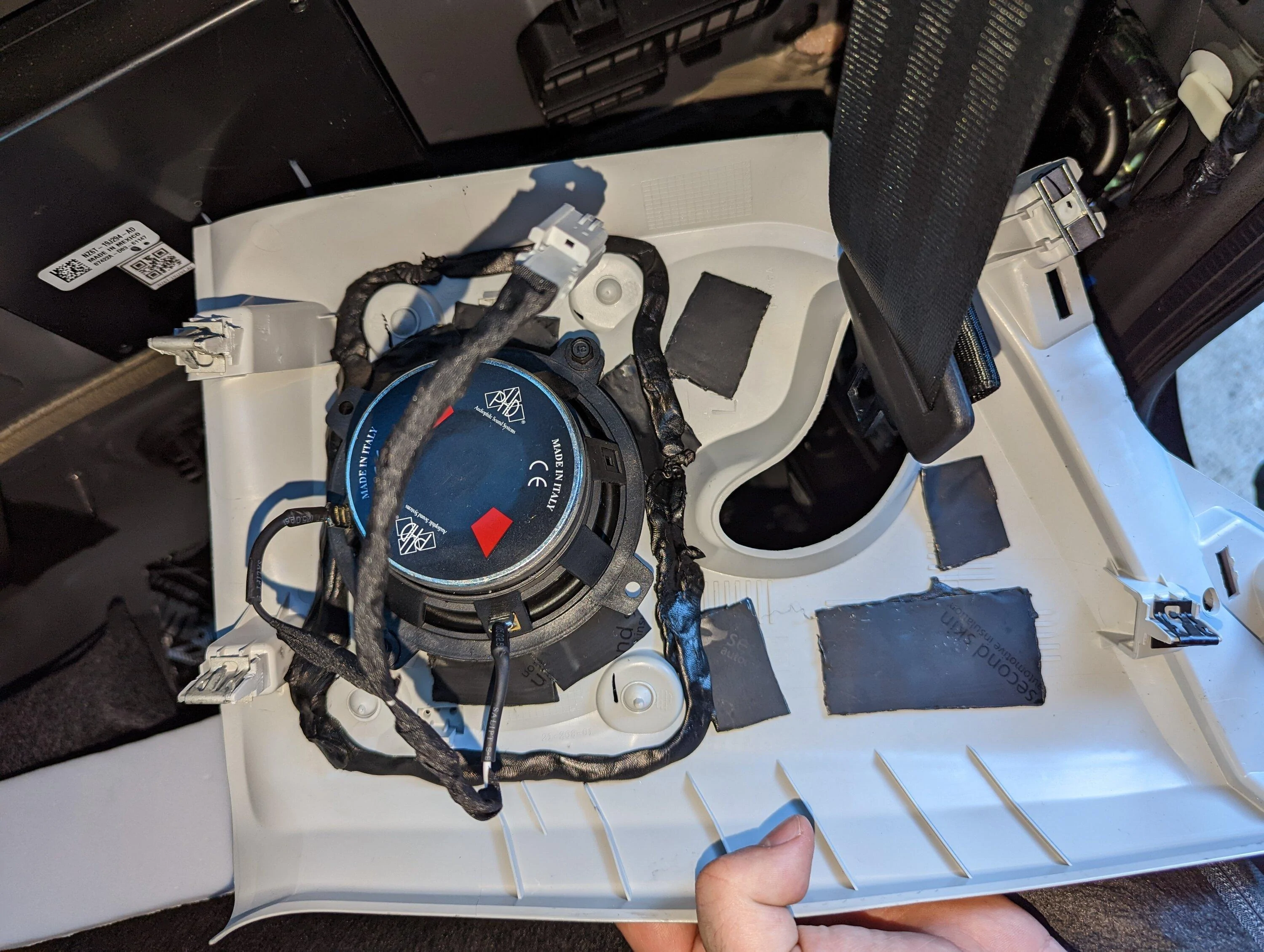

I ended up doing one side of the rear yesterday, didn't get many pictures but here is some
Ford Maverick Another audio build PXL_20220924_231230470
Ford Maverick Another audio build PXL_20220924_233334565
Ford Maverick Another audio build PXL_20220924_233341998

It's foam but I think its similar to those Mr. Clean Magic Eraser but that don't hold water.
Foam is in the D pillar, speaker cavity? Bit close on the photo just making sure that's what I'm looking at
Yes sir, that is mega zorbe from second skin, it's melamine foam which is the same thing as the magic erasers but has a hydrophobic coating on it. It helps with back waves and just further helps with sound blockage.
I will be getting more pictures soon as all the other smaller cavities will have rockwool insulation in them

Did you put this under the headliner as well? See that they sell it in sheets as well.
I was gonna do it under the headliner when I get to that in a few months but resonix just released their fibermat 45 which will be going under there, then second skin luxury liner pro for under the floor

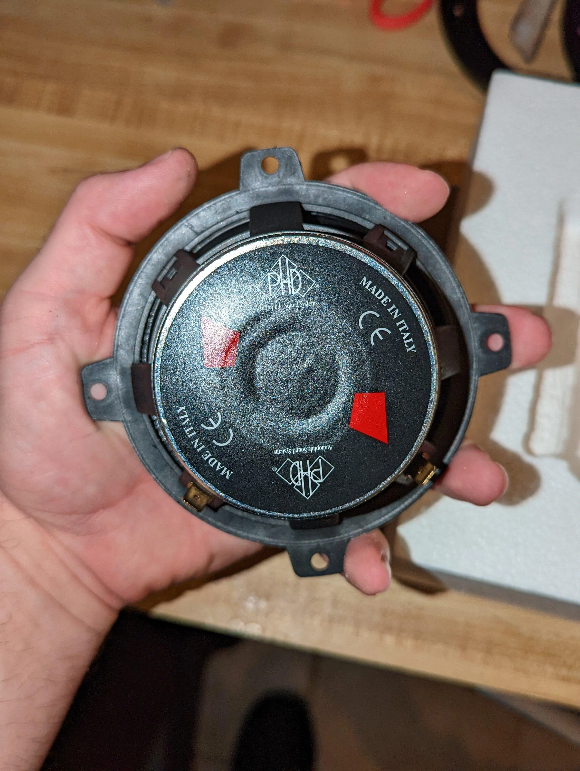

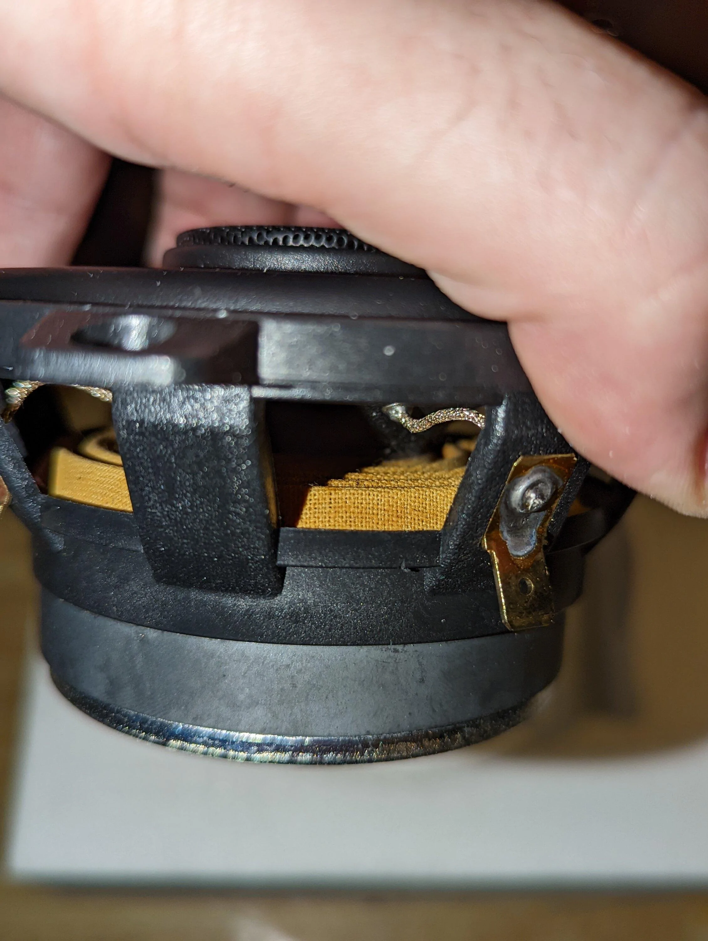

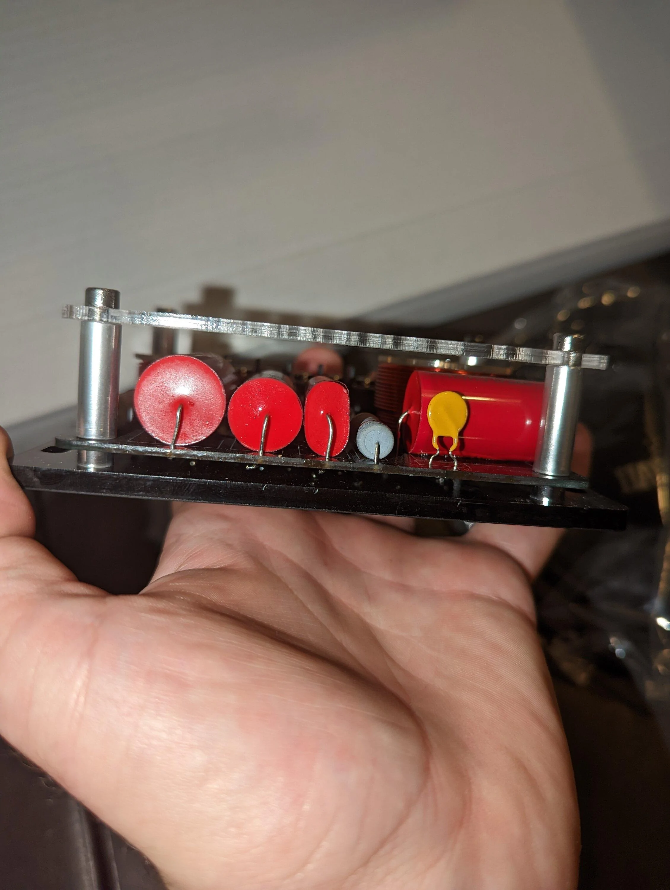

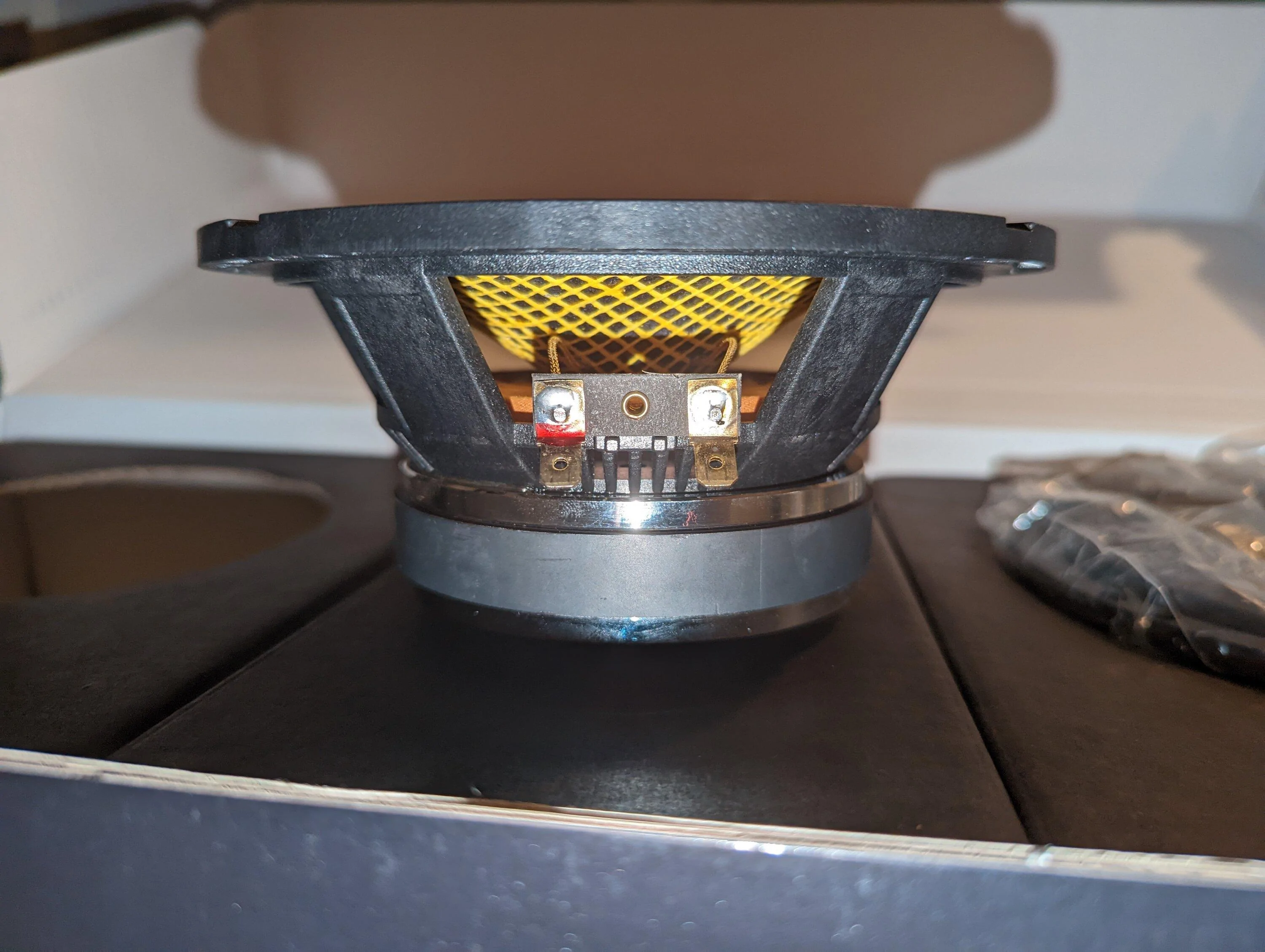

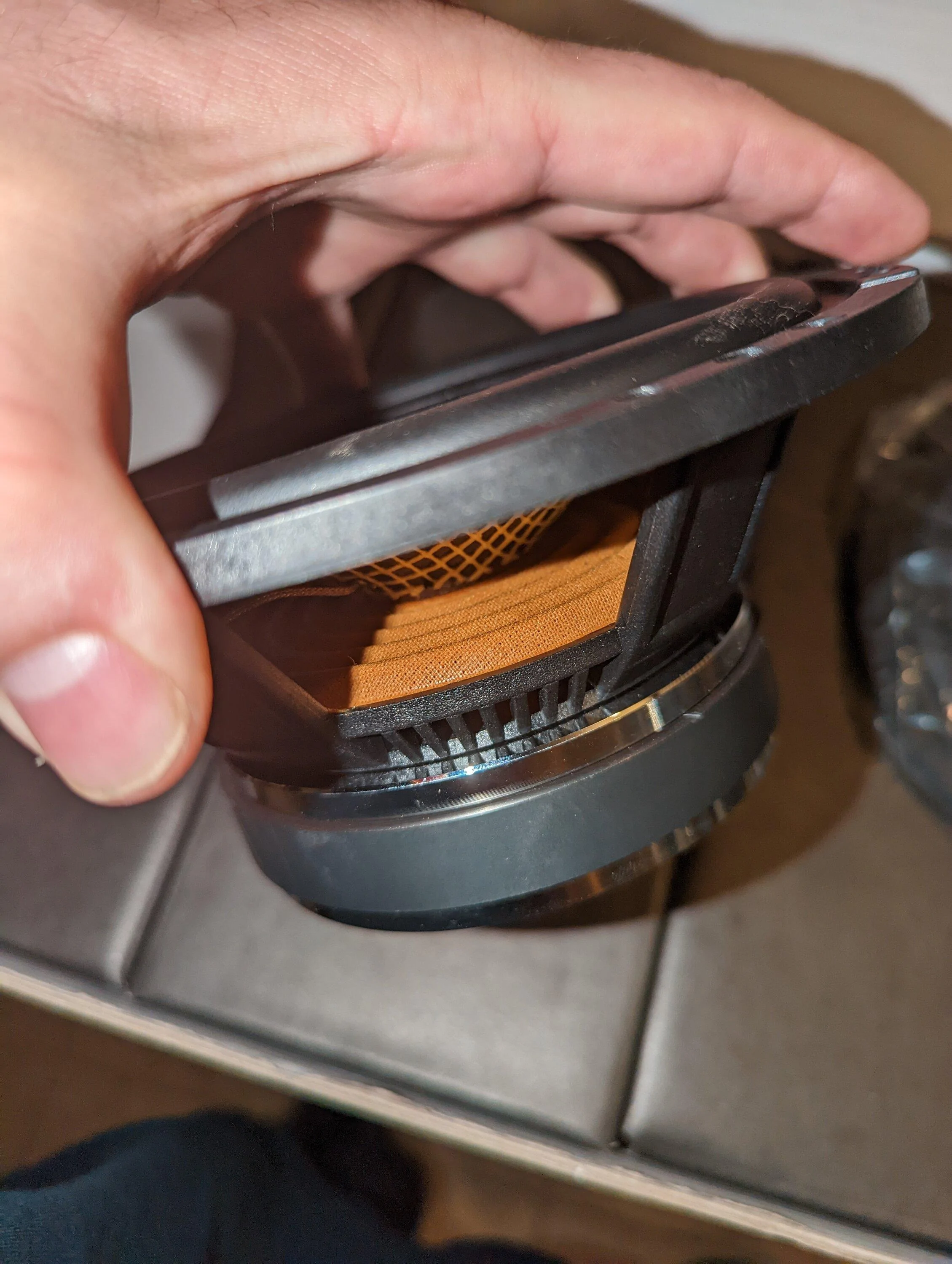

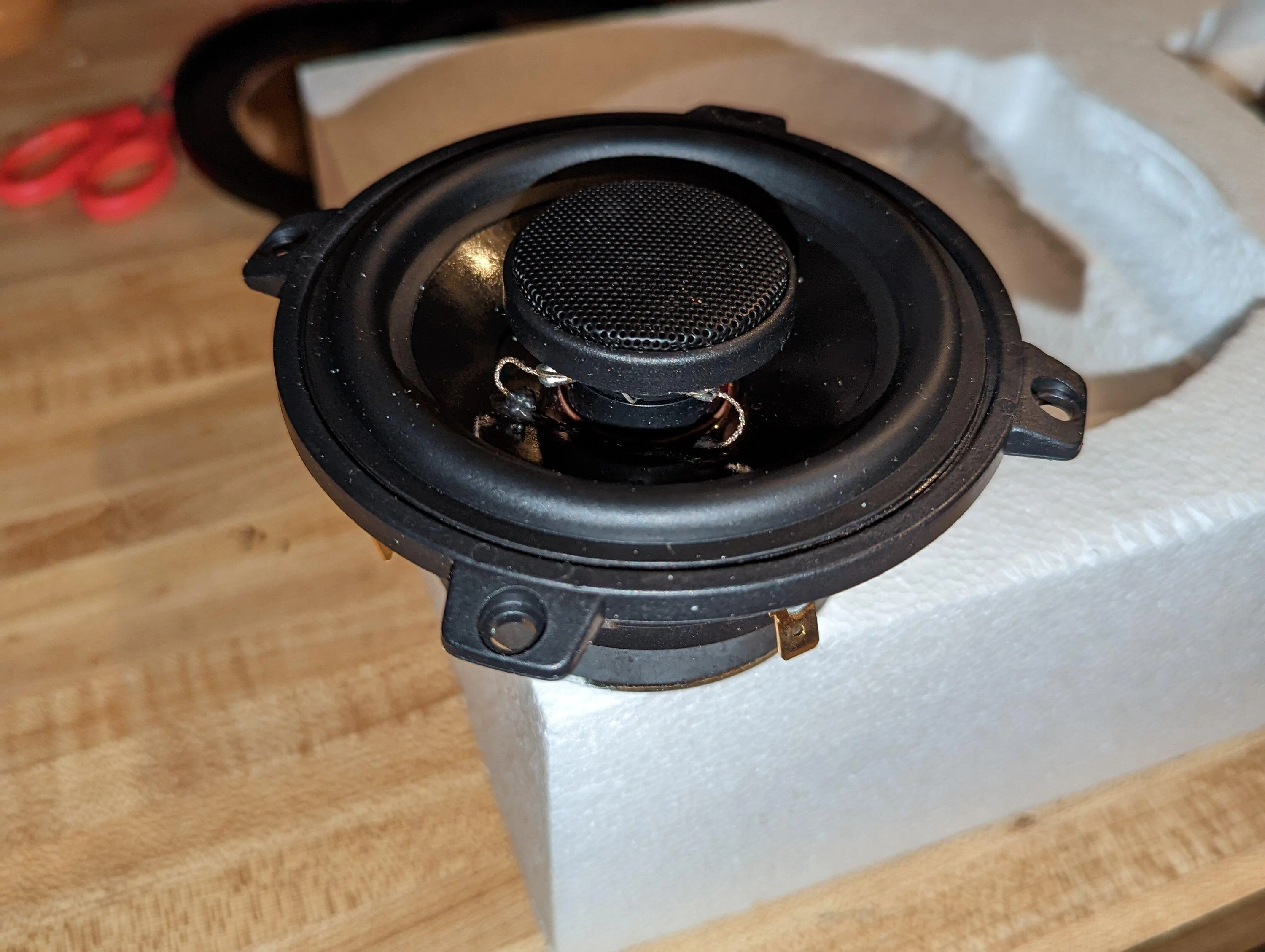

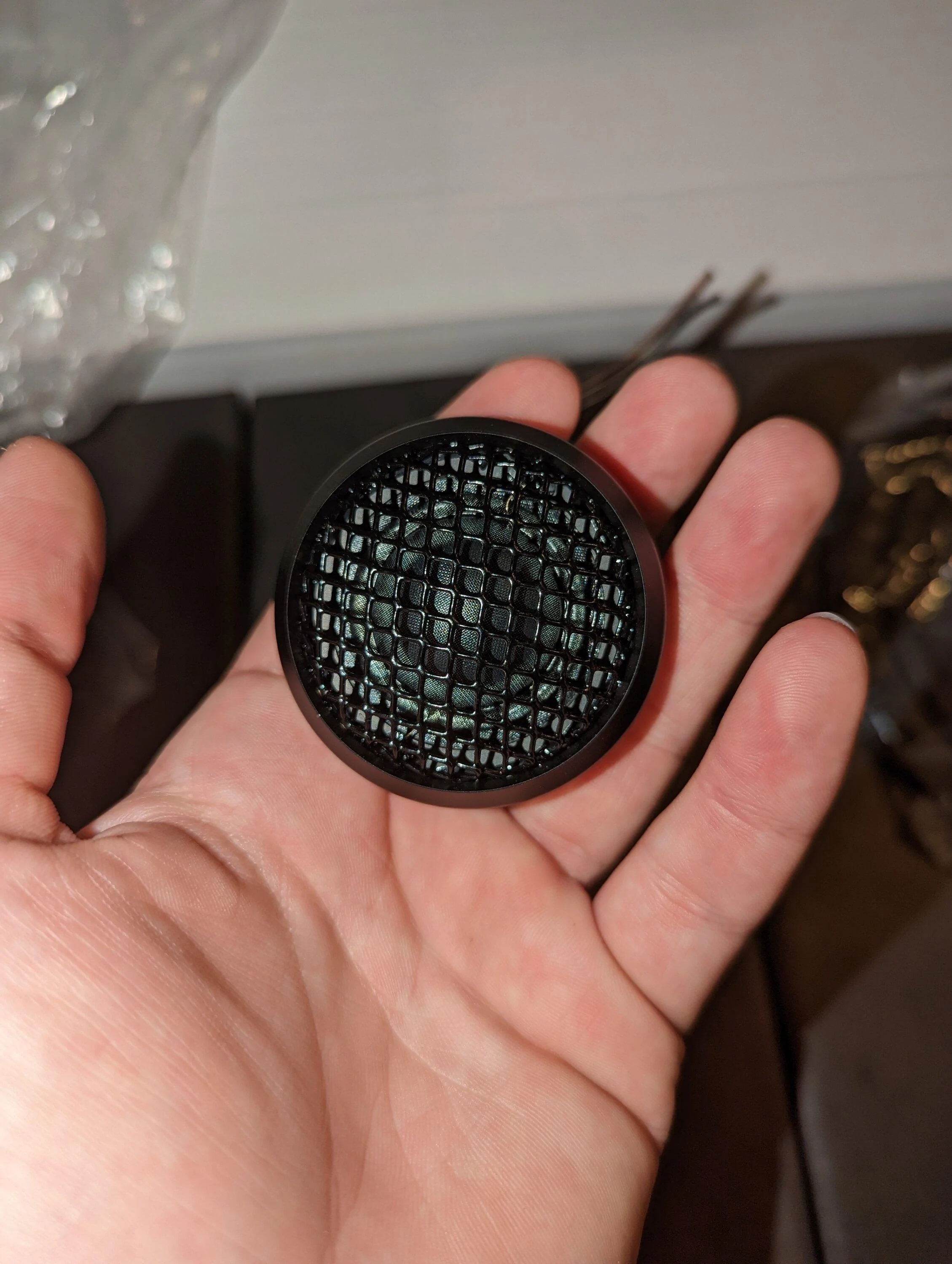

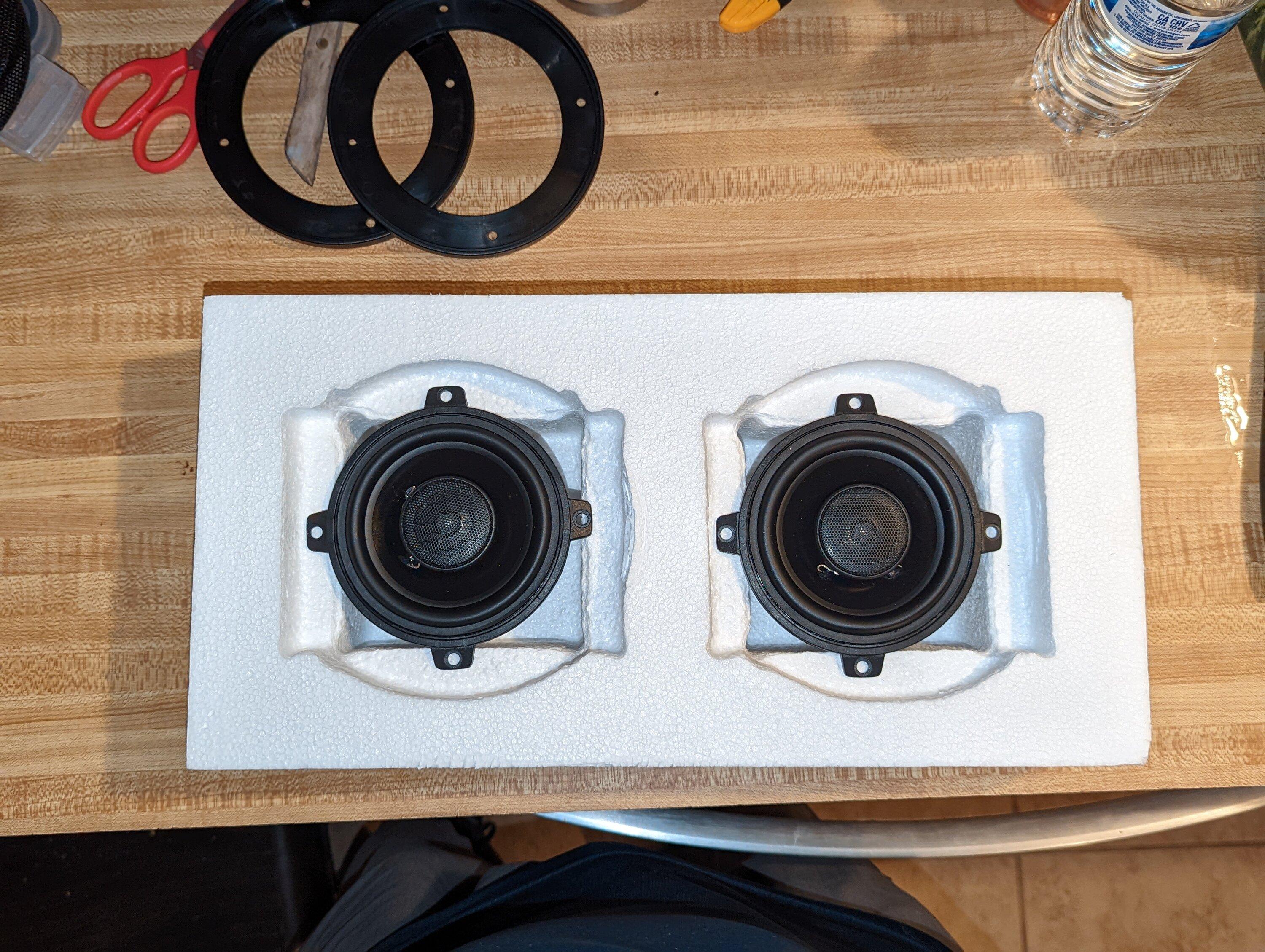

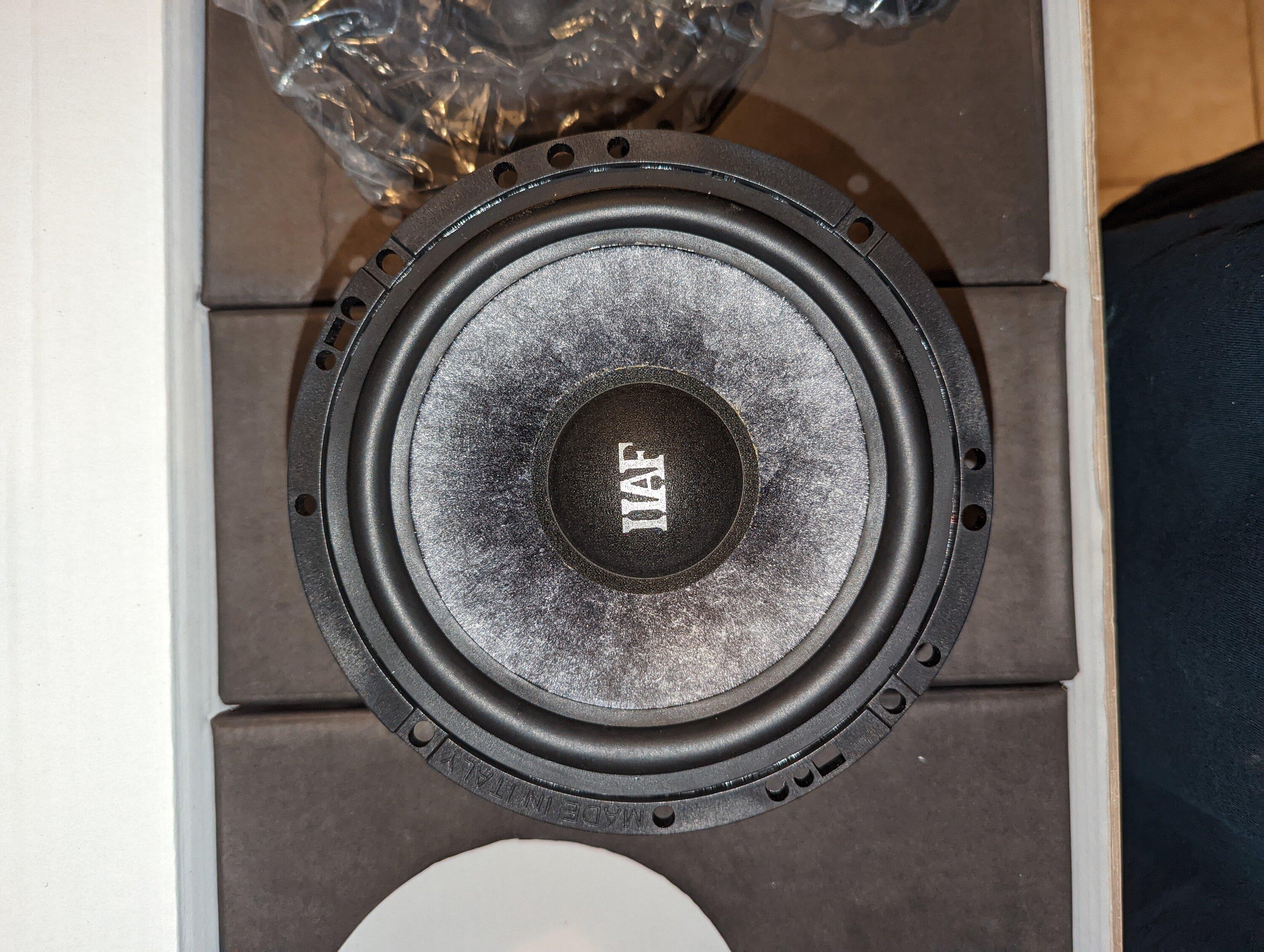

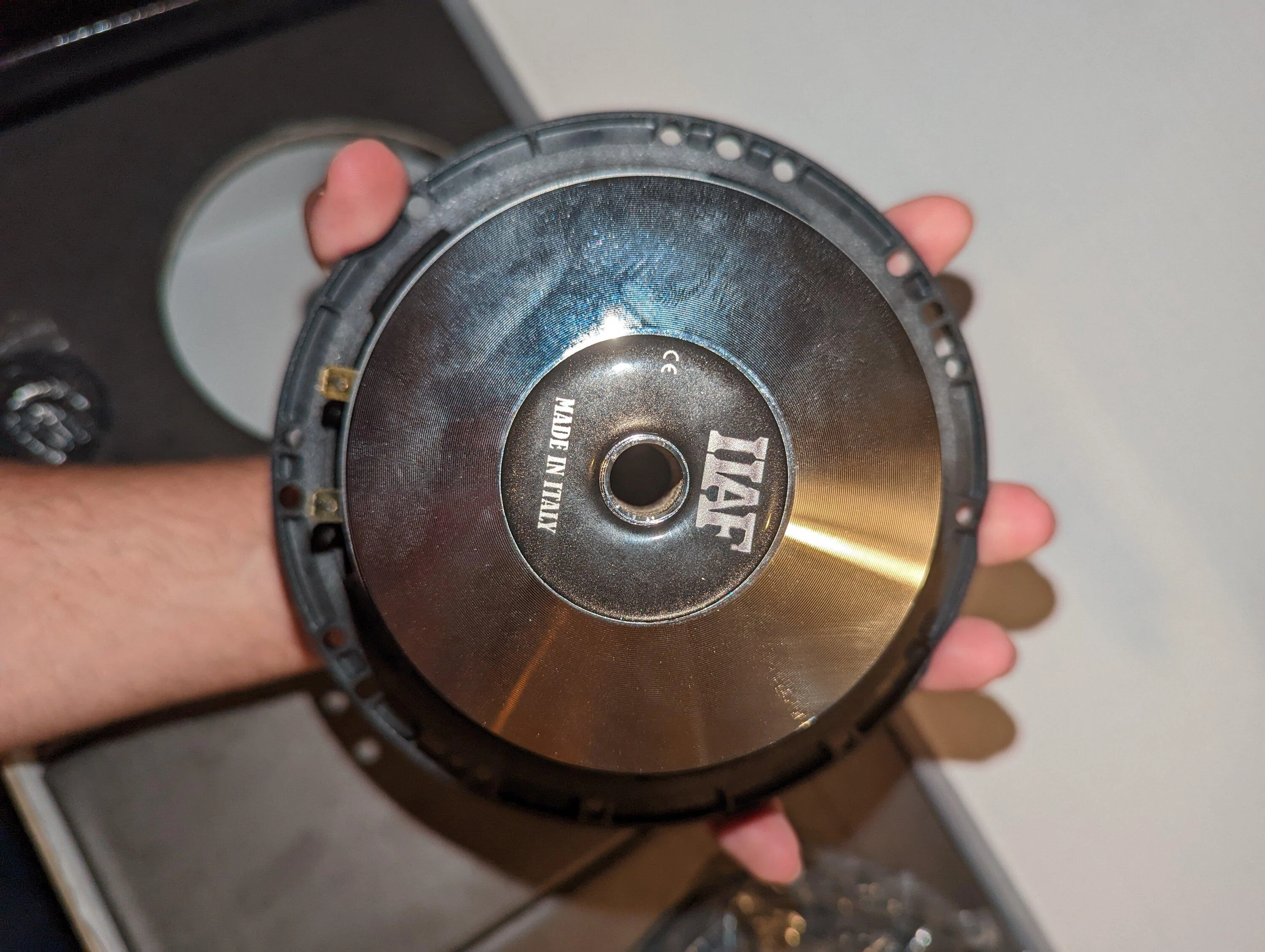

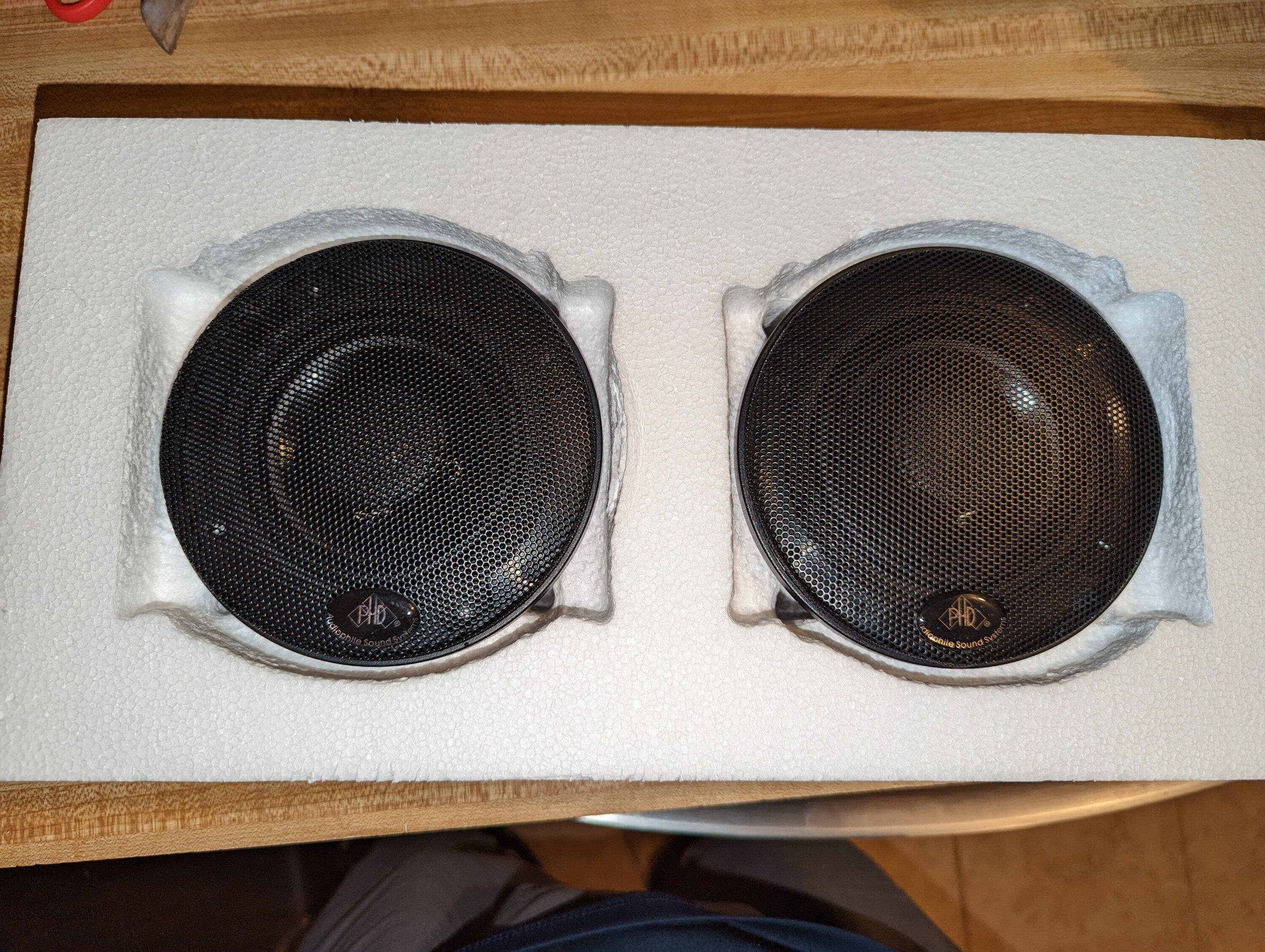

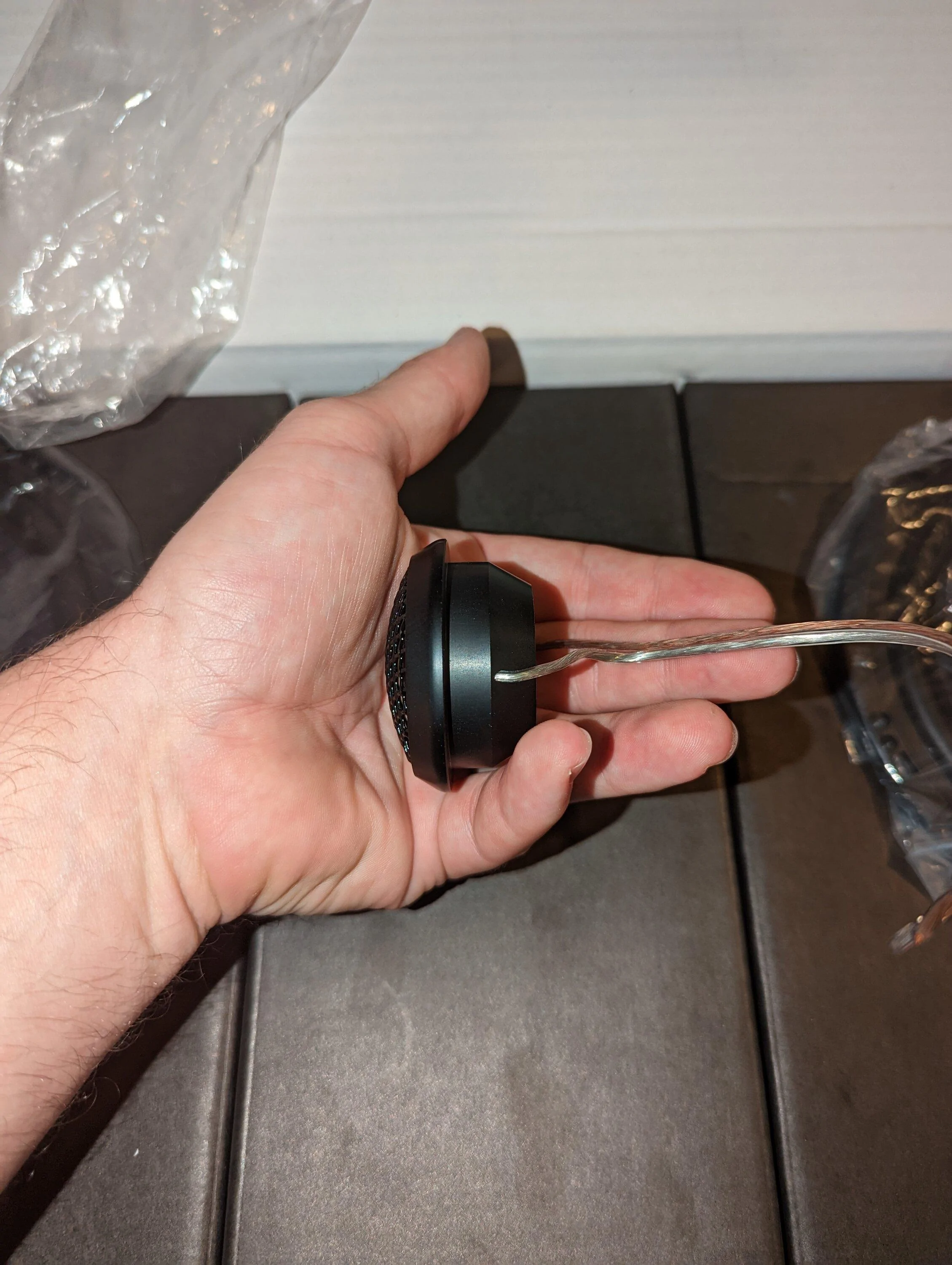

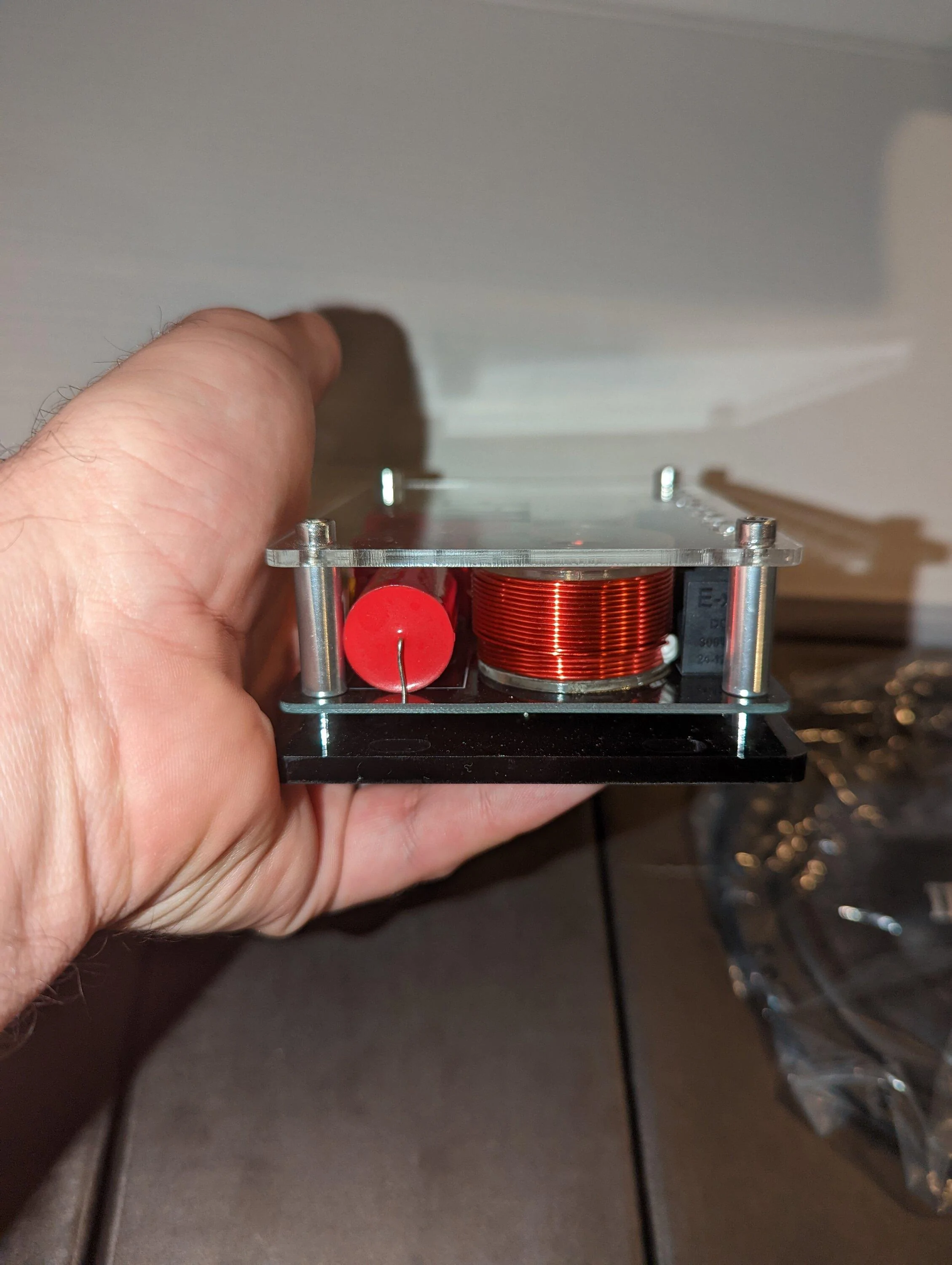

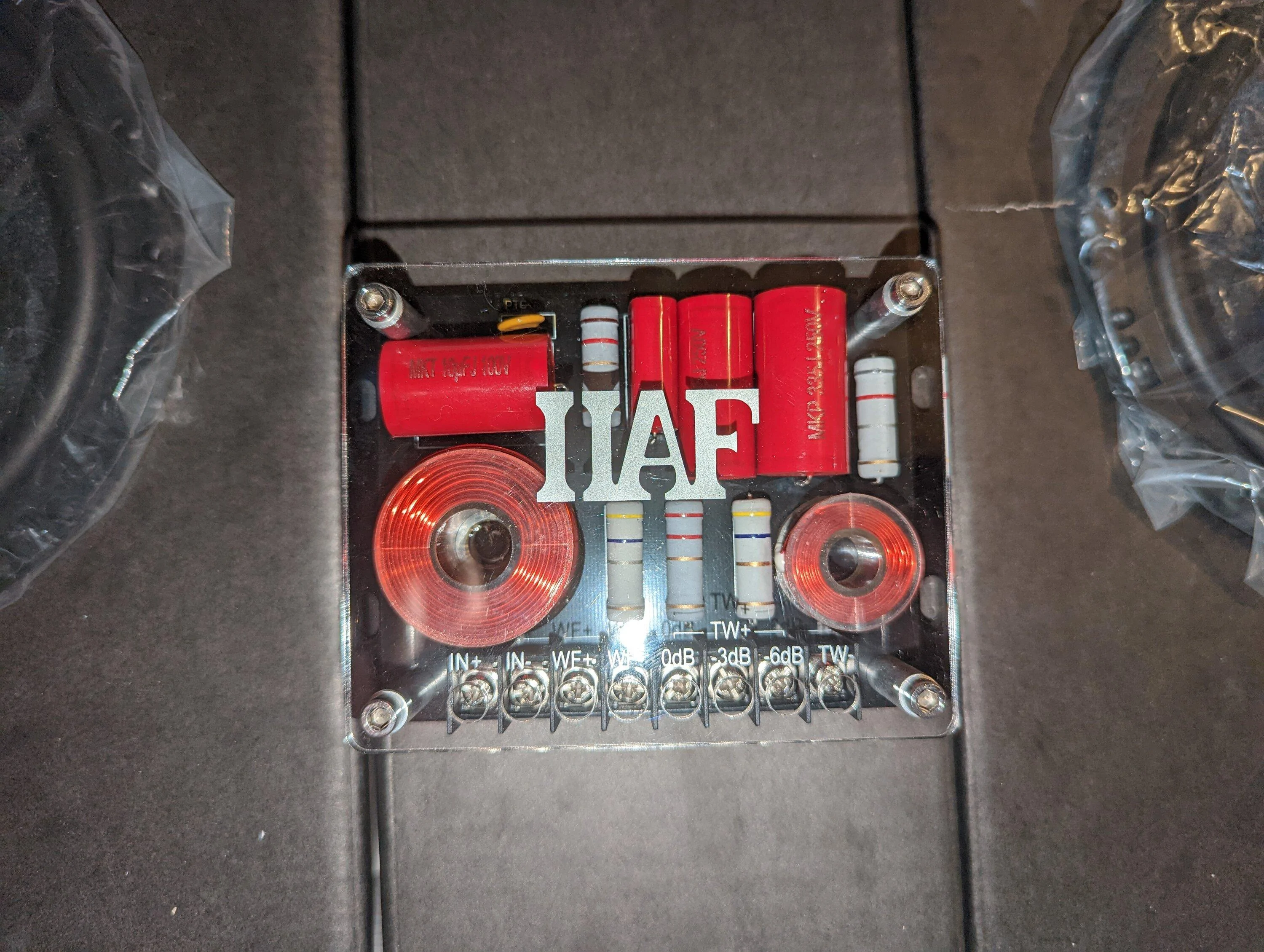

Ended up picking up the speakers and dsp last night from my speaker guy David with sound express and holy crap he wasn't lying when he said this is one of the most beautiful sets he has seen

Yes sir it has a 1/64 layer of lead between the two sheets of overkill, which is a little stiffer then I want, for the rear doors and floor I'm gonna go with resonix ccf which is very soft.
Only reason I chose the mega zorbe is because how hot Texas gets, I want to also fully insult it and the melamine open cell foam is amazing for backwaves as well in layers on top of it, I plan on trying to make that area 2.5'' thick, right now it's about a 1.5'.
