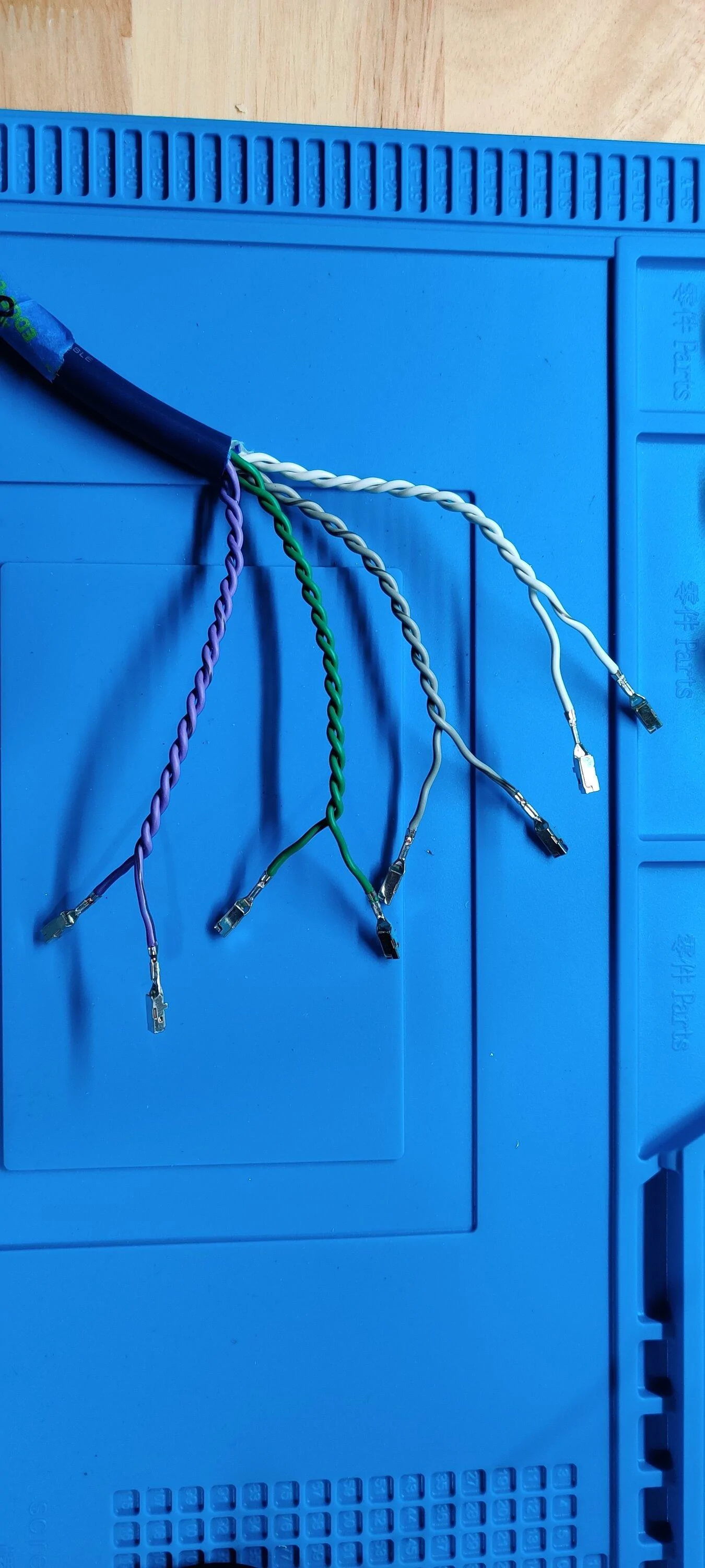

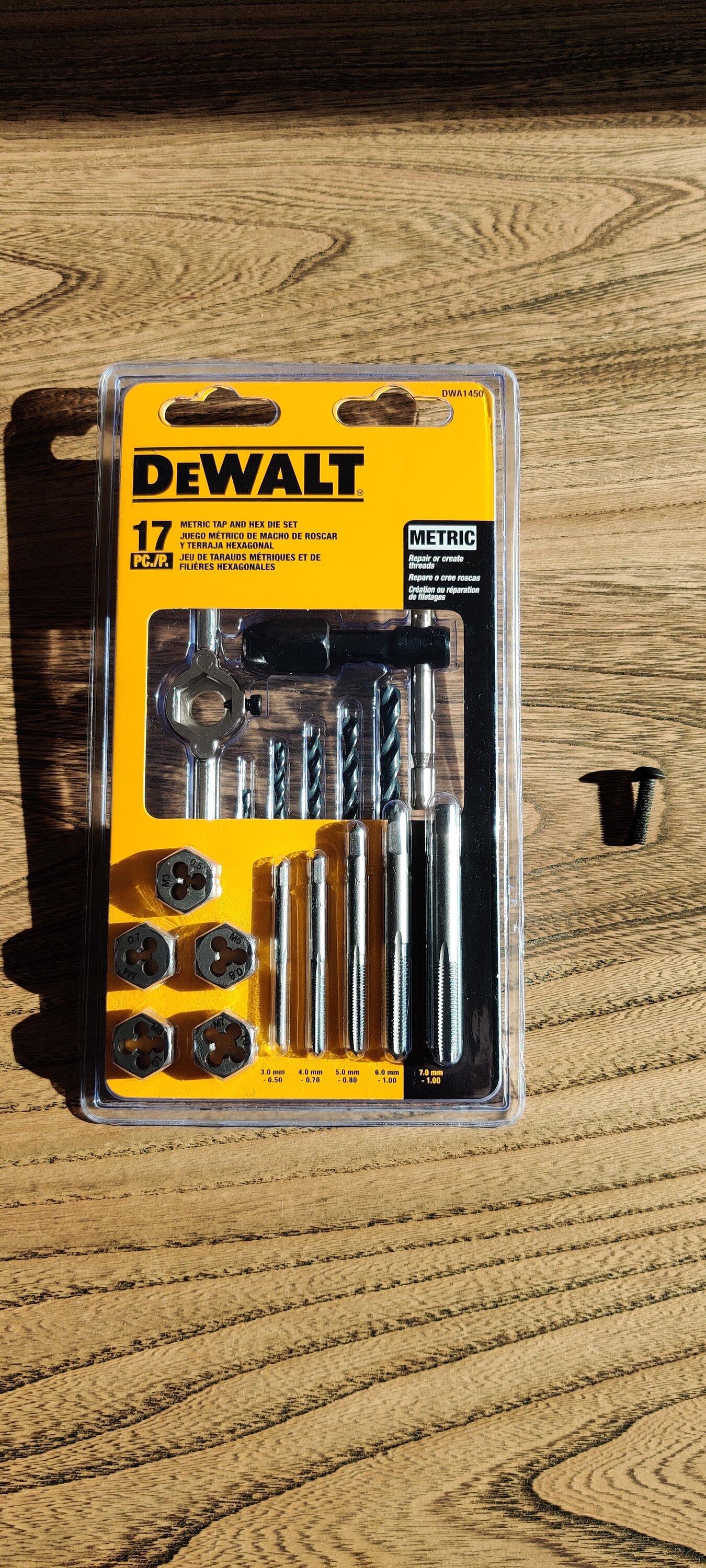

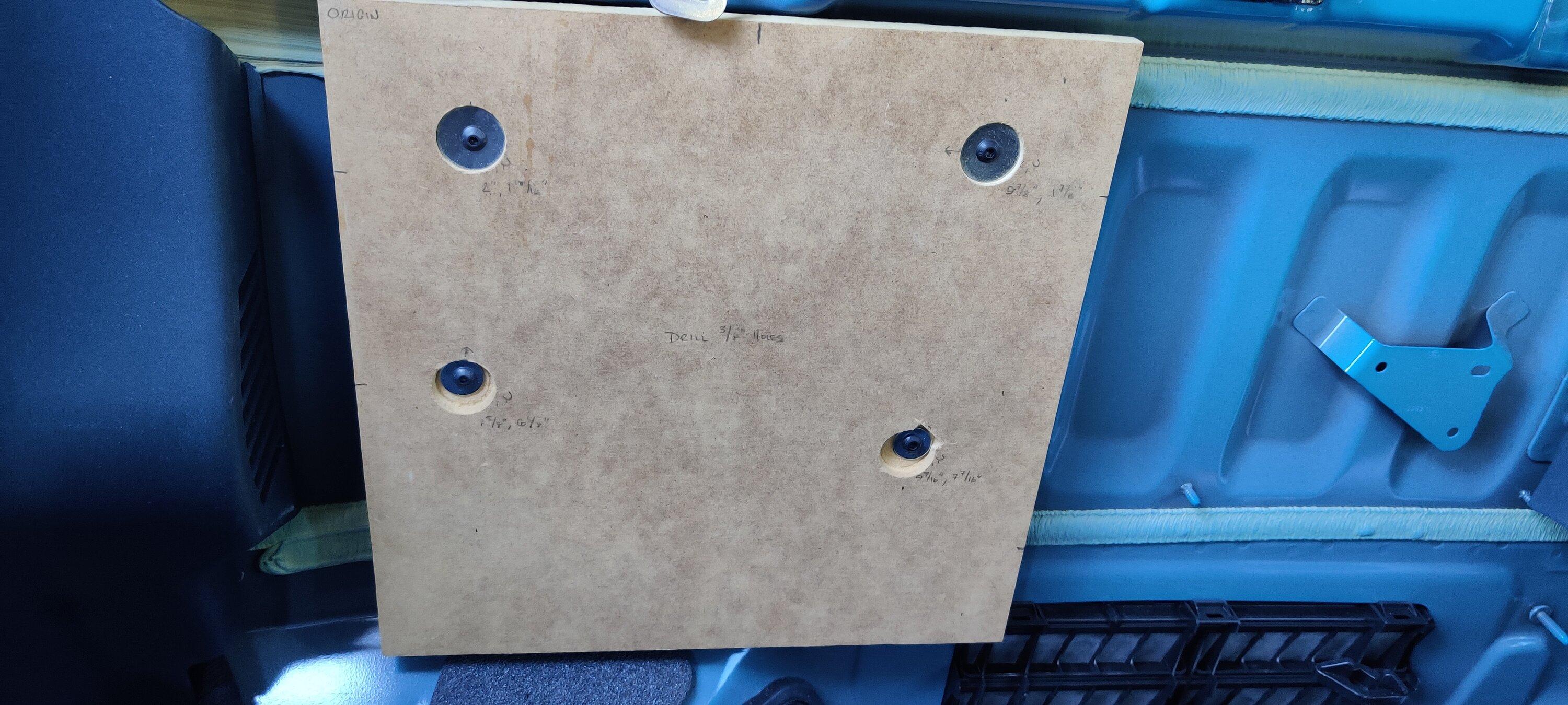

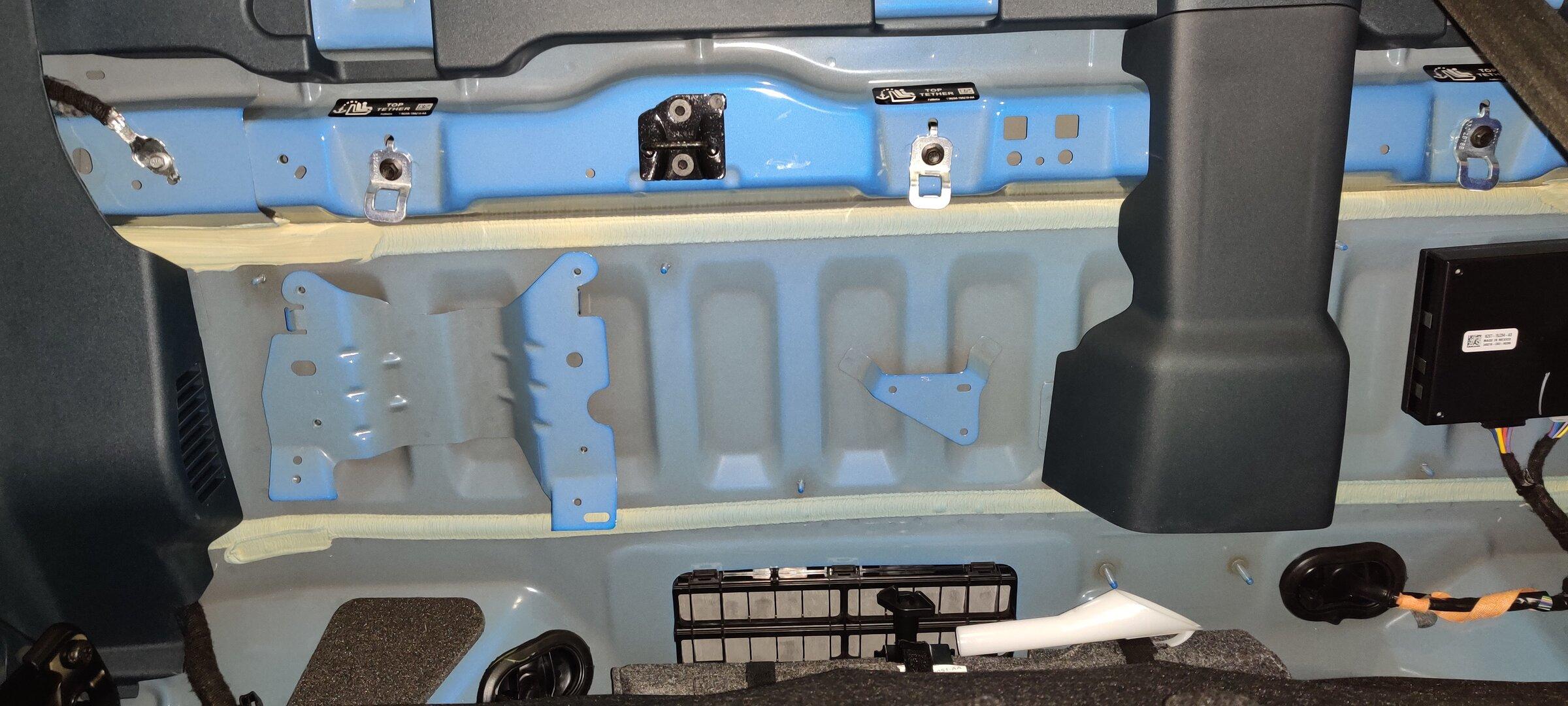

Used the redryder elevator bolt method. Used magnets to hold in place while jb weld dried. Going to run tweeter wiring under floor console.

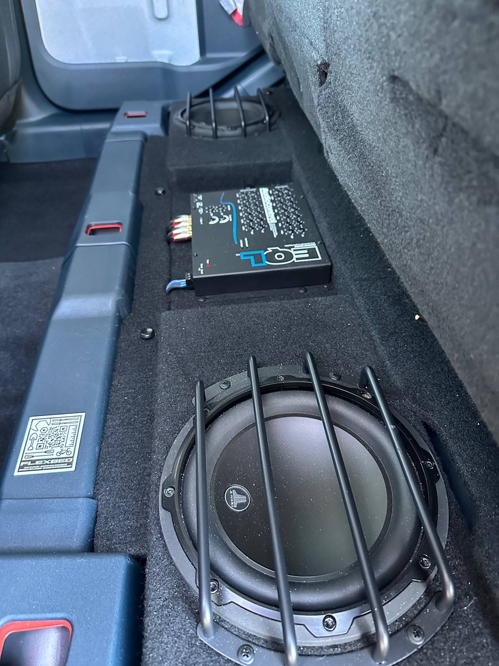

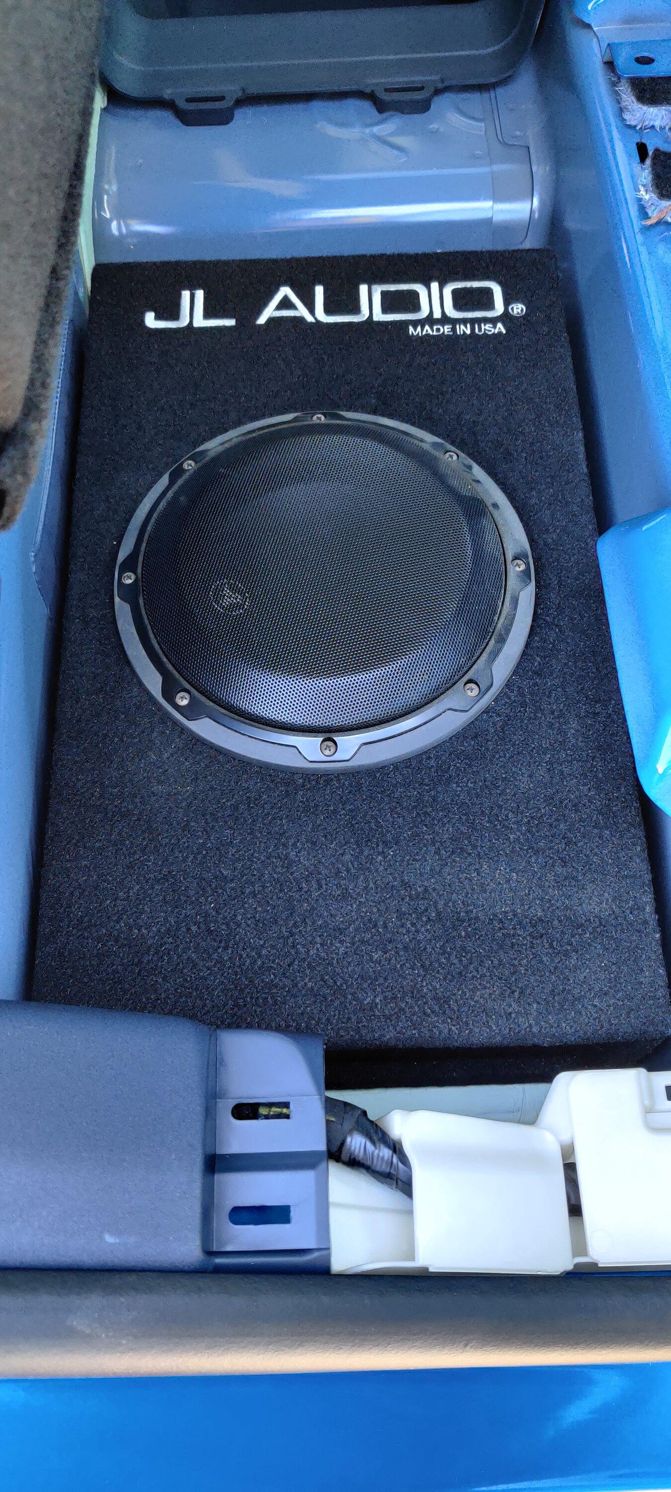

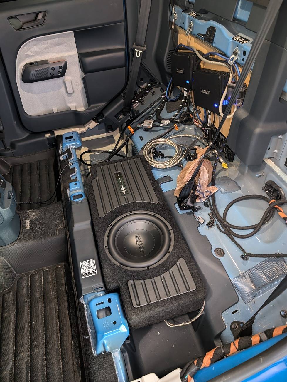

When you put the seat down and cover the subs, do you have any issues with the pressure from the subs rattling the seat or anything? I assume the seat is heavy enough, but as I'm planning my system I'm trying to get all the info I can.
Mine is up much higher, and no seat rattles.
