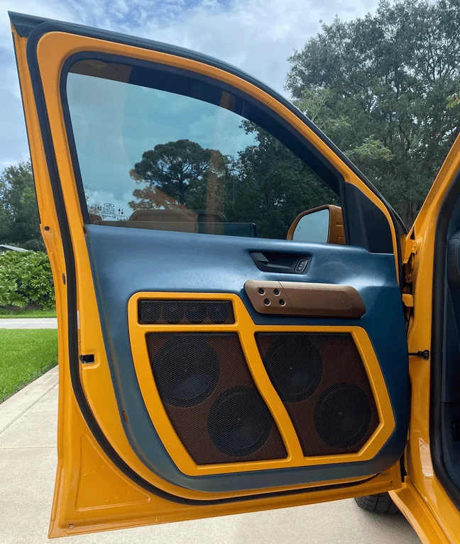

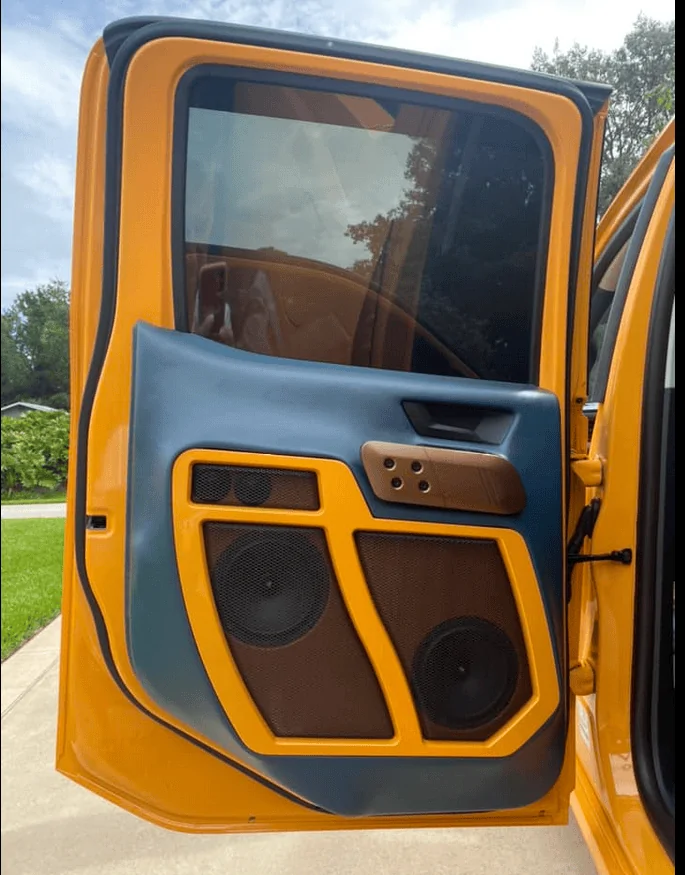

it's very common for high-budget autosound to build speaker pods or complete door panels. here's some examples from the Maverick Customs FB group.
the door panels are one piece so I don't see it as likely for anyone to offer this as a product. it's too costly to fabricate for production and then even if you did some idiot with a 3D printer is just going to copy your product without doing any of the hard work and sell it cheap on Amazon. if you want this someone will have to build it by hand.

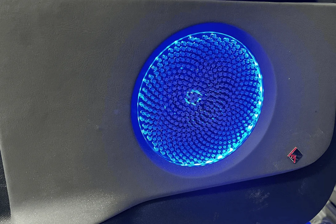

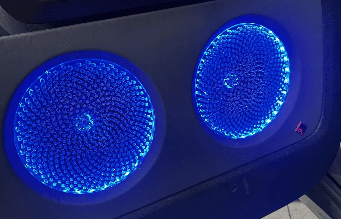

Some things happened over Thanksgiving break lol will be adding a third amp in the future when the subs go in. When subs go in, I will be doing a 5 1/4 in the rear, just didn't have time
Ford Maverick Another audio build IMG_20221130_132238
Ford Maverick Another audio build IMG_20221130_132244
Ford Maverick Another audio build IMG_20221130_132235
Ford Maverick Another audio build IMG_20221130_132230

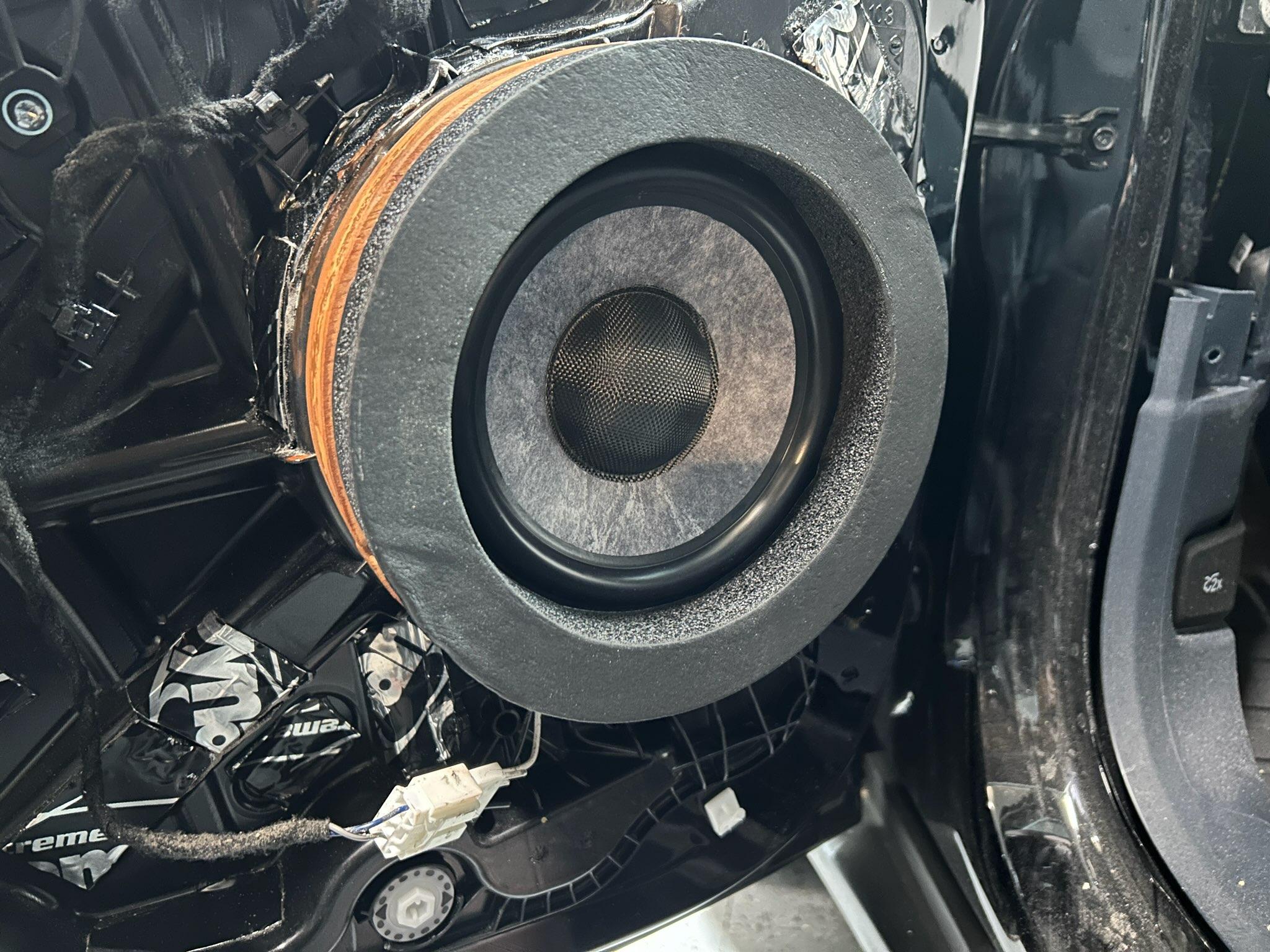

No sir that's the front door, it's a 1.5" ring to be able to fit the massive mid bass. Had to cross it over at 90hz vs 60 due to flex.
So I'm gonna have to take the mega zorbe out of the front doors and do more deadener on them and then do thinsulate or fibermat from resonix in the doors cards themselves. On top of that, the weatherstripping on the door is even vibrating crazy enough lol.
I have only changed my rear speakers out with other 4" coaxials, I will be doing a wood bracket like my fronts and epoxy them on to the metal and remove the plastic bracket on the trim piece. And for the gaps it will get some foam so the rear speakers will be sealed as well.

This is how we had it originally, and the door card was barely popping off, once I get the thinsulate on I will be doing some rivnuts in the screw locations to hold the door card better. And putting the rings back on as well. But hard to fit anything in this door panel.
Planning on doing blackhole tiles now in the door skin at 100% coverage that way I don't have to worry about my barriers in the door cards. This truck is hardcore with tight tolerances. And I was wrong this mid bass is around 3 inches not 4
