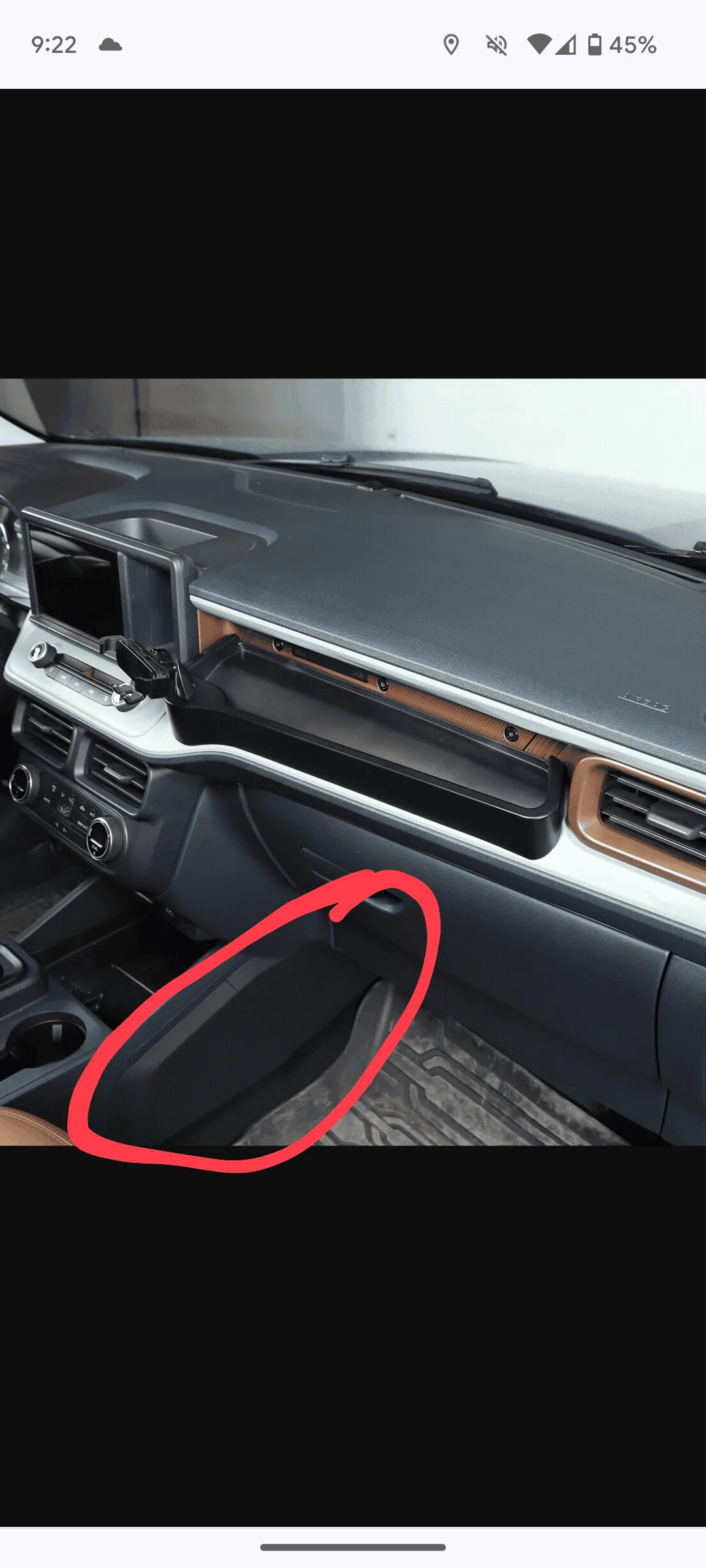

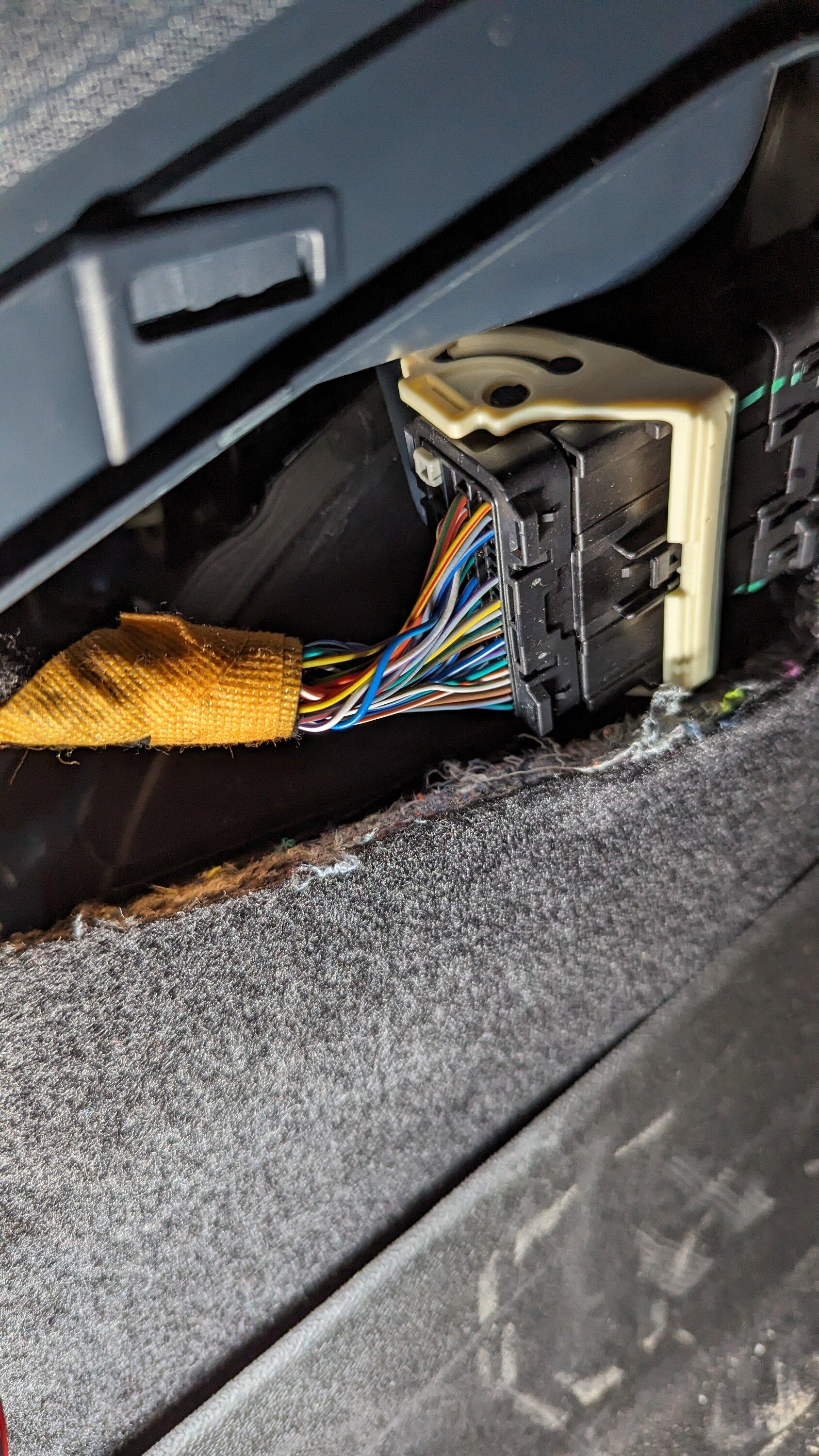

I've got a few recommendations for folks. First, it might be the windshield alignment pins if you hear buzzing/squeaking on the passenger side at times. Ford reseated my windshield and that went away.
If you're going over bumps and hearing plastic on plastic tapping, it could be this massive harness that Ford stupidly attached to the center console plastic with just a plastic rivet. It makes noise, so put some felt underneath it.
Ford Maverick Annoying rattle  coming from passenger side PXL_20231022_212445912
Carefully pull the plastic towards you from the bottom and the clips will unsnap.

Could you post a zoomed out photo, I can not determine where you are referring to. Thanks!
I am not near my truck, so will use this random image I got from an eBay listing...
