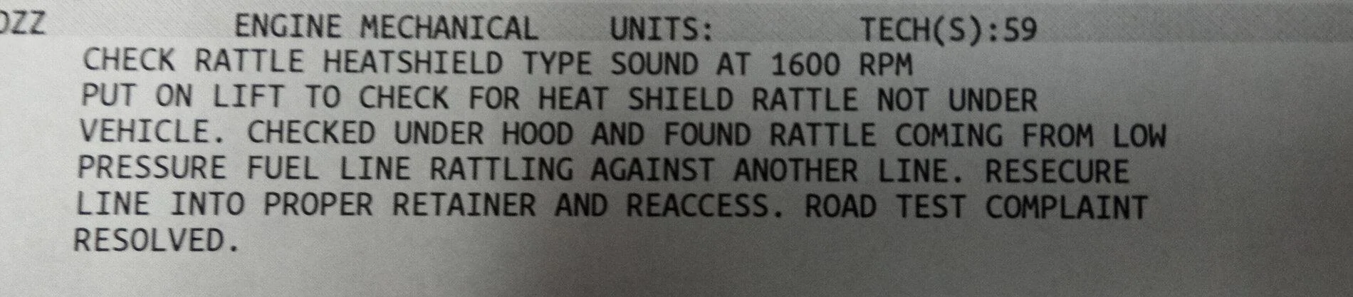

Just got back from having it serviced at the dealership yall. Here is what they said:
Ford Maverick Annoying and Worrying Rattle PSX_20211130_165938
I can confirm that the noise has been taken care of.
So those of you that were reporting a similar issue, maybe look to the fuel line? I seem to remember another member on the forum mentioning that in his case it had been the fuel pump on his Maverick. Probably worth keeping an eye on it or at least keeping this in mind if the rest of you run into a similar issue/noise.

Thank for for showing how it resolved for you. This is a help in case others run into this issue. Much Appreciated.

Good thing you had this issue checked out right away, anything rubbing on a fuel line will certainly wear a hole in the line and possibly cause a fire with fuel leaking in engine compartment.
