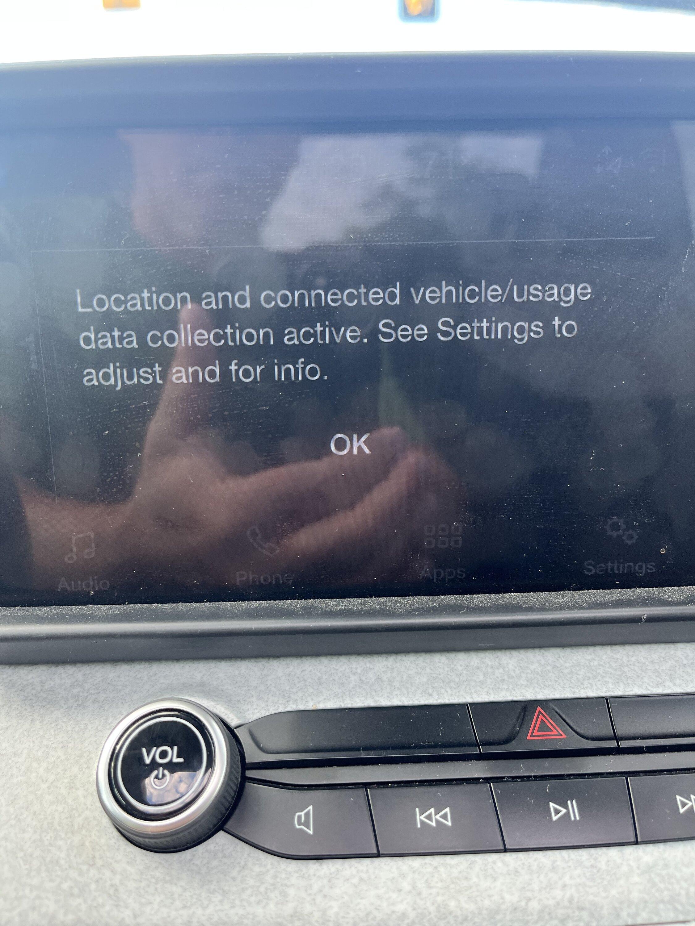

Annoying messages on my display screen. Is anyone else getting this message? If so,
Ford Maverick Annoying messages on my display screen C91A828C-2CC3-455D-8451-77432D9478FF
does anyone know how to get rid of it.

You really need to spend some time playing around with the settings. I spent two evenings sitting in the car, changing settings to see what they would do and looking up stuff I didn't understand.
There is a setting to shut it off. The menu is on the screen. Please note there is a settings menu for the dashboard screen as well. Lots of good stuff in there.

I think he, like me just would like it not pop up every last time I start the vehicle.

Pull fuse 11 from the fusebox in the cabin. That disables the 'telematics control module.'

Or you can just turn it off.

Yes. EXCEPT...turning it off in the menu seems to not actually turn it off. There's still cellular chatter. What's in the chatter remains unknown.
Never trust the menu toggles.
