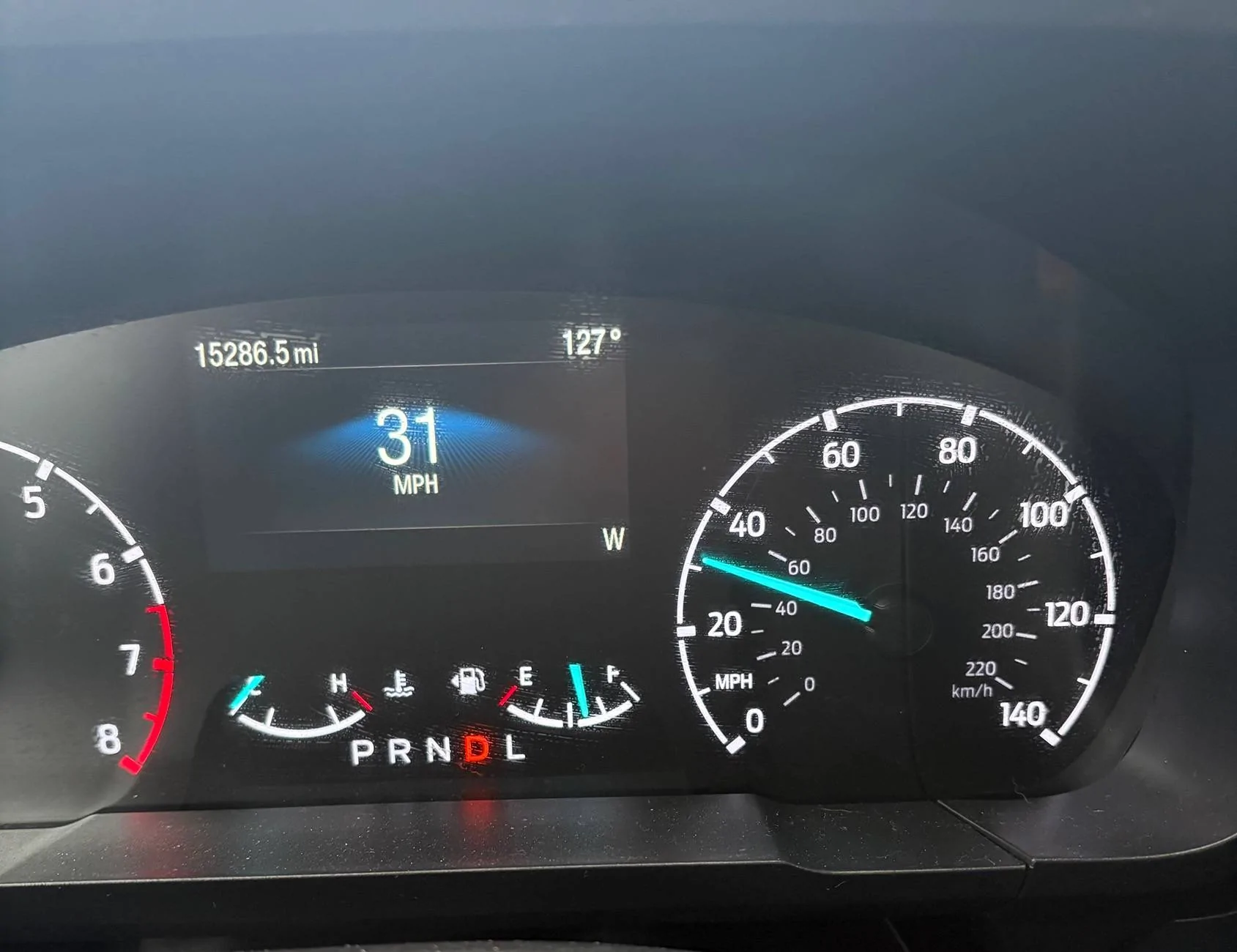

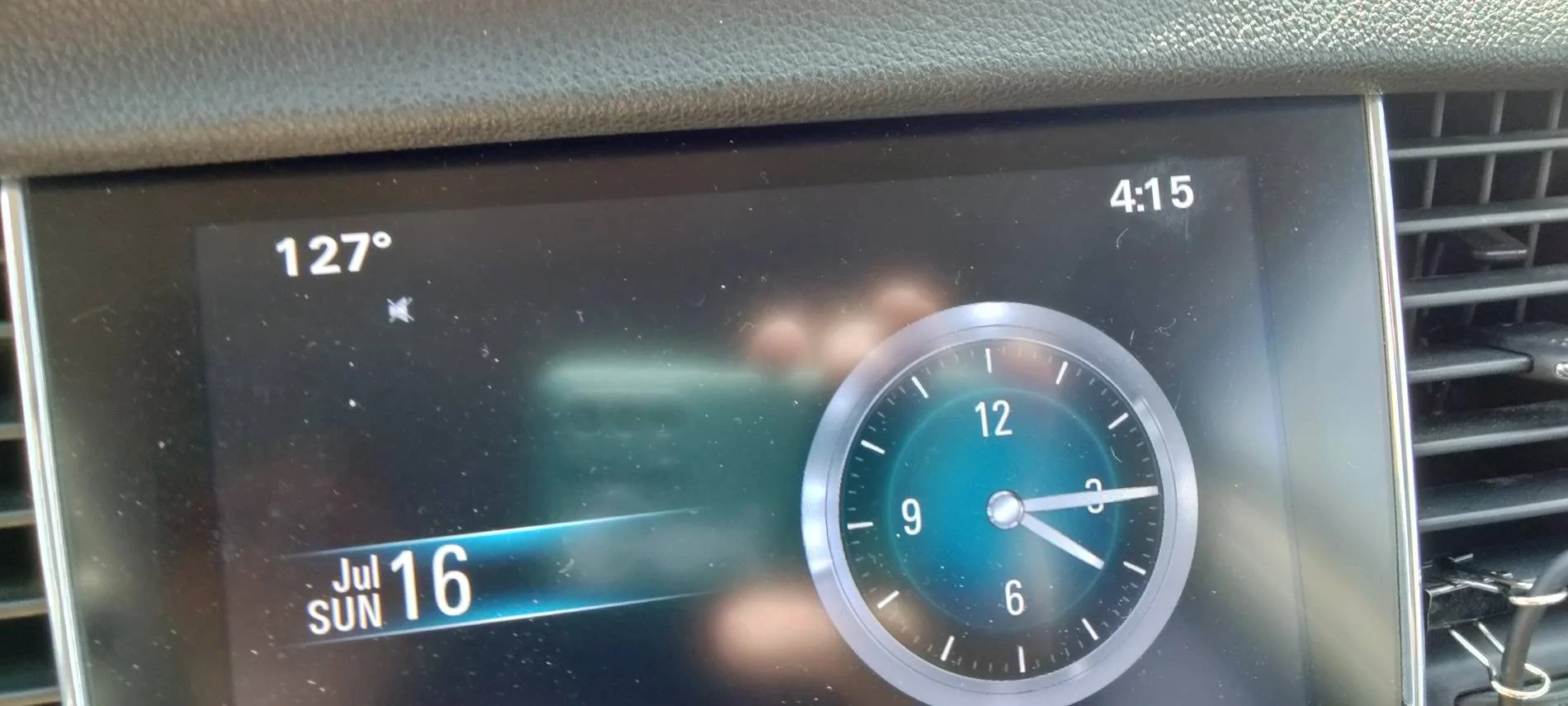

Other than the the outside ambien air temperature showing 50° off.
Was it Above or Below ambient temp.?
Did you notice any other possible related problems?? Such as engine, climate control....???
Is the temperature always 50° off or does it happen sporadically?
There is a reason for the questions.
I just don't want to steer you towards a specific reply.
It's been 50 above and 50 below. It does mess with the climate control

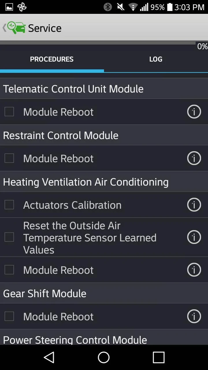

Besides that - did they reset the calibration?
If Forscan Lite has it - I know their scanner does.
Can you tell me how to find this in forscan? My actuator may need recalibrated.
In Forscan Lite for android - it's on main screen under Procedures.
Not used Forscan for Windows, but assuming something similar from Home Screen.
