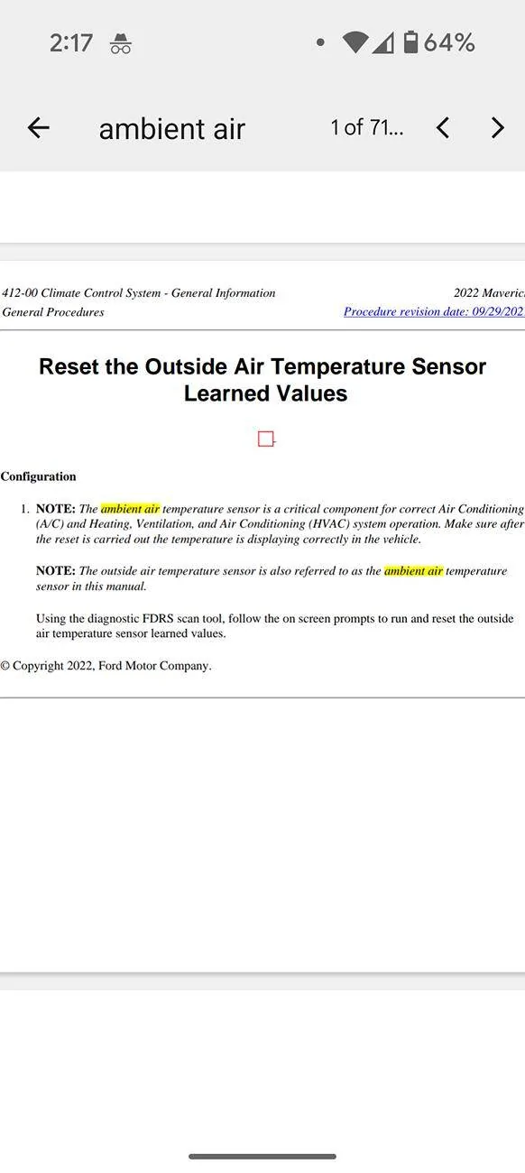

Did you also do the reset procedure via Forscan? Service manual says it's required if the sensor is replaced.

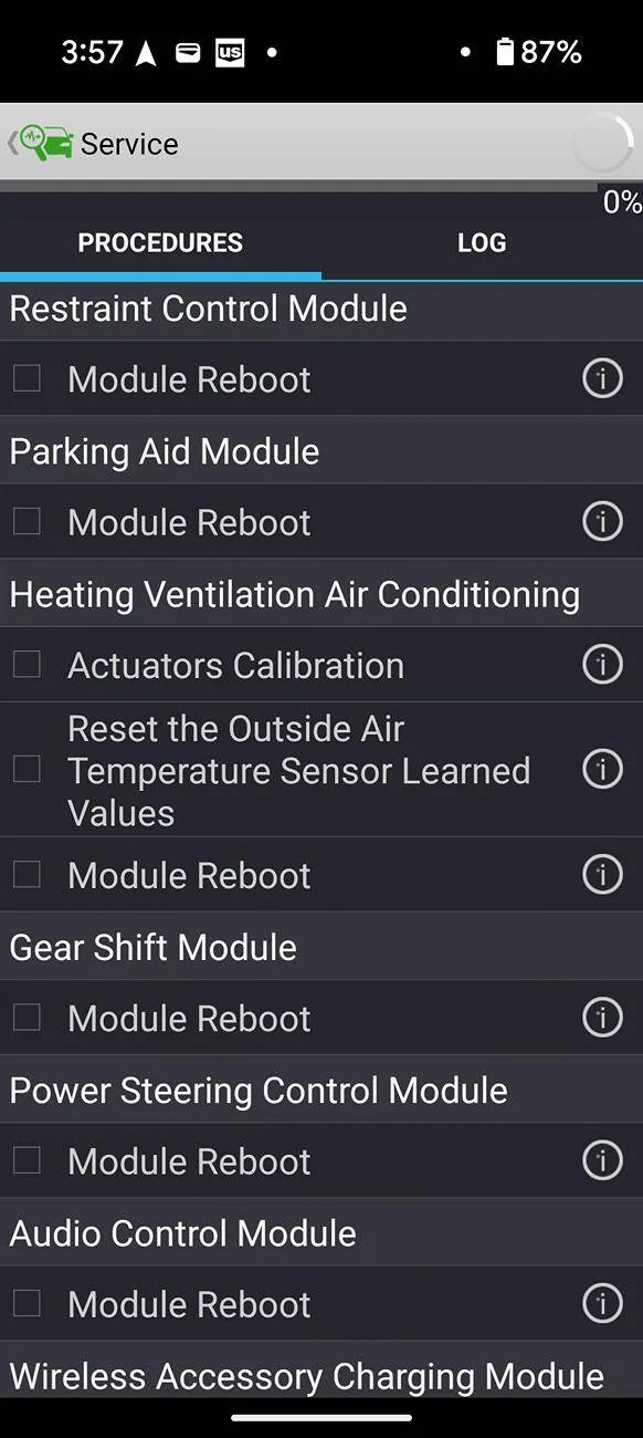

How does one go about reset procedure after replacing the sensor?
I believe it's available in Forscan under the service procedures.

Do you have access to the service manual and if you do could you be so kind as to let me know what it says about this topic? 🙏
bgn
Jun 12, 2021
3,070
5,799
WA
Thank you so much. I was hoping I could do the reset in FORSCAN, but clearly I can't. Thanks for your help.
You should be able to. It doesn't call out Forscan because that's unofficial software. I'll check later today when I'm driving and report back.

Looks like it's possible from the android version.

You're right, thanks! Just did the reset and still no dice. I'm going to try another sensor and then if that doesn't work I'm just going to have to pay the dealership to fix this. Not having AC in the summer is brutal

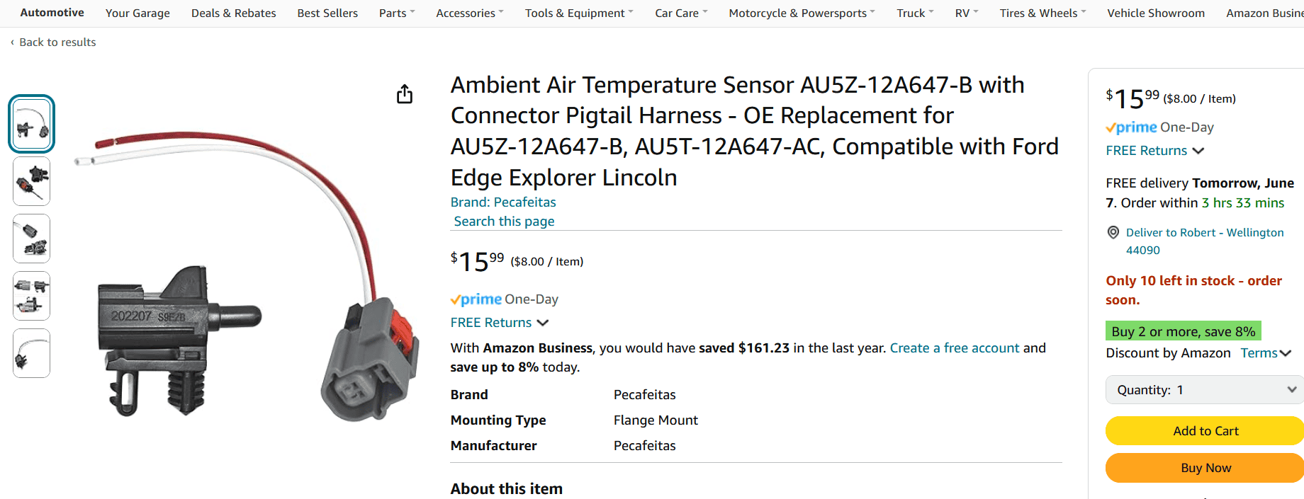

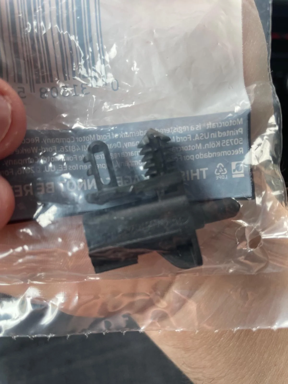

Thanks to the help of everyone in this thread I was finally able to fix the problem!
I bought a new sensor from that Amazon link that was provided for $10. Soldered it in place and heat shrank the wires. Started up the truck and immediately had a temperature reading on the dashboard. I let the truck run for about ten minutes and the check engine light was still on so I didn't try running the AC yet. I then used Forscan to reset the DTC's and and ever since then the check engine light's been off and my AC is pumping out ice cold air. Man what a relief! Hopefully this repair holds long term 🤞
Thanks again everyone for all your help.

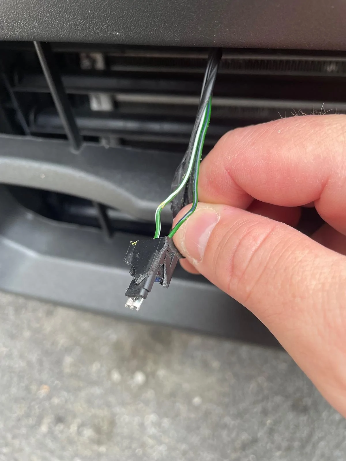

I’ve got the opposite problem of this thread. Bumper damage ripped out the connector so now all I have is a sensor and two torn wires. The connector vanished. Anyone have any idea what kind of connector it is?
