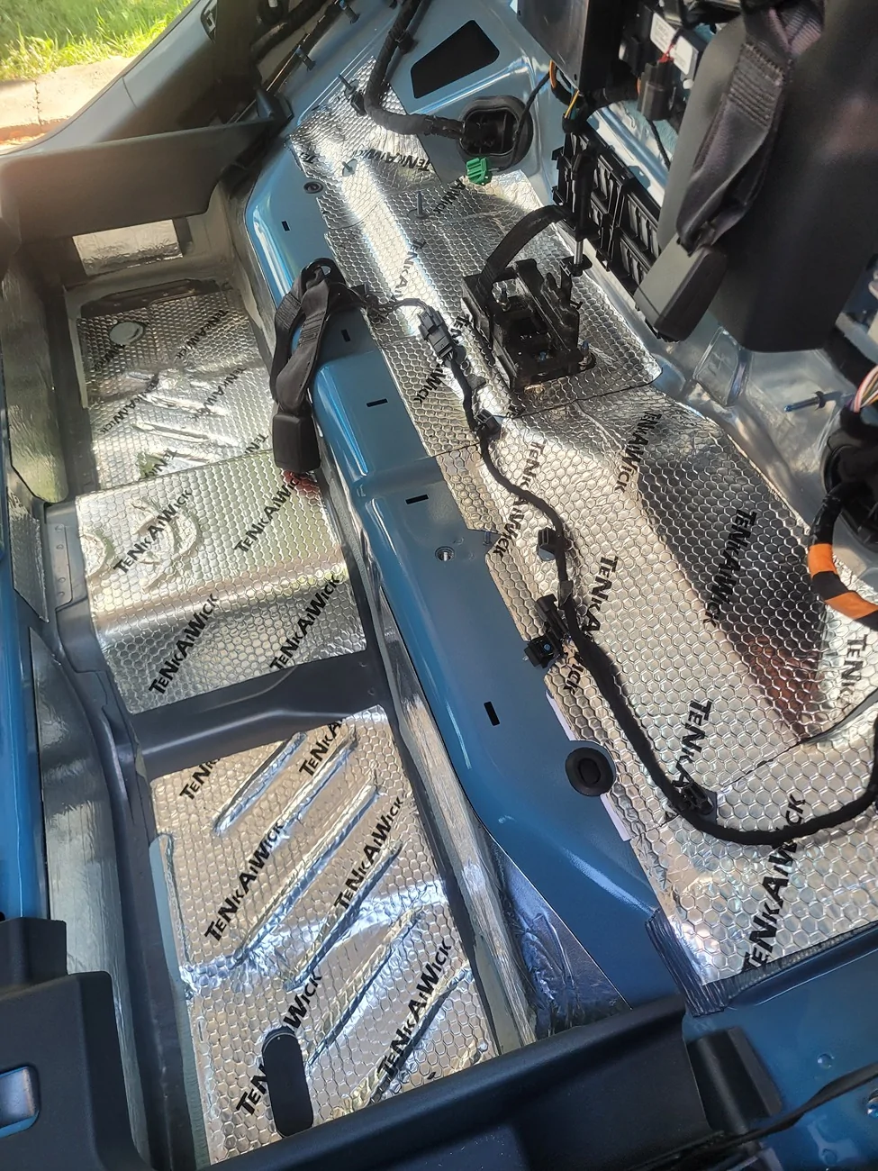

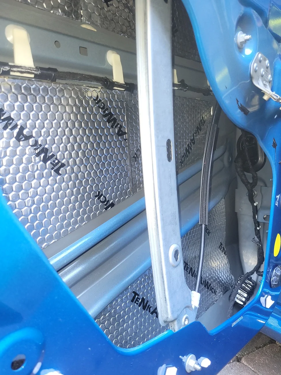

I have done inside the doors, fenders, under the the carpet and rear seat storage bin, and the roof with the aluminum butyl sound deadener.
I also added deadening foam to the backside of the door panels, under the storage bin, the roof and the back of the cab.
The difference is way better than I expected.
Oh great, another project for me. I haven't noticed any noise annoyance, but that doesn't mean I won't try this. Thank you for sharing. Great work.

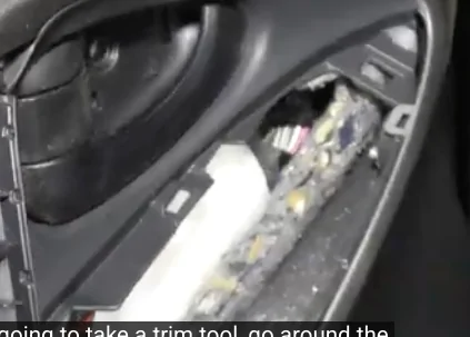

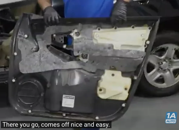

Make sure to decouple the plastic panels. 3M Thinsulate works great which also doubles as a sound absorber. Or any sort of foam with adhesive also works. Adding CLD to the backside of plastic panels also reduces the tendency of the panel to rattle.
That Thinsulate looks good - but pricy.
I was wondering about what my 2005 Toyota RAV4 has on the door panels.
Trying to find pictures - appears like not too tightly pressed felt.
Ford Maverick Amazon Sound Deadening Mat 1763149935062-ci
https://www.toyotatownpartsdirect.c...nel-Insulation-Front/49858233/679240R010.html
Mine is fuller coverage than this later year.
Ford Maverick Amazon Sound Deadening Mat 1763149871349-zh
Requires being on the dry side obviously.
Does the Mav not have space for something thicker, or it actually works better with attaching that other material to metal surface?
