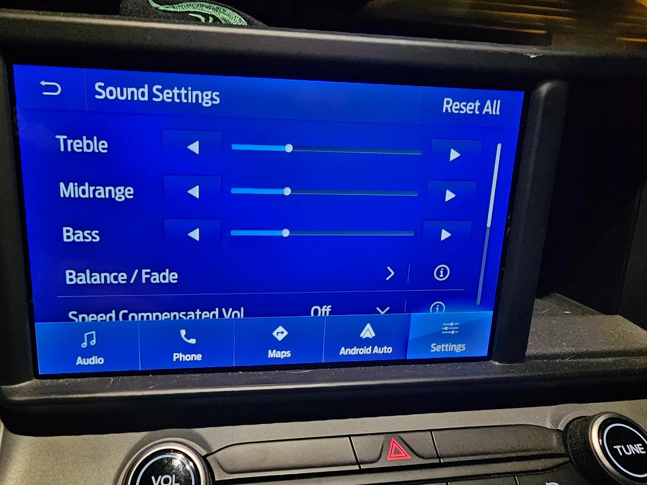

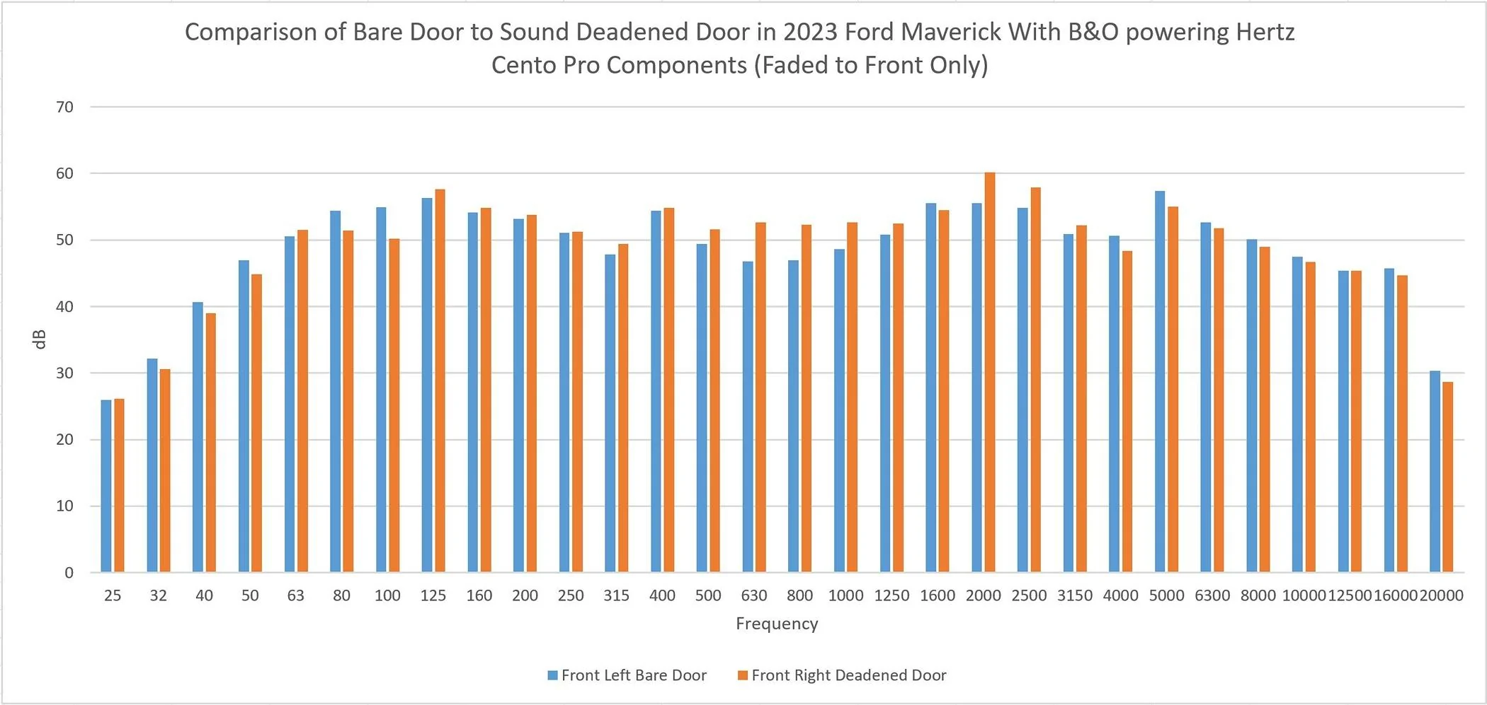

Crossover is somewhere in the 3k to 4.5k range so of course the highs are the same they are coming from the dash tweeters.
It looks like the deadening is more effective at very low frequencies. I'm curious if there is still any resonance.
I turned on some EDM type music on pandora last night that has lots of extended lows. Switching balance from side to side at volume 18, I could hear a slight buzz from the bare door, and nothing from the deadened door.

I had that "buzzin" issue happened to me. Had to do a lot of readjusting and putting the gain just right so I didn't hear it from that one channel. Seems to be the norm for our Mavericks. Never had this issue before.

At the moment, the buzzing seems to be solved on the right side. We shall see if it stays that way when I connect a more powerful amplifier. Fingers crossed. I think the butyl tape really helps.

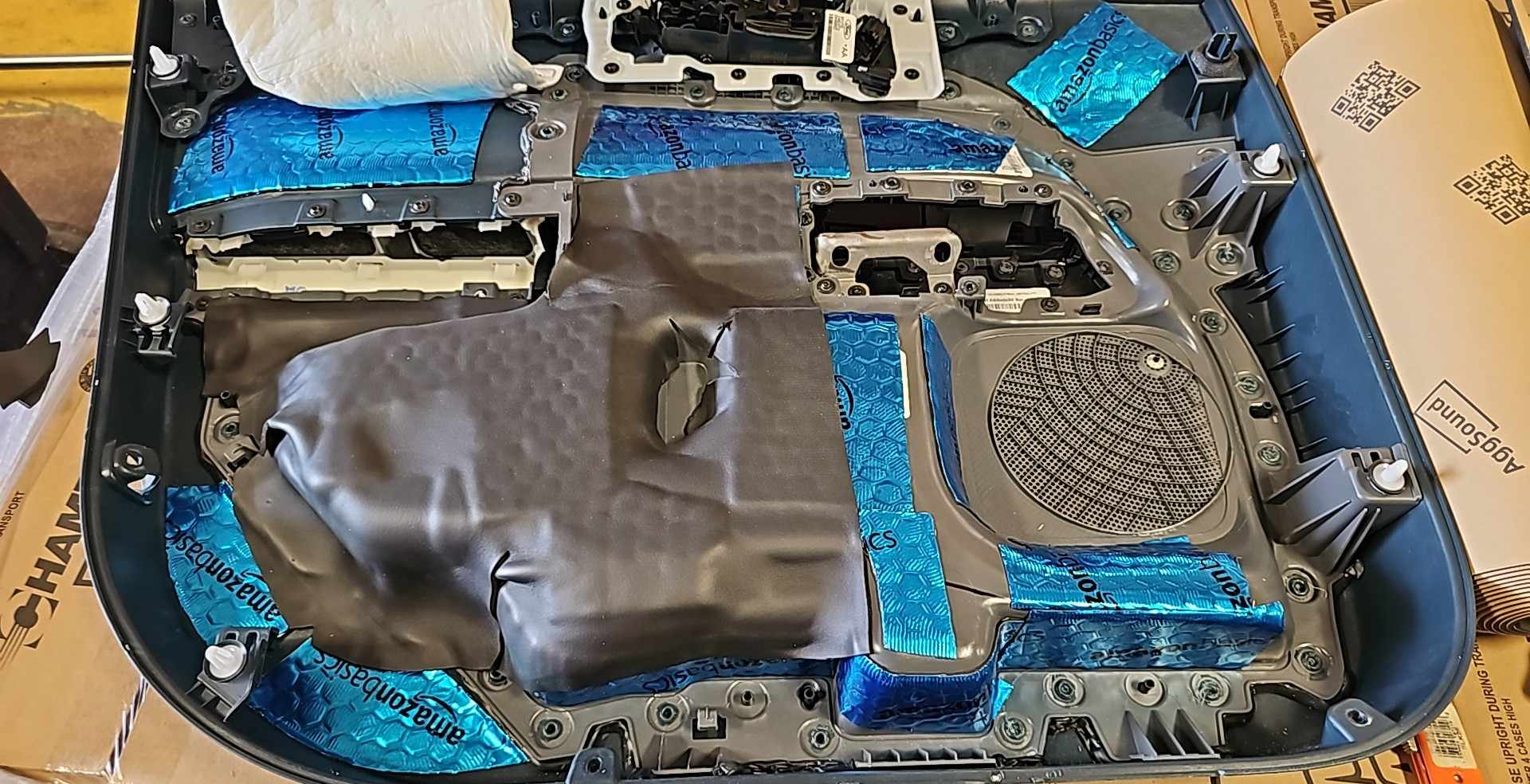

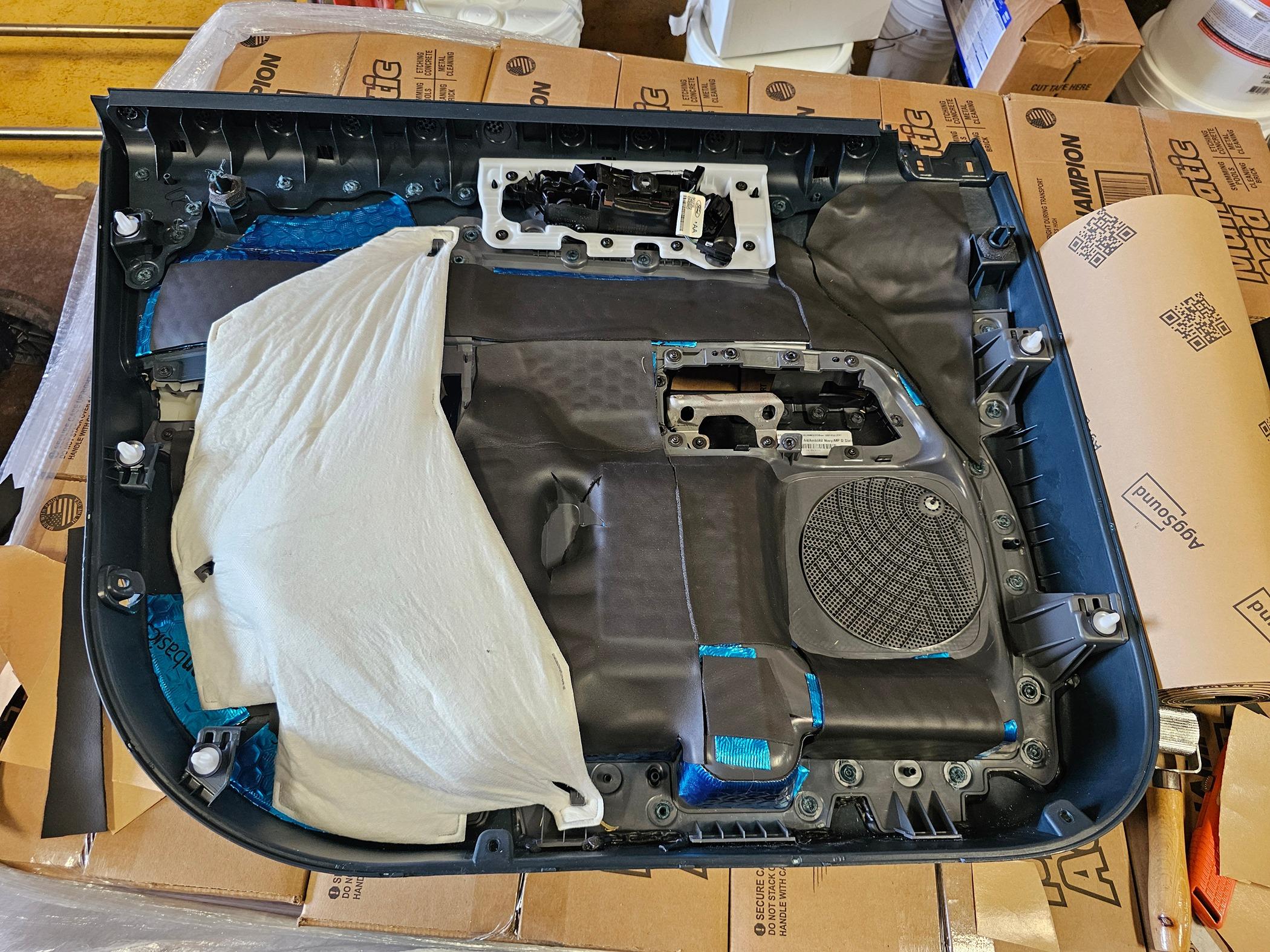

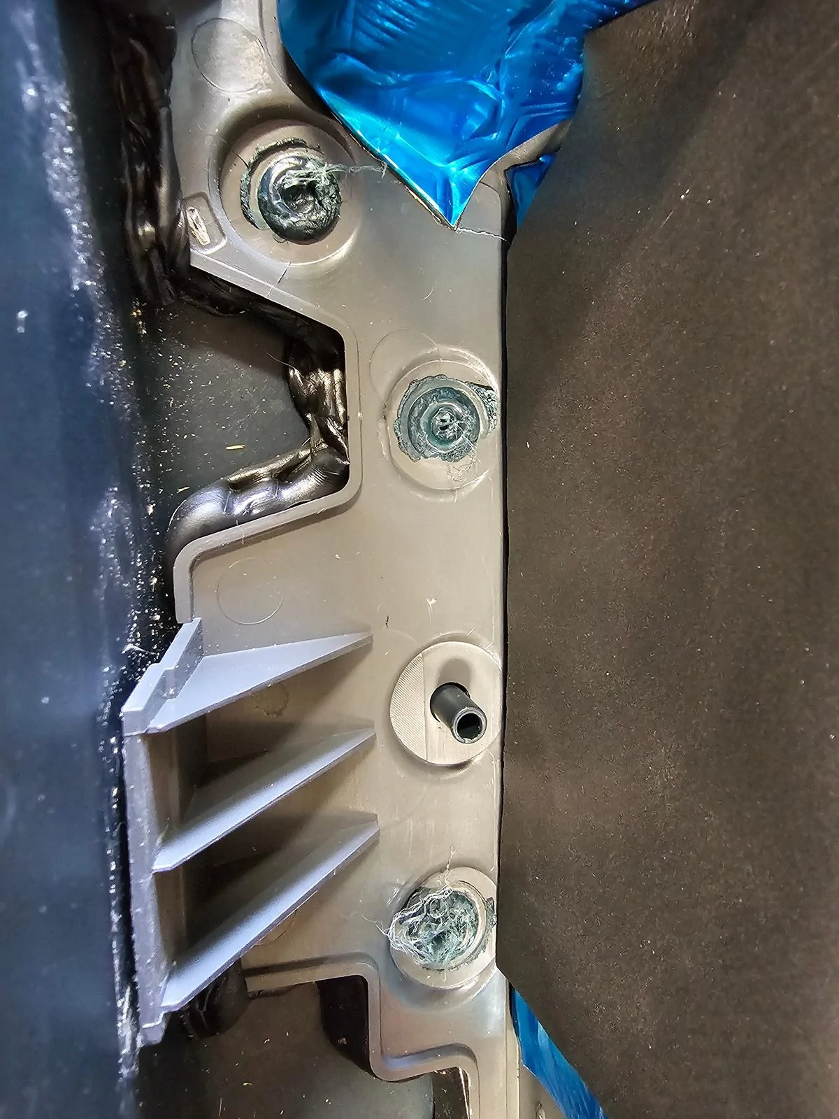

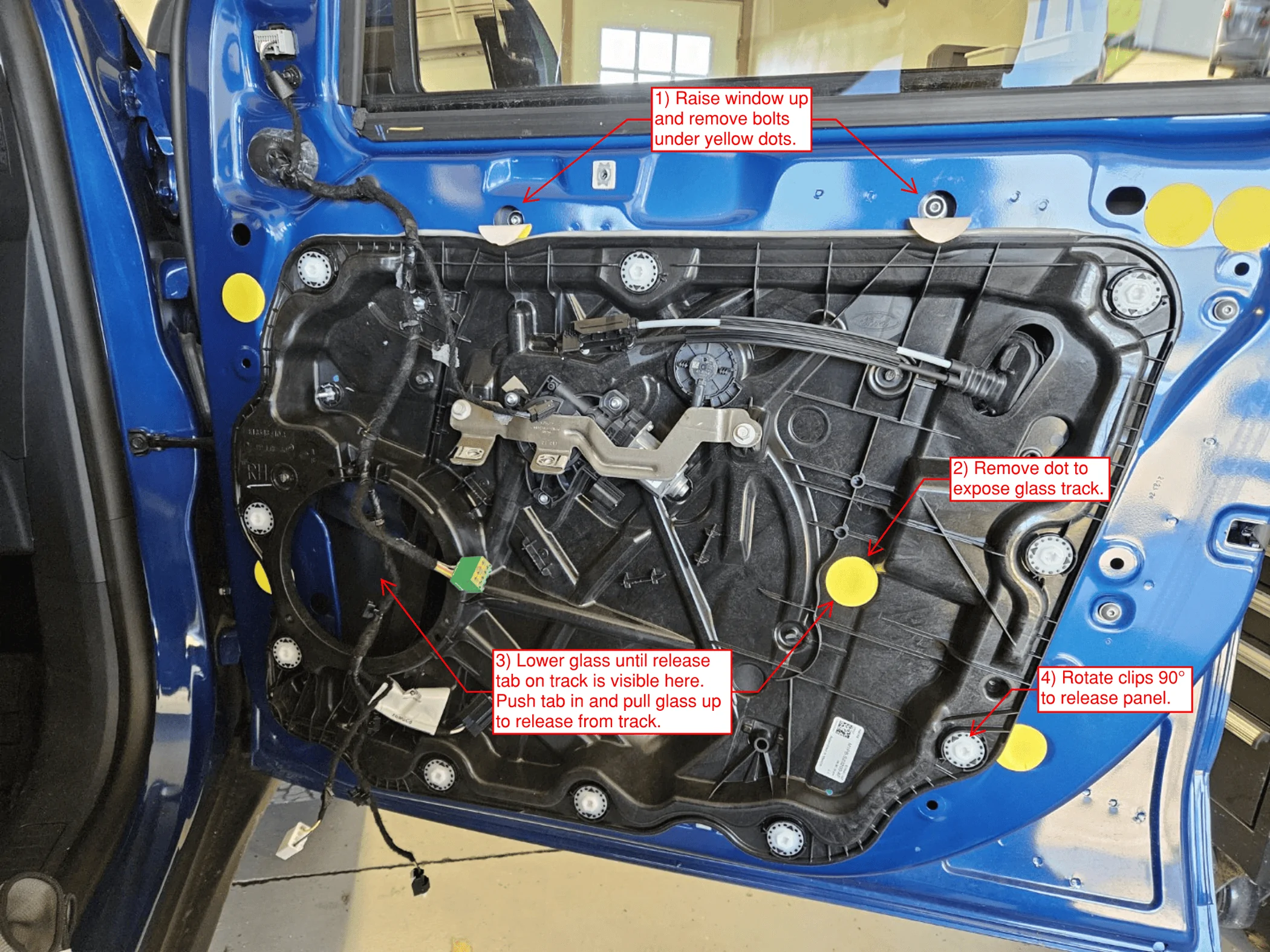

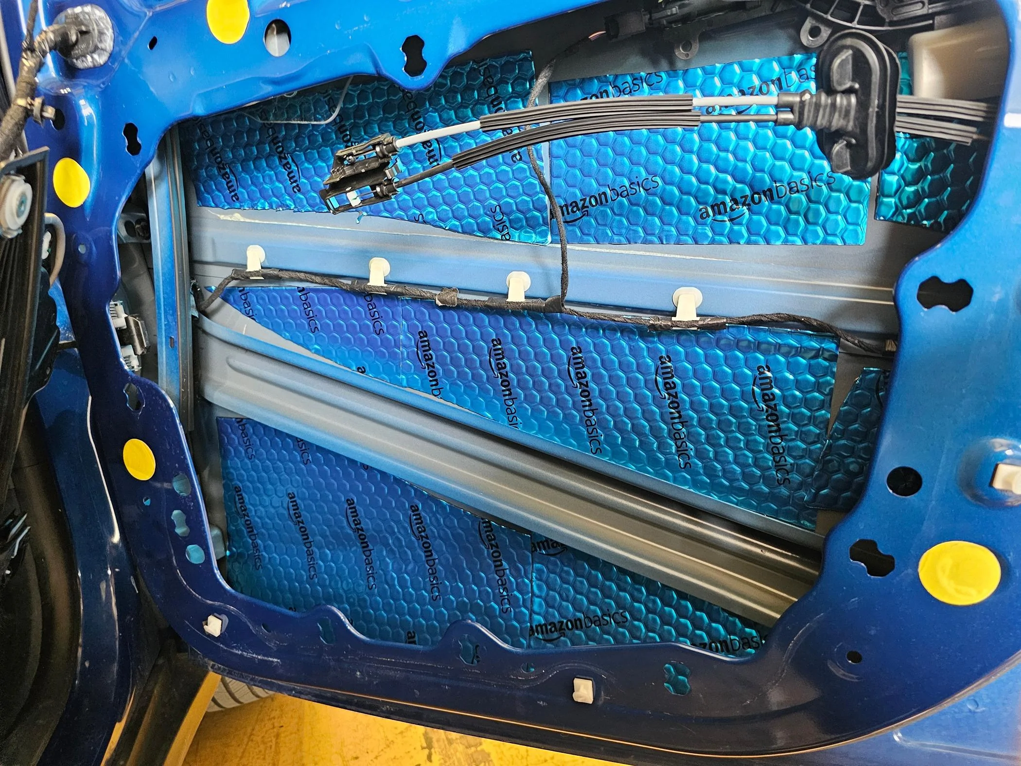

I was very thankful to find a post by BLUE1870 with detailed instructions on how to remove the inner door panel with the window regulator. I knew if I was going down this road, I wanted to put deadener on the outside door skin, and I would have been lost without his picture (which I'll include here as well). For cost to performance ratio, I went with the Amazon Basics as a CLD. I also bought ZMXT Butyl tape to prevent the nasty rattles that tend to happen between the 2 layers of plastic on the door skin. To further reduce any rattling, I also bought the AggSound 157mil Closed cell foam to apply to the door panel to decouple it from the speaker panel. I am not super mechanically inclined, but with some youtube videos and info from BLUE1870 on hand, I was able to tackle the first door without much issue. All in all, I was happy with the quality of the products I ended up choosing. The amazon product seemed heavier than the previous Killmat I have used. The butyl tape is definitly the way to go around the perimeter of the 2 fused door pieces, and the CCF had a nice adhesive and what I think is ample thickness to keep me from having any issues. I look forward to having another good day to do the drivers door and get the Audison Processor installed.

I bought the $47 kit with 34 pieces of amazon CLD sound deadener. This was way more than I needed, but I lined the entire underside of the back seat cubby as well.
For the butyl rope, it looks like I bought a 13ft roll, and that was enough for both front doors.
For the Closed cell foam, it was a 18sq ft roll of 157mil, also more than enough for both front doors.
If I had to do it again, I would probably spend the extra money and do it with Resonix CLD and CCF Decoupler. The cost is significantly more, but the material is far superior in quality and results, especially if it's something you are only ever going to do once.

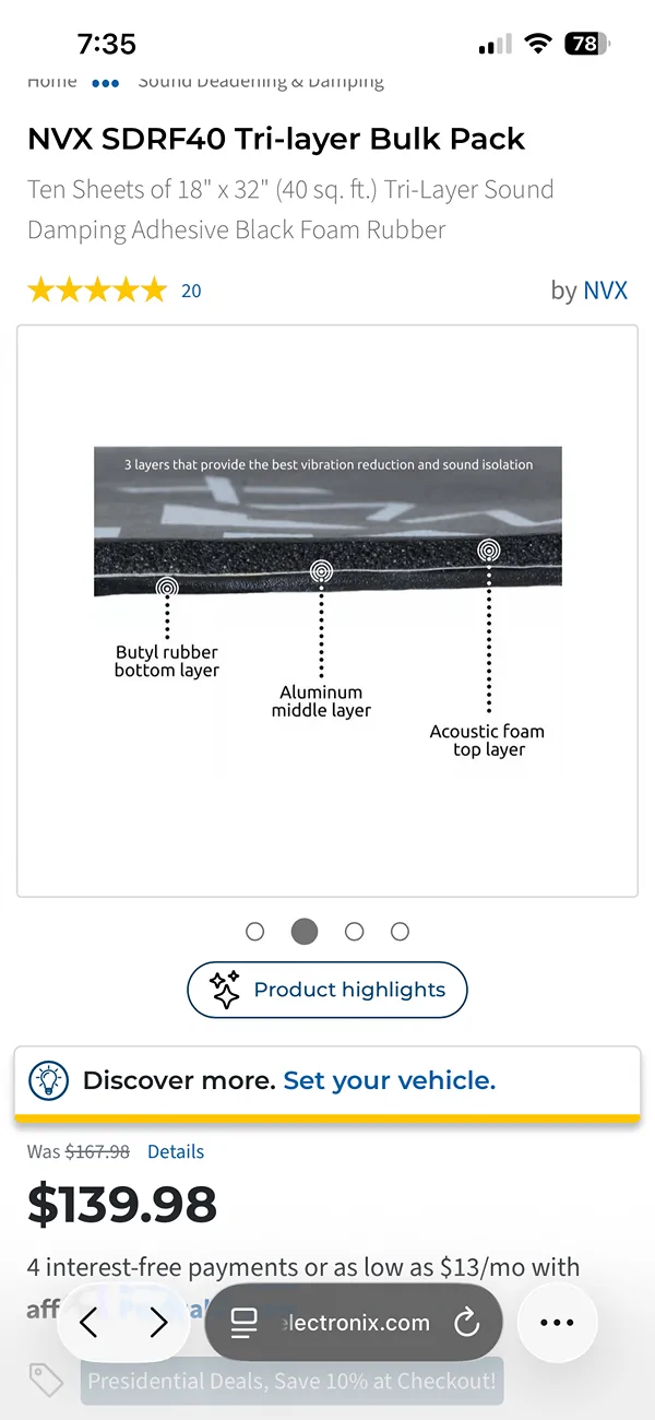

I appreciate the info! I’ve been trying to figure out what I want to go with. Seems like most people say either just go with Amazon or buck up and buy Resonix. I might do the NVX triple layer since I can get 40sqft for $140.
