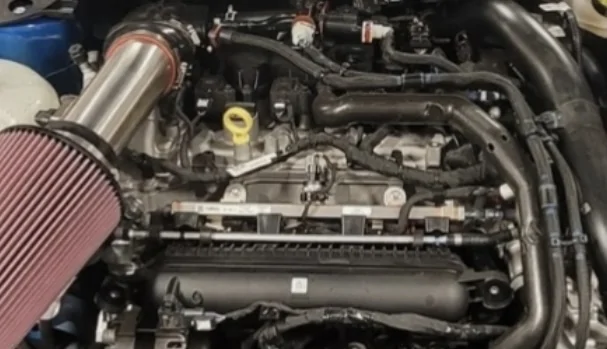

Only the “refreshed” 25/26 Maverick 2.0L EB and the 6.7L Power Stroke diesel engines have aluminum valve covers.
All other current Ford engines have plastic? Coyote, Raptor, 3.5 EB, etc etc.
Not sure why…
Edit…I’m guessing the 6.7L Power Stroke Turbo Diesel has metal covers because it is a beast. But why the refreshed 2.0 EB?
Ford Maverick Aluminum Valve Covers IMG_0942

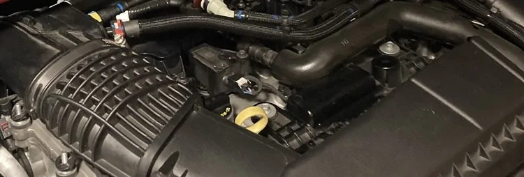

The aluminum valve covers on the refresh are pretty - but you have to remove the OEM air box to see them:)
Ford Maverick Aluminum Valve Covers IMG_0943
Ford Maverick Aluminum Valve Covers IMG_0944
