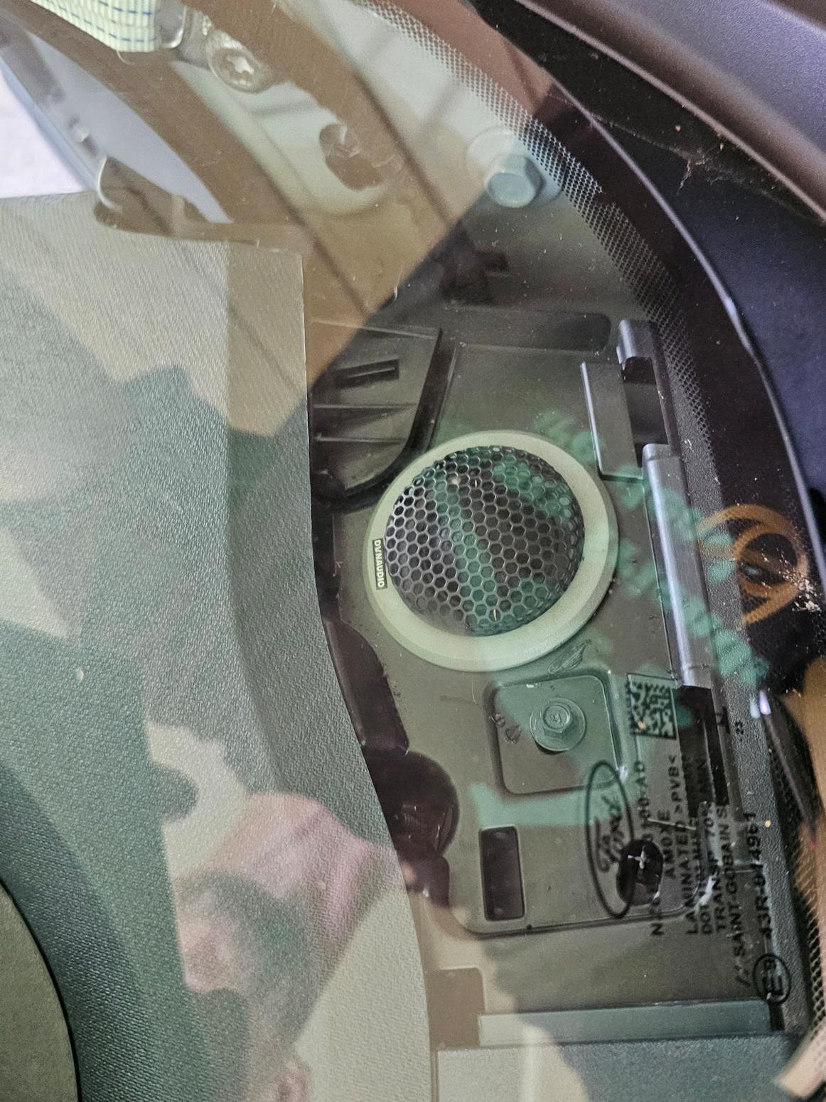

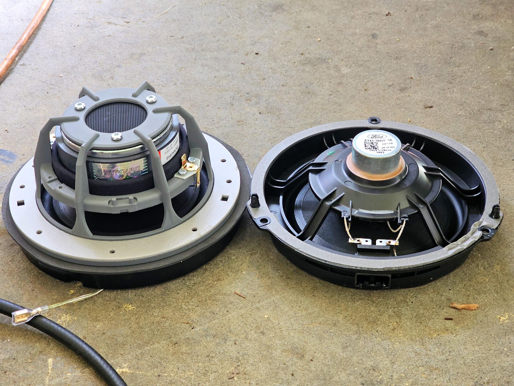

I forgot about this thread! I did end up putting tweeters in the dash, albeit with modified grills. I also heavily modified the dash cutouts to fit some larger Dynaudio tweeters. I modified the doors to fit the Dynaudio 6.5's, which have a massive cast basket on them. The fact is, you'll never the same quality of sound with coaxials as you will with a proper component set. That's why I decided to go through the trouble of making the Dynaudio components fit. There are other component sets that will fit much easier, but I wanted to go for it in the SQ department, so...

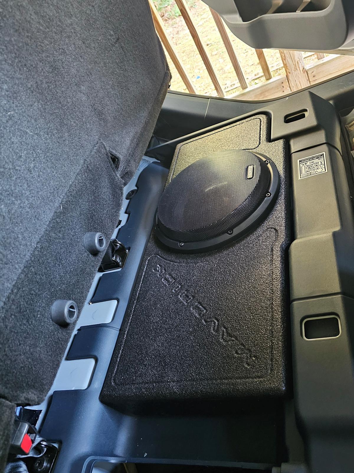

The final setup turned out really well for my tastes. I'm running the Dynaudio components up front, with Polk 4" in the rear. For the sub, I'm using a Hertz MPS 250 S2 in a sound decisions enclosure. It is all controlled by an Audio Dynamics DSP feeding an Audison 5 channel amp. I also went into Forscan and set the Factory special EQ to Flat, which helps the low bass tremendously. The system sounds wonderful, without being fatiguing or harsh. I adjusted everything to have as warm a sound as possible without loosing too much detail. I drive A LOT, so harsh tweeters/highs would get annoying really fast.
Long story short, I'm glad I put in the effort to make some good tweeters fit in the dash. The other most important thing I did was using a DSP. You can get really great sound with a ton of different setups in these trucks, provided you're using a DSP of some sort.

I assume you had to enlarge the tweeter opening for your Dyn tweeter. Did you happen to look to see how much depth you had once you enlarged it? I'm going to try and fit a 2.5" mid range in there but not sure how much depth there might be.

Oh yeah, I basically had to cut out every bit of the factory "bracket" part the oem tweeter snapped into. We'll just say a 60 watt soldering iron with a custom tip was involved, lol. In other words, I turned my soldering iron into a hot knife, and it was not fun to do. The top of the Dynaudio tweeter is all the way to the black grill cloth. If it was 1mm taller, it would be resting against the cloth. As far as depth, I don't think there's enough depth there to put a 2.5" mid if you're wanting to flush mount it. I had to bend the terminals of the tweeters for them to clear, fwiw. You'll likely have to do a pod of some sort to mount a mid up there. You may possibly be able to get a dome midrange of some sort, but it still won't be easy. Also working under that windshield is a sucks.

How does the Hertz sound in that box? I got the dual box from SD and 2 of the MPS250s. Just waiting on an install date for the Audison F8.9 DSP/amp and likely a sr1.500 for the subs.

Where did you order that sub box from? It is wicked awesome. Thanks

Fitting a 2.5" in the dash would require a level of butchery that very few would feel comfortable with. You can make a hole in the dash panel that diameter, but I'd be surprised if the speaker could actually be put in the hole from the top because of the windshield being right there above it on an angle. Before thinking any more about it, find a piece of foam and cut it into the shape, dimensions, and depth of the replacement speaker. Then put it up near the windshield to help visualize what kind of installation clearance issues this might present.
