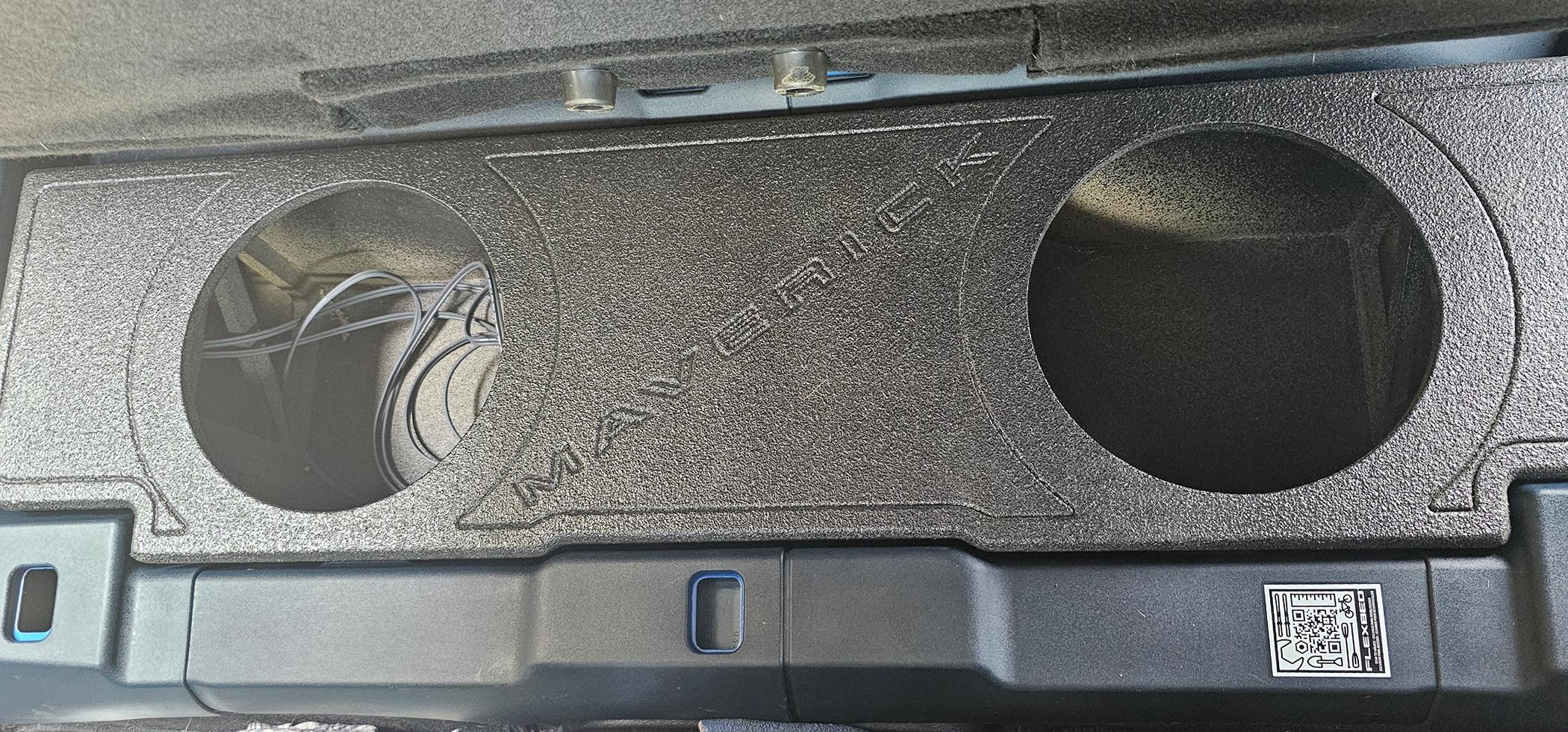

How does the Hertz sound in that box? I got the dual box from SD and 2 of the MPS250s. Just waiting on an install date for the Audison F8.9 DSP/amp and likely a sr1.500 for the subs.
I love the Hertz sub! It sounds great, and I haven't even found it's limit yet(probably never will). It is a good combo of SQ and "authority". It eats up every bit of the sub channel on my Audison SR5.600 amp and asks for more. For my tastes, any more sub would over power my mids/highs. I imagine two of them would be all anyone could possibly want, unless you're just going for maximum sound levels. I think you're going to be VERY happy with them, just make sure you got the 2 ohm versions to get the most out of that sub amp you're planning on.
I actually ordered the 4ohm versions. There's only a 200 watt difference in output from the amp from 2ohm to 1ohm. I figure this will give the amp a bit more control over the speakers and tax the electrical system a bit less. I think I will be pushing the limits of stock electrical as it is with the 2 Audison amps. My other sub amp option is the D'amore 1500.1. I have it just sitting new in the box. It puts out 100 more watts at 2 ohms, but is huge in comparison. I'm not sure there is space for it.
I would swap them for the 2ohm if you still can. That's a mistake underpowering them, and my Key 500.1 plays just fine at 1 ohm 500w. It is not stressed, overrated/mis-rated, etc. There is no discernable distortion or noise.
I thought about it.... but this guy seems to know his stuff. If I was doubling my power instead of going from 800rms to 1000rms it might be worth it. The video is a little long-winded, but makes sense.
While he's not wrong in a general sense, it really depends on the amp. Audison lists the amp with a damping factor(control) of greater than 300, which is great, but it doesn't specify if it maintains that damping factory as the ohms go down. I don't think you'd really notice the difference in "control" if you were running 1 ohm. Don't get me wrong, the system will sound great with the 800 watts. You'll just be leaving potential on the table running 2 ohm. With the two amps you'll be running, I don't think current draw will be too much(even at minimum ohm loads). Those amps are incredibly efficient for what they do, and that's one of the reasons I went with Audison myself. Those subs will eat up 800 watts like its nothing, and can most definitely handle more. If its a matter of not wanting to go through the trouble of swapping the subs out, I get that too. Truth be told, your ears will be bleeding from the mids/highs before those subs run out of steam as is, haha.

Where did you order that sub box from? It is wicked awesome. Thanks
Look up Ford Maverick Audio on Facebook. He has a page and I just ordered it via private message with him. It's Chris from sound decisions.

People don't realize how well those enclosures are built too! Very solid sub boxes from Sound Decisions with great bracing, and that bedliner covering is super tough.
