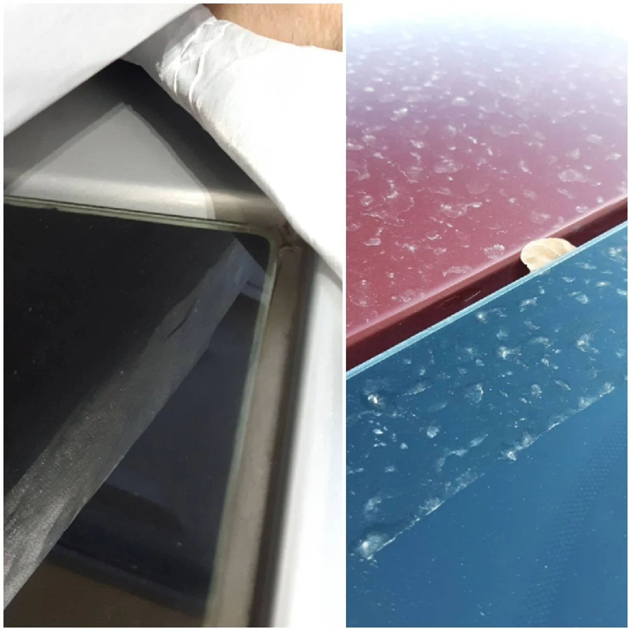

Bugflector 2 here . no additional noise here . no noise before install .
Ford Maverick Air Deflectors reduce wind noise? 20220509_141016
