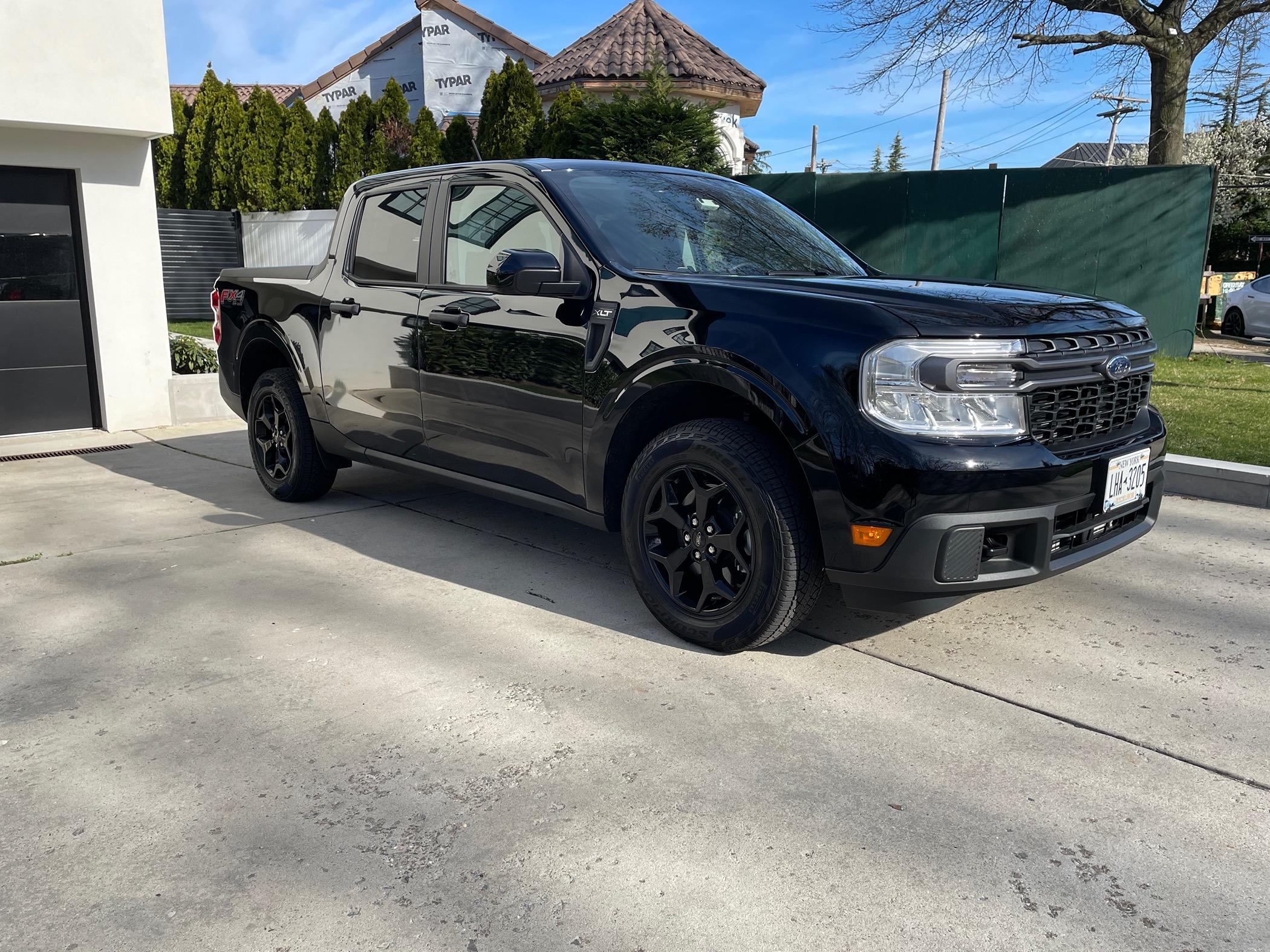

Finally removed those front wind deflectors. Took about 12 minutes with a 7mm socket wrench. Reinstalled 3 screws on each side to keep the wheel well material flush, and I’ll be adding some black gaff tape underneath to cover the holes. I’ll keep you posted on MPG difference or feel difference. Cheers! Looks way better IMO…. No more bottoming out when I go “off roading” to the Dunkin drive thru…
Ford Maverick Thinking about cutting off the wind deflectors IMG_0373

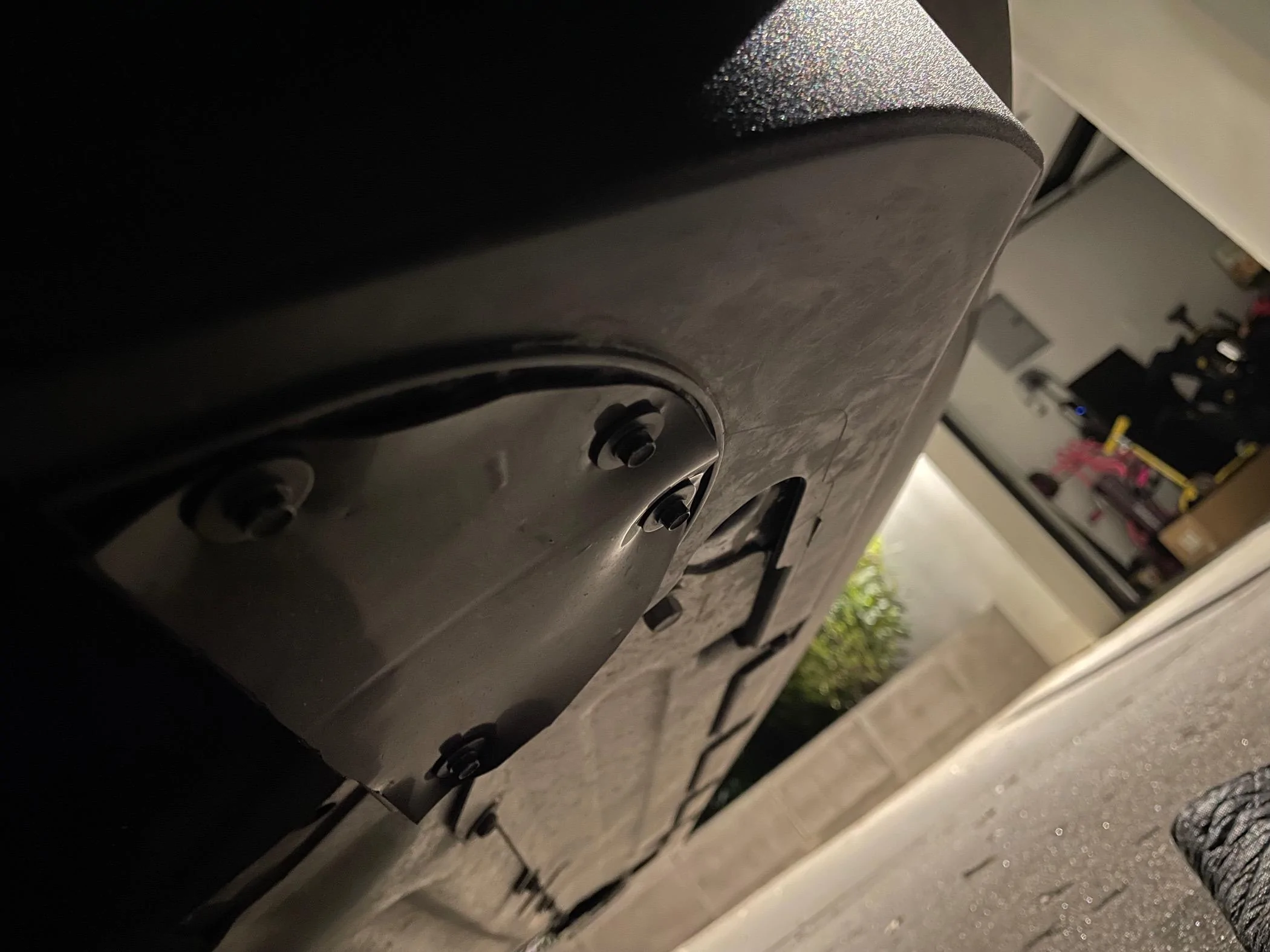

Update - never looking back on those strakes/wind deflectors. Love how my fx4 maverick looks without them, and no more bottoming out! I picked up a sheet of black rubber on Amazon, and traced, cut, stretched, trimmed and installed 2 debris covers. Here’s a pic, cheers! - Oliva
Ford Maverick Thinking about cutting off the wind deflectors IMG_0848
