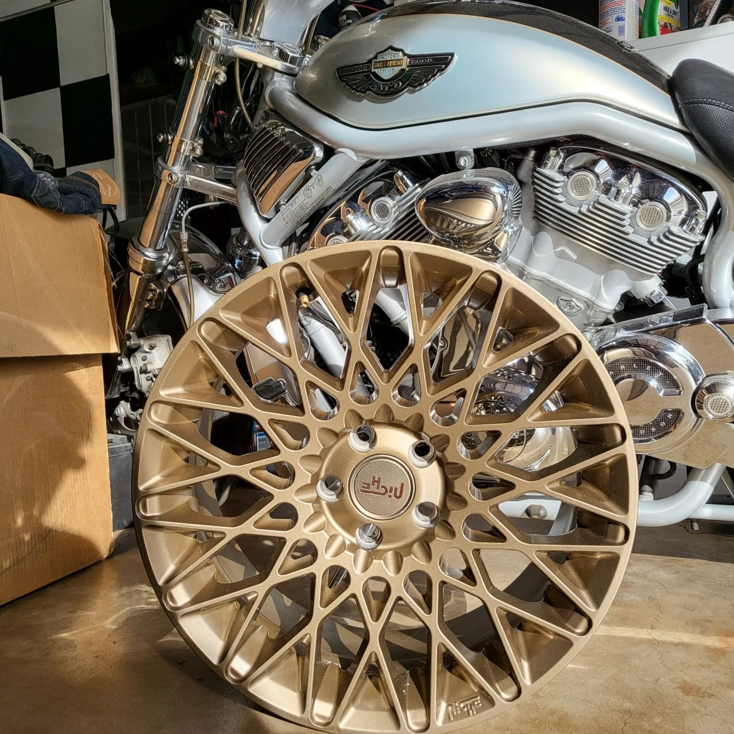

Ford Maverick Aftermarket Tire and Wheels. Anyone find hubcentric wheels? 20221226_145614_resized

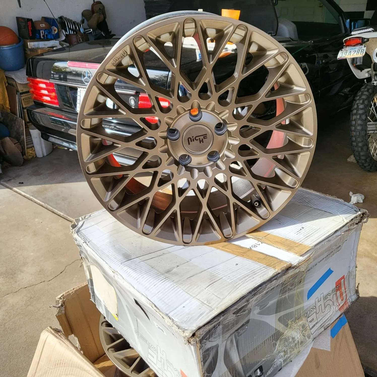

Ford Maverick Aftermarket Tire and Wheels. Anyone find hubcentric wheels? 20221226_145846_resized

Just did an UBER SCORE! on the 18x8 Matte Bronze Niche Wheels above. Can't wait till my 23 Mav hybrid arrives (playing the waiting game) These are 5x108 with Et +40. should fit perfectly (probably will do a 1 inch level kit) just for looks. Fingers crossed to get a hybrid next year.
Cheers!
