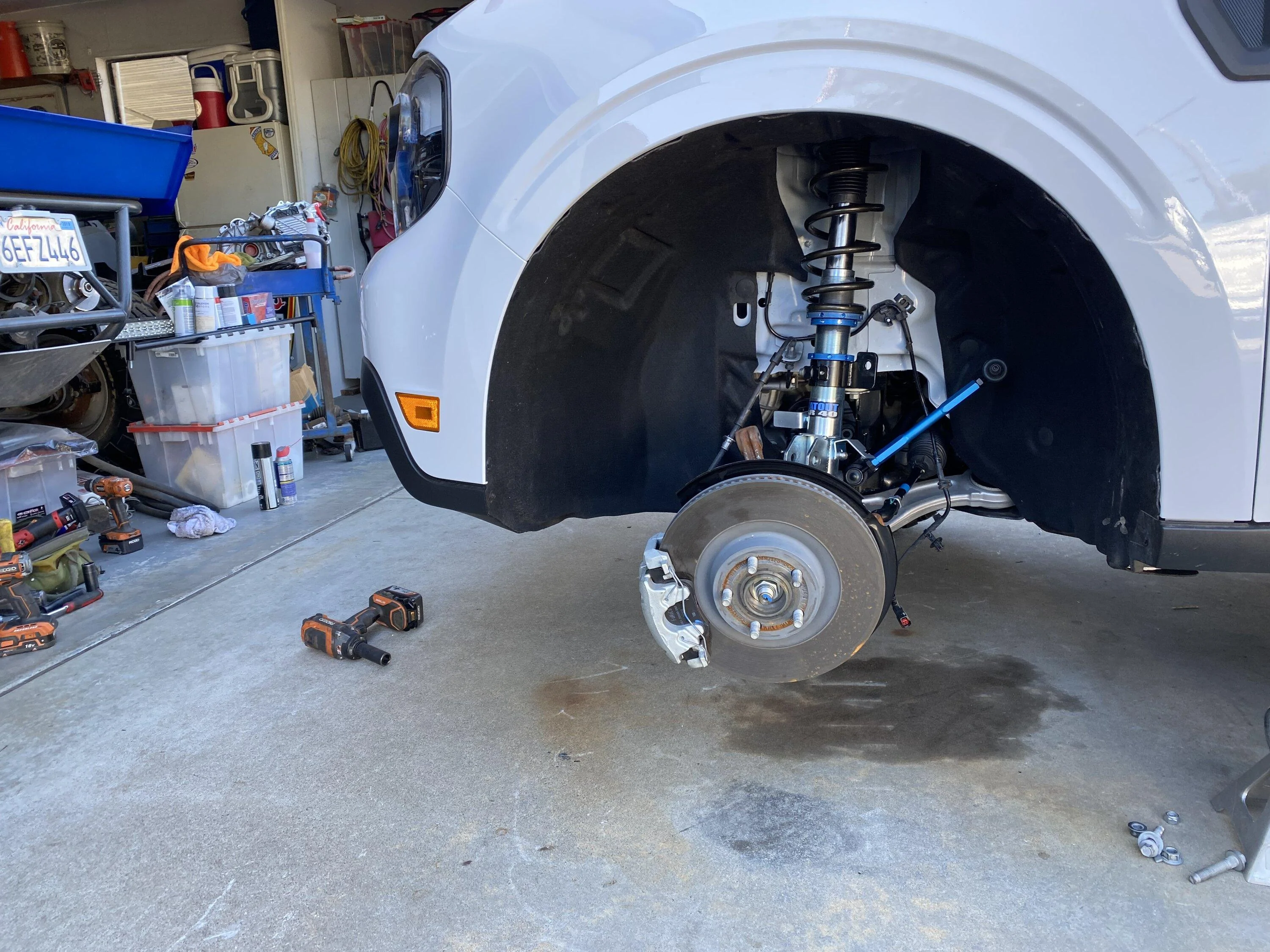

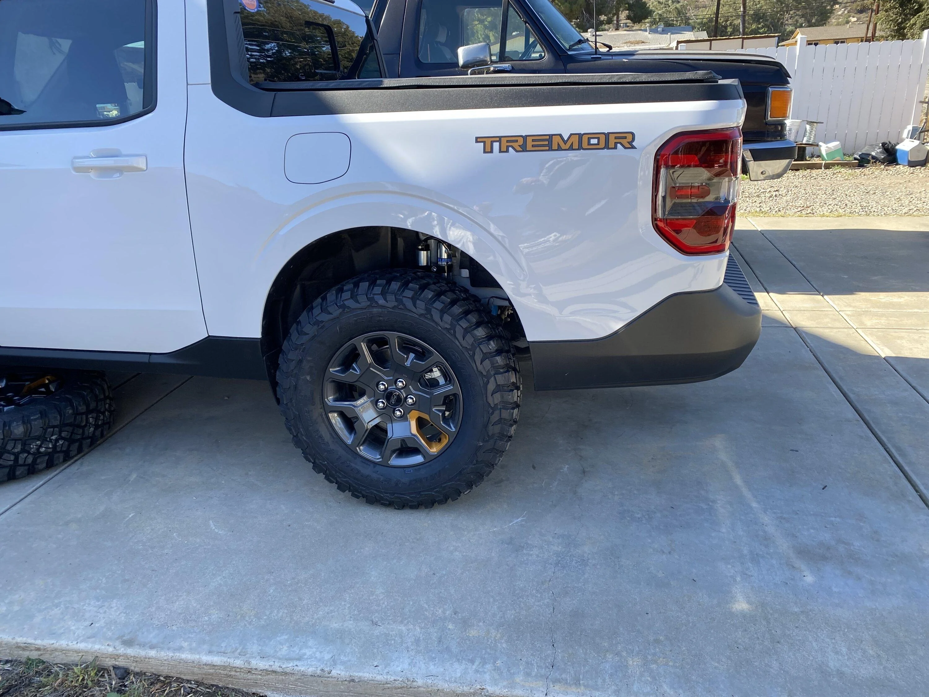

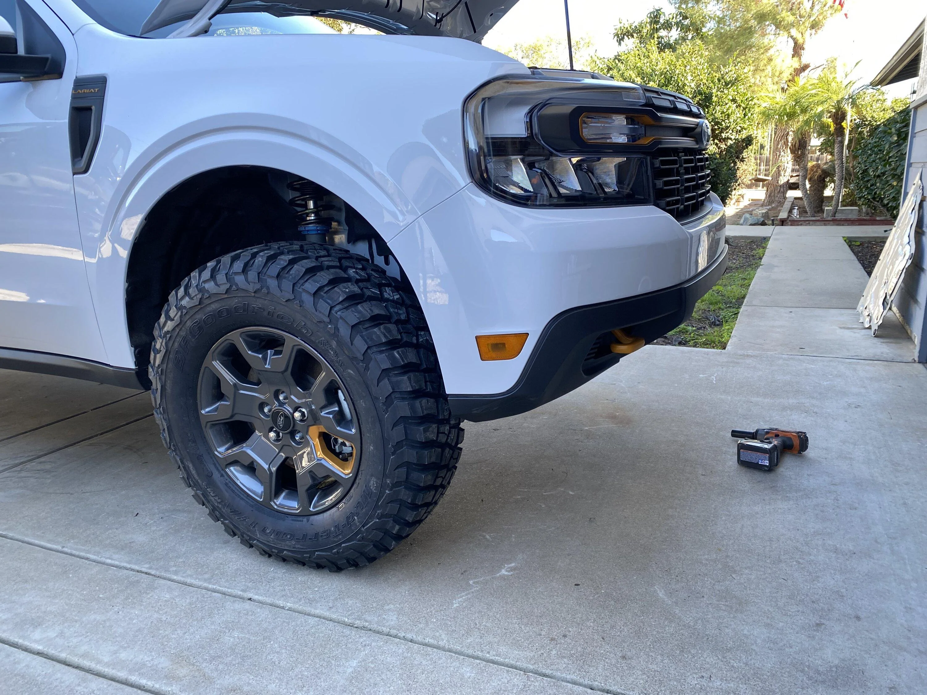

Looking at cutting rear plastic level with upper line on plastic cover and tapering down to bottom at rear of wheel.
will then be adding a rear pre-runner style sliding tube bumper under the trimmed plastic edge up to rear subframe so as to add a skid plate for the rear diff.
already have exhaust ordered for in front of tire side exit,and am putting on a gr40 suspension setup from flatout suspension .
once I finish the rear I will post some pics .
the front is going to be a little tricky.would love to do some fiberglass fenders and bedsides too.

So far only 3/4 “ in rear , and a little over 2” in front .
Getting alignment tomorrow . Got 32” big muds mounted up.
May have to go longer on springs , have to see how the ride is

Will also be pulling rear bumper and front plastics this weekend , gotta figure out how to pull ( flare rear fenders and make some molds for front fenders ! Wanna add some stance to it and bigger openings .would like to be able to get 33x10.50 tire under it ! Will try to take pics .just got the wheel liners out all around but now dark out .
