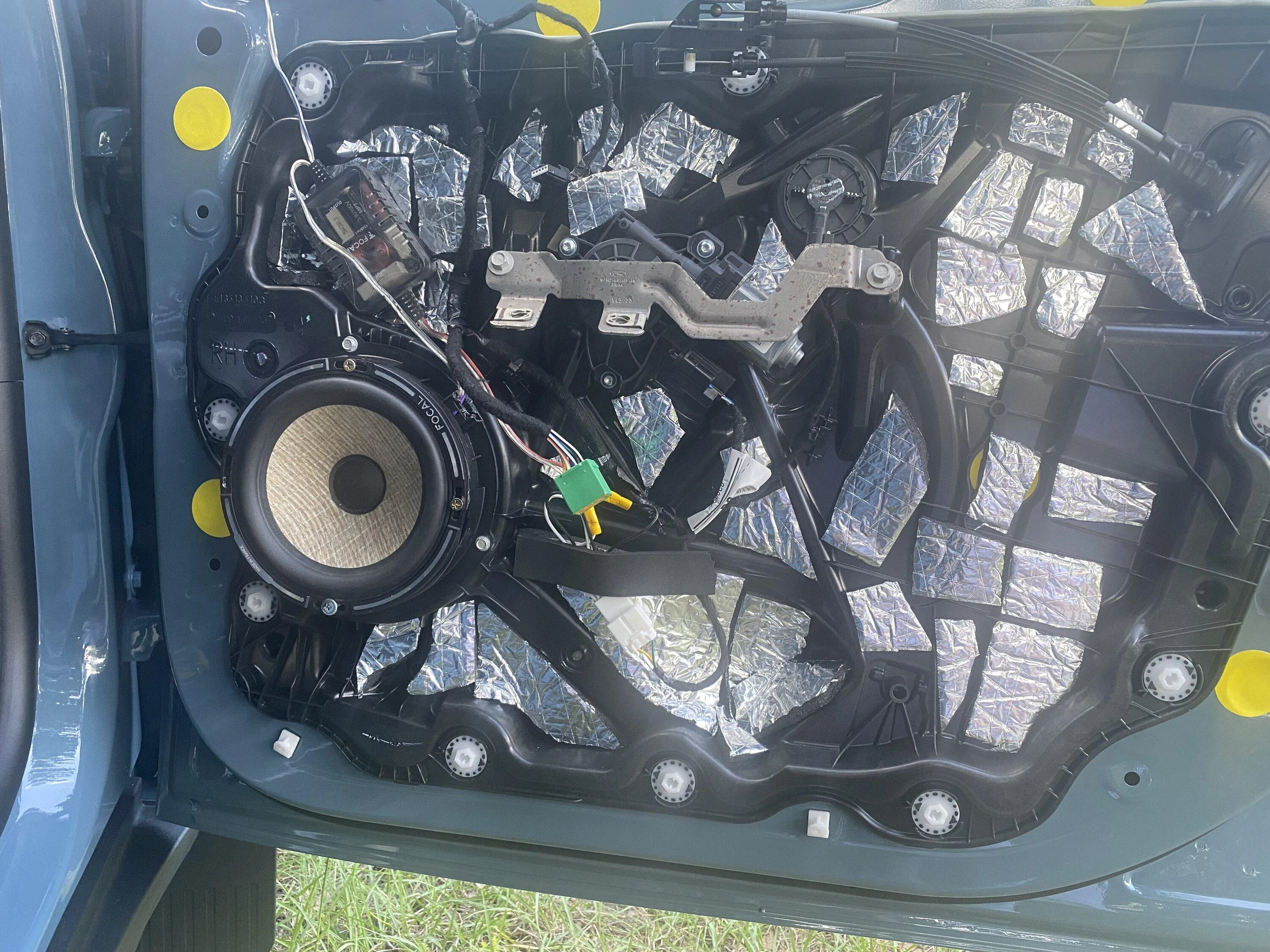

I have a 2023 xlt, hybrid, lux package. I changed out all my stock speakers for focal components. I am adding a JL 10” sub and a NVX NFA501 5-channel amplifier. I am having it installed w/ T harness & LOC.
To be able to use my fader, they are recommending the audiocontrol. LC6i. I noticed that this model does not have Accubass. If you have experience with this, please give me your input and let me know if this is the right LOC for me. 😊👍🏻
is the LC2i just as good? Is a fader over-rated?
thanks! George

Sorry to bring up an old thread but can I ask what you ended up doing?
Also, is that the Focal Flax Evo PXE or another model? Or are they a slim version? I didn't think they would fit depth wise.
I ended up going with an LC2i. It didn’t seem to make sense to have a fader situation with a 4-channel LOC IN SUCH A SMALL AREA..
