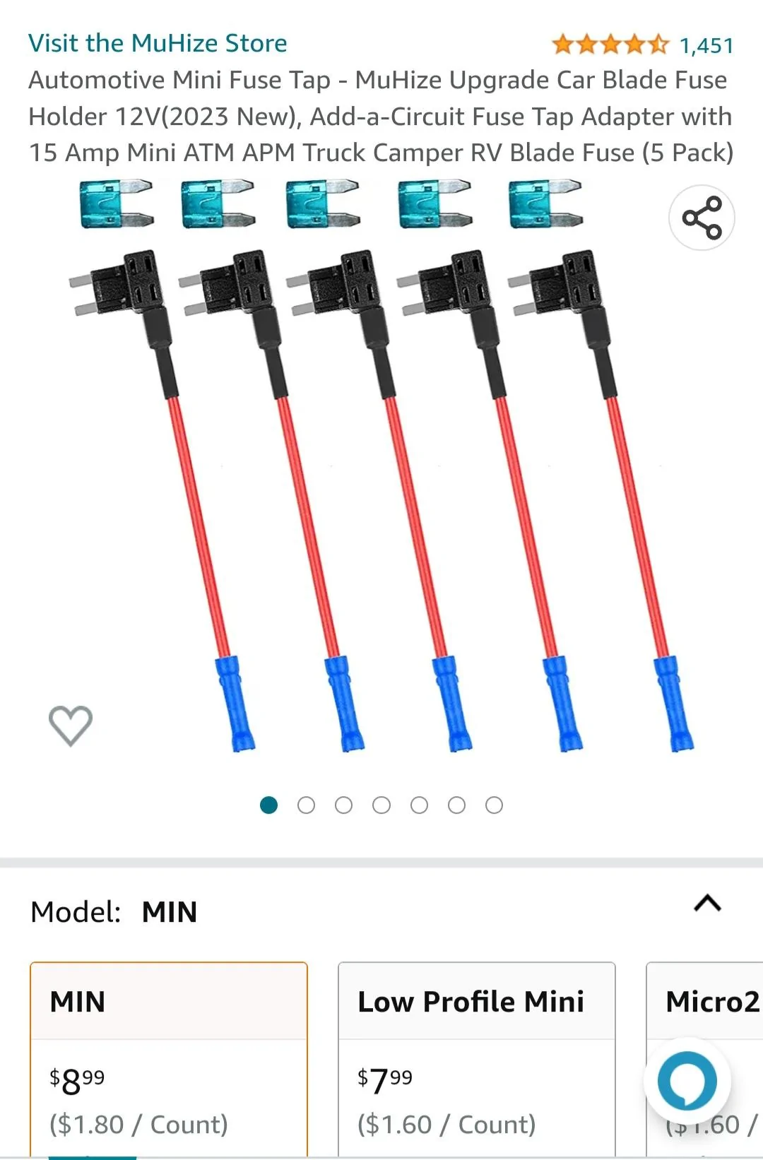

which fuse I should use install dash cam non ford one ? Please ,help !
no, it will not.thanks ,so slot 3,6 will be ok for the dash cam in the parking mode

fuses 3 and 6 are 12v switched. meaning dashcam gets no power when the ignition is off. this happens instantly btw, it will not wait for the door to be opened as the infotainment and driver's instrument cluster will do.
if you instead connect to 12v constant - and there are many fuses to pick from - your truck will go into Deep Sleep eventually and turn off everything including the dashcam. you can try it anyway, maybe your dashcam's current draw is low enough it will work sometimes when parking for a short while. in Deep Sleep you will not be able to use remote start or unlock the doors from Fordpass.
