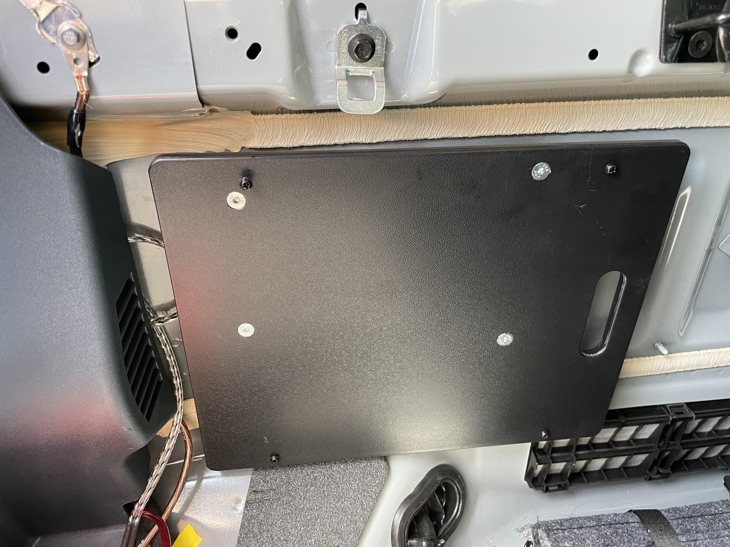

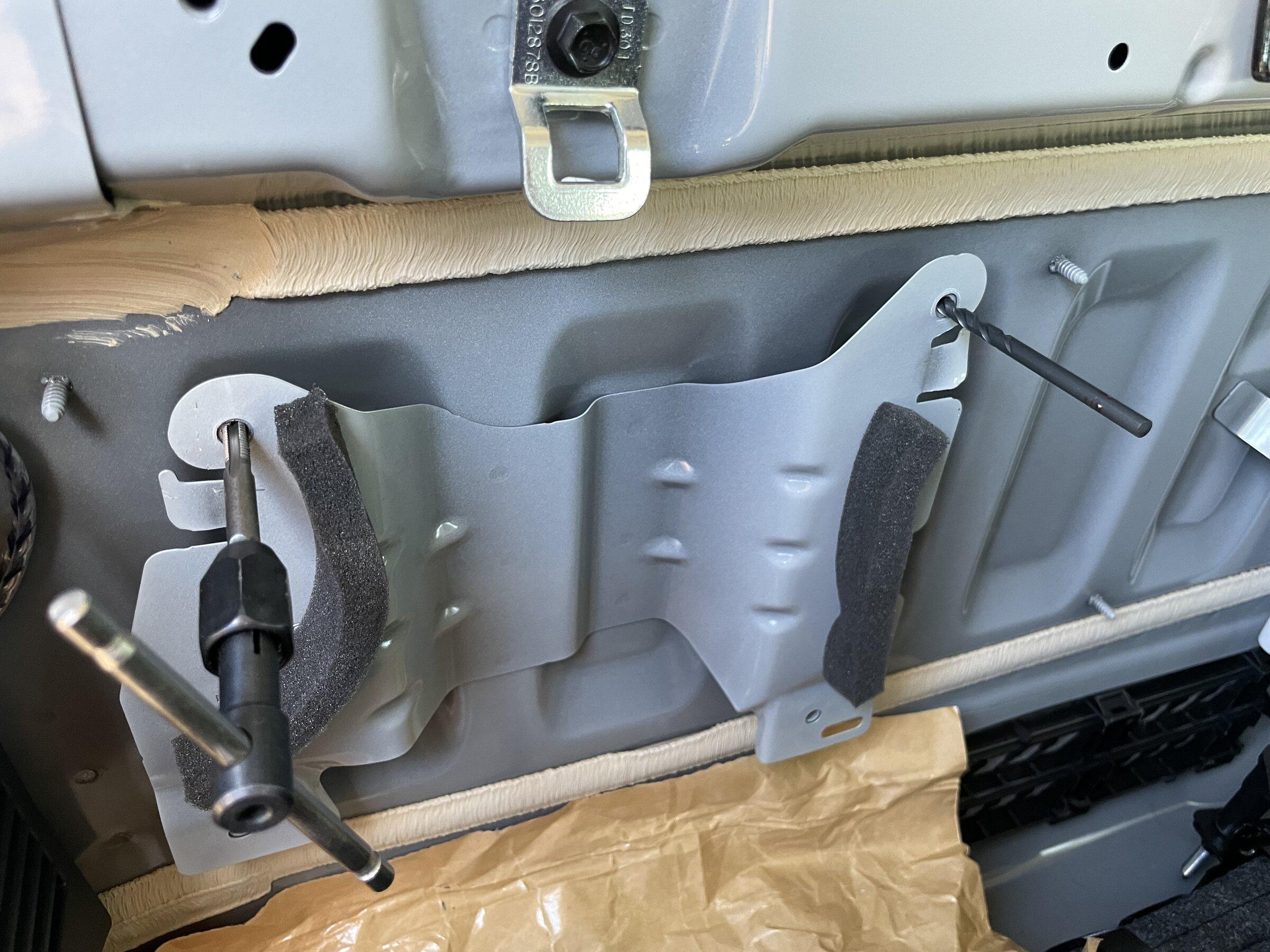

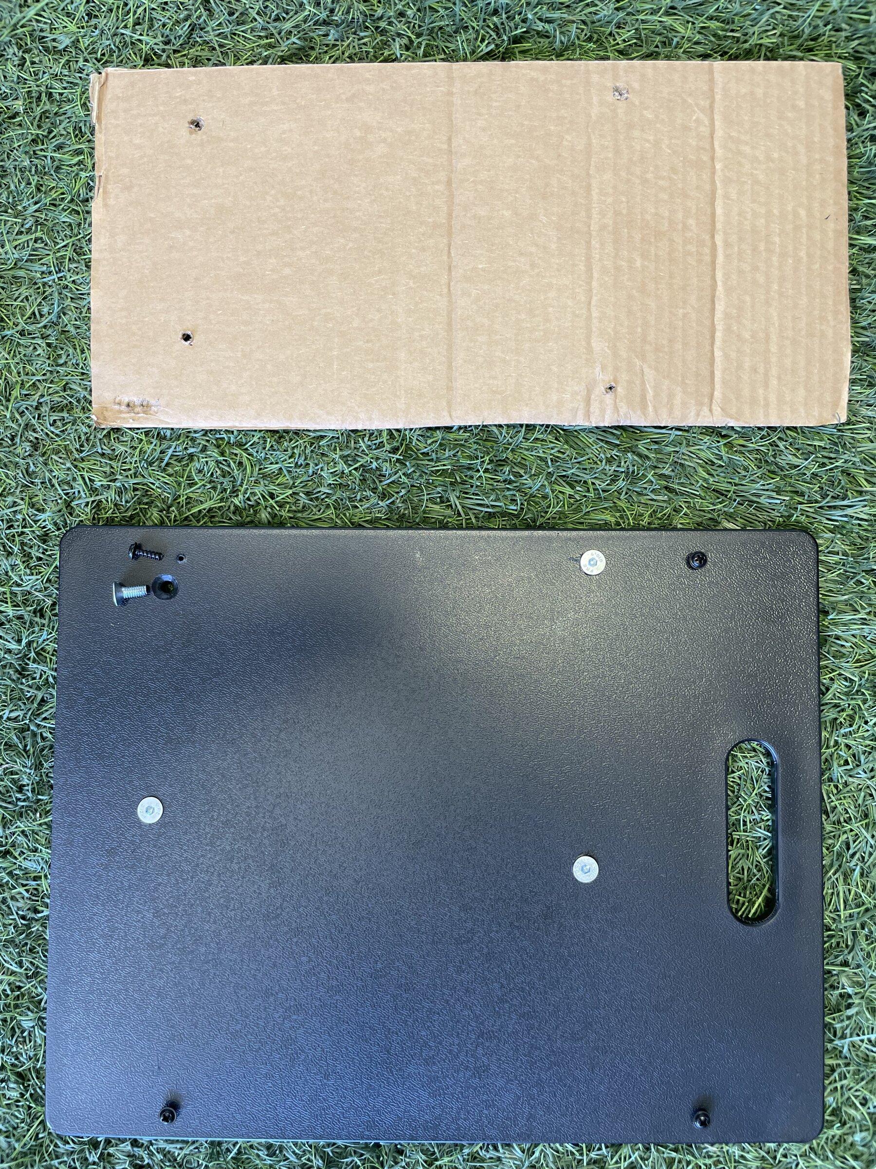

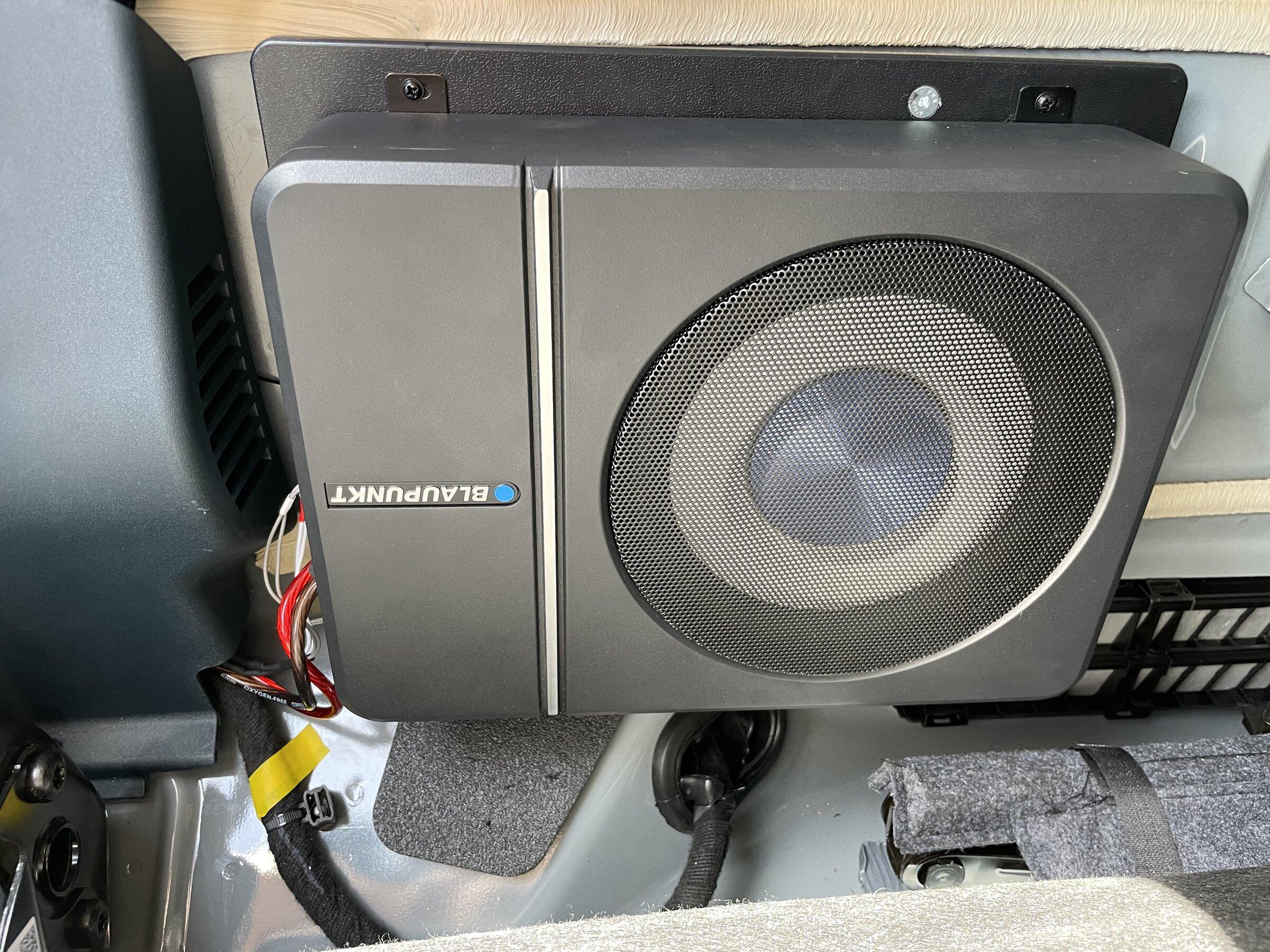

Found a black plastic cutting board at Ross. It was perfect for for what I needed. I used cardboard to make a template of where the holes live and transferred that to the cutting board. Drilled and countersunk them, predrilled amp holes. Inside the cab I used the stock amp “butterfly” mount. Unfortunately have to drill and tap the little inserts I thought are threaded. Haha. It sounds complete.
Ford Maverick Active Powered "All-N-One" Subwoofers 32D27EE4-8E88-4DCD-9FFA-3E1C53E44598
Ford Maverick Active Powered "All-N-One" Subwoofers 3ED8DD03-466E-4510-8D24-0BC9D98D3392
It sits straight. Camera perspective is wonky
Ford Maverick Active Powered "All-N-One" Subwoofers 2CF544D7-B53C-41AD-B23D-32C7902BDAA3
I didn’t think through the actual fastening of the amp to the board. I had to use one of my misses mirrors to find where those pesky screws went
Ford Maverick Active Powered "All-N-One" Subwoofers AC52072F-AABF-49F9-BE82-1AEEAD3045D6
“Finished” look with the cutting board. Has a fairly even reveal all around the edges. No wired vibrations or annoyances from that super flimsy sheet metal mount.

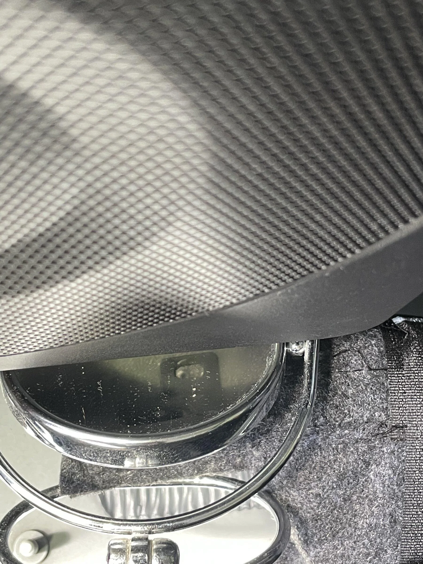

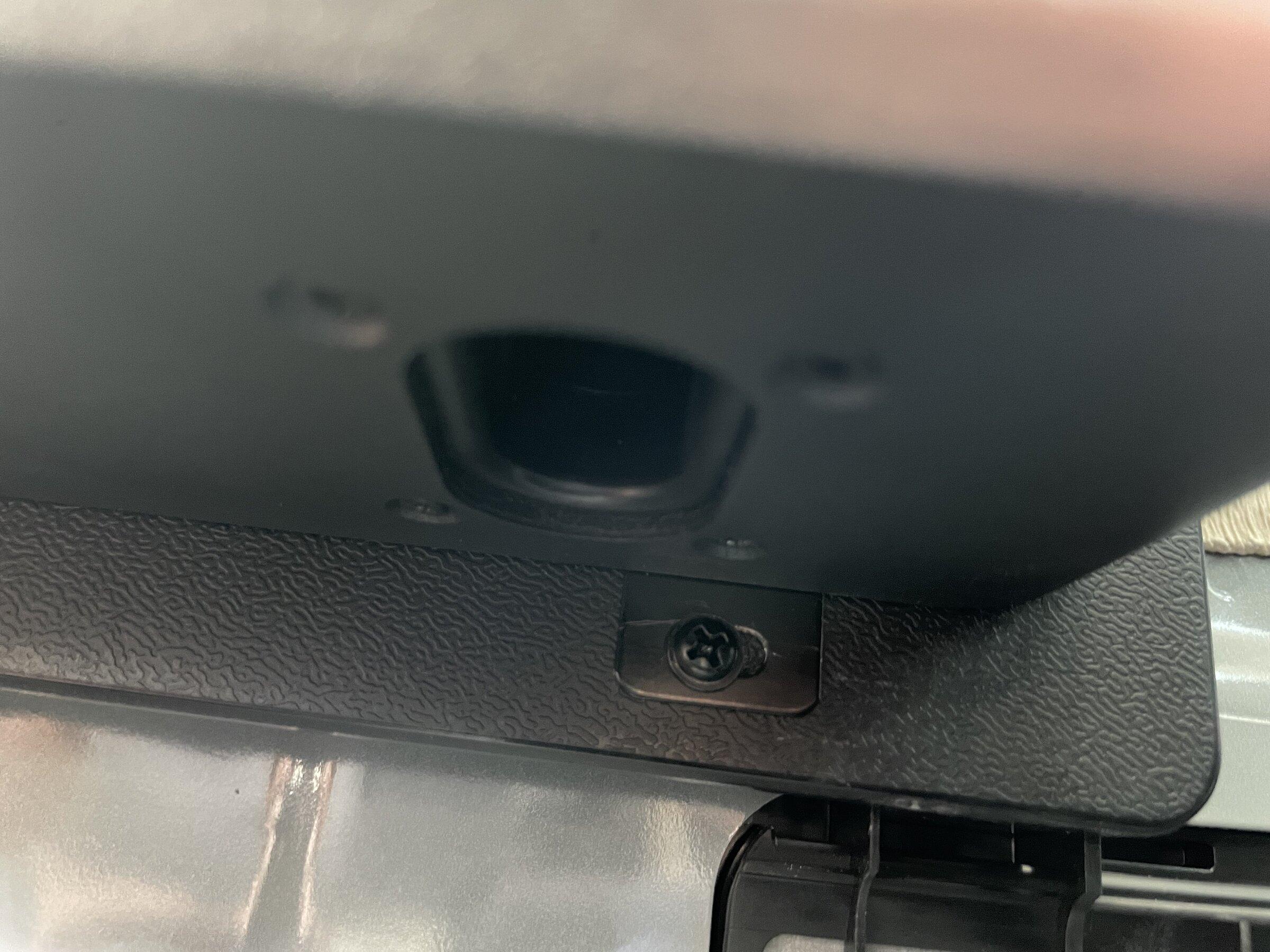

Two things I forgot to mention. One of the reasons I chose the Blaupunkt was because of its port. Of which made nearly no difference which way it was pointed.

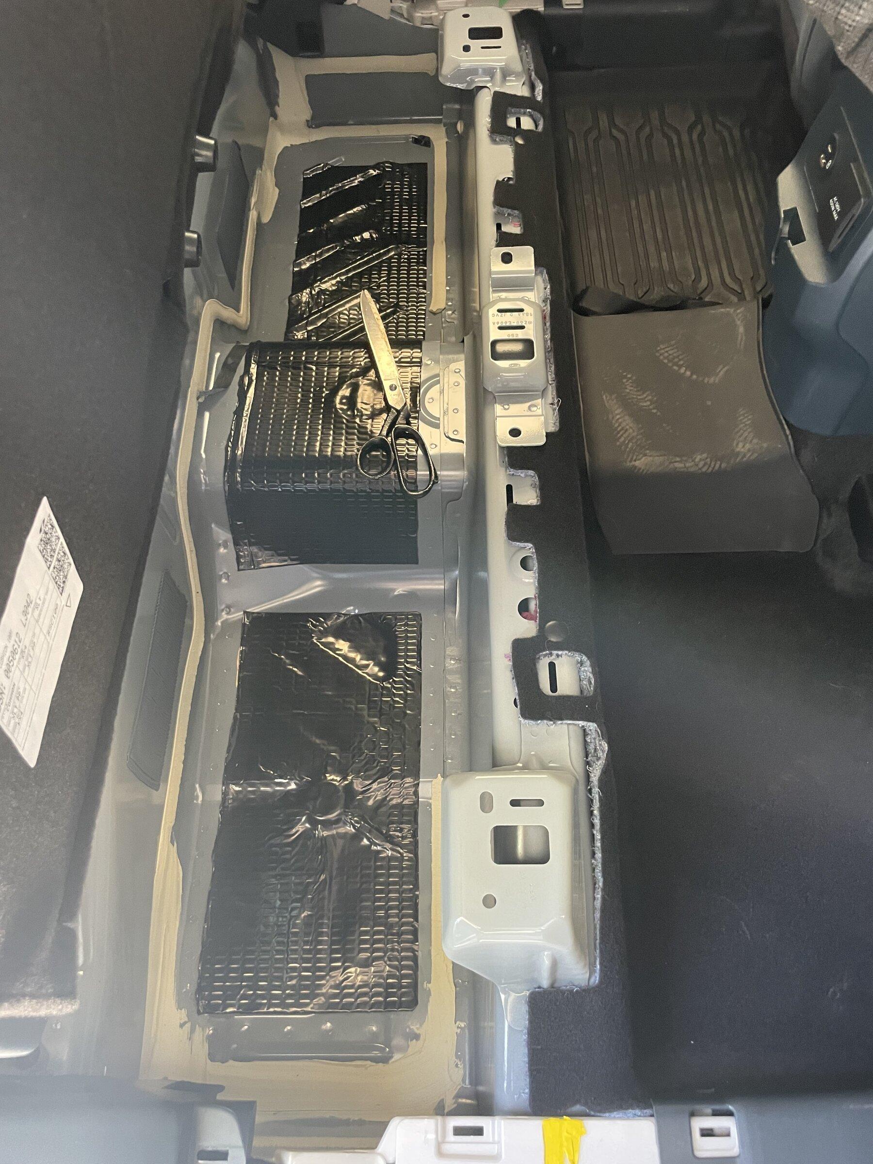

The other noteworthy thing I wanted to mention was the floor under the backseat bins. That was the biggest offender on the “tap around” the sheet metal for sound deadening. Discovered this while running wires. I will probably have to pull up those bins again to stuff some foam in here or there. Honestly I dread pulling those up, because I crippled one of the tabs that go under in the back. I pulled nearly every piece of this plastic interior out, and I knew I would have one zinger. Literally the last piece. Lol!

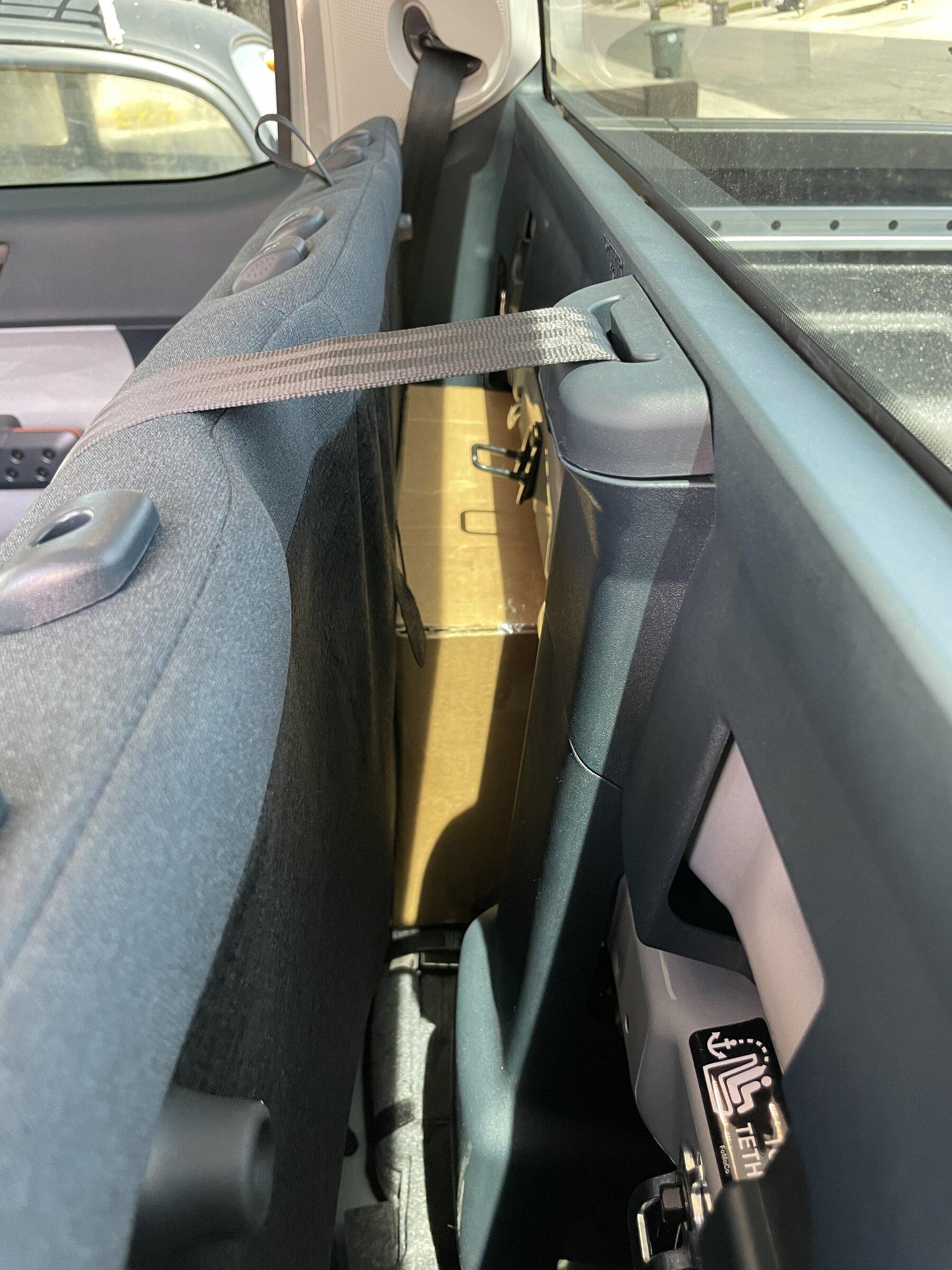

I had a minute to goof off with so I made a dummy analog of the RockFord Fosgate P300-8P. It wasn't even close. I wanted to start with the larger sized stuff and cut down my dummy until things fit 🙃
I did the same but I started with the 10... not gonna happen. Without modifications
