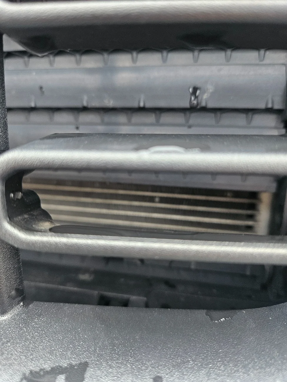

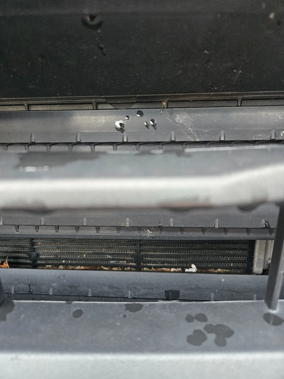

My 23 hybrid is missing one from the top set and one from the bottom. Kind of defeats the purpose of warming up the engine.
This was done to mitigate the engine fire recall on the 2.5L ICE on 22 and many 23 Hybrids. Even if your vehicle wasn’t part of the recall Ford likely shipped most of them that way, since they expanded the range of the recall several times.
