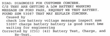

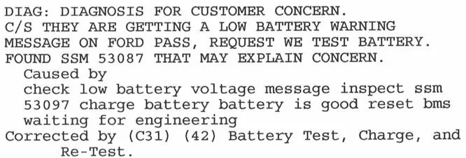

Update- I took it back to the dealer 2/10/25 and they apparently fixed it with a battery test, charge and BMS (Battery Monitoring System) Reset.
The service advisor blew me off until I had him check inaccurate sync3 deep sleep notifications (SSM 52307) and intermittent battery drain when ignition is off (SSM 53087)
We just finished a full week of frigid weather with temps remaining below freezing for the entire week, and the Ford Pass app remained fully functional, incl. remote start! He indicated that Ford is still expecting a SW fix for this 1Q25.
Note- I left my AA Wireless 2 adapter connected since the service, and it has worked as expected, so it was not the issue.
Detail from the service 2/10:
Ford Maverick AA Wireless 2 causing FordPass app to be disabled. 1740177344022-s6
Ford Maverick AA Wireless 2 causing FordPass app to be disabled. 1740177140127-vo
