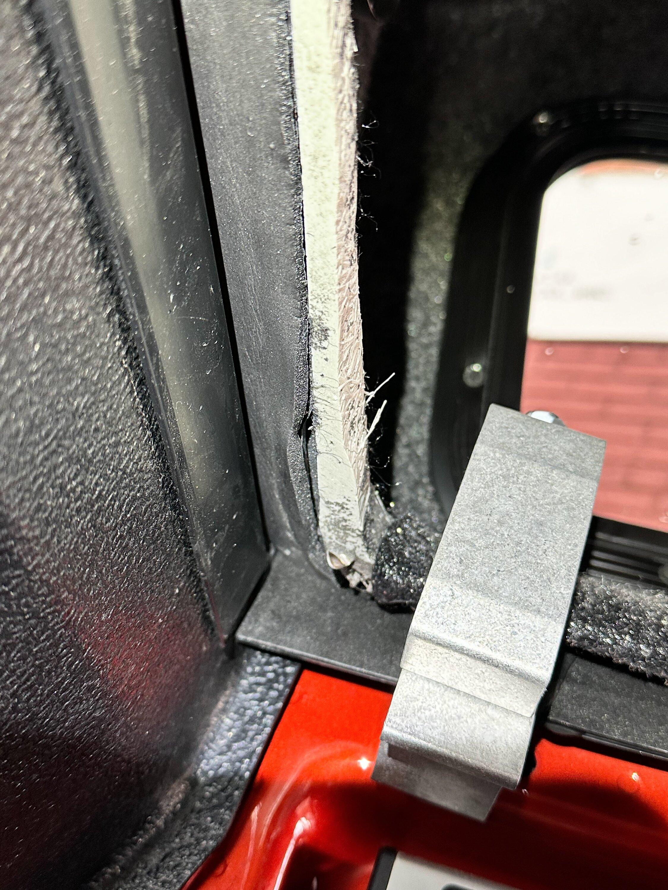

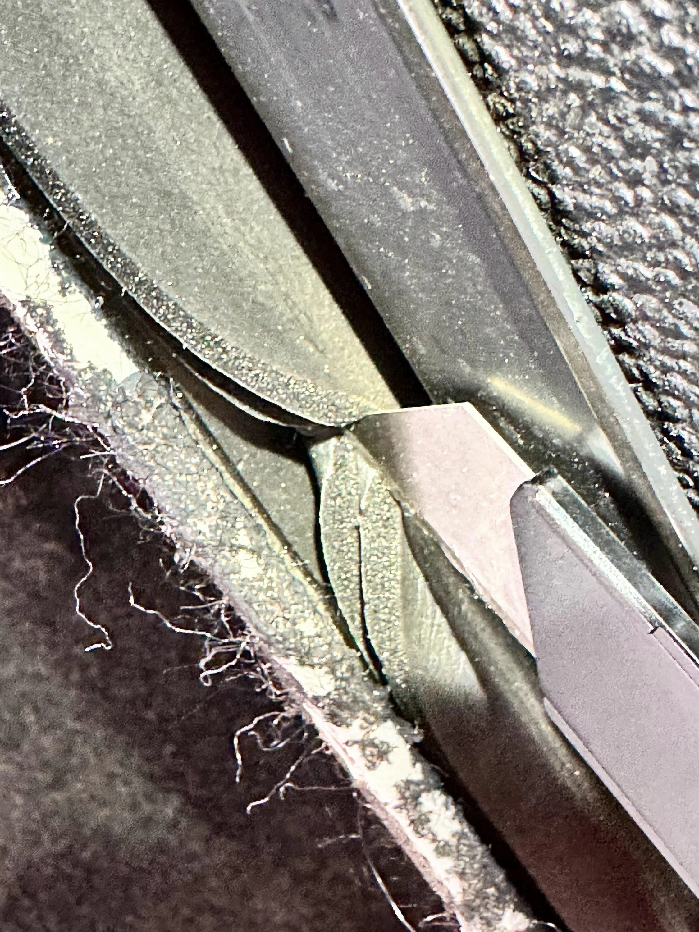

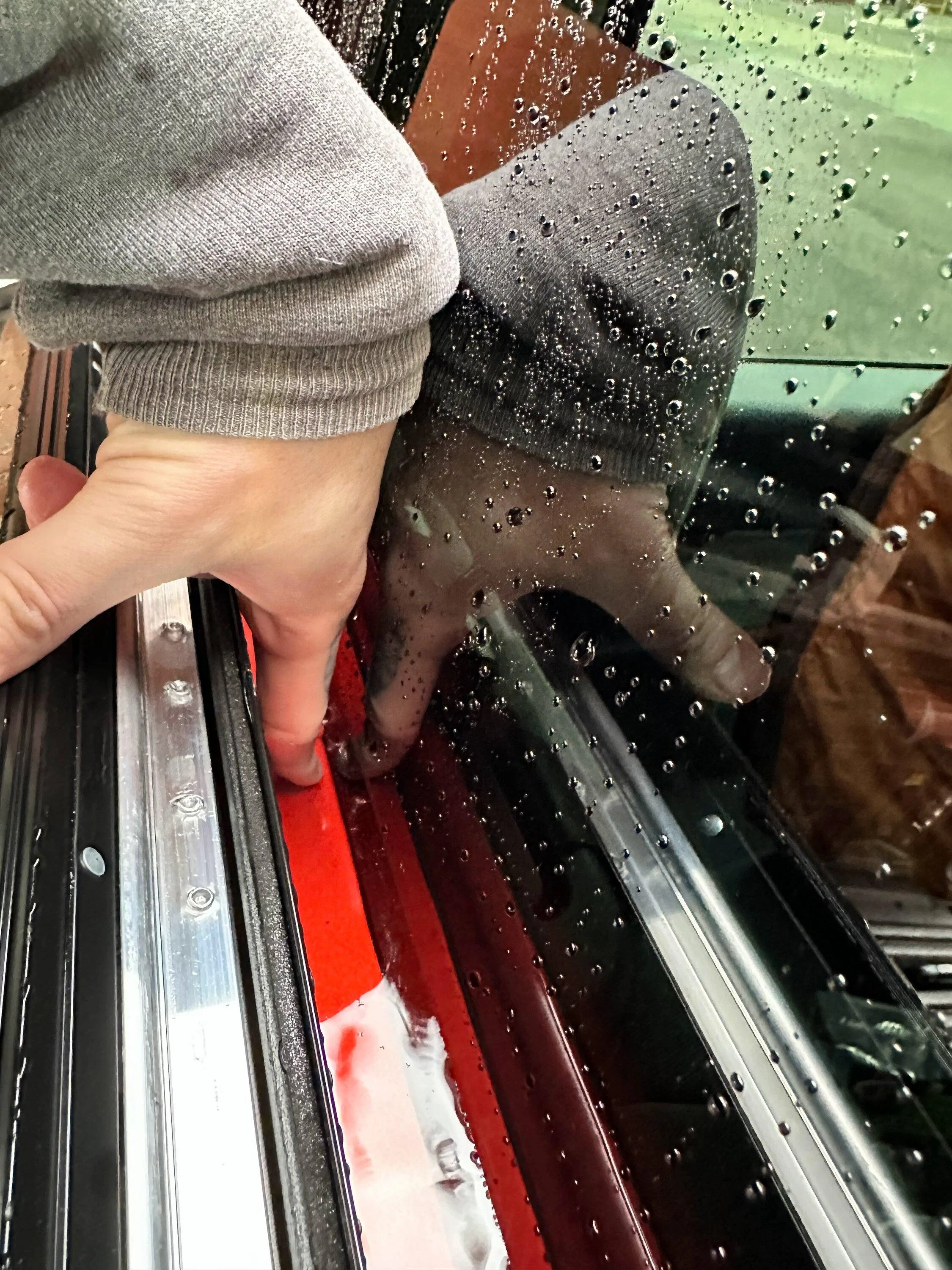

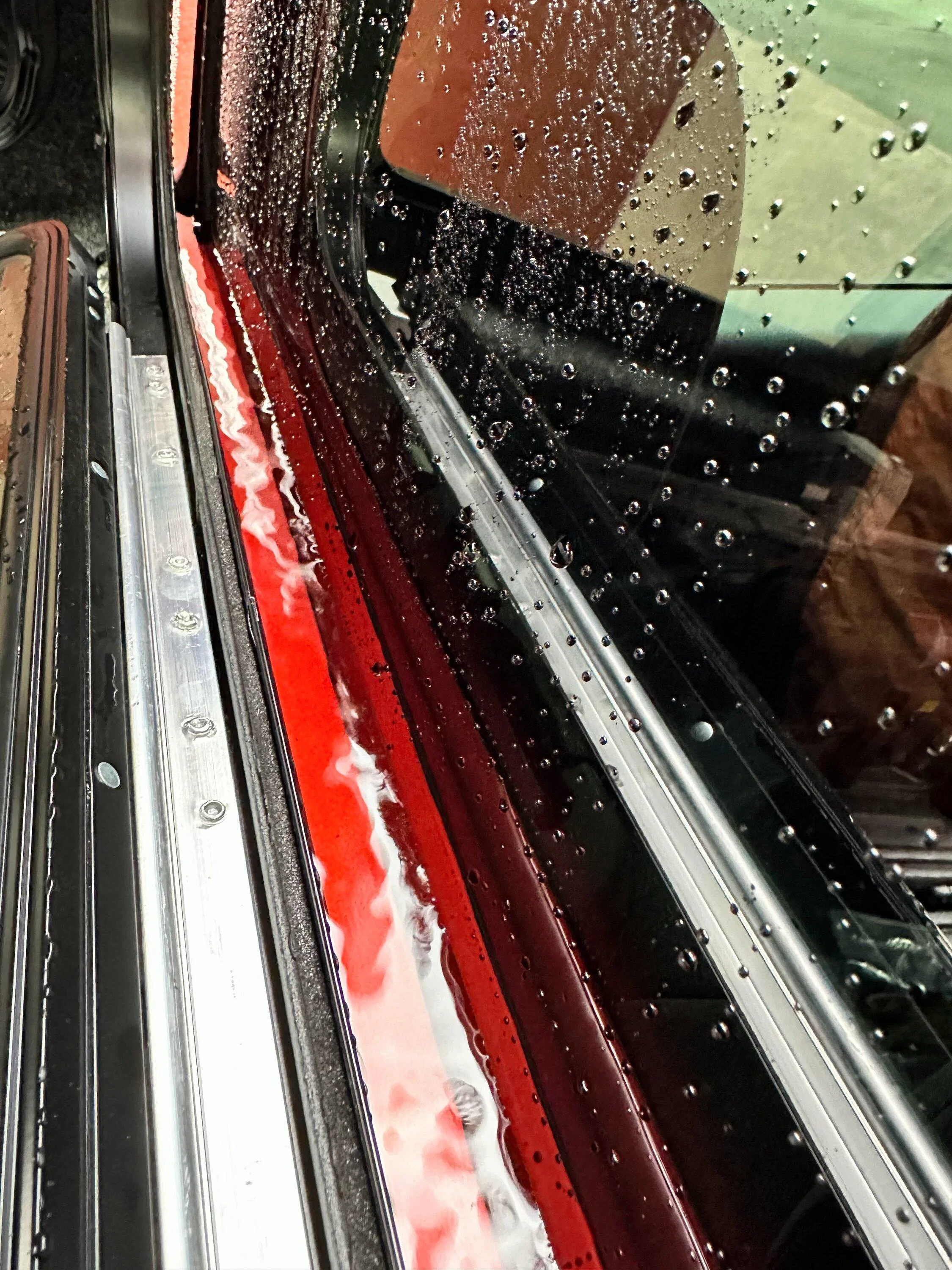

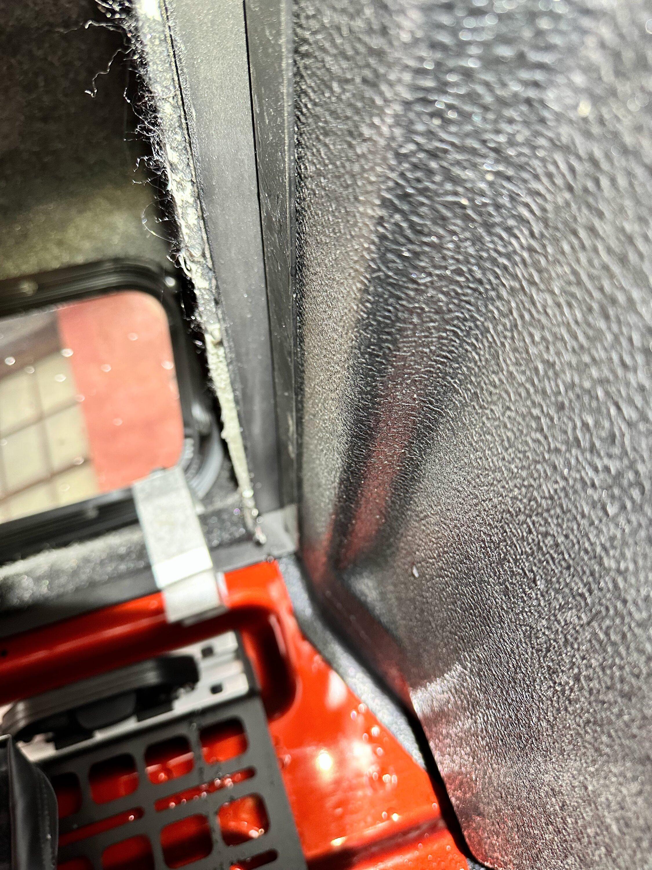

1/1/24 Update!
It leaks! I am having water get in from the seal on the front of the cap near the cab. It looks like they used three layers of quarter inch foam and it is not working. I'm going to contact them again and show some videos and pictures.
You can see in my photo about an inch of water collects in between the rear window and the front of the cap. I know me running a hose isn't rain but if the truck sits out in a heavy storm I bet a bunch of water would collect there. I am really hoping we can solve this issue. I want to add a bed rug but I don't want it to get soaked.

Given what mine experiences in car washes its not great. Leaks from rain are minimal by comparison. I personally dont think it will ever seal enough at the front rail. My solution that I have yet to try is form a piece of 2-3" thick foam that fits the gap at the top of the cab tightly and fills the void preventing water from running in. Basically i think for a Maverick cap to be 99.9% waterproof it will have to be sealed against the cab of the truck and at the rail providing a double layer of protection.
I just havent found the right piece of foam on island yet to try it out. I do have a boogie board I was thinking of cutting up to try, just havent done it yet.

Of course it leaks. It leaks like a screen door boat. Here's the quick, easy and cheap solution to keep 99% of the rain out. Also, put some putty in that indent on the bed rail on both sides (near the cab). I think you already saw this. Also, I sealed the tailgate.

I did see what you did. It's a great idea. I am thinking of doing the same. My buddy thought about putting a seal on the side of the cap so it would seal with the end of the cab. The seal with the PPF on top would keep all the water out. My truck is ceramic coated so I need to buff that off to get the PPF to stick on the roof.

The fiberglass contact surface of the cap is rough on the underside, so it doesn't seal well. I took it back once (waste of time), they just add another layer of tape. No change in the leak. I put butyl putty to smooth out the fiberglass contact surface (front seal) and put putty in those 2 side channels. Still leaked badly but improved a little bit.
Mine is pretty much flush to the cab on the sides, not much left to seal with the top sealed 4" down both sides. I'll call it an air gap. No fogging, I don't know if that's due to the tiny air gap remaining or not. Really happy with the PPF seal beyond the slight cosmetic downgrade.
