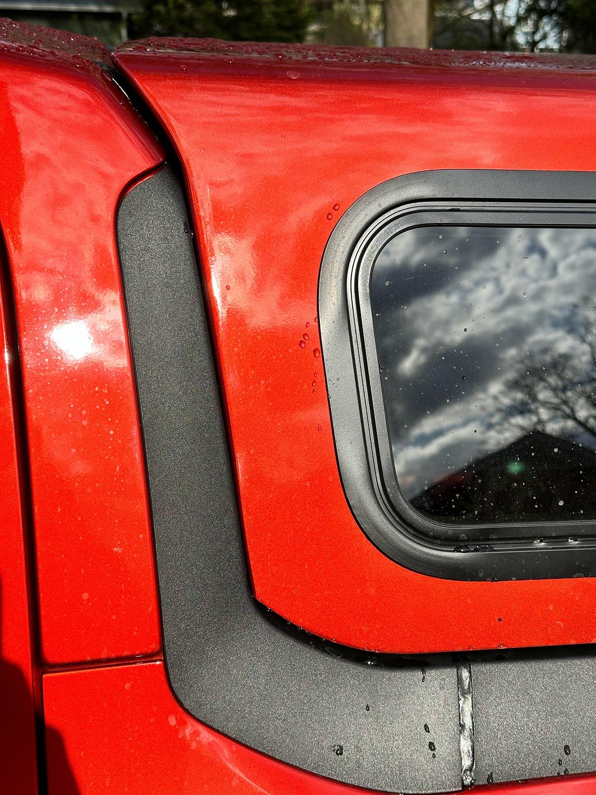

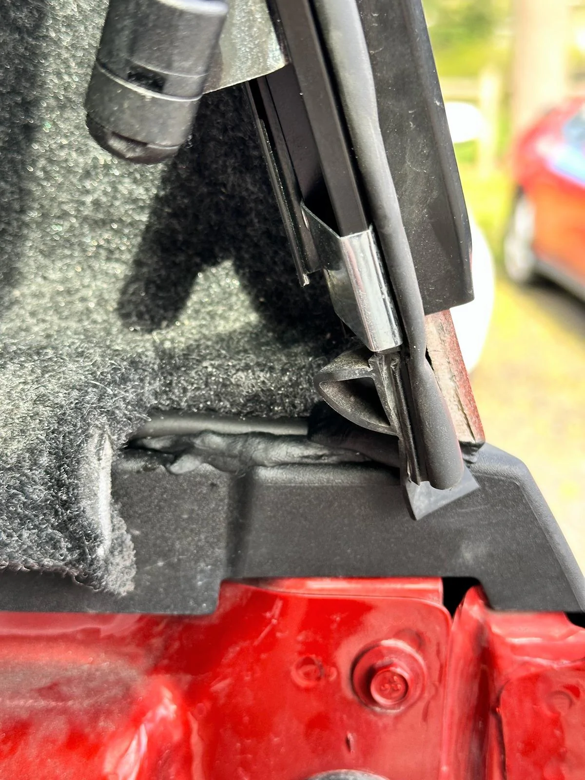

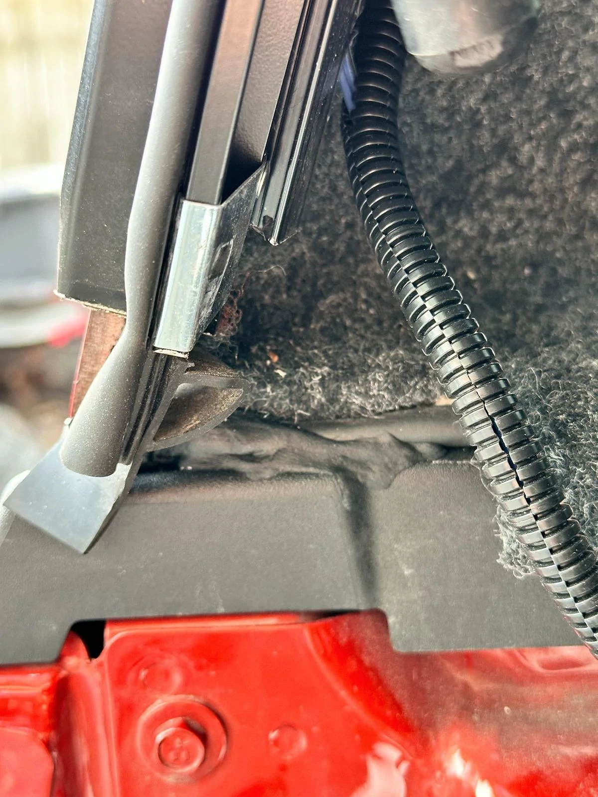

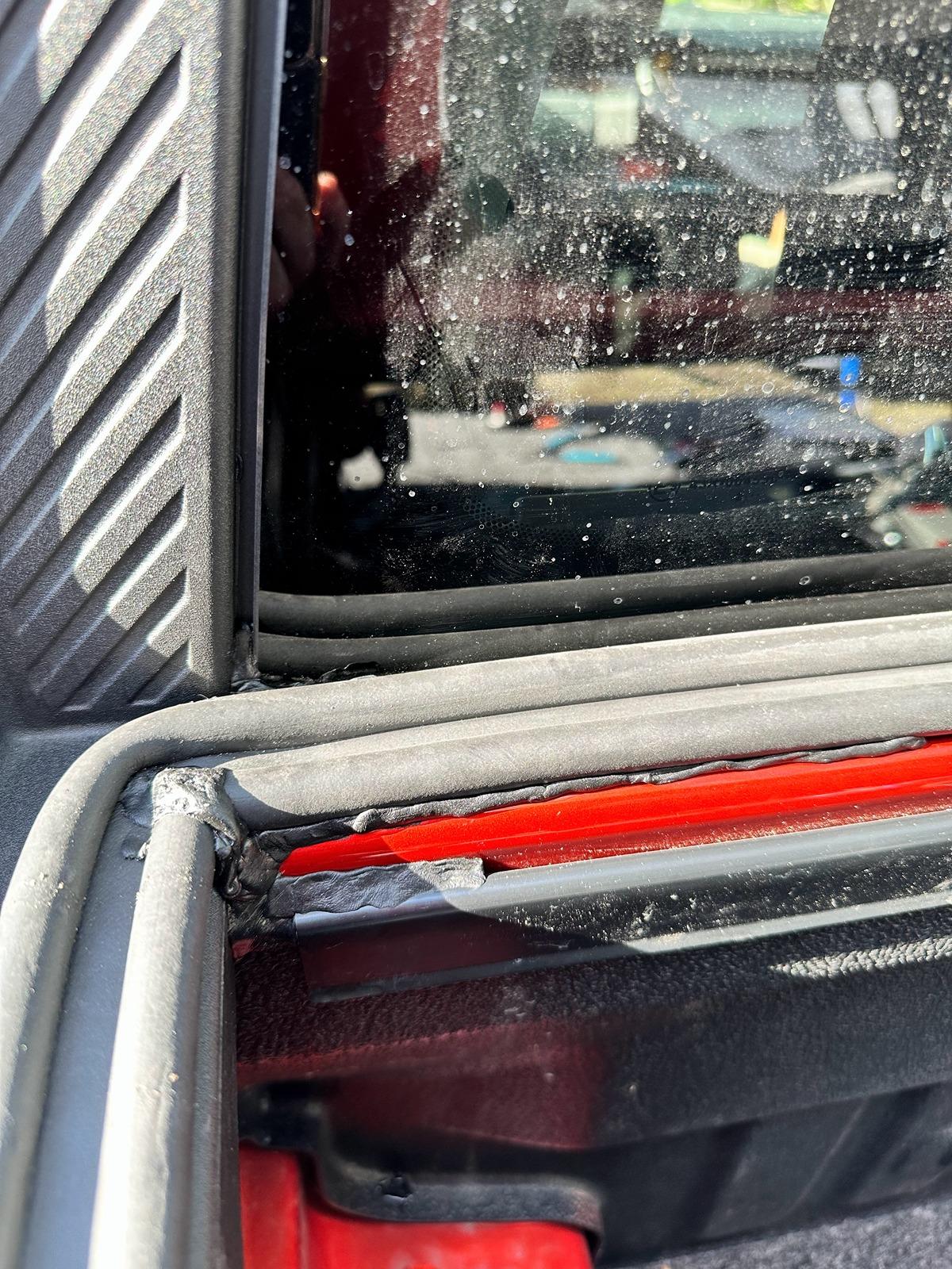

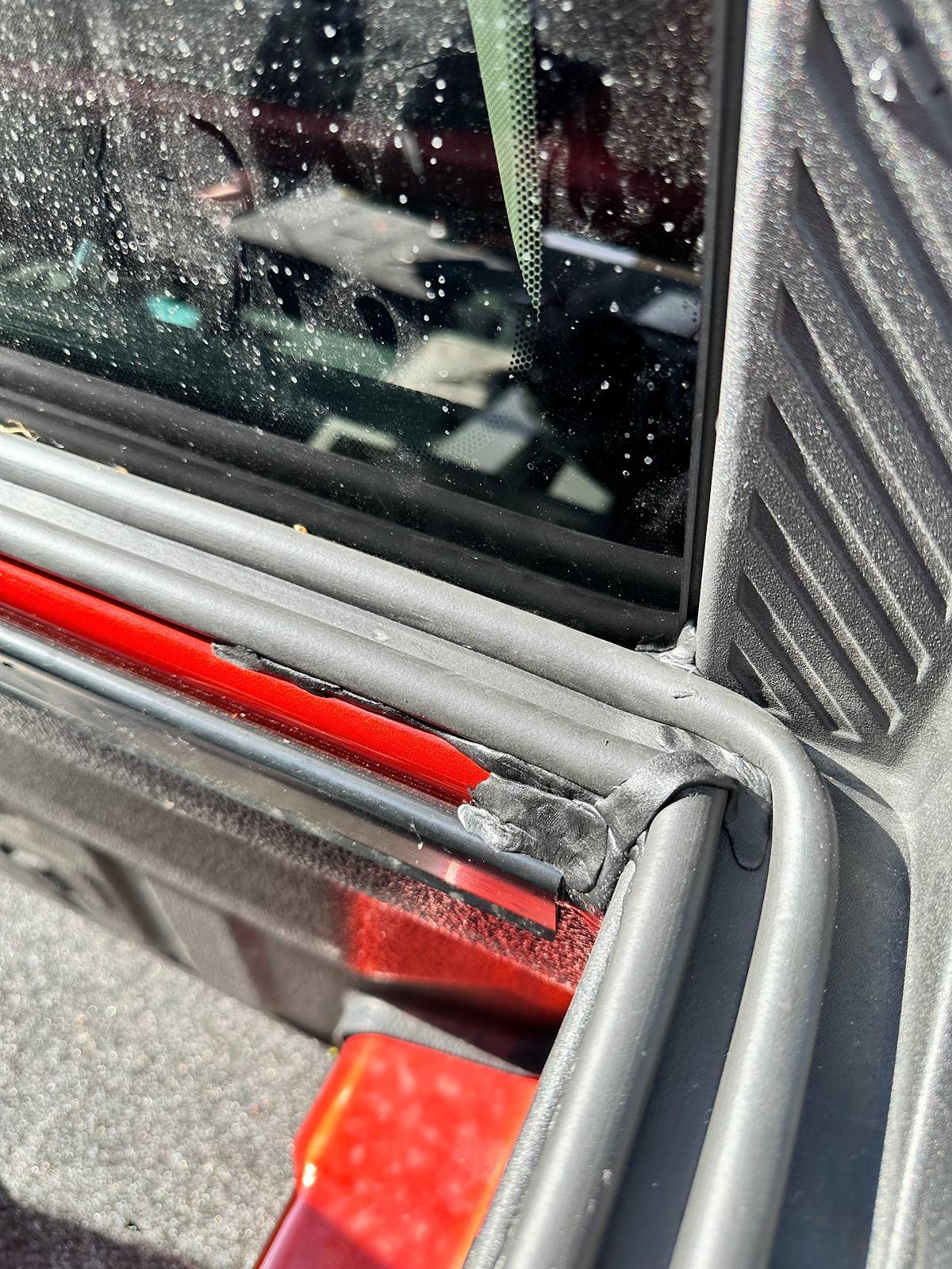

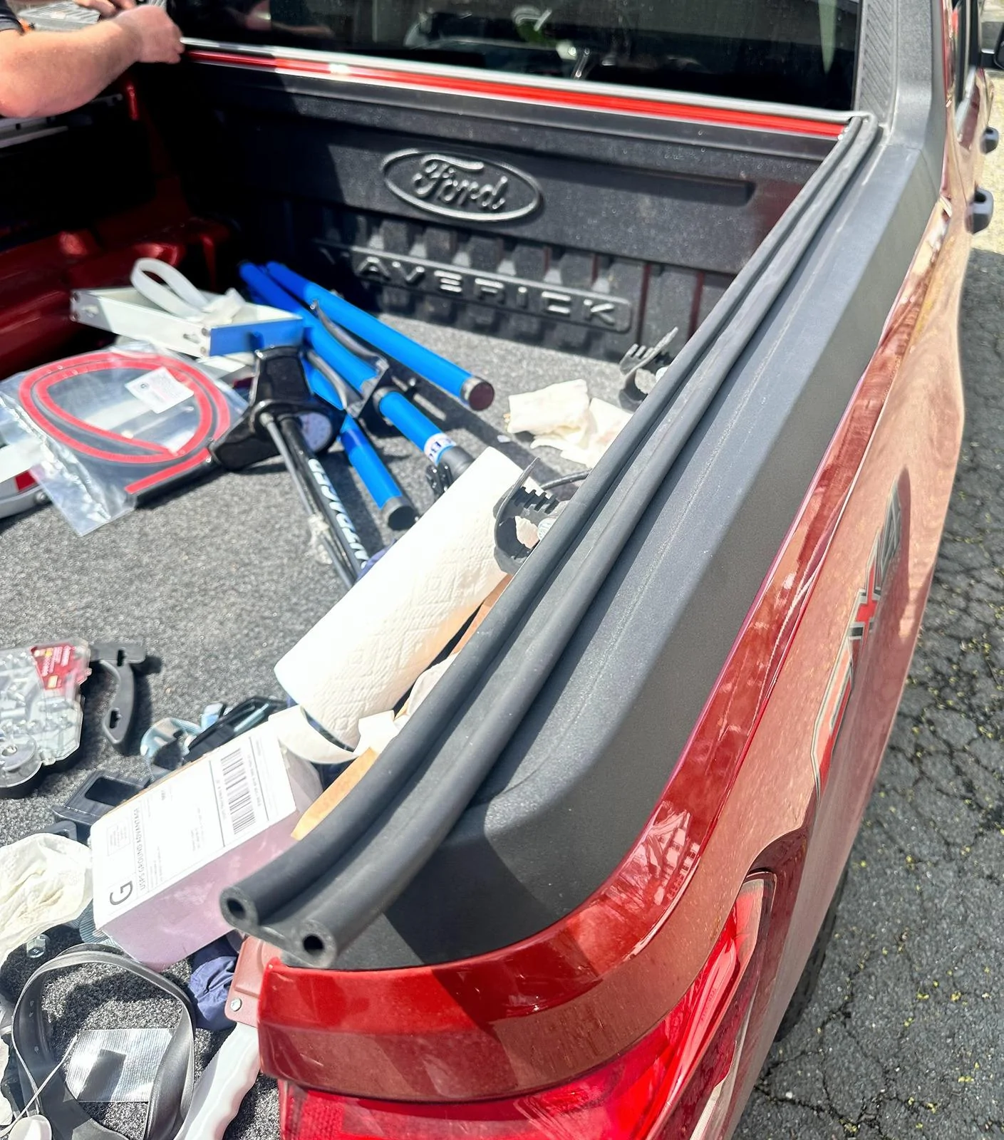

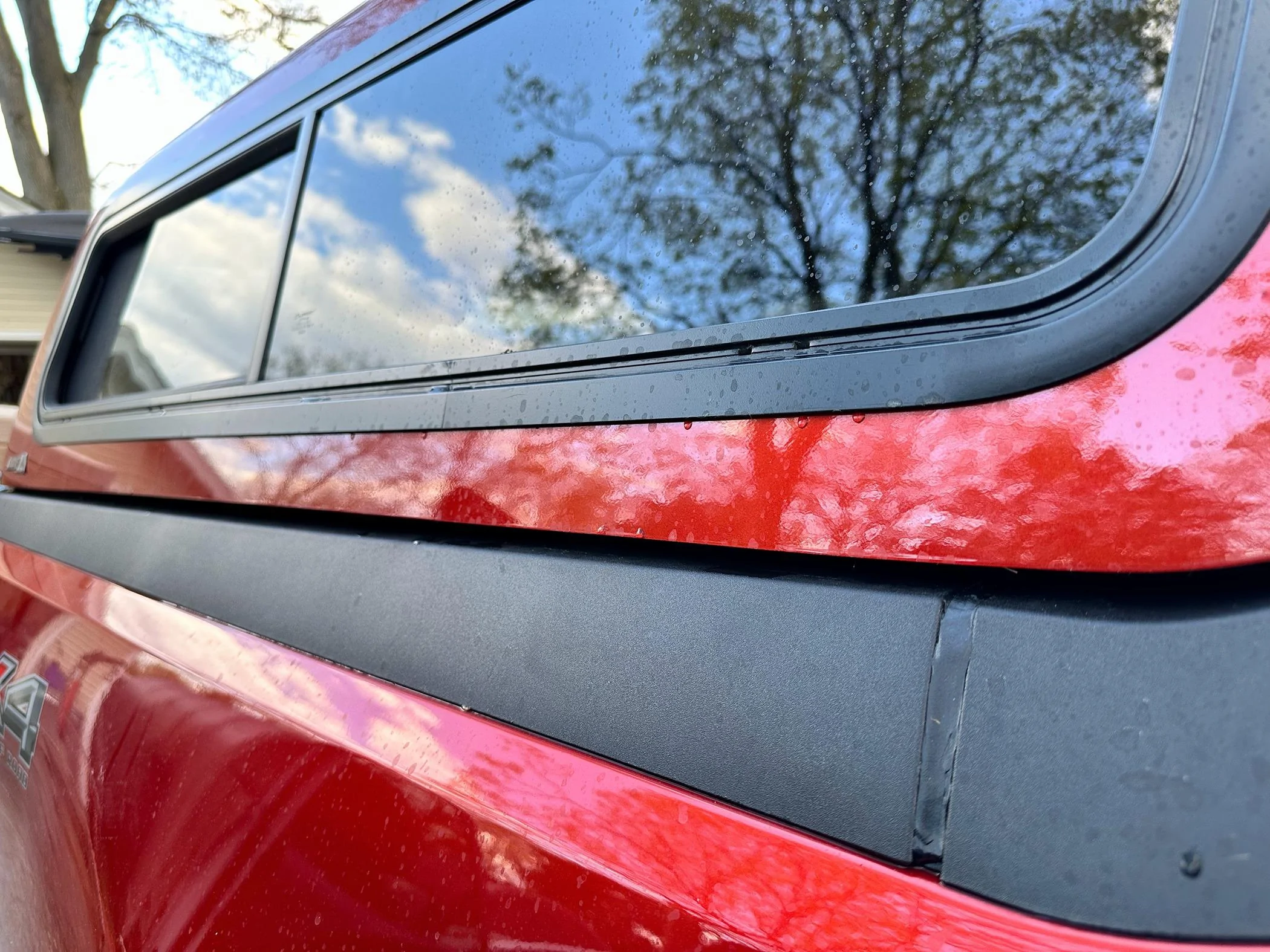

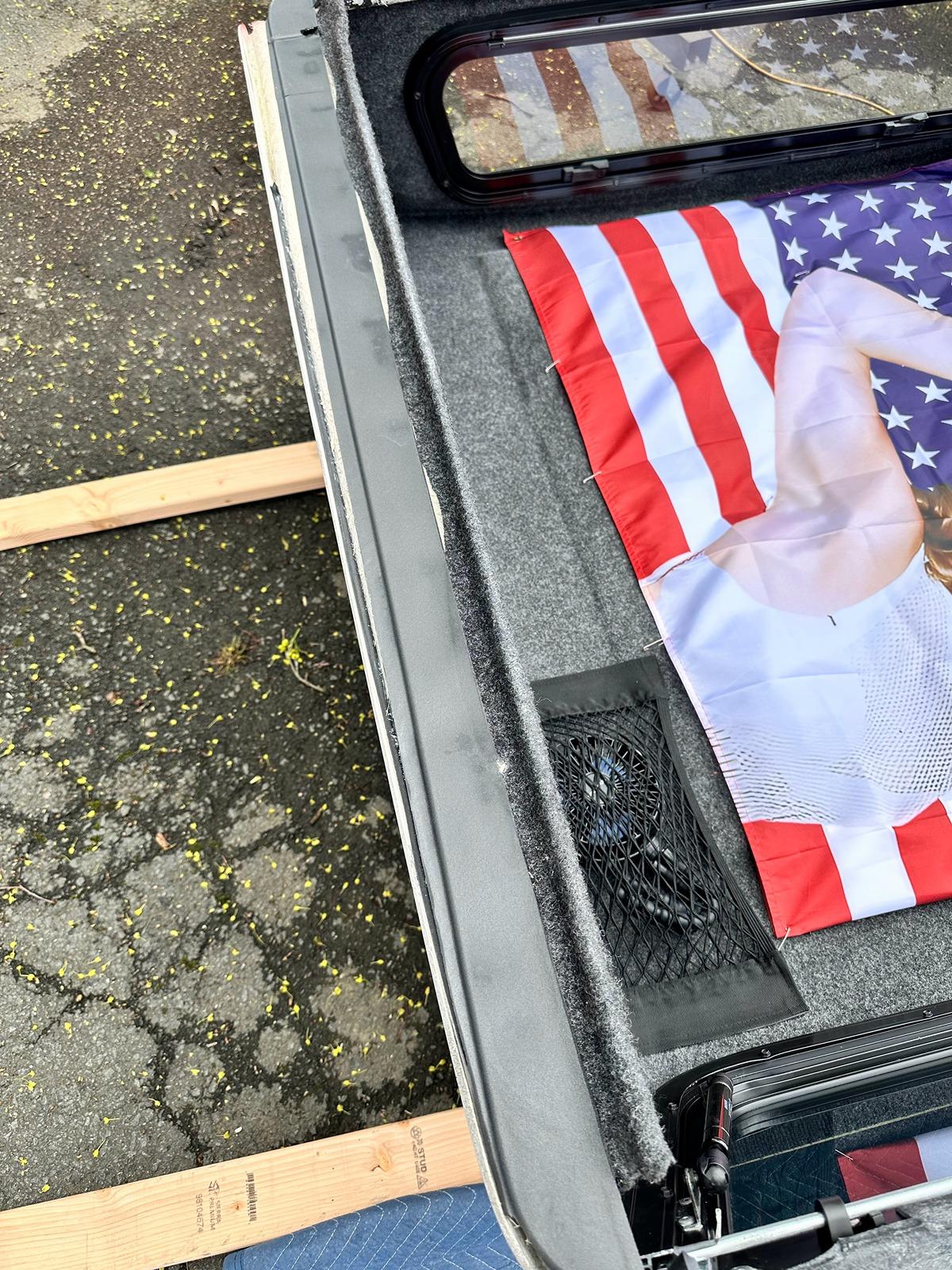

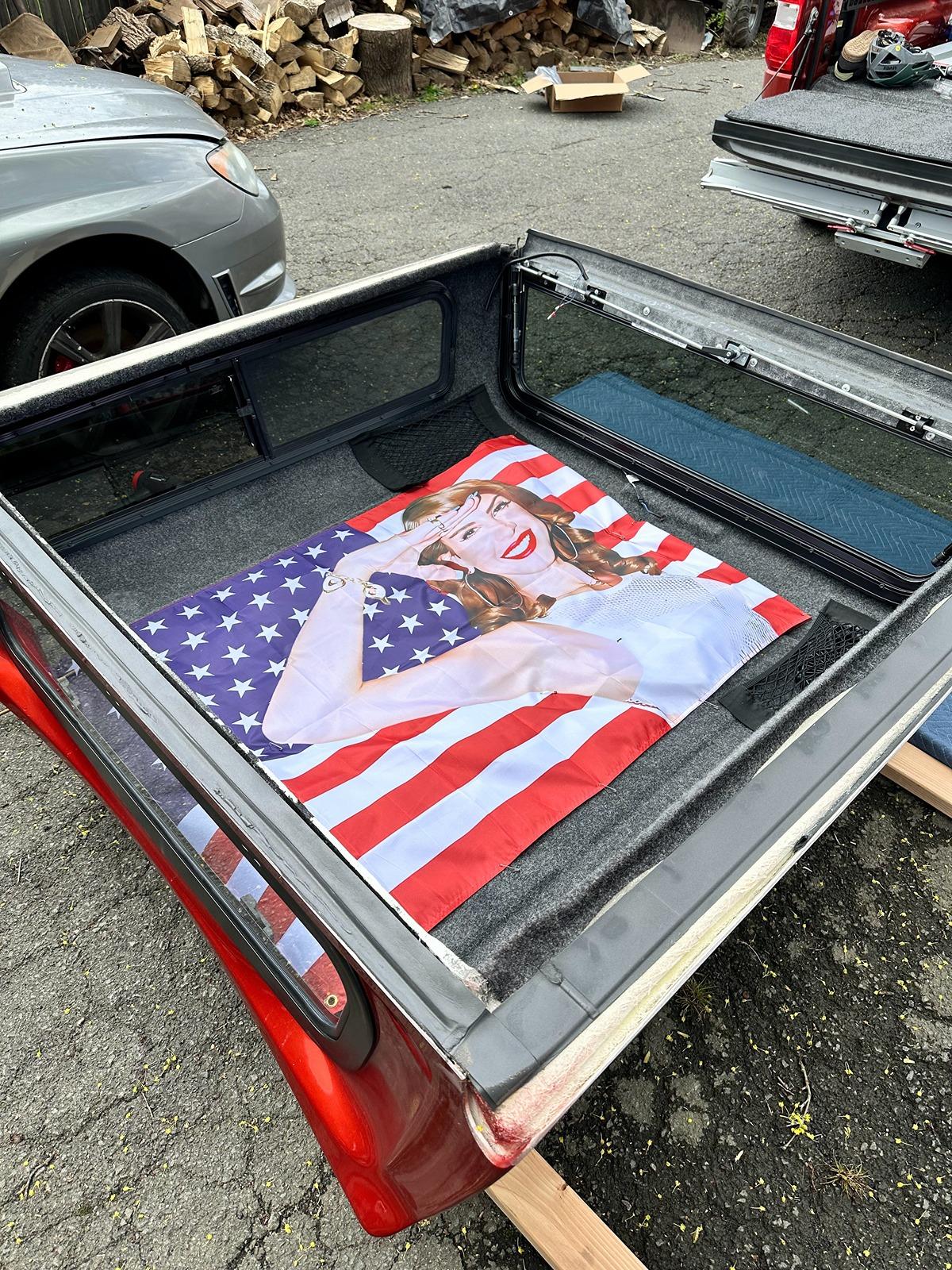

Update!!
Some friends and I resealed the cap on my Maverick this weekend. The process was simple and didn't take too long.

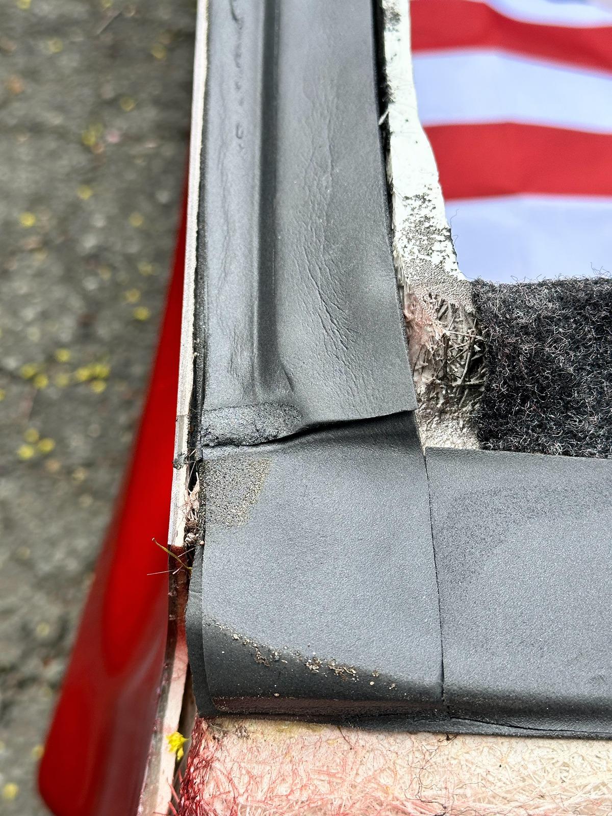

The cap was heavier than I thought but with three people it was easy to remove and flip upside down. Once we had it flipped you could see the horrendous seal job that was done originally. 1/4 foam was used down the sides and then stacked near the cab of the truck to makeup the gap.
No way this would ever seal well enough to keep water out. I know the company that installed it claims these are not meant to be water proof but I think we all want them to be and with a little effort it's possible.
After removing the old seal I cleaned the cap super well and it was time to apply the new seal. After some looking and thinking we all decided to put the seal on the truck instead of the cap. I don't plan on removing the cap so if I need a new seal down the road I will just buy another one. We installed a double bubble seal that is meant for truck caps. I'll leave links below on what we used. This seal is so much better than thin foam. In the corners we needed to use a good amount of butyl to fill some gaps.
On the first water test with the garden hose it was leaking in the corners. There was seam sealer below the double bubble seal and it caused a slight gap where water could get it. We removed the cap and put more butyl. I went a little overboard as you can see in the pictures.
The second water test was a success. No leaks and the water was running down the sides of the bed and emptying out the back. We also moved the cap closer to the cab since it's unibody. No need for a gap like a frame and body truck. The cap sits higher than before but I'll take it being water proof over a better look. Overall I am super happy with the result and can't wait for some wet weather.
Double Bubble Seal
Butyl
