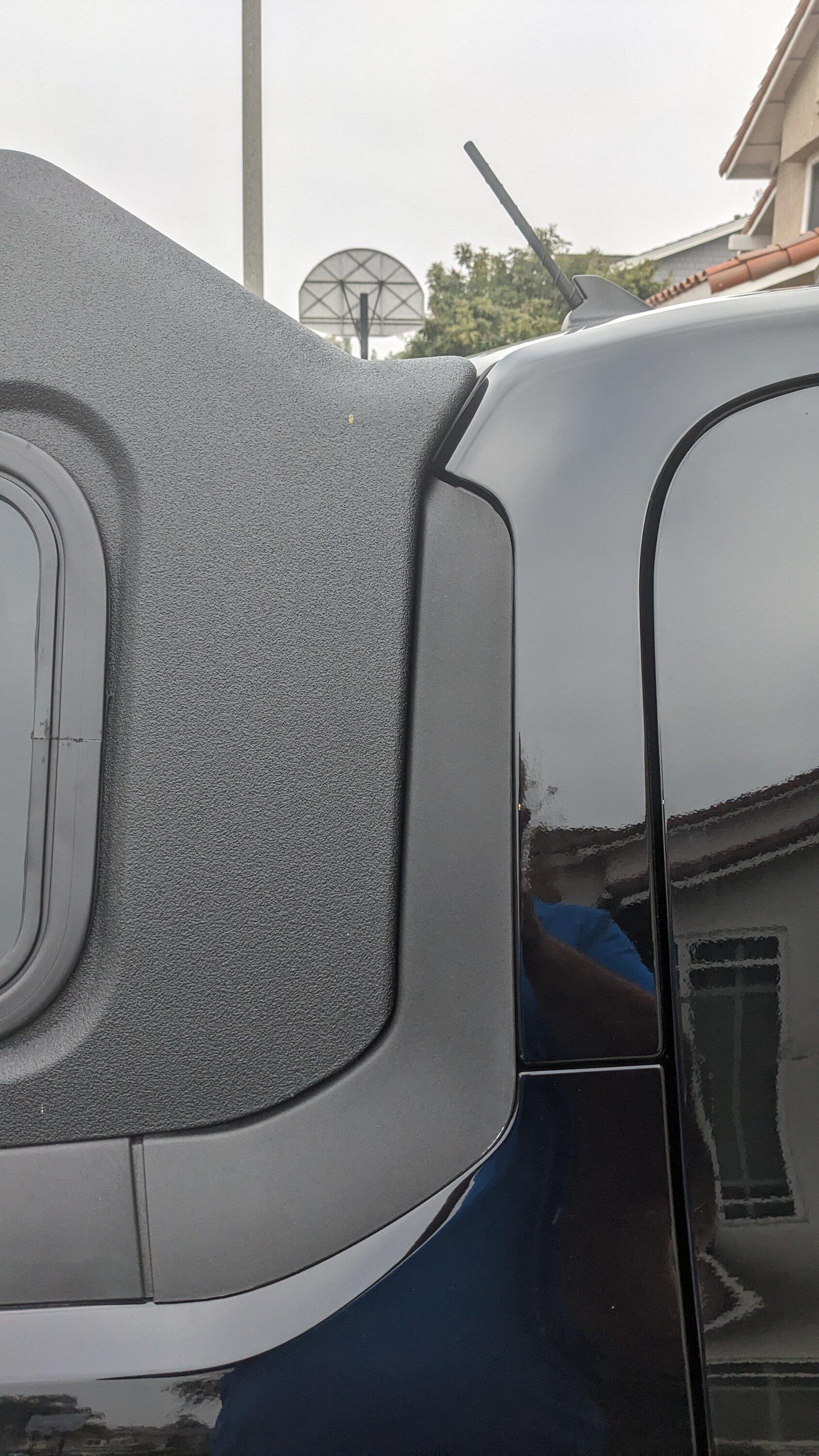

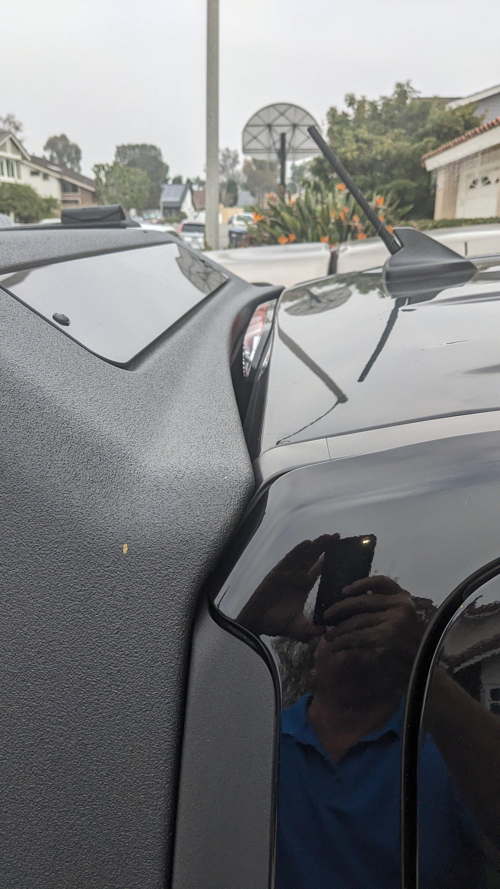

You might want to have them re-position the shell closer to the cab. Most installers are used to installing shells on pickup trucks with the bed separate from the cab. The Maverick, however, is unibody and doesn't flex. Consequently, the shell is designed to be close to the cab.
Pictures of my A.R.E. MX-series repositioned closer to the cab below
I bolted mine to the bed since the MX-series is fairly tall, and I want to use the racks to carry stuff with confidence.
Ford Maverick A.R.E. V Series Truck Cap installed PXL_20231228_165658551
Ford Maverick A.R.E. V Series Truck Cap installed PXL_20231228_165704664

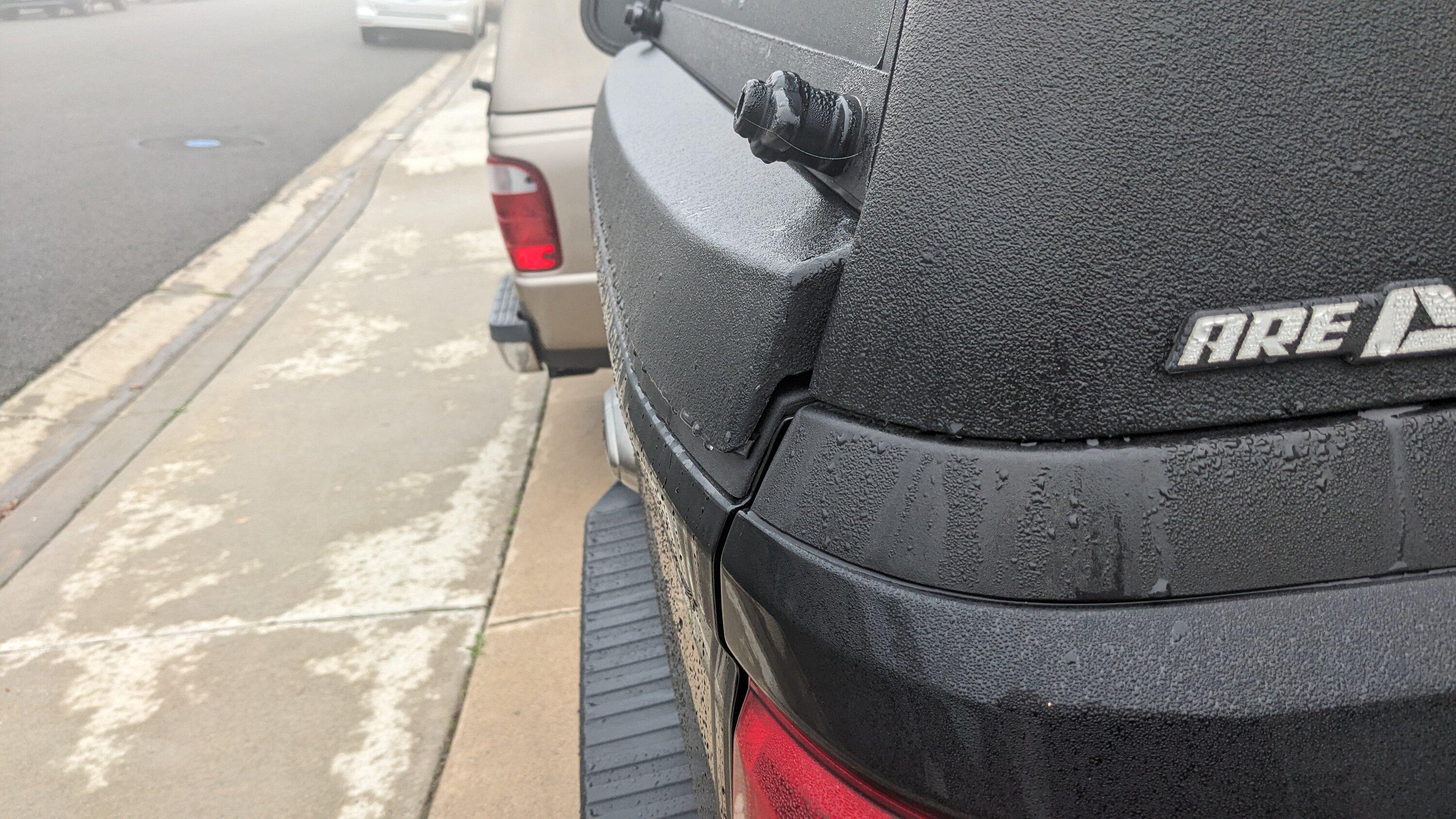

I apologize for the delay. Please find pictures of the rear ends of the cap. I can send you more if you want to send me a direct message.
What it looks like from the outside:
Ford Maverick A.R.E. V Series Truck Cap installed PXL_20231229_164353202

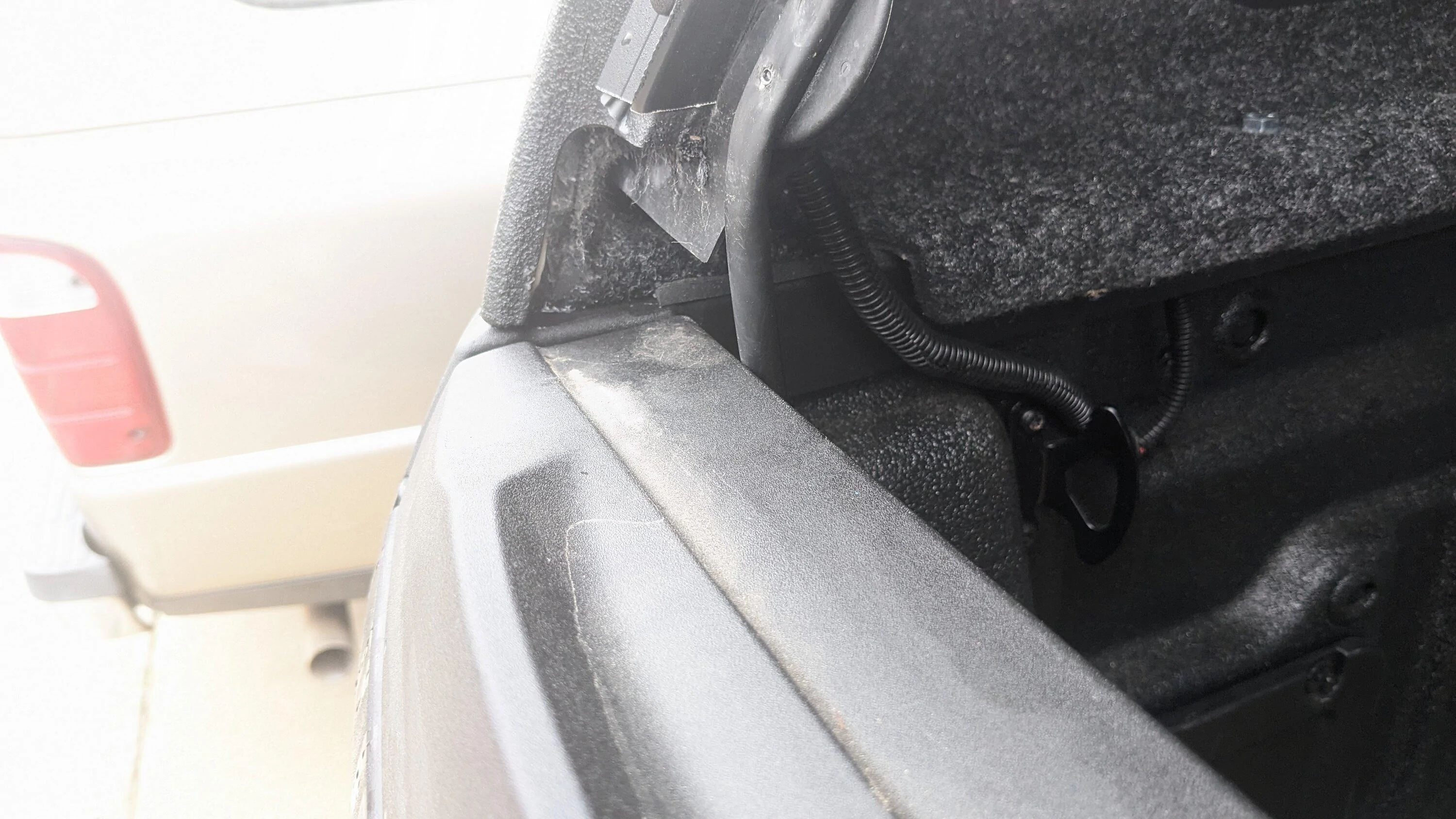

What the inside looks like.
Ford Maverick A.R.E. V Series Truck Cap installed PXL_20231229_164546018

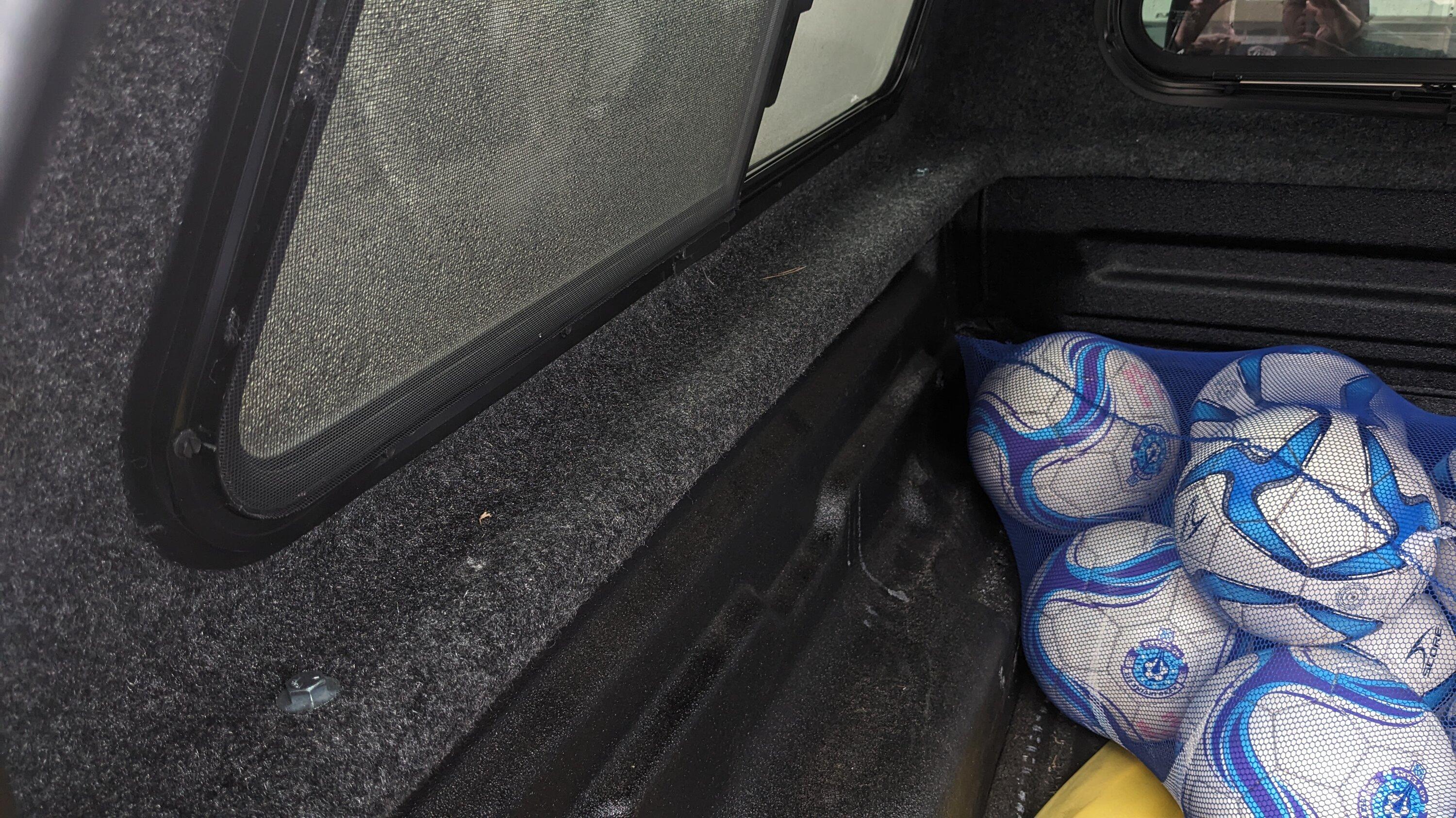

@Dad Here is a shot of the inner rail to see the difference between bolts and clamps.
Ford Maverick A.R.E. V Series Truck Cap installed PXL_20231229_164649741

Thanks! The installer didn’t feel comfortable moving the cap up further. He wanted there to be space in case of vibration.
I did have some leaking near the front corners so he added two extra clamps. He said it wasn’t clamping down all the way. I’m hoping the leaking is either gone or very minimal.

Your installer doesn't realize they are looking at a unibody truck. The bed doesn't vibrate independently of the cab.
If the shell is properly attached to the bed, it isn't going to move enough to hit anything.
Looking at my pictures, the shell is about 1/4-3/8 inch away from the cab. If it is vibrating that much, the clamps are not tight enough. :)

Thank you. Is the last photo a Maverick? If so, then I'm thinking you swapped out the clamps for the bolts. Nonetheless, the cab looks like a good fit for the Maverick. Many thanks for taking the time to post your experience and answer questions.
