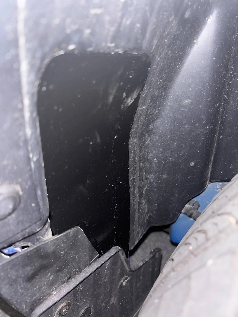

Just finished printing the left and right debris shield. The fit was perfect, slid right into place. Great job on making the printer files
I printed them on my Anycubic Kobra 3 Pro. I used PETG filament. It will not degrade in the heat or wet/snow. PETG is also very solvent resistant
Ford Maverick A quick fix for the rear wheel well debris trap IMG_3069

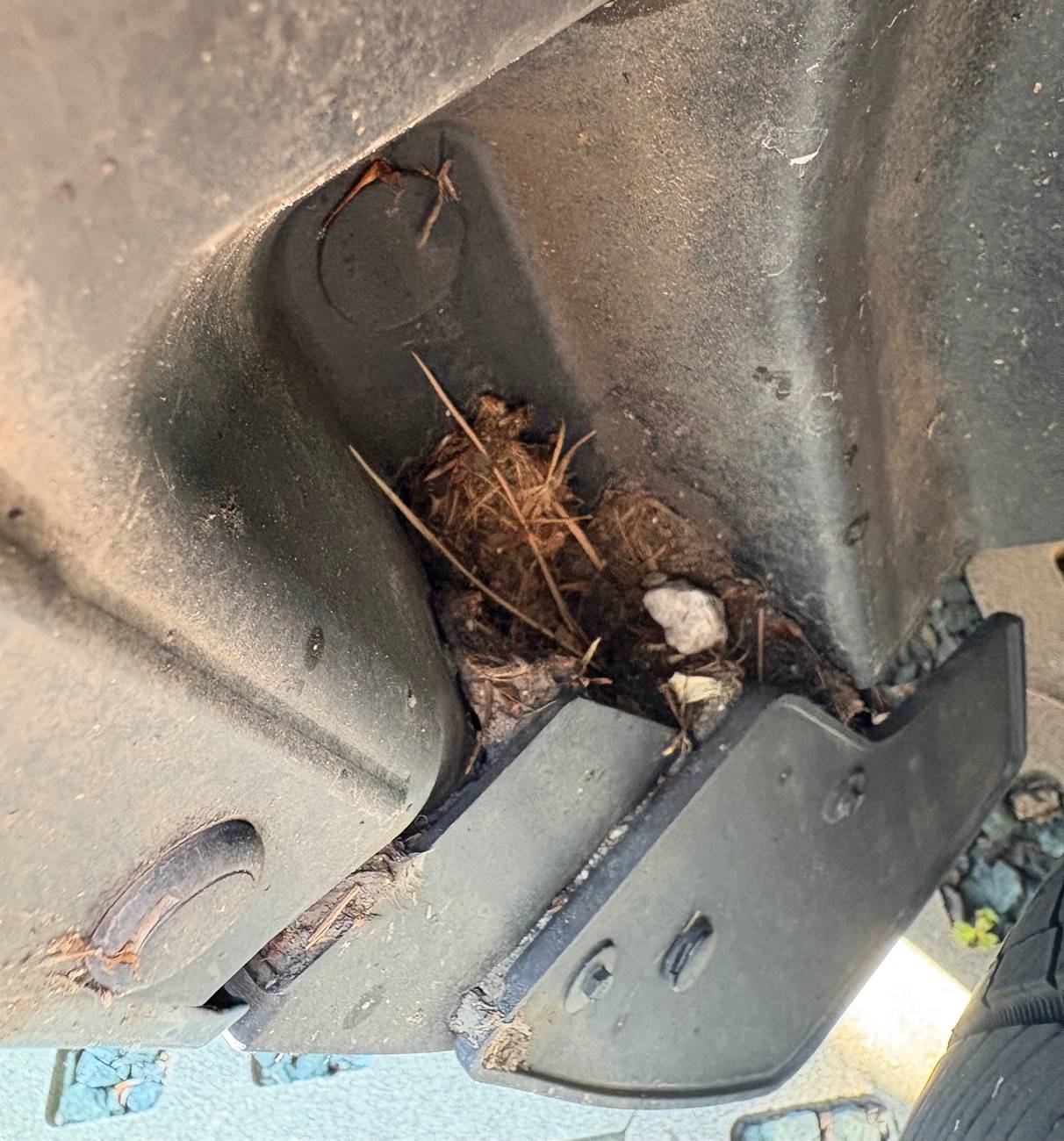

You'd have to be damn near a fool to print and install this. It would obstruct air flow to dry out the rocker. Just rinse it out when you wash the vehicle. It really is as simple as that. 3 winters and there wasn't that much debris in there, so OP is exaggerating. And no OP, you don't need to remove anything to flush this area.
This was what my ‘23 looked like when I first learned about these pockets. There was already zero airflow through that pile of mud. And I live in a city and drive 95% pavement.
Ford Maverick A quick fix for the rear wheel well debris trap IMG_0874

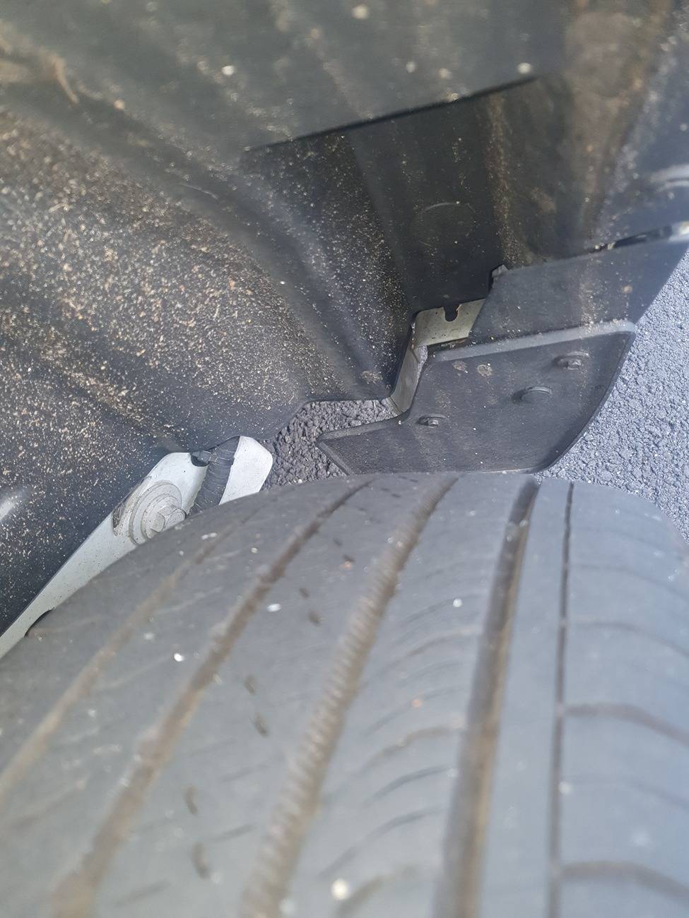

35,500 miles here, Very minimal debris on mine. All I do is wash the truck monthly and weekly in the winter. Keep it washed out and only cover it temporarily if you're planning to off-road in mud. I'll call that my rocker panel moisture air vent and I don't want it covered.
Ford Maverick A quick fix for the rear wheel well debris trap 20250612_201506
