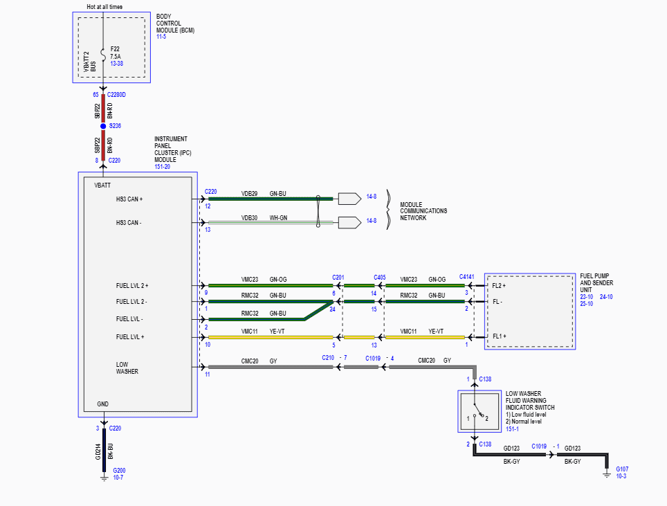

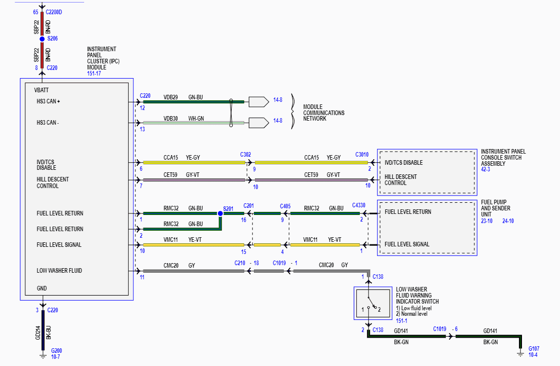

So, you're not gonna like this, but the Escape uses 2 different fuel level senders, the Maverick only has one. On the Escape, the 2 signal inputs are compounded to get the total fuel level. With only one input, the cluster will only ever see the tank as half full.
Some tweaks with ForScan might switch the cluster over to a single input, but I couldn't say for sure. For reference, the Escape's fuel level signal to the cluster is on pins 1, 2, 9 and 10. The Maverick only uses pins 1, 2 and 10.

Actually, after looking at the wiring, if you add a pin 9 and splice it to pin 10 (Circuit VMC11), the cluster should see the one sender as both of its inputs, and you should be OK.
Again, anything done from here on out is on your own, but the Part # for the Ford terminal to go in the empty pin 9 slot is DU2Z-14474-AA
