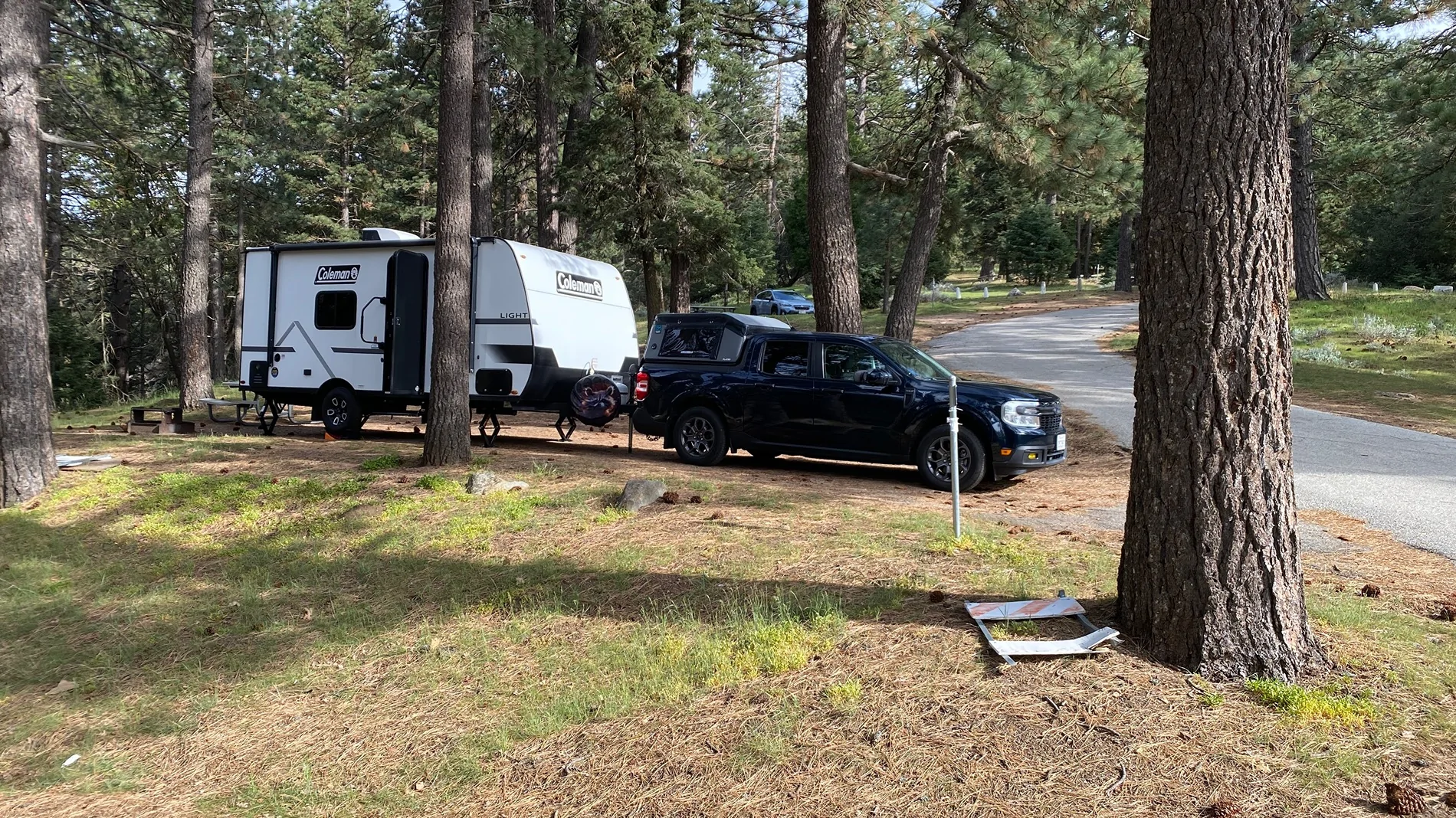

Meet F-050 Super Dudey. It is a 2025 XLT Hybrid FWD, in Space White Metallic, purchased 7-1-2025. I use it to tow trailers around the country, which is my main source of income. As such, it now has 131,400 miles as of this writing. It is my second hybrid, the first being a 2017 Toyota Prius Two Eco, which was likewise used as my main source of income for nearly 6 years, before I killed the engine around 396k after letting it run out of coolant. (I've been paranoidly watching the coolant level in the Maverick as a result, which did save me)
Ford Maverick 1 year, 130k mile review from a heavy hauler photo_5069019857461906791_y
However, the Prius set the bar a bit too high for the Maverick, so the list of gripes is going to be longer than the list of compliments. But first, here are a few of the modifications (you may be able to see the antenna base in the above picture, and on the car in the background)

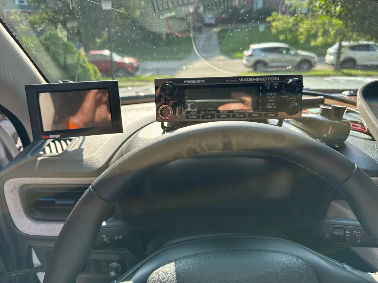

A ScanGauge III, a President Washington "10 Meter Export" CB radio, and just in the crook of the steering wheel, you can see, on the light control pod, the control for the RedArc Tow-Pro Liberty brake controller. The radio might get moved back an inch, and it will definitely have a right-angle microphone extension cable added later today, as my hand brushes the cable in turns. And it blocks my view of the underside of the hood, but not the hood, and definitely not the road.

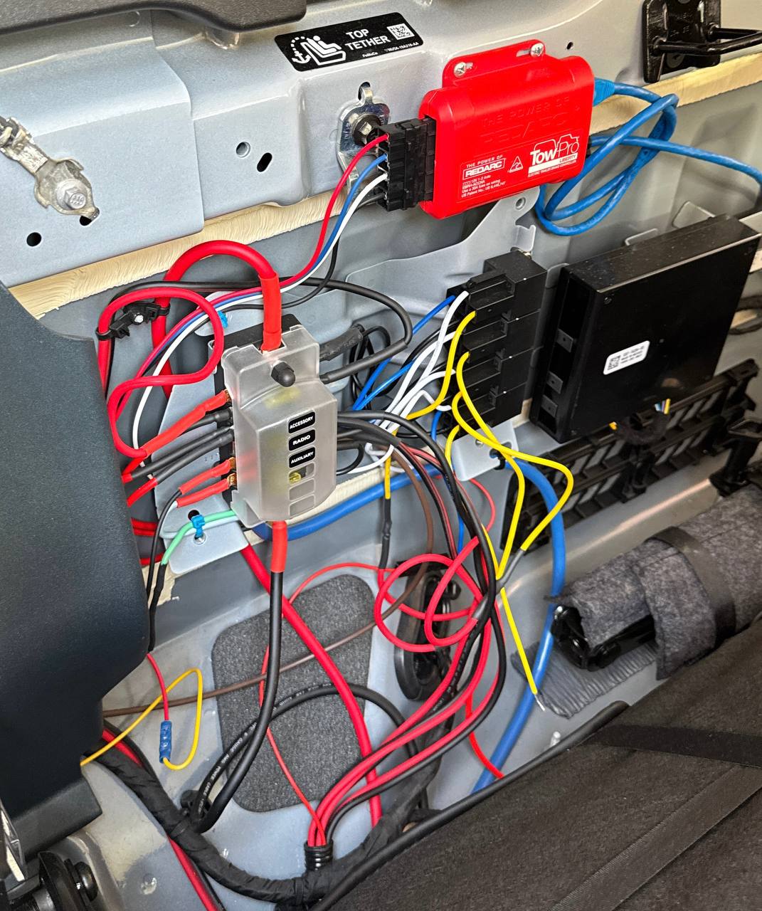

Cables! The lower relay is as yet unused, hence the hanging wire there. Props to RedArc for using standard Ethernet cables, I managed to cut my own custom-length cable. (y) Not pictured, as it's buried deep in the front, is a panel-mount Anderson connector for charging a "solar generator" battery pack, to run my cooler overnight. Also not pictured, I snipped the lines going to the factory AC outlets, and cabled those out to the "solar generator", as it can actually power my air compressor, unlike the factory inverter. Blue cable at bottom goes out and supplies 12V, ground and brake to the 7-pin out back.
Also hard to photograph, as it's mostly hidden by the spare tire, is a trailer junction box I use to bring those connections together, along with the custom set of relays to provide running, reverse, brake and turn signalling to the hitch, as the 4-pin trailer module is unreliable, randomly not powering the lights, even with a synthetic load added on. 🤷‍♂️ (Yes, I saw the thread about the recall, but too late, and I also needed a source for the reverse, as many boat trailers, like below, lock out the brakes using this signal)

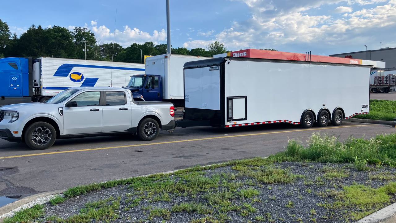

Built Ford Tough is apparently not a marketing gimmick. This trailer weighed 8,160 lbs, had around 800 lbs of tongue weight, and of course I found a bone-cruncher railroad crossing on my route. The hitch, and the unibody it attaches to are both arrow straight after that experience. Good job, Ford.
Ford Maverick 1 year, 130k mile review from a heavy hauler photo_5051195025923968043_y
Power-wise, I have no complaints. Perhaps just a touch more than the FWD can handle, at times, as at the extremes it sometimes becomes an issue with handling. (it can get a little floaty)

Can you believe the gall of modern auto makers, that they leave no room in which to install a CB radio? The nerve. At least they had already drilled a hole at the optimum place in the roof for the antenna, that's a plus I guess. But holy hell headliners just suck. As a matter of fact, all modern cars are just too cramped. For those younglings reading, go sit down in a 1990's Buick LeSabre, or any other GM H-Body. Or a 1980's B-Body. Being able to play footsies with your passenger is a feature, and it seems like EVERY manufacturer has dropped this feature for one that nobody asked for, and I hope you will read all of the derision dripping from my voice: safety

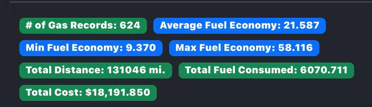

So fuel cost was 13.9 cents per mile. Seems good to me considering the use. Did you generally feel safe while you were pulling these loads or did you often feel you were on the edge and pushing the envelope so to speak????

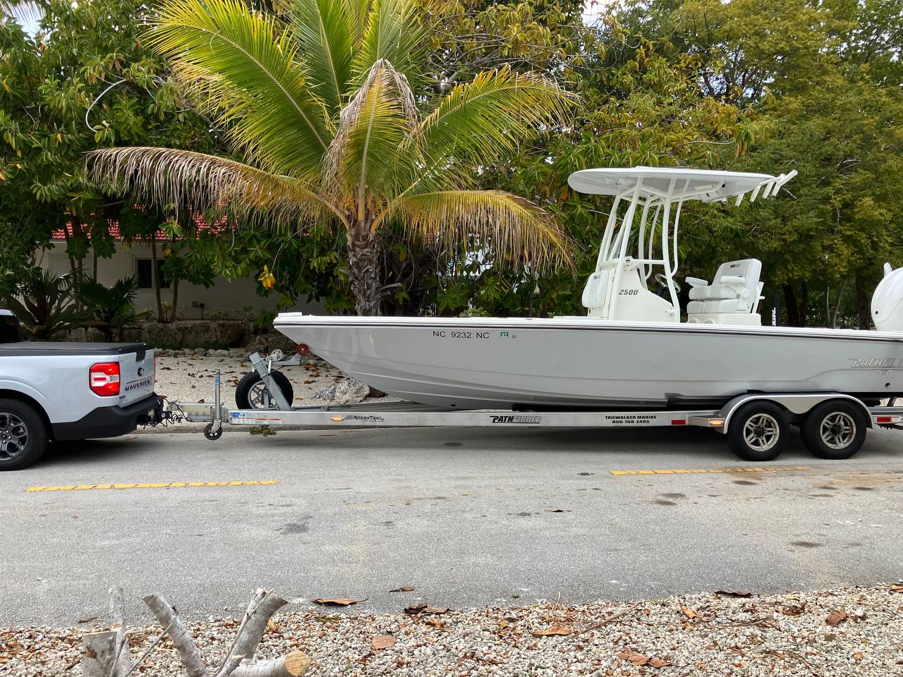

Also, I climbed the worst part of National Pike in Pennsylvania with that triple. I got 2.3 mpg instant. 😂
At least as reported in MTC I'm probably in second place for most towing with a 2022 FWD Hybrid.
I've towed something big and heavy for about 16,000 miles out of 65,000. About 25% of the miles I'm towing.
