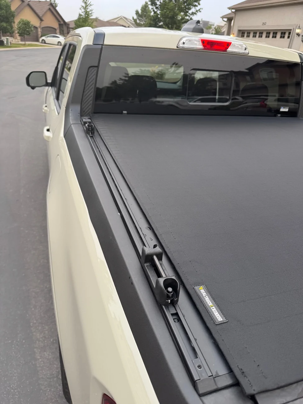

-Cons: have to pair with Elevate TS Rails for T-slots and bed rack compatibility. Velcro along sides to help seal, and I thought this looked more gimmicky and less smooth to open than the interlocking teeth on the x4ts. Also have to unlatch cover in order to shut tail gate.

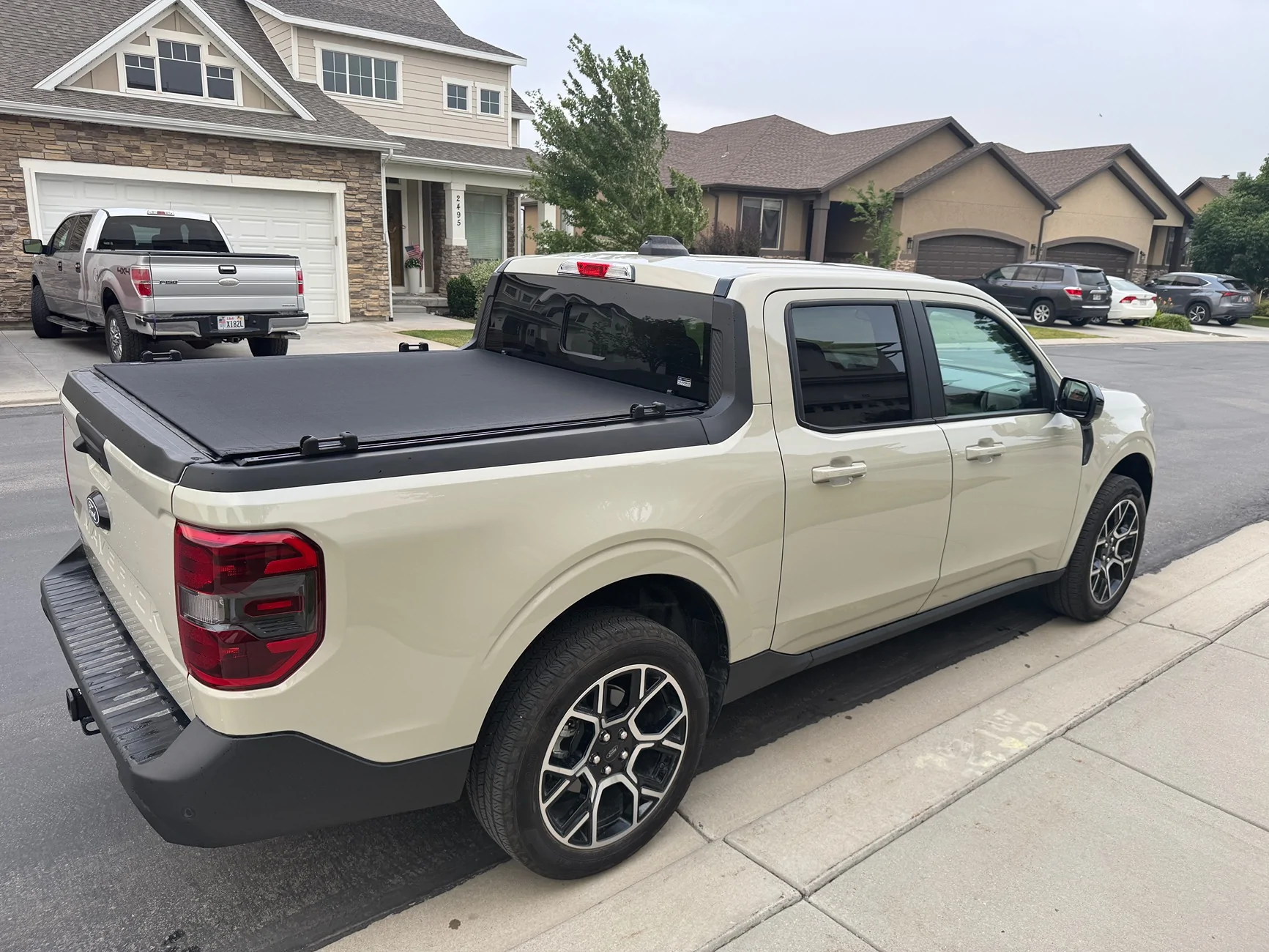

I ultimately decided to go with the Sentry CT + Elevate TS Rails, mainly because of the durability concerns with the XT4S. After having it for a couple months now I can say that I am EXTREMELY happy with my decision! Everything works really smooth, feels very high quality, and looks really good. The Velcro on the sides works really well and doesn’t bother me like I thought it would. I also don’t mind having to unlatch the cover if I’m just opening and then closing the tail gate. It’s super easy and quick, and takes very little extra effort. + I think it provides a better weather seal. I’ve also pulled the cover out completely a couple times, and it was easy to take out and put right back in.

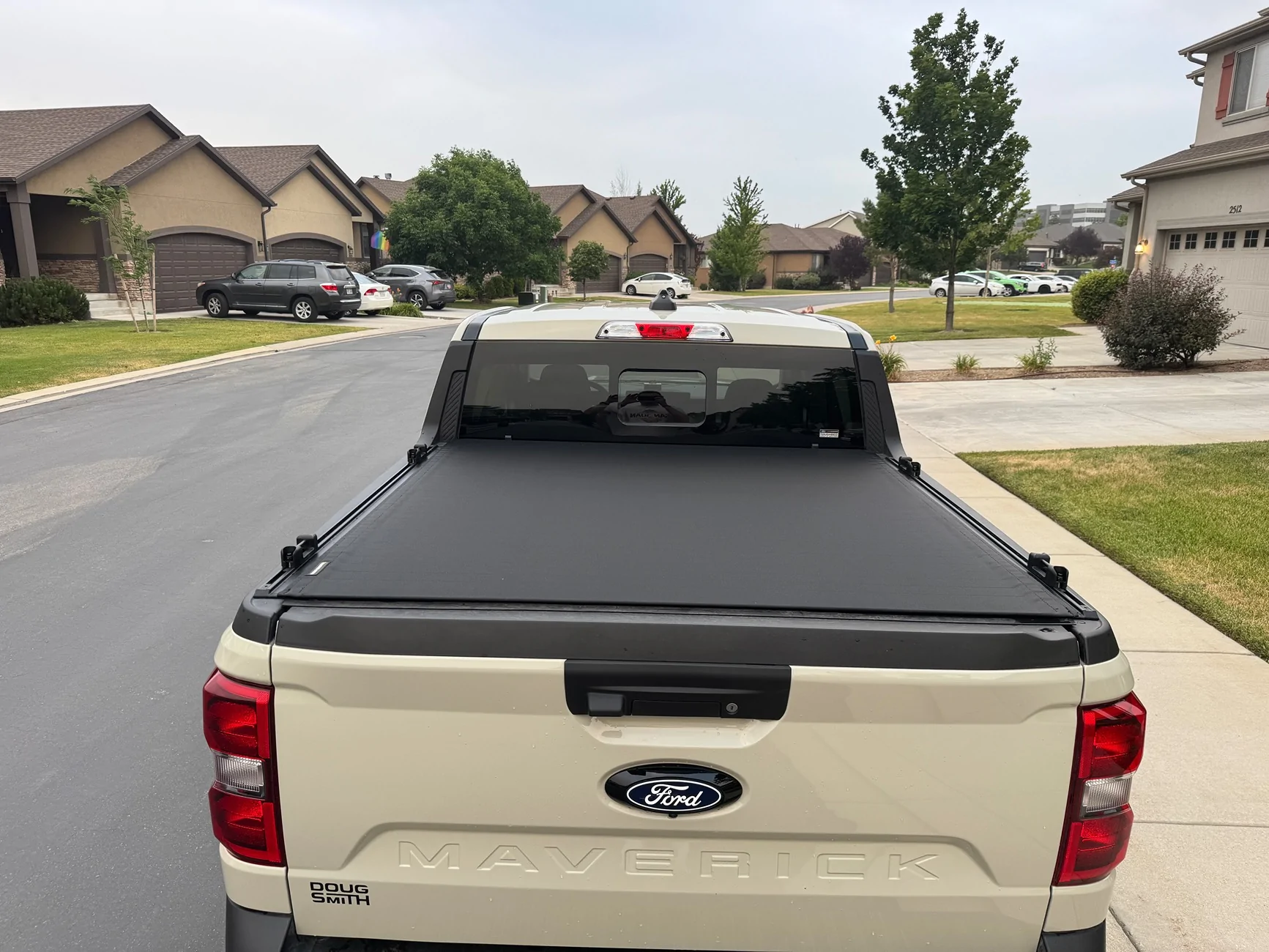

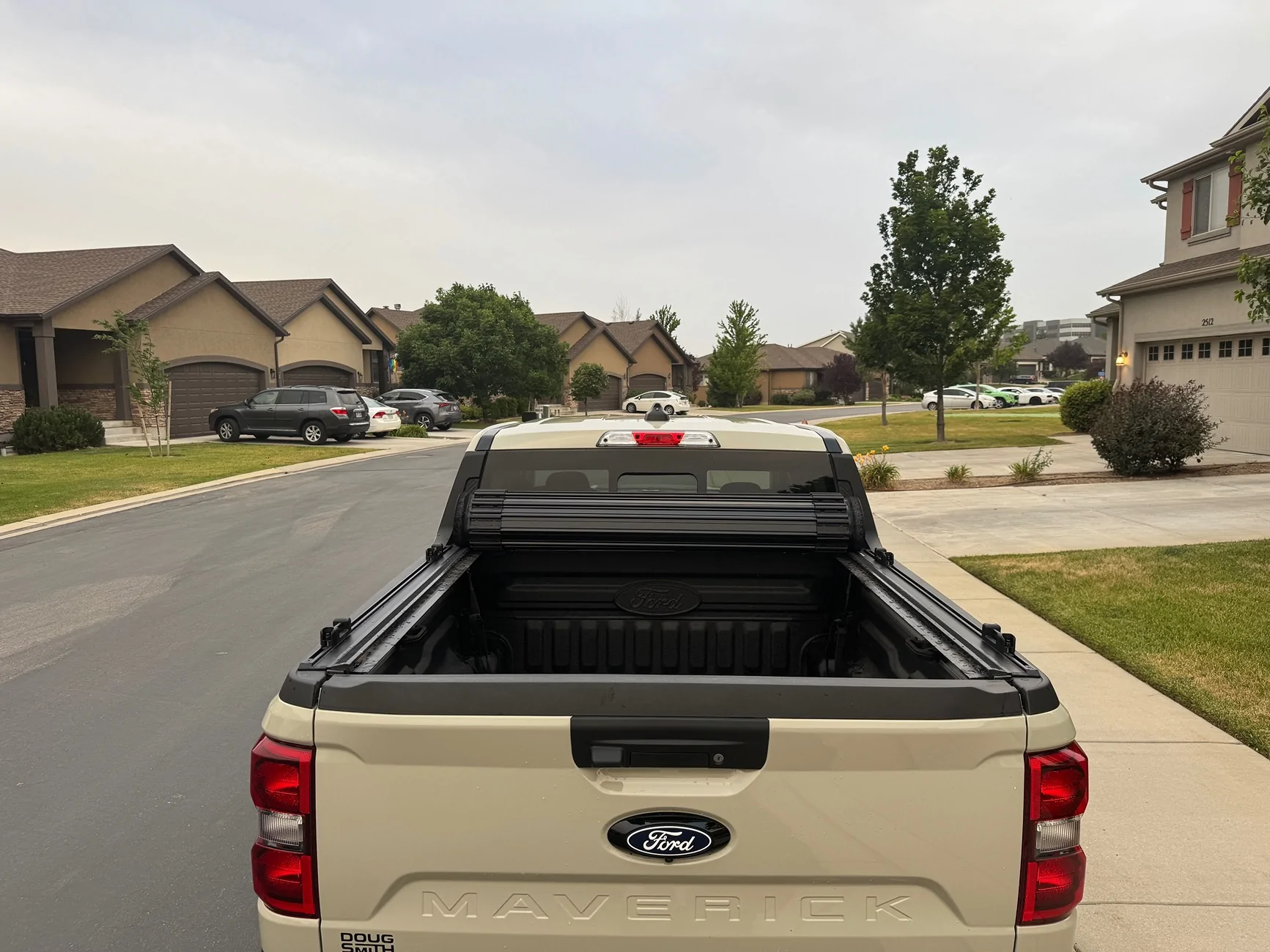

RealTruck Sentry CT + Elevate TS Rack Install:
Install was pretty straight forward and without really any complications. You’re technically supposed to remove one of the rubber seals and replace it with a provided thinner one since you’re sandwiching the rails in between the sentry ct rails and the bed rails. Sadly, that thinner seal was lost during shipping and so we ended up not messing with it. The good news was it went on without any issues and hasn’t seemed to cause any problems after 3 months of use.

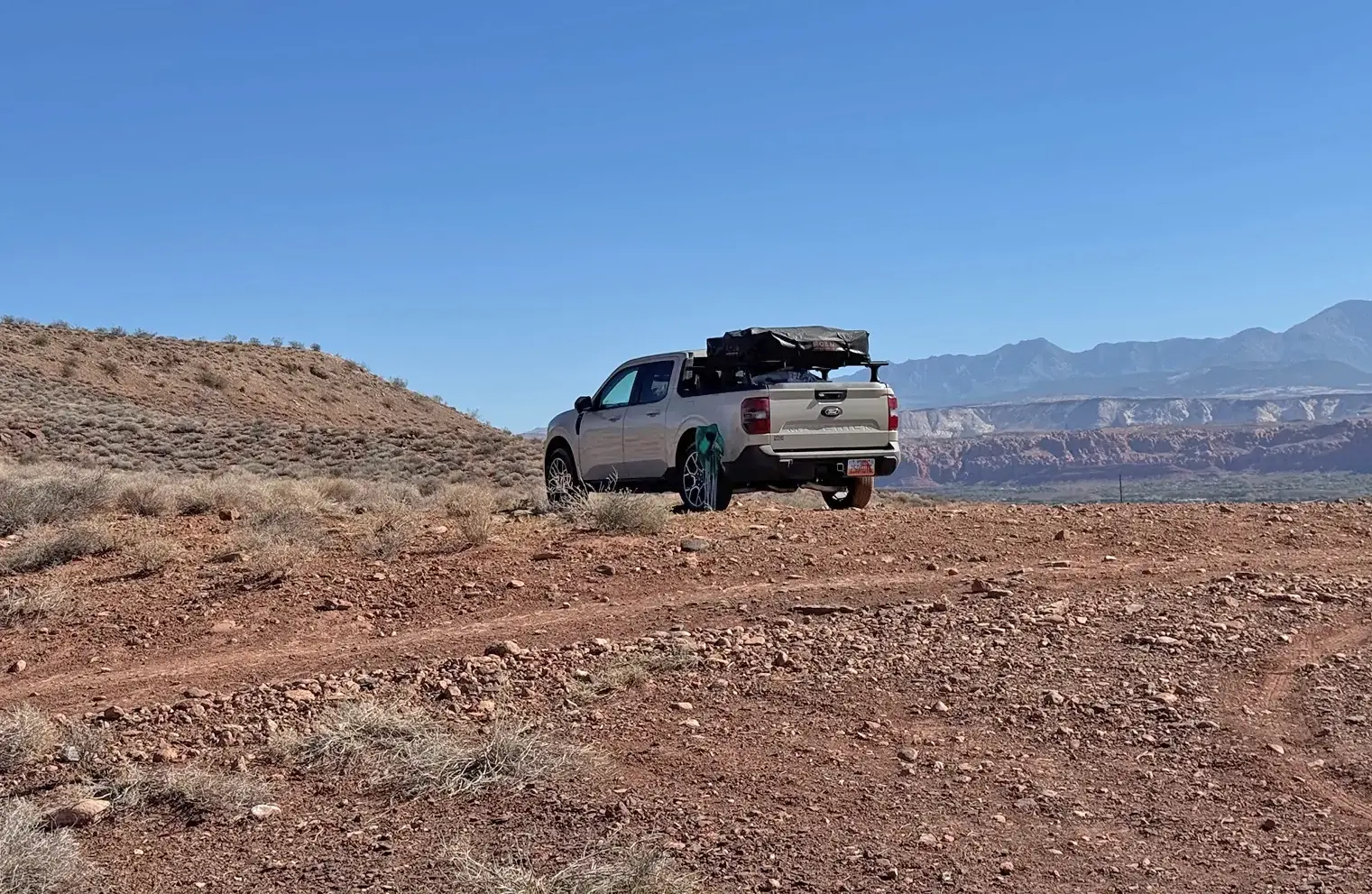

RealTruck Elevate Base Truck Rack:
I decided to go with this truck rack for a couple of reasons. First, I overall liked the look more of the lower profile rack, especially with an RTT mounted. Second, I was really interested in the quick release/install mechanism on this rack as my hope was to just keep the RTT mounted to the rails and remove both the RTT AND Rails all together on a lift. This was big for me because with our previous car we had a difficult time keeping it clean as we don’t have hardly any self serve car washers where we’re at, and removing the RTT is somewhat of a hassle so we just wouldn’t wash it that often. But if I can easily remove it with rails when not in use, then we could keep the new truck much cleaner.

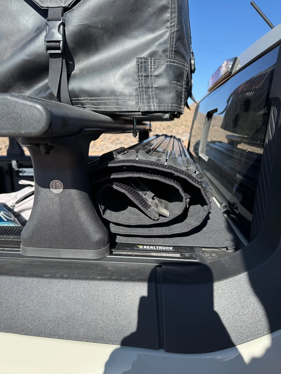

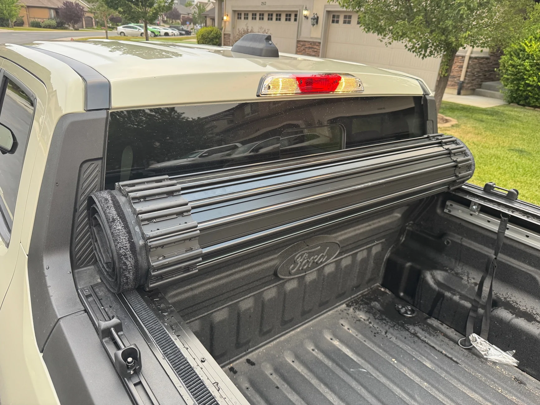

The last concern with these rails is that the tonneau cover might be too thick when rolling up to clear the bed rack. However, I figured out that if I just do a more oval shaped/longer roll I’m able to get it to roll all the way back if I need (see picture). I think because the bed on the Maverick is shorter it’s able to clear the bed rack, where it probably wouldn’t on like an F-150.

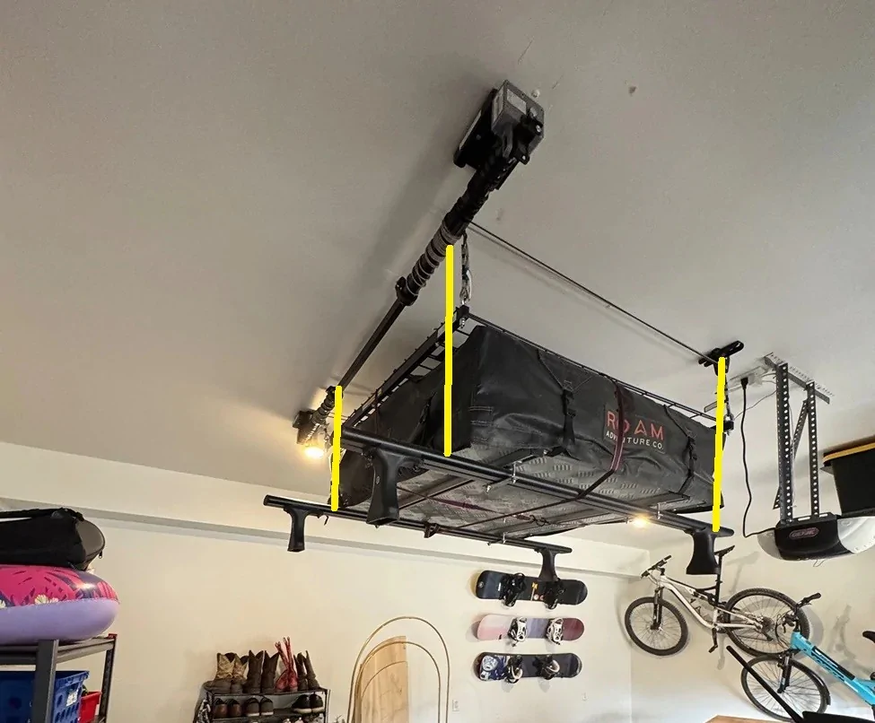

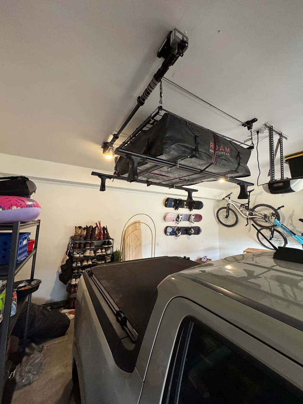

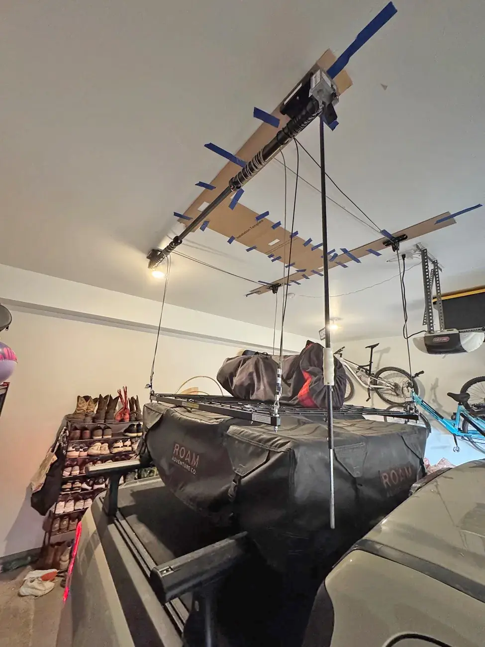

FLEXIMOUNTS GL1 Overhead Garage Lifting Storage Rack
Lastly, I got this storage lift off Amazon that I just installed last week to complete the project. Now with a couple straps I can easily remove the tent and rack when not in use.

Love that pully system you have for the pop-up. Looks way easier than having to try and lift it off yourself. Very nice set-up (y)

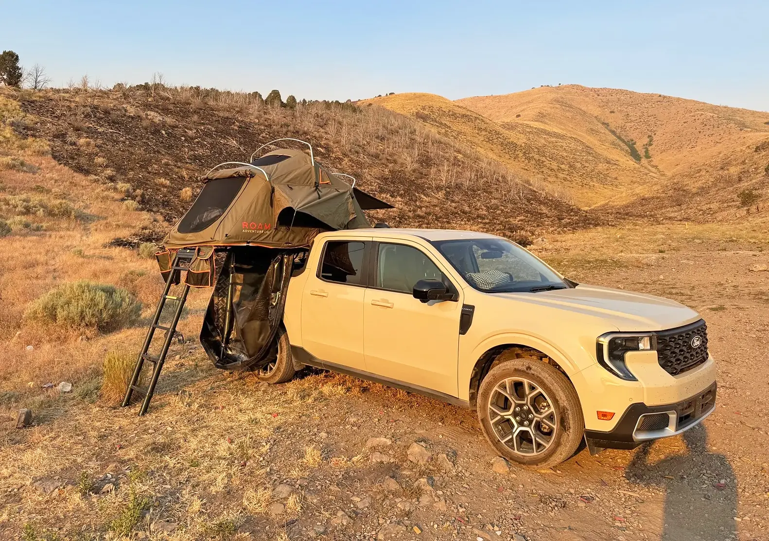

Which tent is that and what was the total cost for everything? Looking at doing something similar lol

Great setup! Mine's similar except I got custom-made risers (about 2" taller than yours) for better rear view and easier bed access
Thanks for mentioning those garage lifts, I didn't even know they existed but now I feel like I need a few 😅

It’s funny, this is where I ended up also. I installed the rails and the sentry ct. I don’t have the rack or RTT yet but that is next, maybe next summer.
I love the look of the canvas over the vinyl.
one thing to know, you can close the tailgate with the sentry ct down, but you train the lip to allow it over time. It does say this in the manual.
but the default is closing the tailgate first, which is what I am planning to do.

Hard to tell from the picture but do you only have one strap (around the middle) holding your RTT to the rack? I'd put a strap on each side to reduce stress on the wire shelf ...
I'm also curious how the bikes are floating against the wall??
Tent is the Roam Vagabond Lite (they might not make that model anymore). We’ve had it for about 4 years and have loved it. Roam as a brand seemed to focus on improving on all the most common complaints in the market by including a thicker sleeping pad (3”), heavier duty cover, industrial zippers, boot bags, and lots of windows/skylights. Other brands may be doing all of those things now, but at least when we got ours it seemed to be better in a number of ways.
- Roam Vagabond lite: $1,600
- Sentry CT + Elevate TS Rails: $1,350
- Elevate Base CS Rack: $548
- Garage lift: $190
Total: $3,688
I’m honestly someone that doesn’t care to have name brand and am always hunting for a good deal/value. With that said, I definitely didn’t go the cheapest route I could’ve on these items, but it was more about the quality and lifespan I’m hoping to get out of everything, and the functionality of how it all works together for what I was trying to do. Haven’t had any buyers remorse yet!haha With that said, I’m sure you could get a pretty similar set up for quite a bit cheaper just by getting a different cover+T-Slot set up and RTT.

Did you ever consider bringing the lift straps down to the crossbars, so you could lift tighter to the ceiling?

Oh yeah and the garage lift I think is really going to be the cherry on top for super easy install and removal. I can connect my power drill to it to raise and lower which is nice so I don’t have to somehow connect to power or hand crank it. Getting the cardboard template exactly where I wanted it on the ceiling was the hardest/most time consuming part. But once that was up everything else installed fairly quick.
